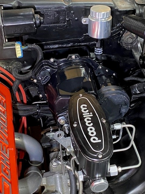

      Name:  Camaro ibooster.jpg
      I'm a big fan of the iBooster in 1st Gen application.

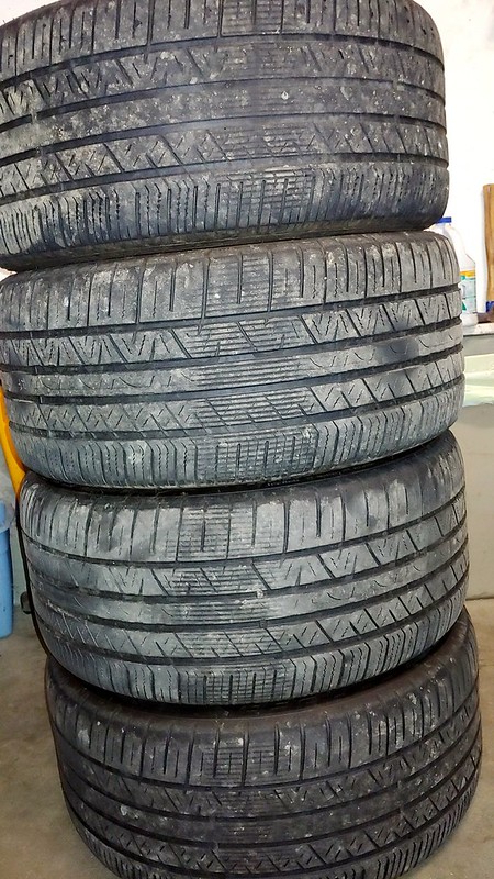

      You have more brake than tire. I ran into the same problem but have an adjustable proportioning valve and have mine set so all 4 bite. After the experience pictured below (all 4 locked up on highway when someone cut over from a non-moving lane) I re-educated myself on the limits of my tires and then upgraded to a better traction compound so the brake and tire combo would better suit one another. This is just with a hydroboost out of a 05 Tahoe and 2000 Camaro / LS1 big brakes, all from the junkyard. I smile at people spending big money on race brakes they don't need.
