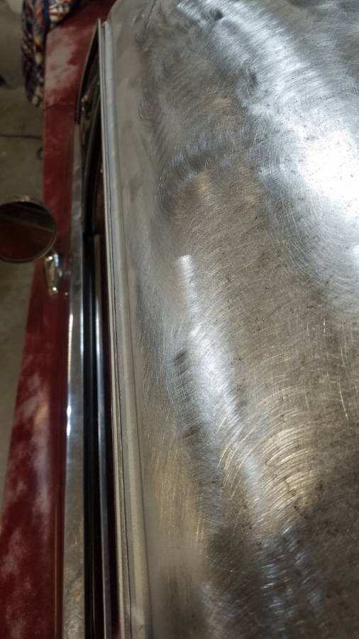

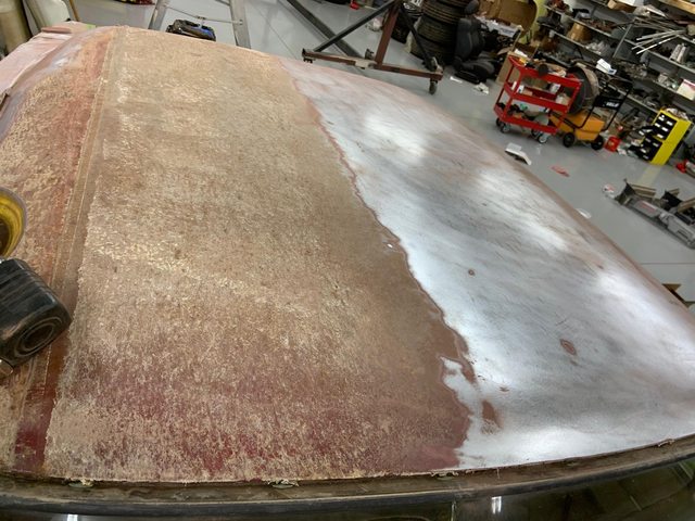

      I tried to remove the vinyl top glue with 3M adhesive remover and acetone but the glue was not coming off so out came the DA.
      - - - Updated - - -
