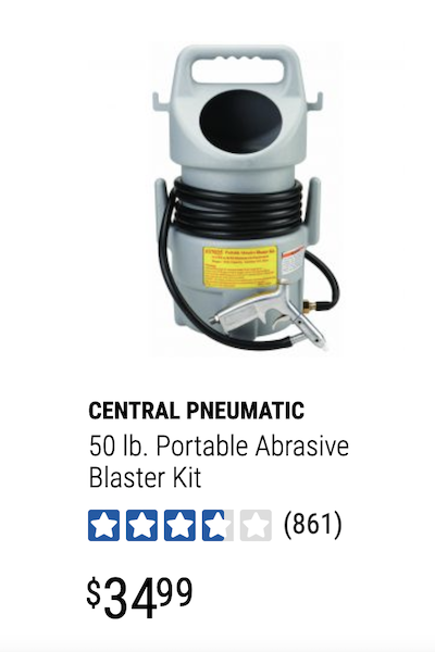

      You could get a small set-up from Harbor Freight (only $35) and some fine grade walnut shell blasting media. Should do the trick. Don't use POR15; it's meant to be an easy process applied directly over the rust. After you remove all the rust, there is nothing left for the POR15 to grab onto and it will eventually fail, and probably trap moisture in the process making matters worse.
      Epoxy primer is the way to go, and you can get it in spray cans from resto-suppliers like Eastwood.

      From personal experience I would avoid the walnut shell abrasive. It's mainly for brass prep and gentle cleaning of delicate items. The rust you're wanting to remove will laugh at walnut shells especially the harbor freight variety.
      There are numerous websites with great resources to guide to what grit to use to achieve your desired results.
