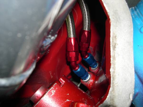

      69 Camaro, 7004R Aeroquip -6 AN and fittings.
      Then trough a remote filter into a BeCool radiator. Could just as easily go to external cooler, but this works well. Using a trans temp gauge and it's always within limits.
