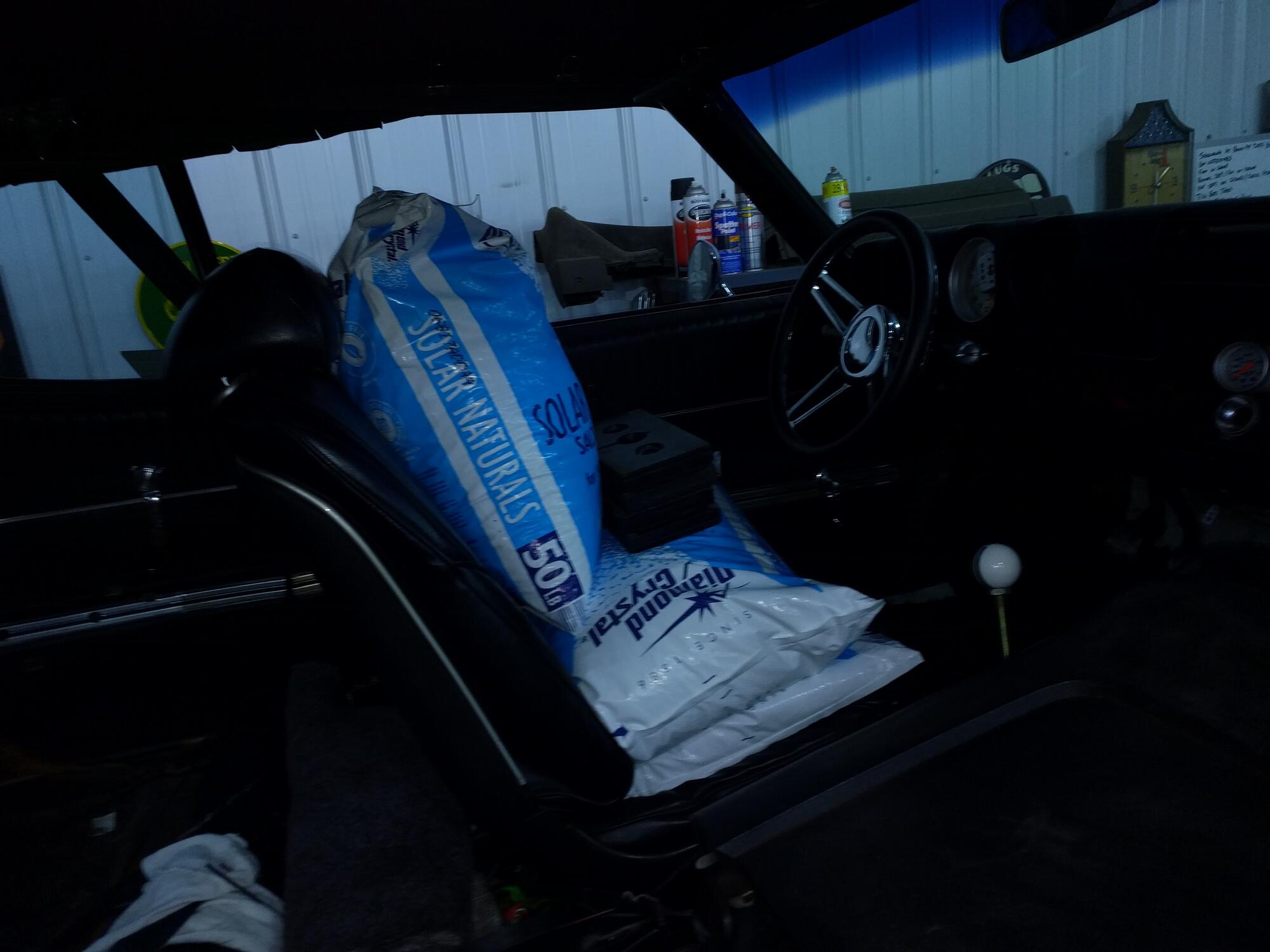

      I offset my lower control arm link so that both would be parallel when 280#bigboi was in the driver seat. My thoughts when doing this would be a car with predictable rear steer when it was just me driving. The frame side mounts have adjustment holes so I can angle the arms up, level or down. Angled up should make the axle turn into a corner, angled down should turn out. In reality I have not messed with this at all. They sit at level setting. Doing it again I’m not sure I would offset the mounts, or worry about this at all. I haven’t had any experience changing settings, it could be awesome or awful.

      Hey, when I say offset I was referring to the vertical position. I added 280 lbs of salt into the driver seat, and welded the lcas in a position that both lower arms would be perfectly parallel. The idea was to eliminate rear steer variability from left it right turns.
