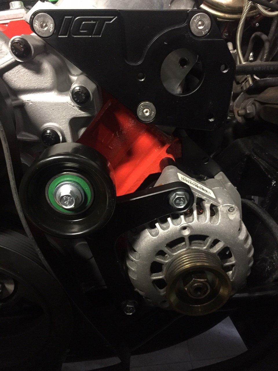

      I can't comment on LSX concepts but I ended up using ictbillet for my accessory drive setup and engine mounts, nicely made and came with everything needed, fit perfectly for F body LS1 spacing.
      I believe they have Corvette spacing.
      https://www.ictbillet.com/ls.html
      Name:  ICT billet parts.jpg
      Name:  ICT Alt and PS bracket.jpg
      I had then anodized black.
