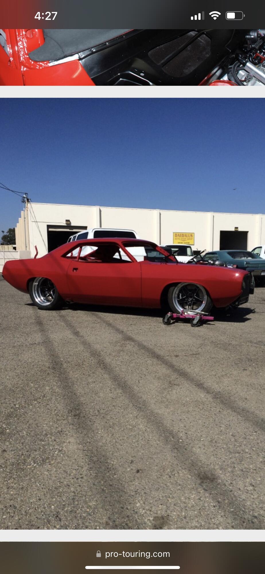

      Hello, I recently got into this hobby so I知 learning along the way any advice will help. But I知 looking to get this ride stance on my cuda but without doing a full chassis.. I知 planning on mini tub, spring relocation kit and shorty headers to get this stance.. my question is would it be drivable? I知 planning 20x12 in rear and 18x8 in the front like the picture above. Thanks again any help is appreciated!

      90
