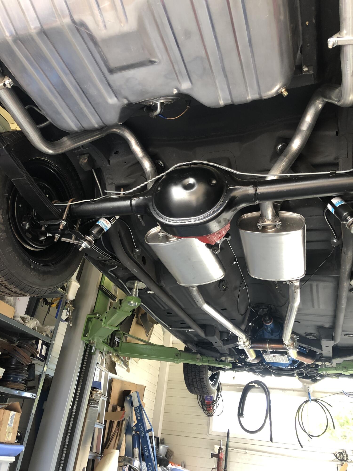

      not really had a Name:  9B9D6599-7165-48DD-B93D-54E149861988.jpg
Size:  308.0 KBName:  5A64595C-28EB-49F9-8DC3-041B1CD8ED2A.jpg
Size:  336.7 KBName:  42091AD4-3792-4168-B83A-95386C50B615.jpg
Size:  337.1 KBName:  3C3E7E59-DA33-4B9D-9071-7C6E92637341.jpg
Size:  201.1 KBName:  2AF64E58-AC66-4BC2-A146-47B34B1703C9.jpg
Size:  521.2 KBName:  D4FEB990-B529-4212-8D71-69FE3AE39593.jpg
Size:  515.4 KBName:  259A6A66-B987-479F-B91A-C5B5769D8336.jpg
Size:  628.2 KBchance to use the 69 yet, but here some pics of it on my drive.
      wil be putting some mikes on it over next few weeks to bed her in
      chris

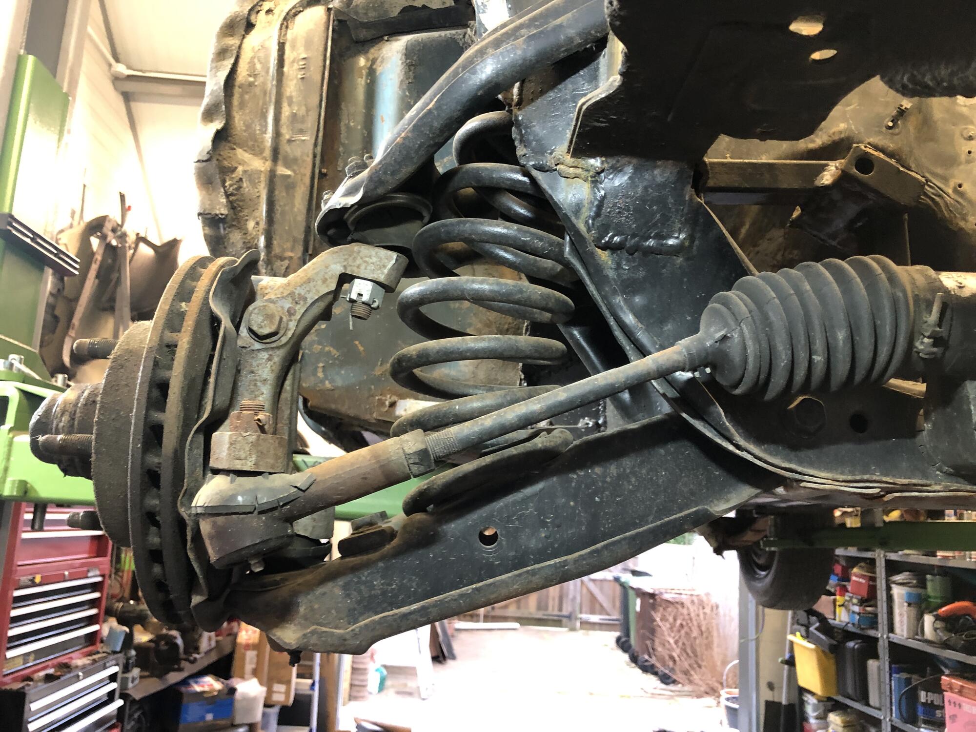

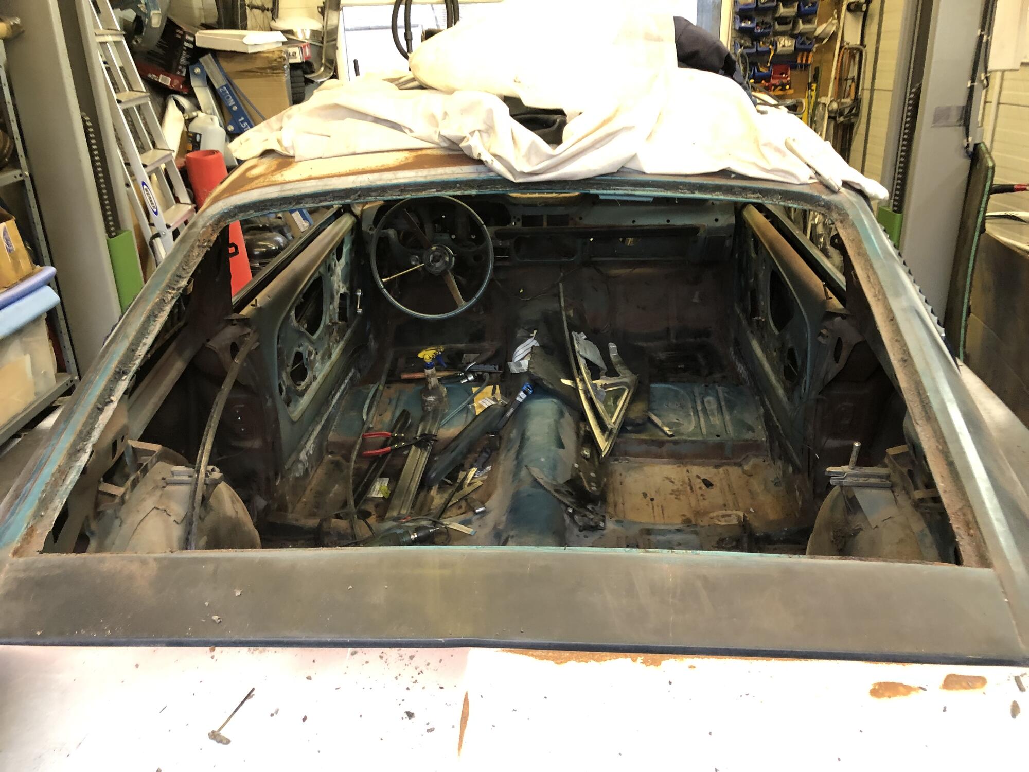

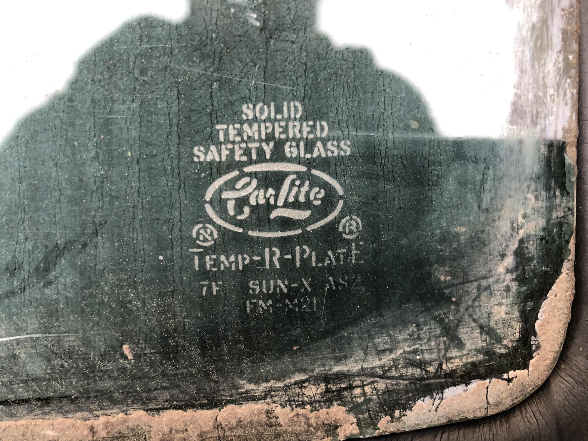

      Strip down nearly done; all front and rear suspension and rear axle is of now and it’s on my false axles to push it around the shop..
      Those side windows and main door glass are a pain in the ass to get out. Not looking forward to putting that back together in a few years when the car is done.
      Just took out rear screen, I wanted to save it as an original Carlite one which looks in decent condition.
      Next 1/2 weeks I’ll assess what’s needed and start ordering the main parts.
      I’m going the “whole hog” on a restomod so going to be a long project.
      I have a week off at the end of the month so I’ll look to to start to replace the floor section then.
      #builtnotbought #68restomodmustang

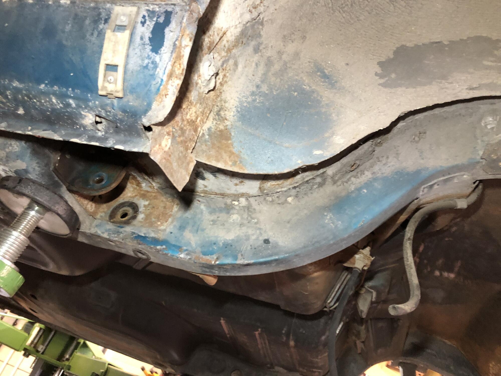

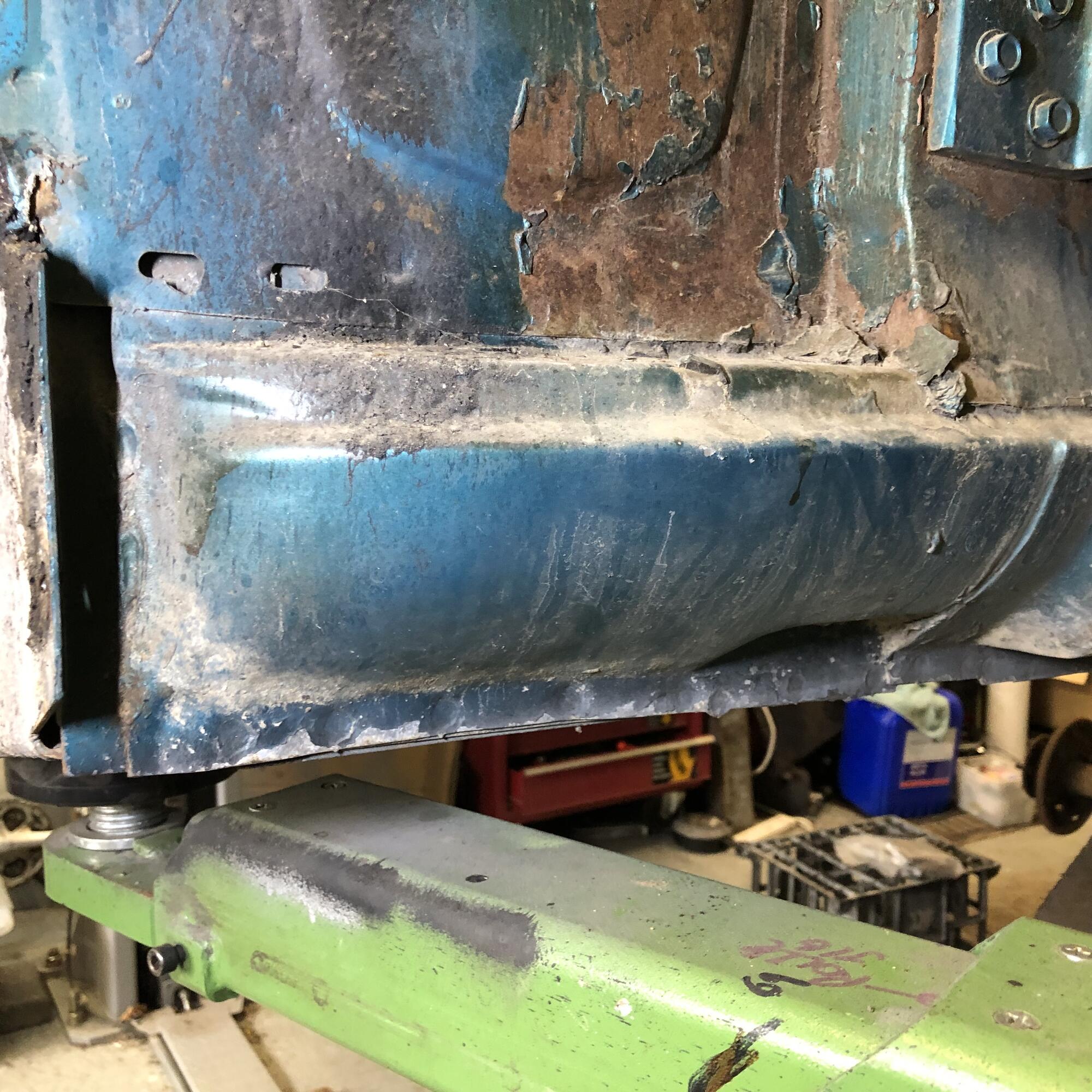

      Apologies, it’s been a quite a time since I last posted - I’ve been busy finishing off my 69 fastback restomod and trying to enjoy what we have of summer we have over here in the U.K.
      Progress has therefore been a bit slow on the ‘68 fastback.
      surprise,surprise on a mustang, I found a bit more rust than I was expecting; floor pan, bulkhead/firewall and lower cowl plus some other stuff, so much for buying a West Coast car, lol. Had to get the stuff via US which has caused a delay.
      Now starting to make progress; bulkhead/firewall completed and full floor and cowl test fitted and ready to install.
      Hopefully pics will load.
