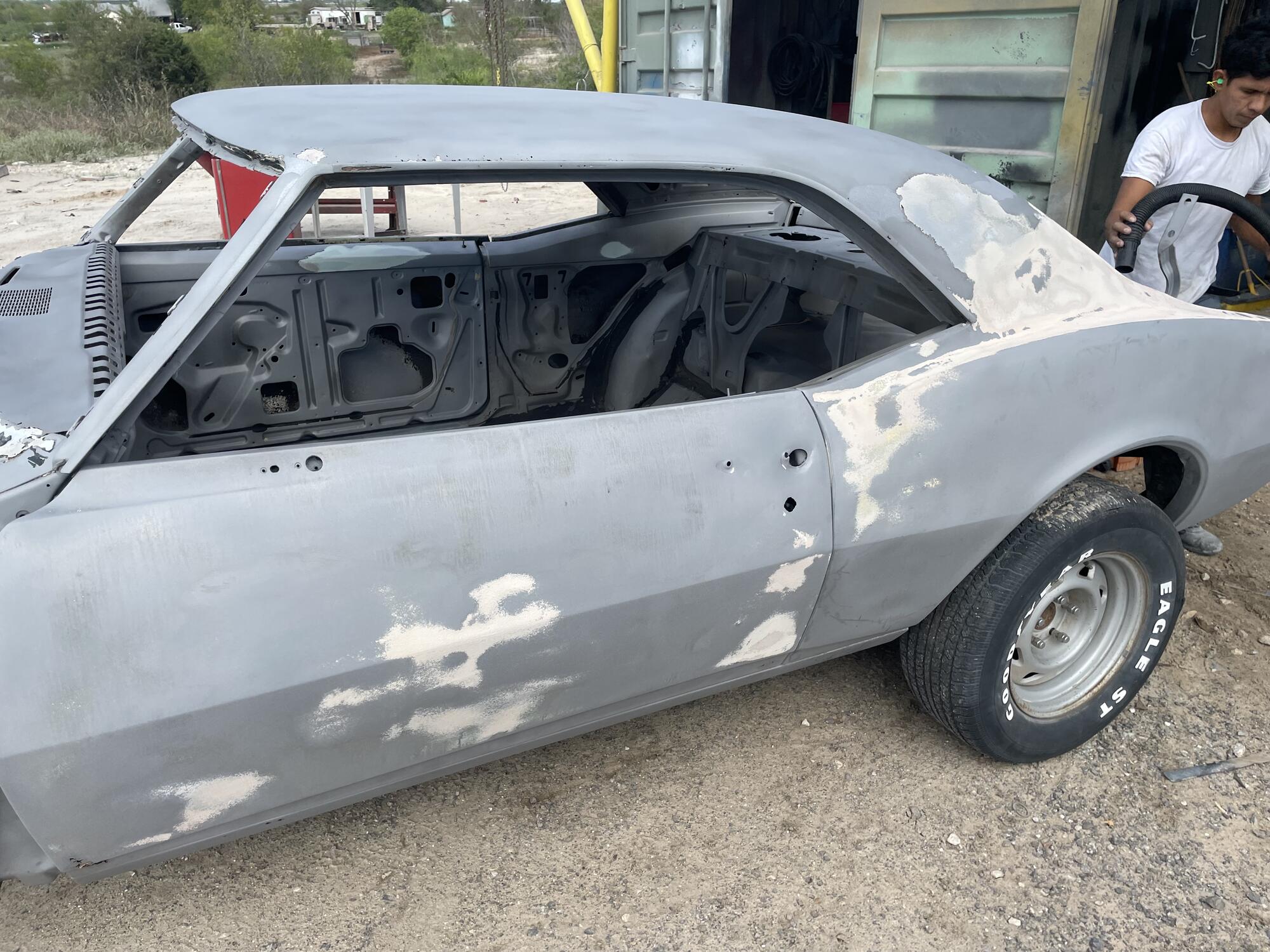

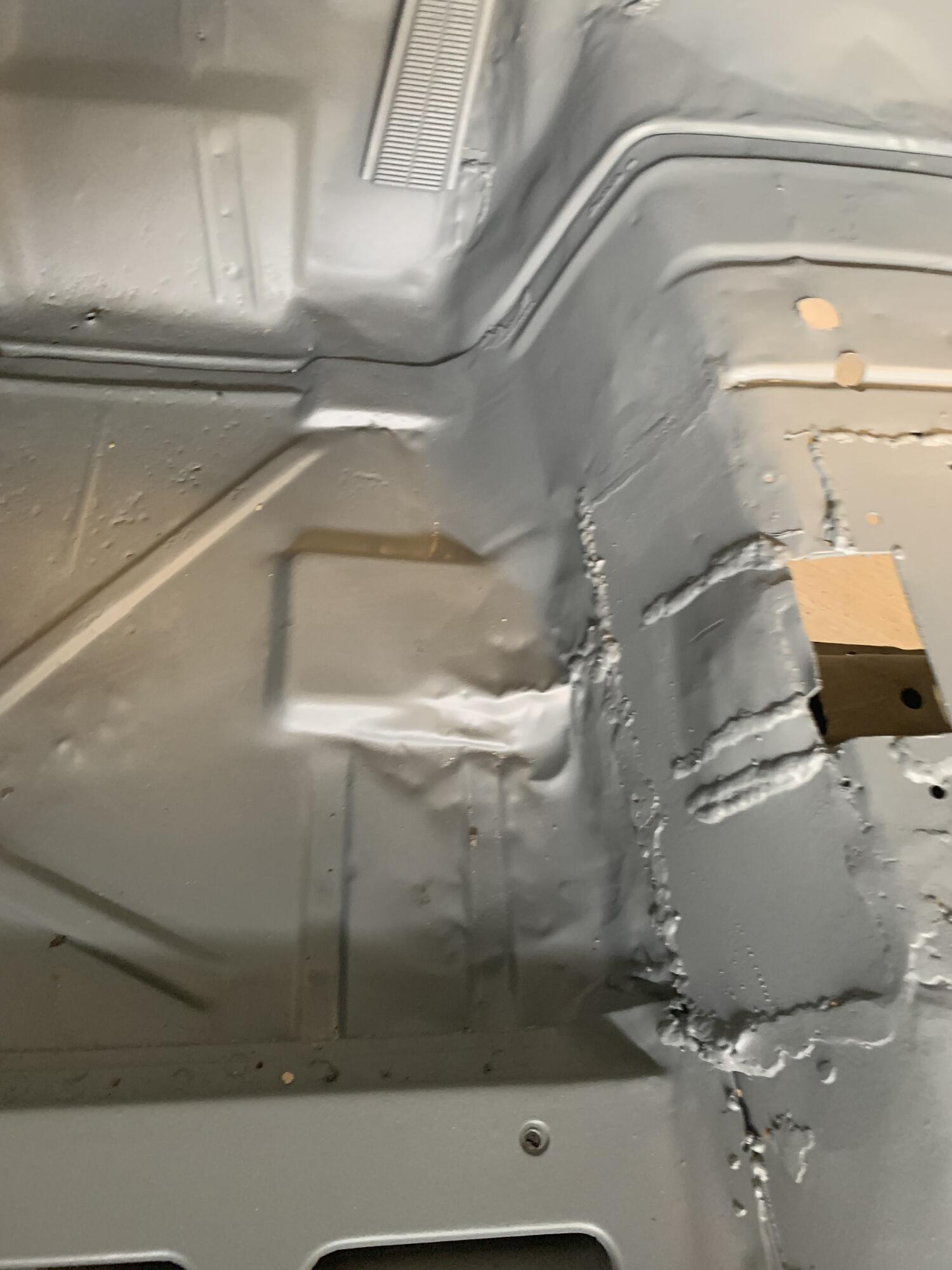

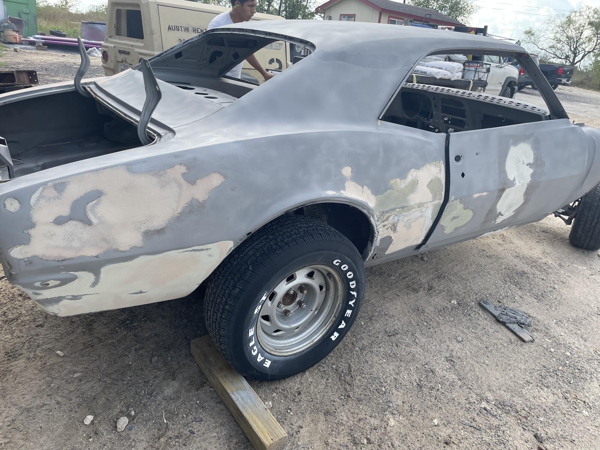

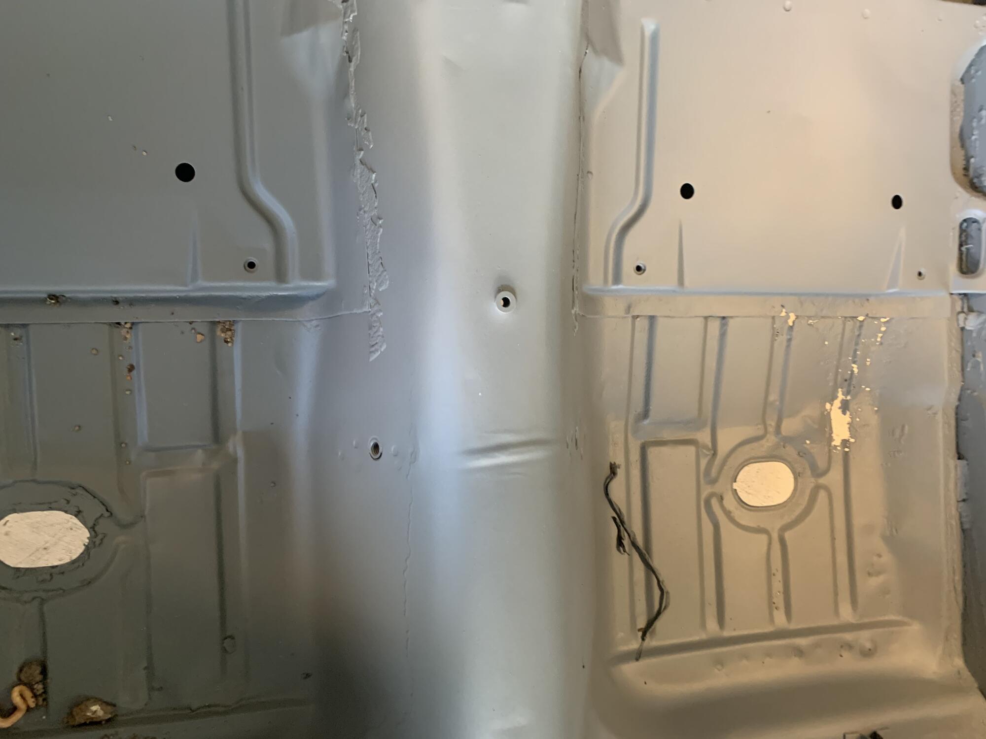

      I need some advice to move forward. I recently got my car back from media blasting, and while I am not overly surprised, it's worse than I thought.
      From what I can tell, it needs
      • the full passenger quarter, and maybe the drivers.
      • roof skin with drip rails
      • rear trunk filler panel
      • deck lid
      • passenger door skin
      • tail panel
      • upper dash
      • both tulip panels
      • full floor?
      I need some input from people that know more than me on how best to proceed. I see that the Dynacorn are $13.5K and come with doors and truck lid, this seems like it would be a cheaper/faster route than sentencing the car to either body shop jail for years, or having me hack at it until it is minimally acceptable. What level of quality are these bodies? Can I just swap my VIN/body tags over?
      I am also a little afraid of the squareness of the whole body after seeing the floor pan around the transmission tunnel. Are there any known points that can be measured to confirm square, or should I just pick some repeatable locations?
      Thank you all in advance for your help.

      As I understand it, you can get a new body and simply use your old VIN tags. With as much work that your body needs, a new shell makes a lot of sense.
      Mountain Springs, Texas
      4,877
      If the rockers and frame rails are decent it can be fixed. A body jig is essential to doing a good job. Camaros.net has a lot of threads from guys fixing worse. Here’s my body jig.

      Those new bodies aren't anywhere close to being ready for paint either from everything I've heard. Obviously it would require less work vs your car now .

      Thanks for the feedback. I know that the body can be fixed, I have seen some amazing transformations from way worse beginnings. But this is not anything special, just a base model car and in the interest of savings (both time and money) I am just wondering if I would be ahead starting with clean (er?) sheetmetal? Does any body have any first hand experience with the aftermarket bodies?
