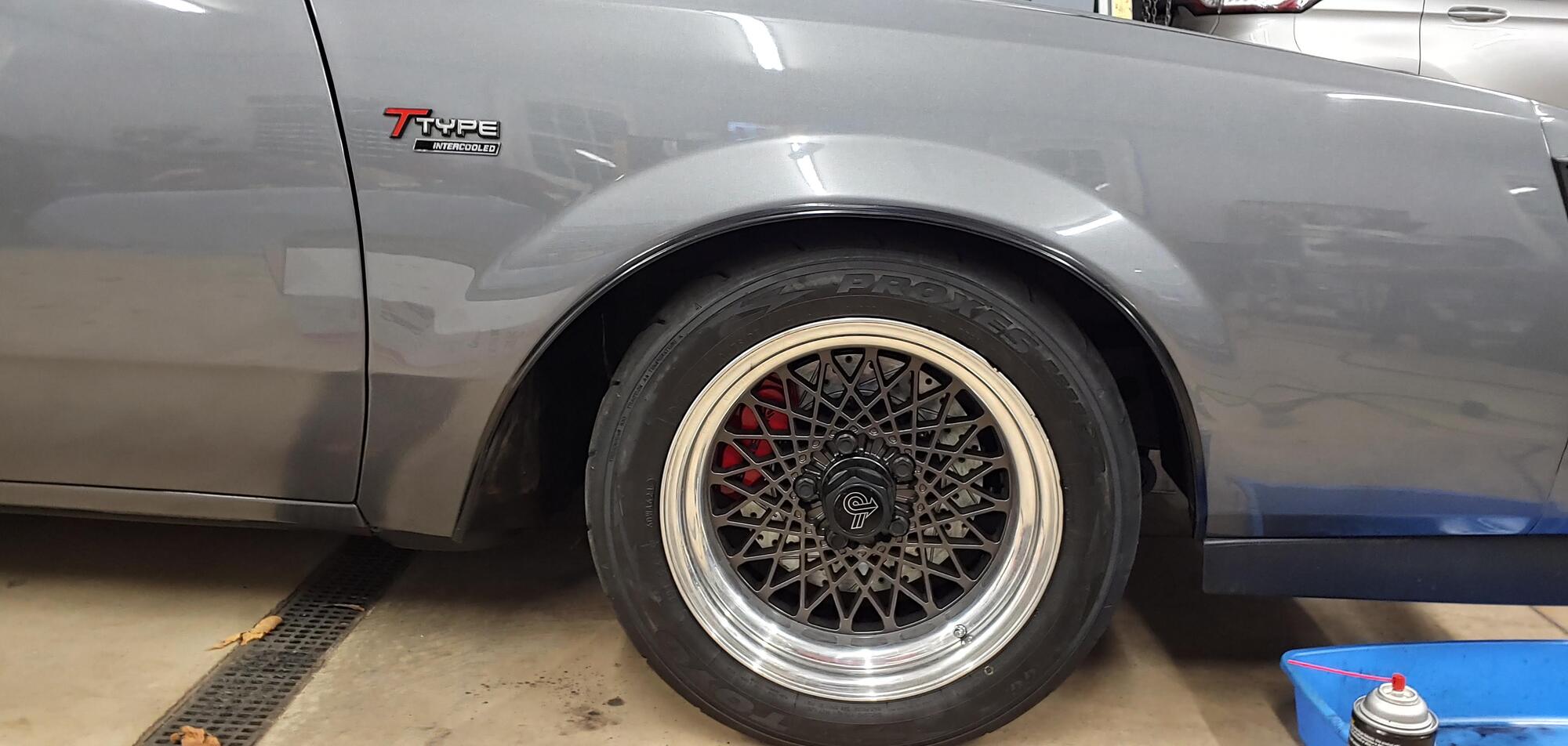

      I'll try to get this started. I just finished upgrading the front brakes on my pro-touring Ttype. Baer made me a 12" rotor set up to fit their ss4+ set up that typically comes with 10.75" rotors for the G-body. The 12" rotors will fit with a 16" rim.

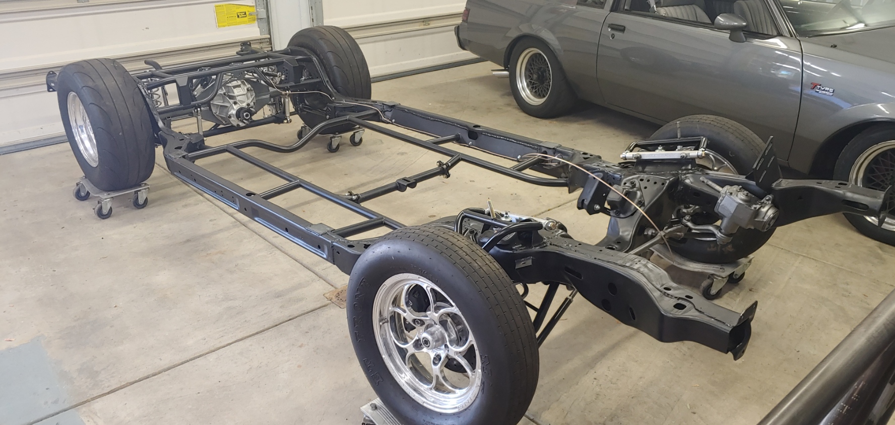

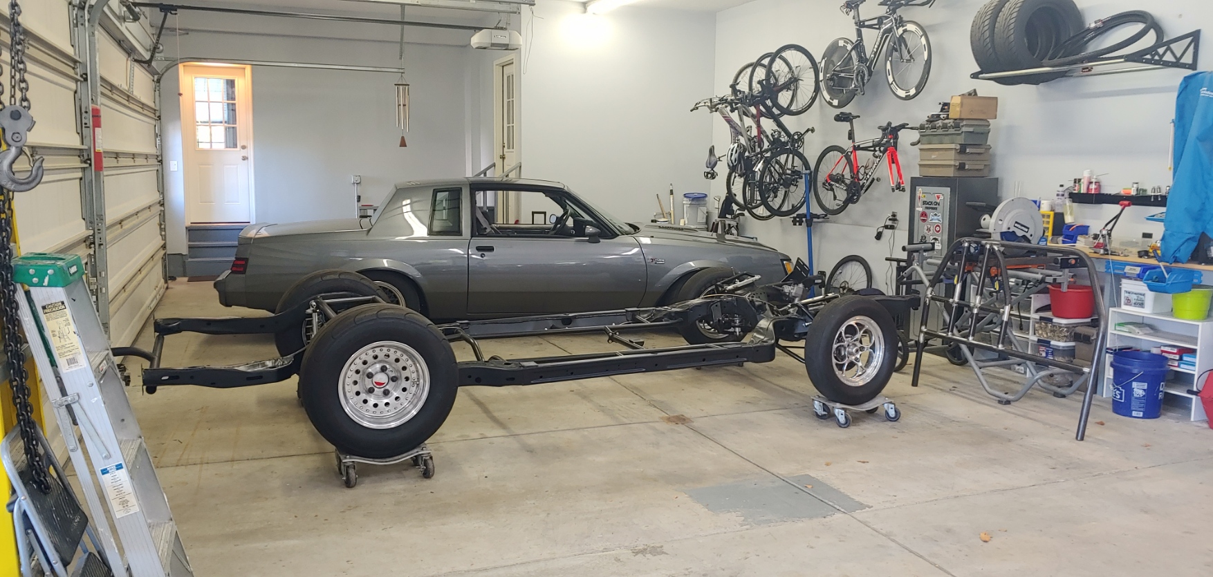

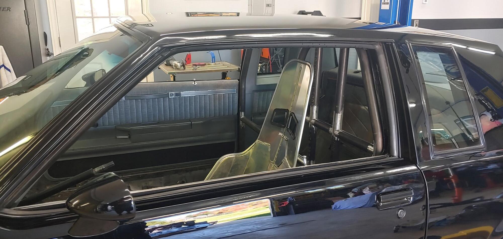

      I am also building a 25.3 87 GN to do drag-n-drive events. I am signed up for Sick week in Feb but that will be a long shot in making. The car has been 8 teen at mid 170s already planning to be in the 7s with the new chassis.Name:  1009221130.jpg

      Turbobuick, Great looking builds! The T type and Grand Nationals have always been a favorite of mine!

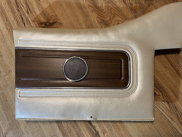

      I'm currently working on interior and stereo stuff for my '72 Olds 442 convertible. This 10-year project is approaching the finishing line and I couldn't be happier. I bought a pair of used BMW seats from an M3 convertible and had them recovered to emulate the stock A-body bucket seats, got them install this weekend. The upholstery guy thought I was crazy to remove the beautiful black leather and recover them with white vinyl, but they look great and match the rest of the mostly stock interior. I made custom mounting brackets to allow the seats to bolt to the A-body floor pan contours, and I reinforced the mounting locations for safety. The seats sit a bit higher than I'd like so I may rework the mounting brackets to incline them a bit; but that will be a project for another day.
      The previous weekend I installed an 8-channel JL Audio amp in the trunk and ran all the power, signal & speaker wiring. I'm looking for a good location to mount the Dayton DSP unit which will be used to tune the 8-speaker system and set crossover points for the speakers. I think it will fit nicely below the RH A-pillar, kind of behind where the door jamb switches are located. This weekend (after sleeping off too-much turkey) I will be working on the rear speakers. I've added power windows and the stock location for the window switches was in the upper door card where the window cranks would be. I moved the switches to the armrests and will be fitting a pair of 2-1/2" full-range speakers in the door cards.

      I bought these grilles off eBay, the 2-1/2" speakers will fit behind
