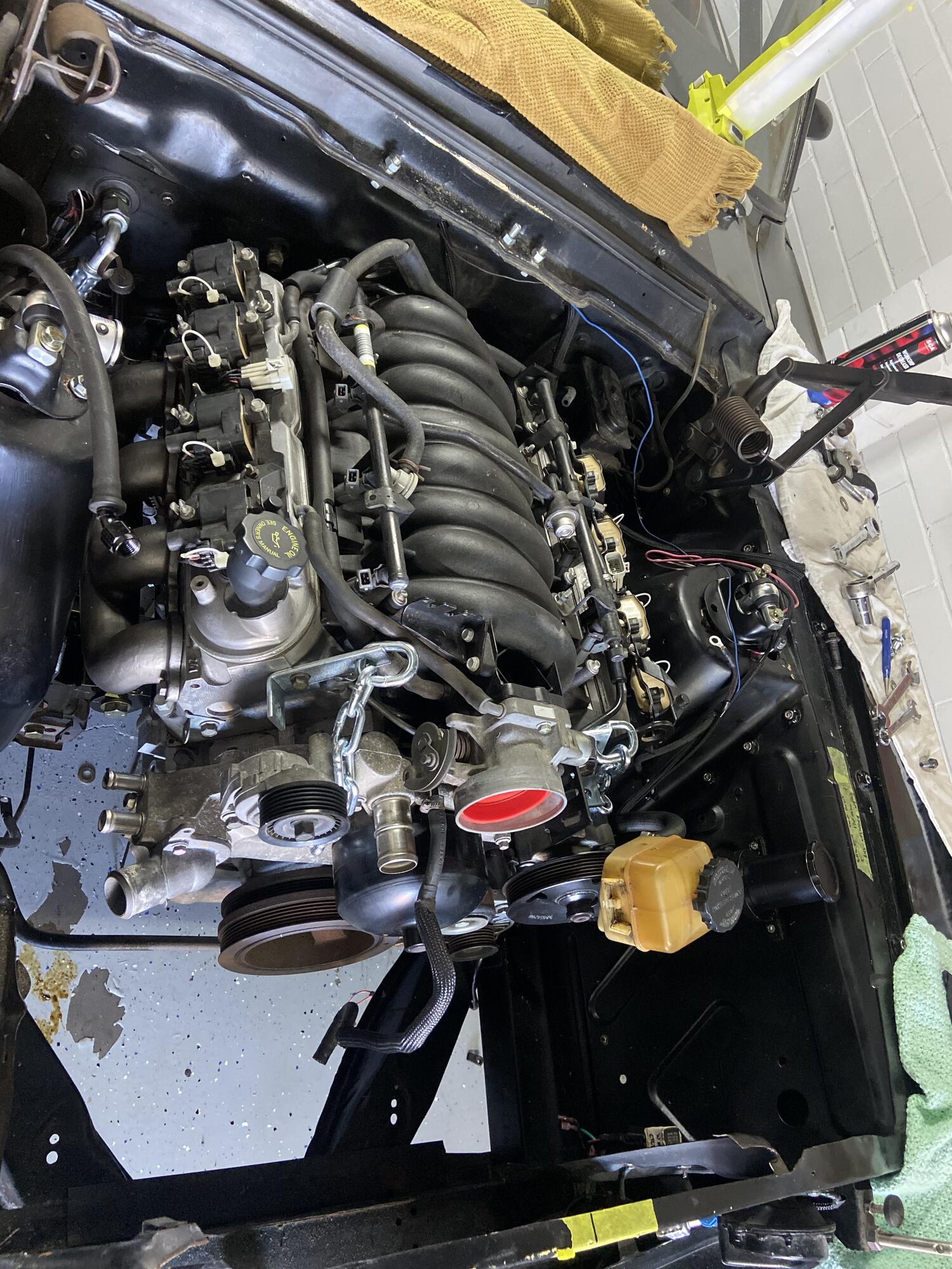

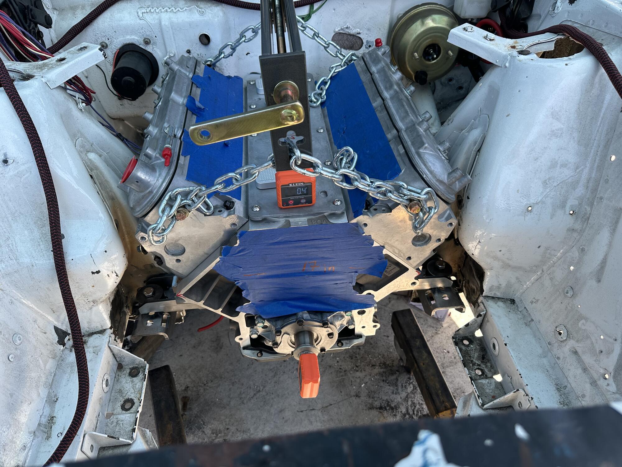

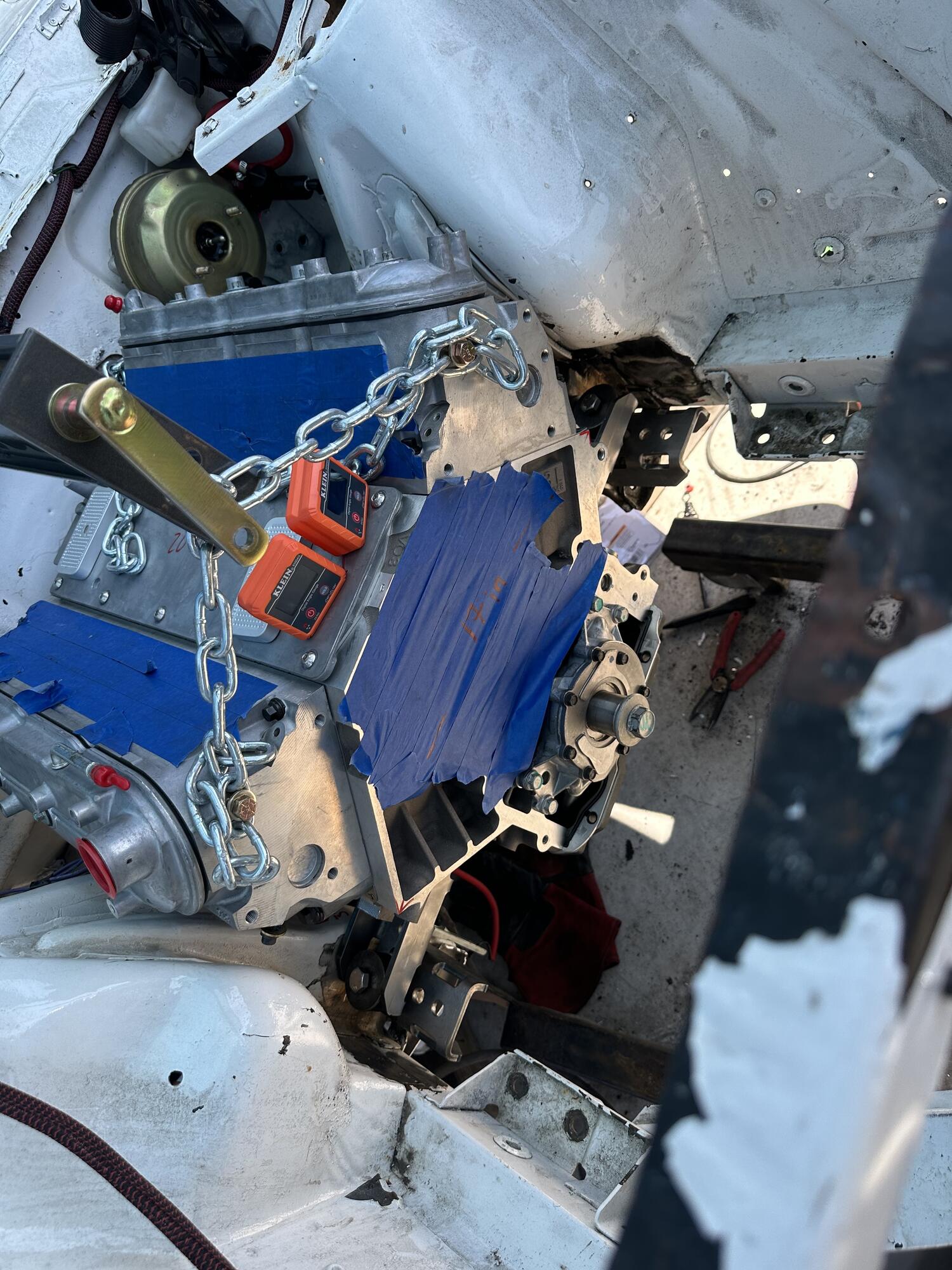

      Hey Bro, I am on the same boat with a 66 Mustang. A client of mine opted to cut the shock towers and keep the same suspension. I have welded up some dirty dingo motor mounts and it fits fantastically. Except for the headers :(. I am looking at my options and I stumbled upon your thread; have you been able to properly get this setup in the vehicle and check clearances?
      PS: You're my last hope before I tear an old suspension suspension and do a Mustang II conversion on it

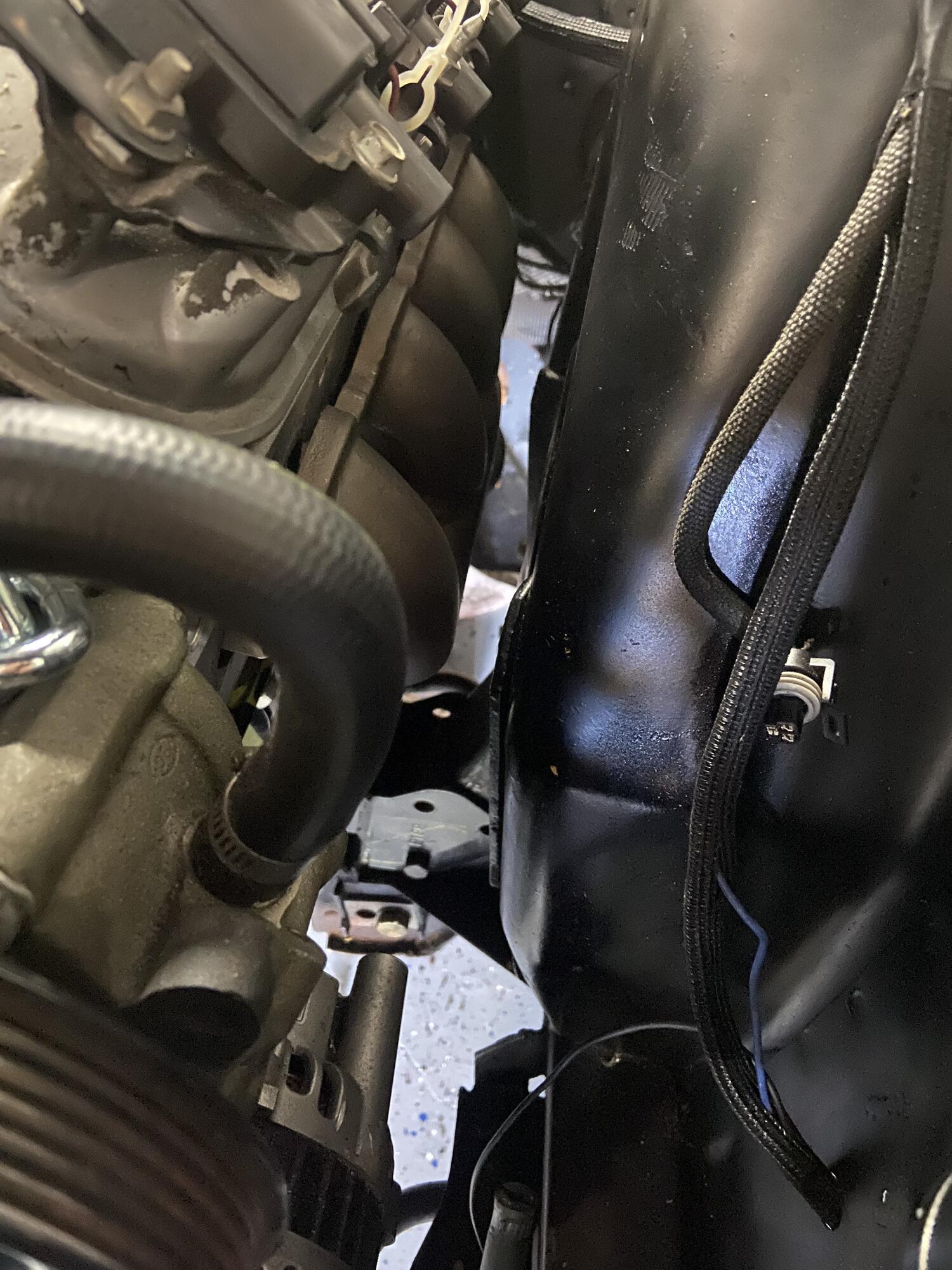

      Mate I've just (literally sitting in my garage typing this) test fit the Hooker LS Swap manifolds. Fits perfectly.
      Note that I'm using a TCP rack and pulled out the original steering components.

      Much appreciated bro!! I will be getting the hooker headers and test fitting with the dirty dingo mounts if not I will have to cut them off and order the ones you did! Thank you !

      this is my set up. I have most accessories in place already the heads have been ported along with the lsx intake manifold. It’s being married to a tko.
