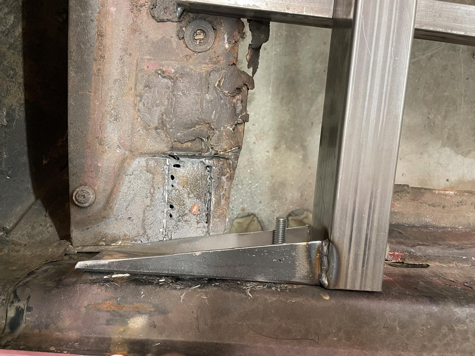

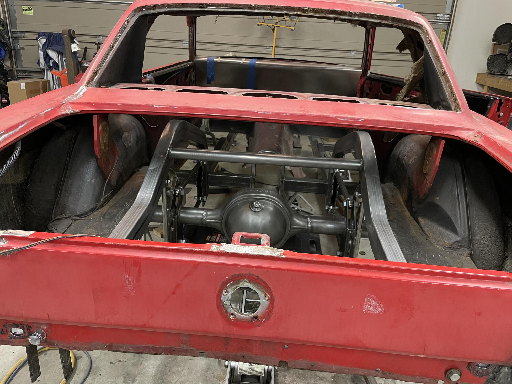

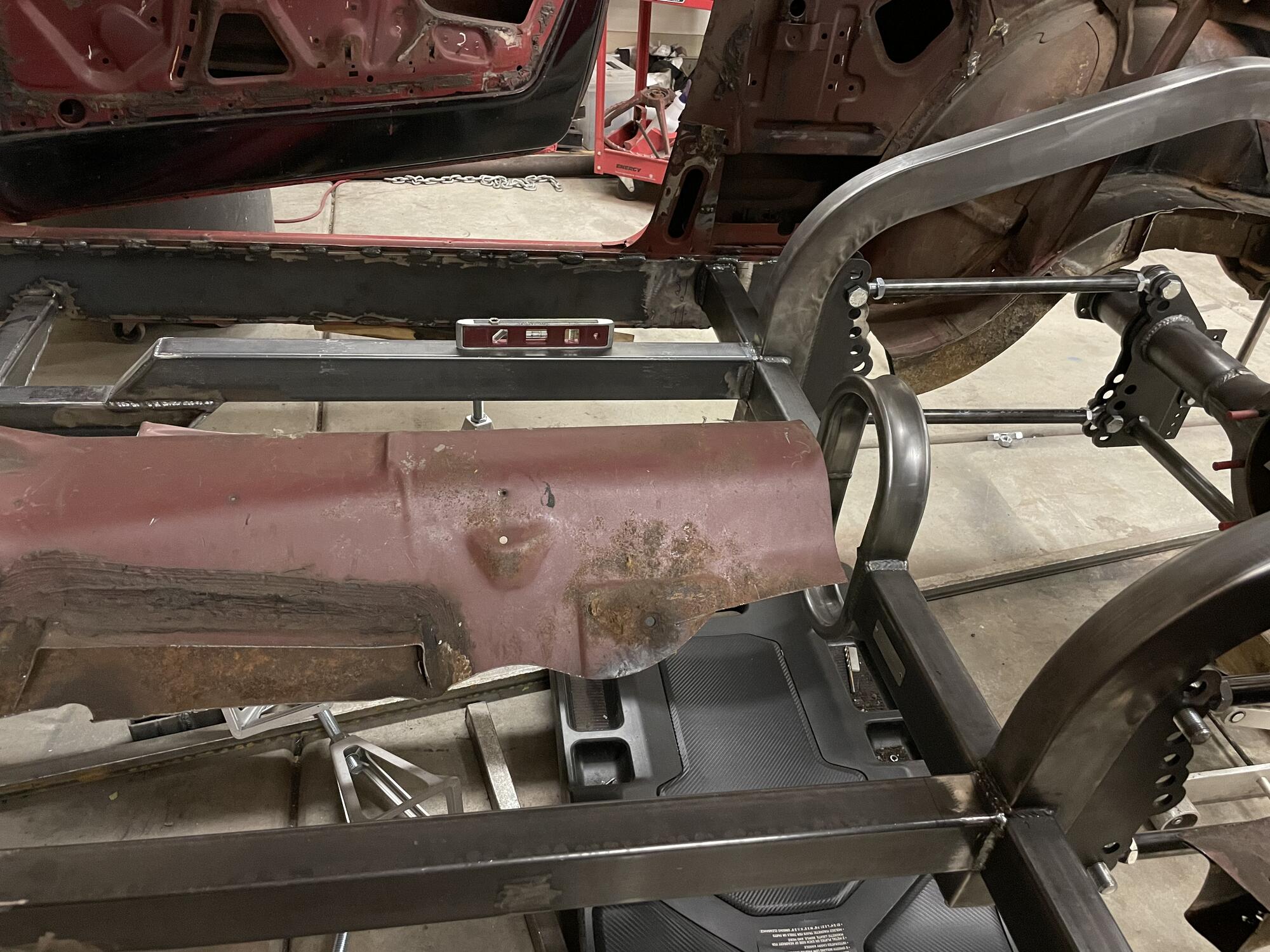

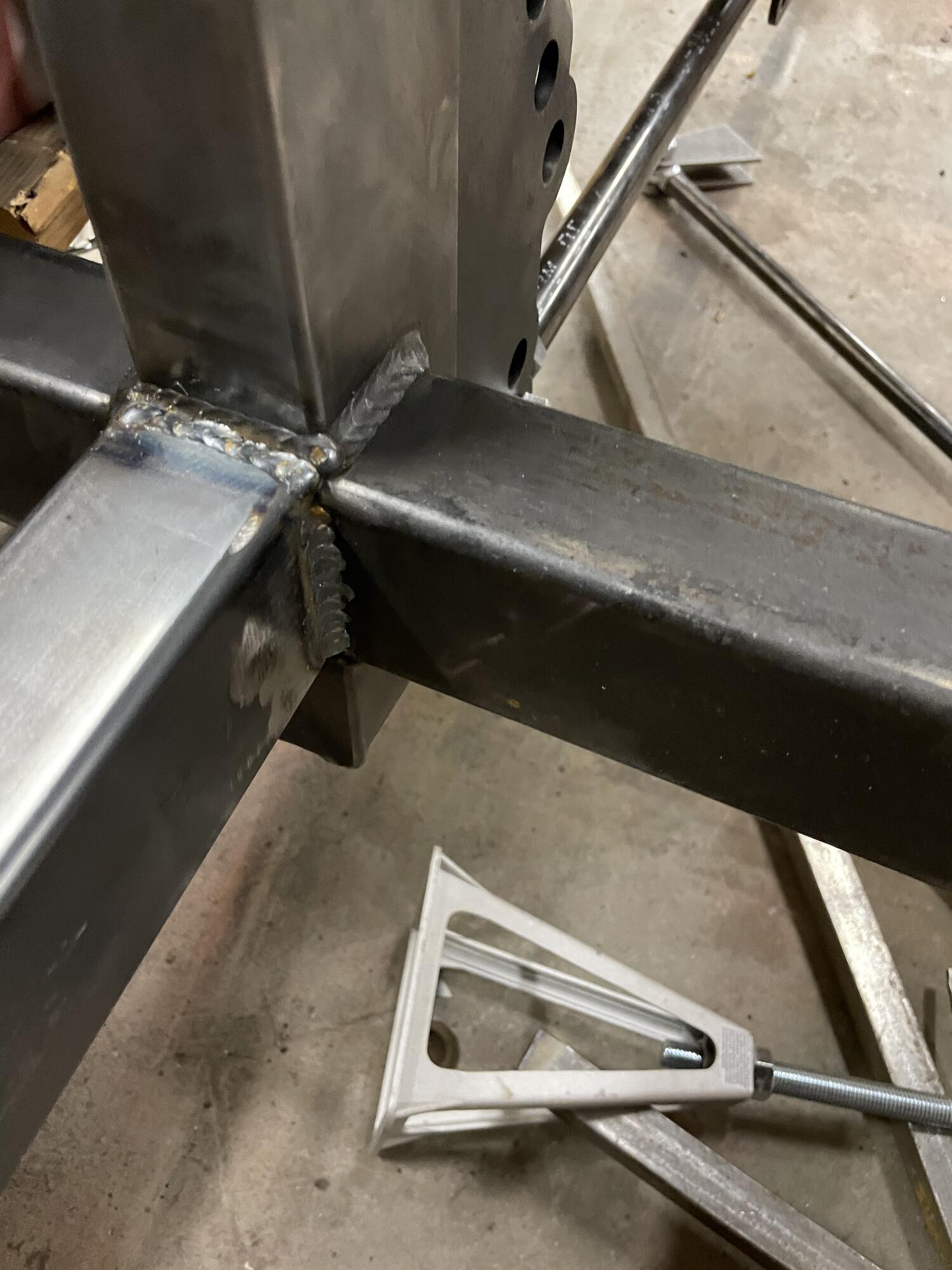

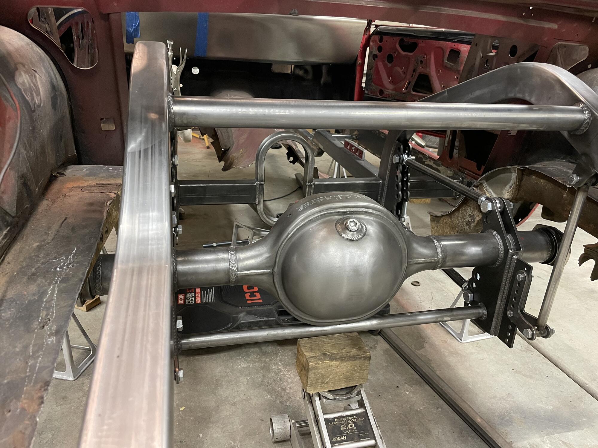

      The back half is fully welded now. Just need to finish the bumper brackets and then I’m on to smoothing out the firewall. I need to place my roll cage order too. I think I’m going with Art Morrison for that. My welds are getting better as we go along.
Size:  448.5 KBName:  7CD02705-395C-43E5-B53A-9B8DC321173B.jpg
Size:  255.1 KBName:  52D0CBDE-08AC-4BD7-9C0A-34B57188BC84.jpg

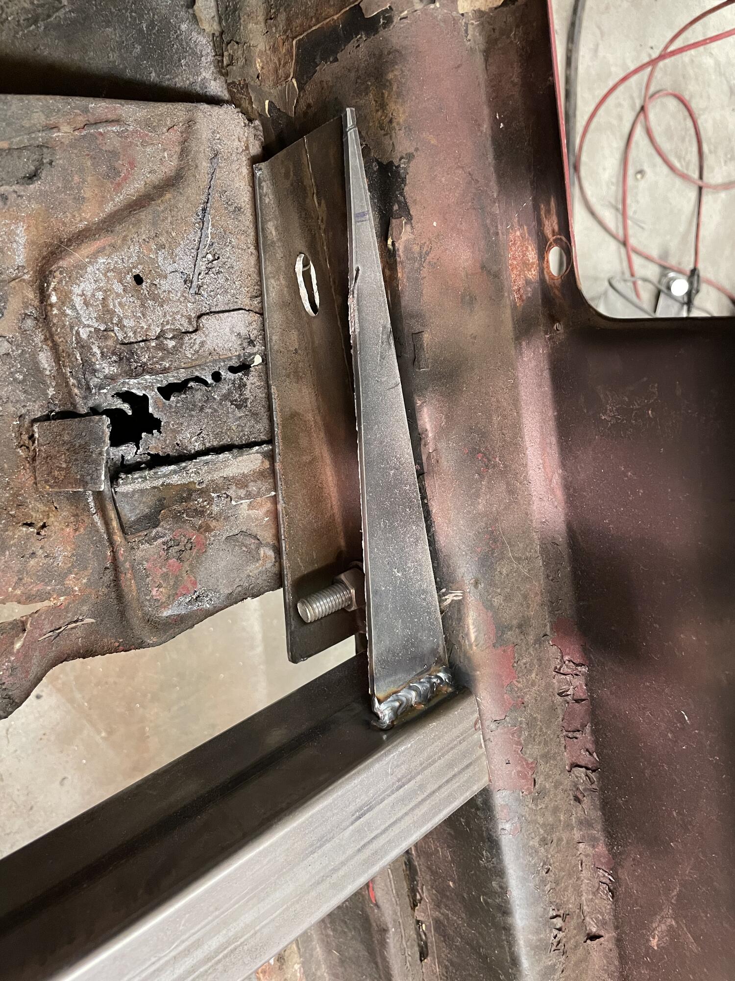

      Bumper brackets are done. I’ll have to do the final welding once the old sheet metal is removed.

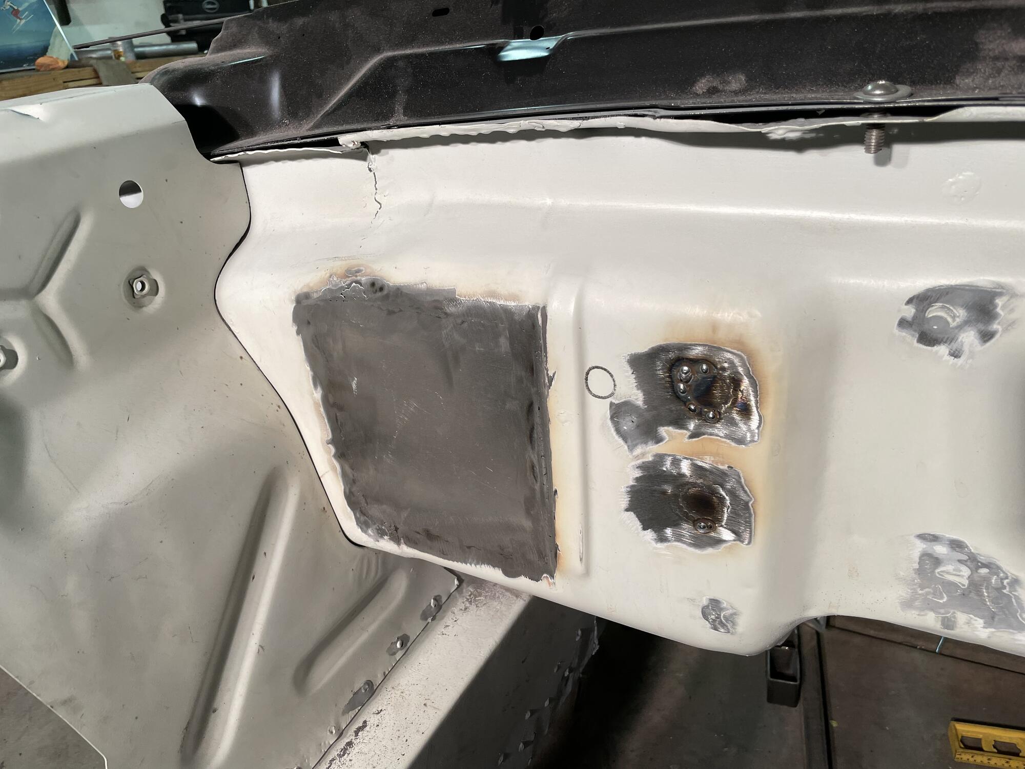

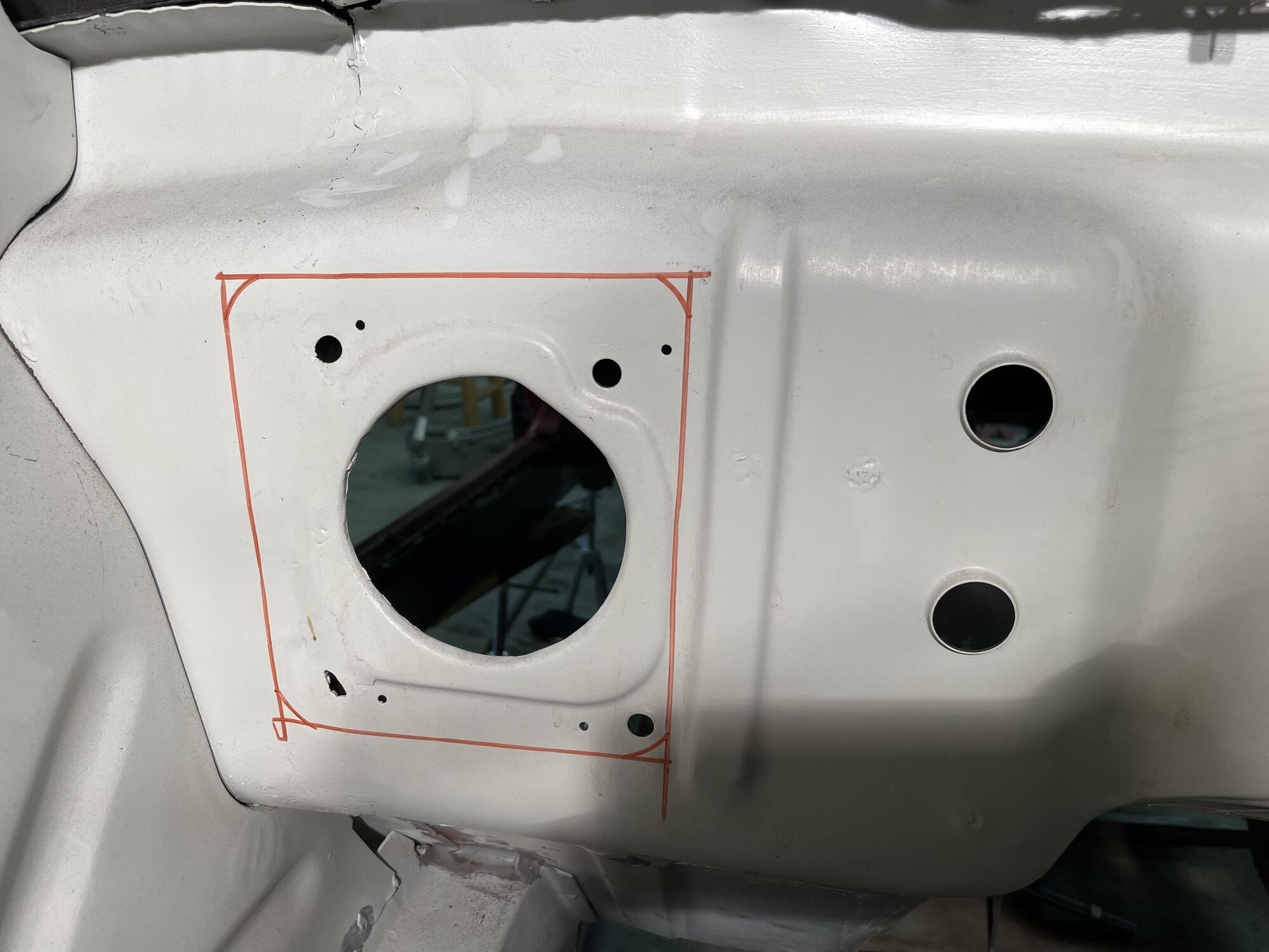

      I spent a little time cleaning up the firewall a bit.
Size:  202.8 KBName:  A4FC951E-AEDE-4595-8C7C-B8FD9E2D9751.jpg
Size:  285.6 KBName:  DBAFD102-EC7A-418D-B917-78EC615B3318.jpg
Size:  216.6 KBName:  26A1DF22-B769-430D-A98B-6E6D32DCB6A4.jpg

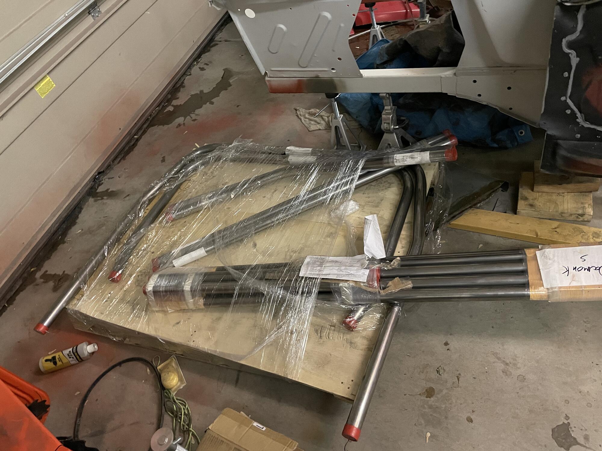

      It’s coming together pretty good and starting to look like what I want. The next phase is cutting away pretty much all of the existing sheetmetal. The original car was mostly just a serial number and a template. It lets me know where to mount all the new stuff. I thought the roll bar was next but I really need the roof in place before I can cut the roll bar so I need to put that stuff in place next.

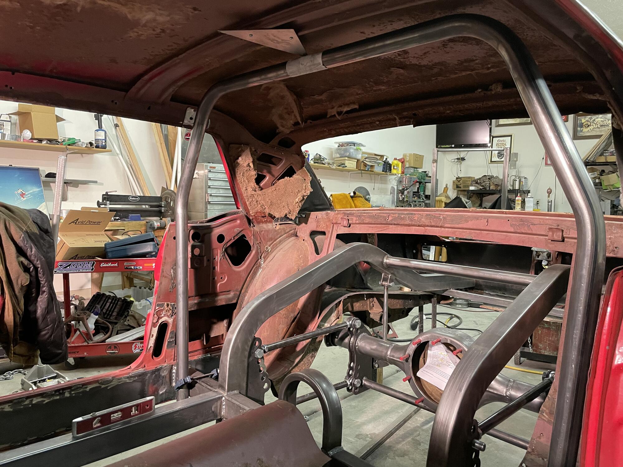

      I just need to figure out where all these tubes go. I can fit these up and get close but I can’t weld anything until I have the fastback roofline set. Name:  8BDF2F5C-2BCC-4808-9650-5E8BDFB76945.jpg

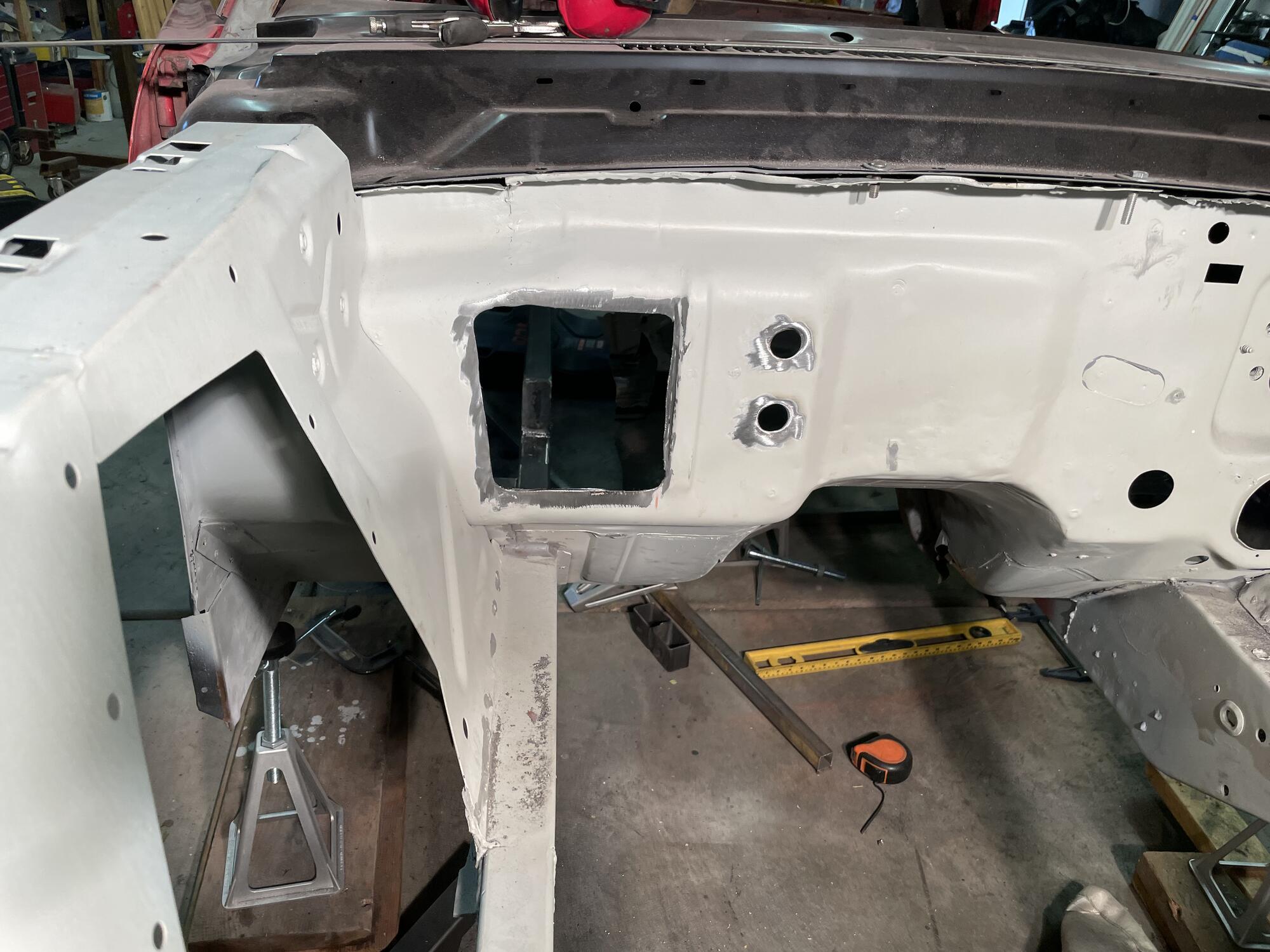

      I spent some time smoothing out some more of the firewall today. I’ll probably stop there since you really won’t be able to see it once the engine is in.

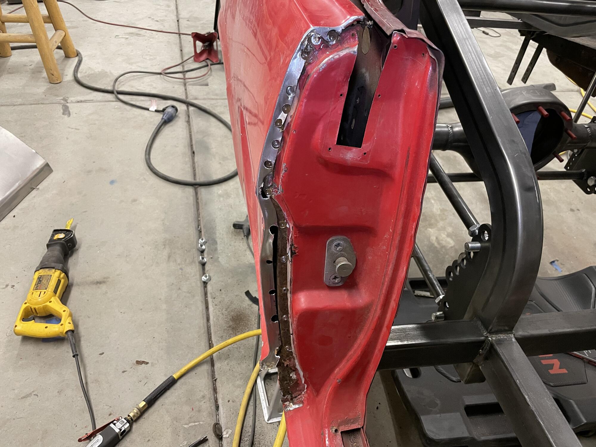

      I started removing the sheet metal. Didn’t get too far. Drilling out those spot weld sure is time consuming.

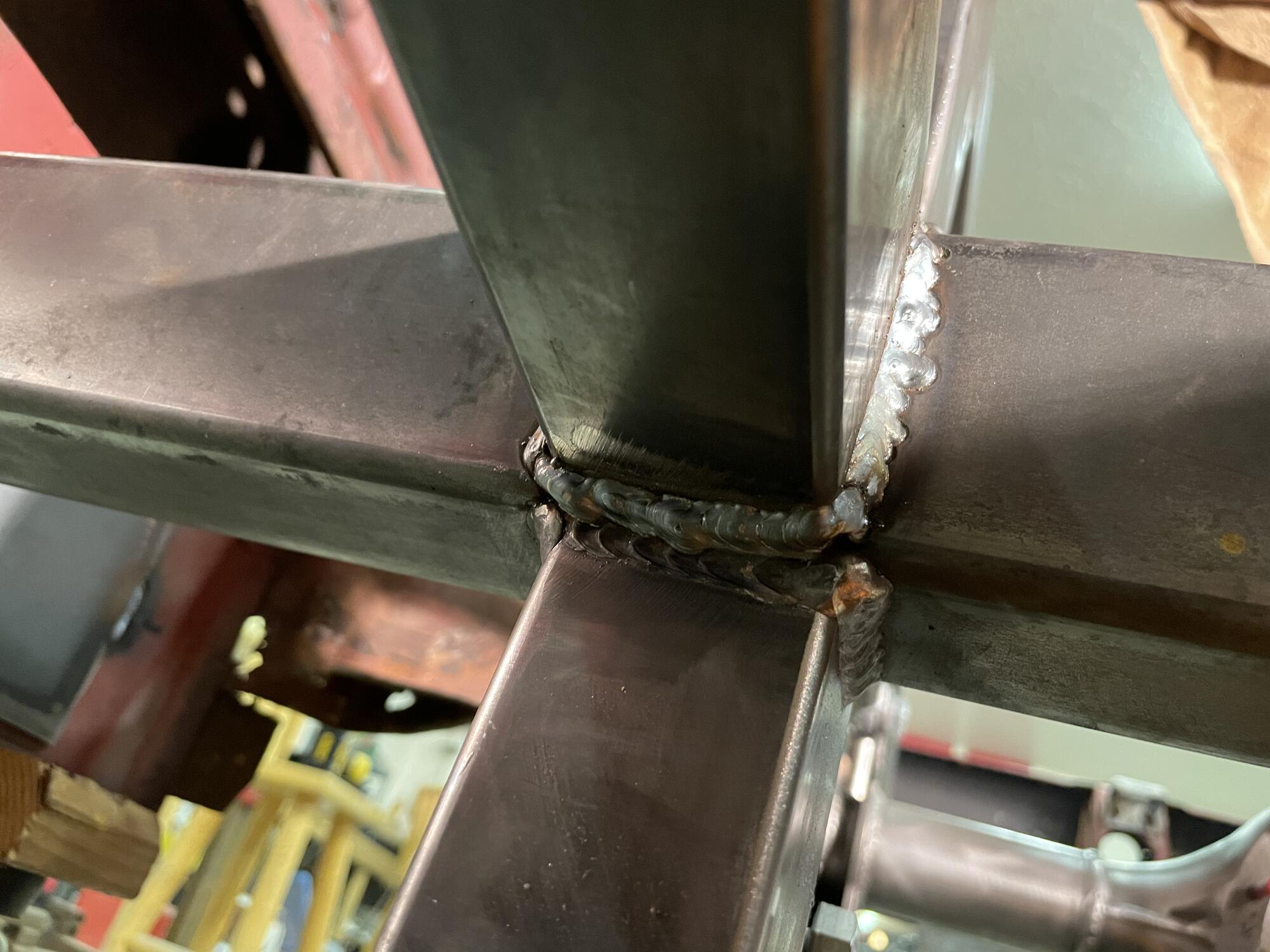

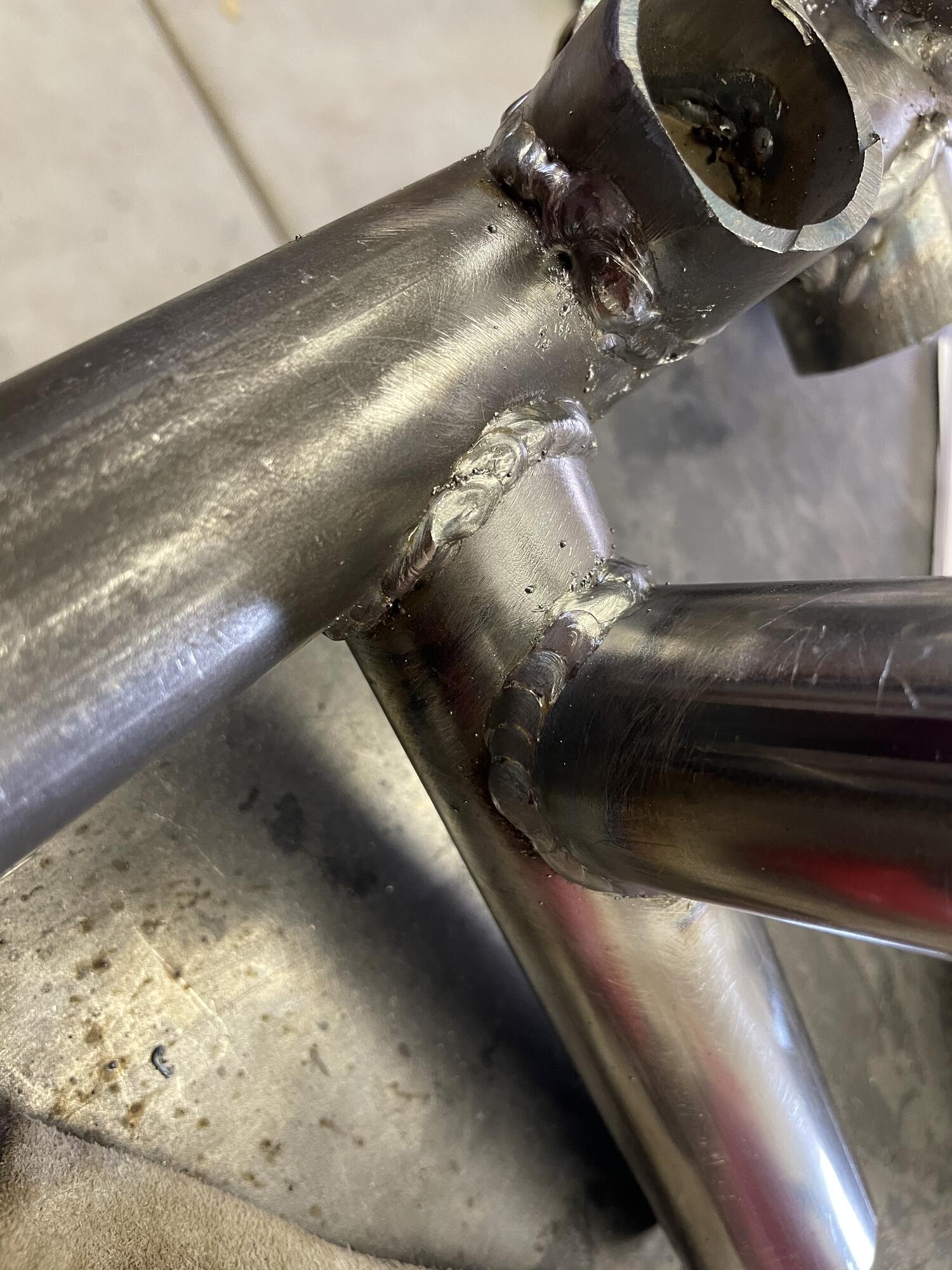

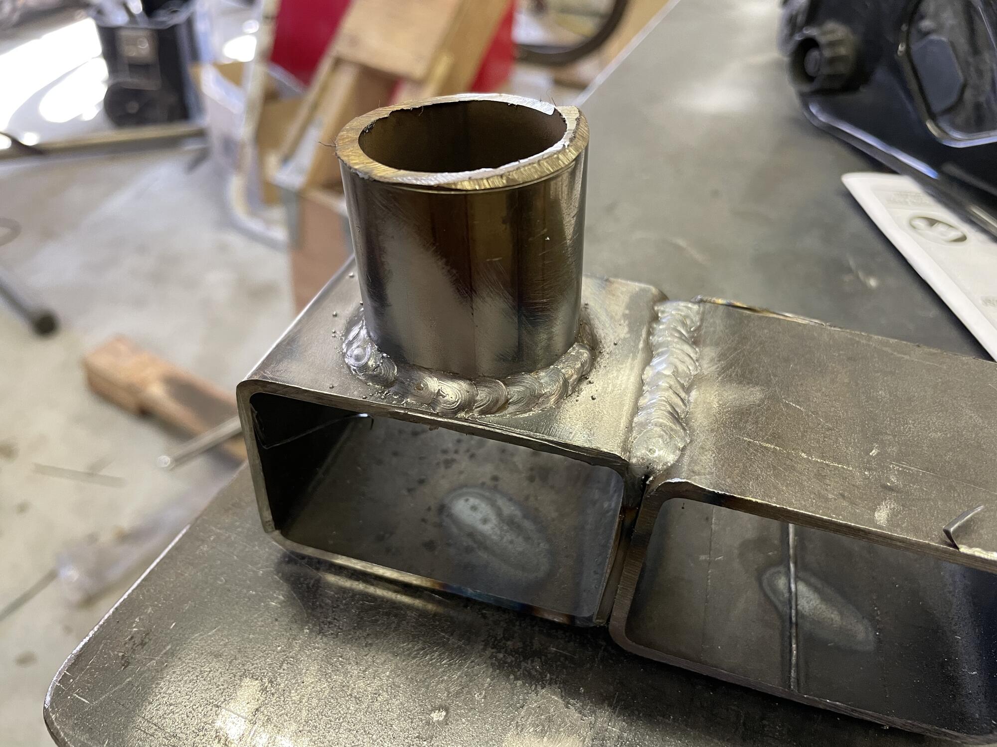

      I got in some practice welding tubes for the upcoming roll cage installation.
Size:  350.3 KBName:  2BC1E331-DF67-429C-8891-AF442B5339E6.jpg

      Looks great, awesome build. Myself I'd crank up the heat a bit on the welder.

      Thanks, I’ll give it a shot. Those tubes are plenty thick and it cold in the shop these days.

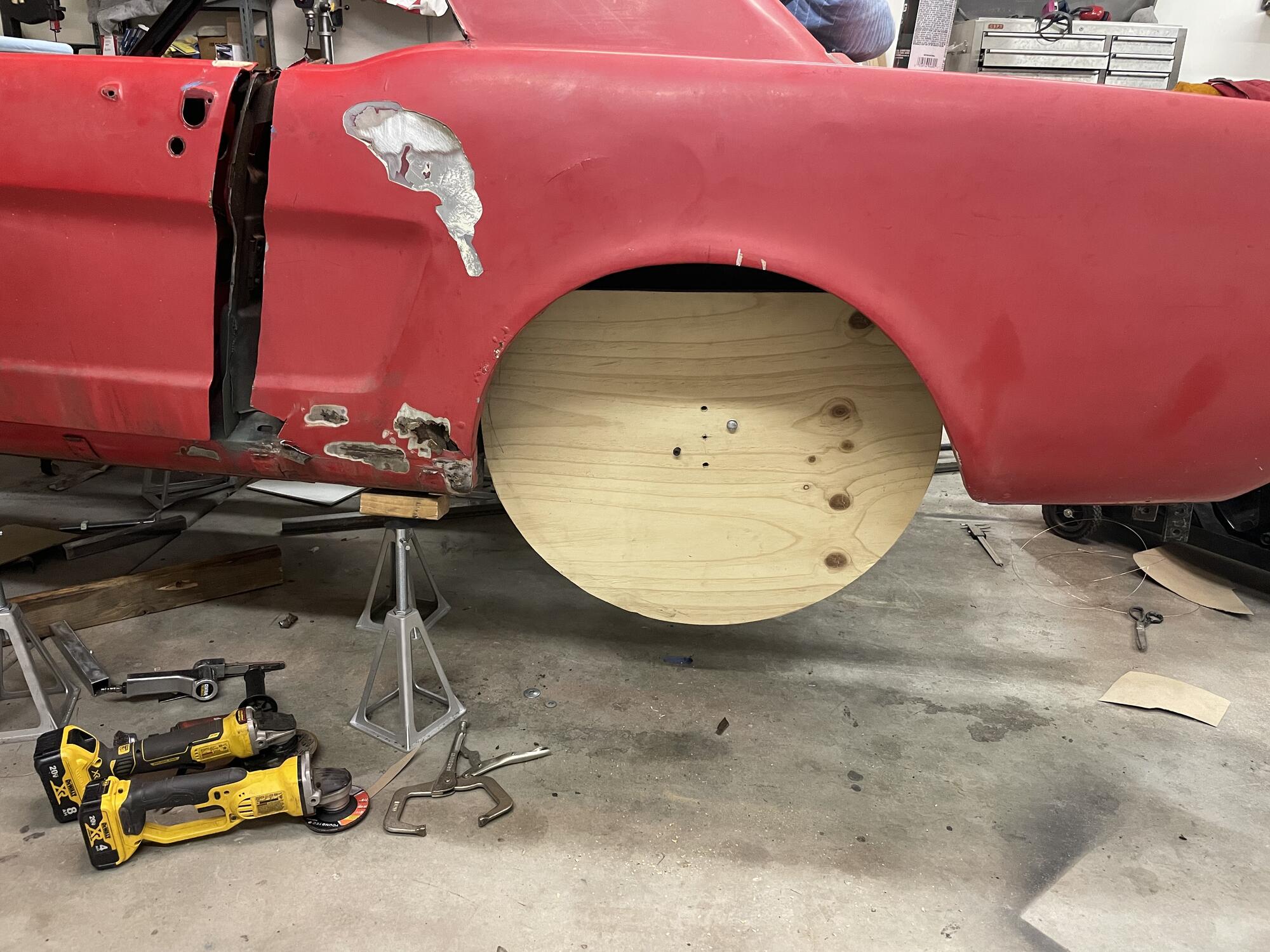

      I discovered why I was having so much trouble fitting the cage into the car- I ordered the wrong cage. I had a 94 Mustang cage which is significantly smaller than the first gen and wasn’t working at all. So, I packed it up and shipped it back in hopes of getting the right one this time.
      In the meantime, I decided to preview the tire size I intend to use so I cut out some plywood circles and “mounted” them to take a look. They don’t fit and I can’t set it on the ground until I cut away the rest of the trunk supports and wheel wells.
Size:  360.6 KBName:  AA1FA683-185B-45BC-8A44-6E52CACB13D1.jpg

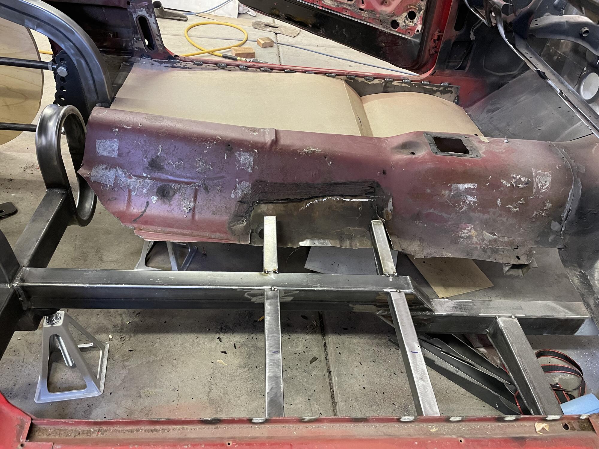

      I built and tacked in the seat supports and then made some cardboard floors. Mocked up a concept for the rear in place of backseats.

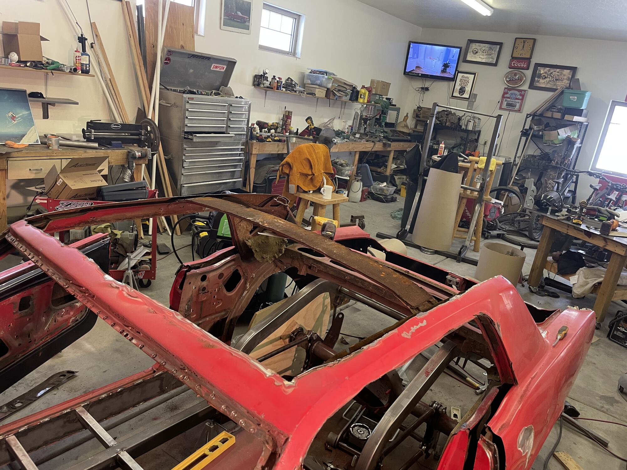

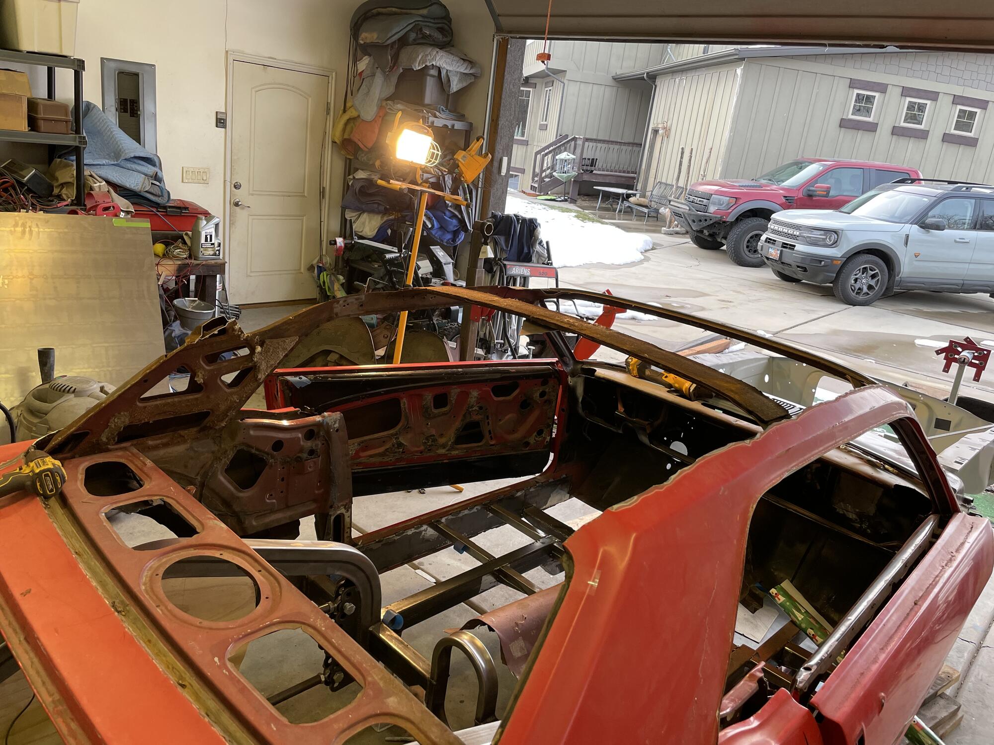

      I turned it into a convertible on the way to becoming a fastback. Name:  0FEB315E-4F99-429C-9FC9-8BA944B85867.jpg
Size:  471.7 KBName:  1C150812-B36E-4F33-8151-CD4E3B9A84F0.jpg

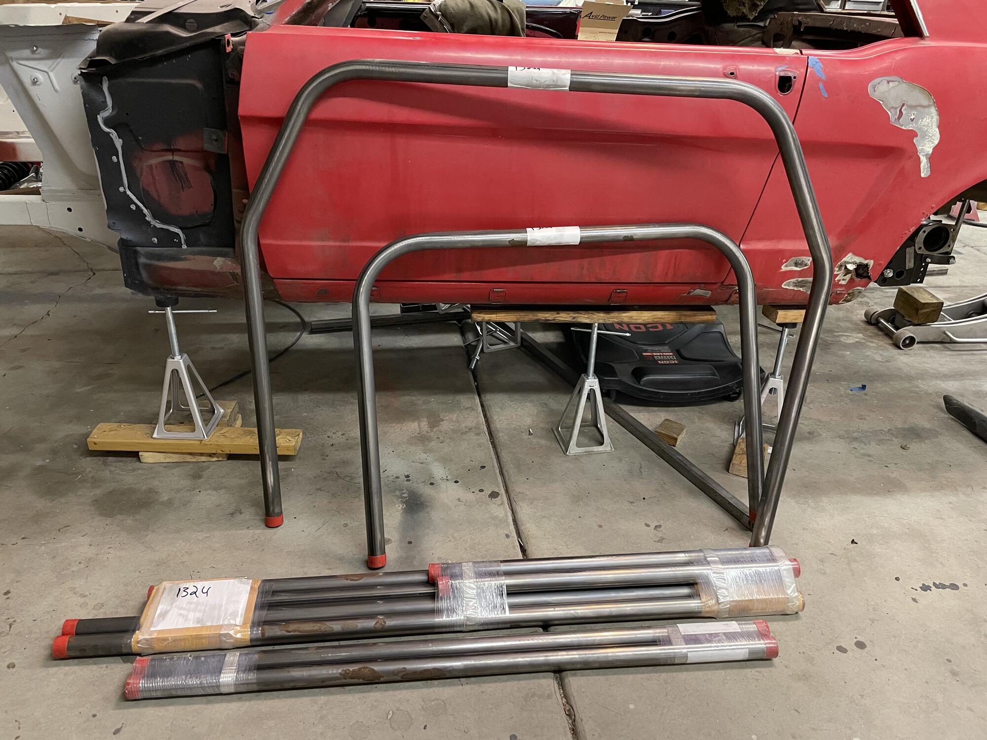

      Jun 2017
      Utah
      240

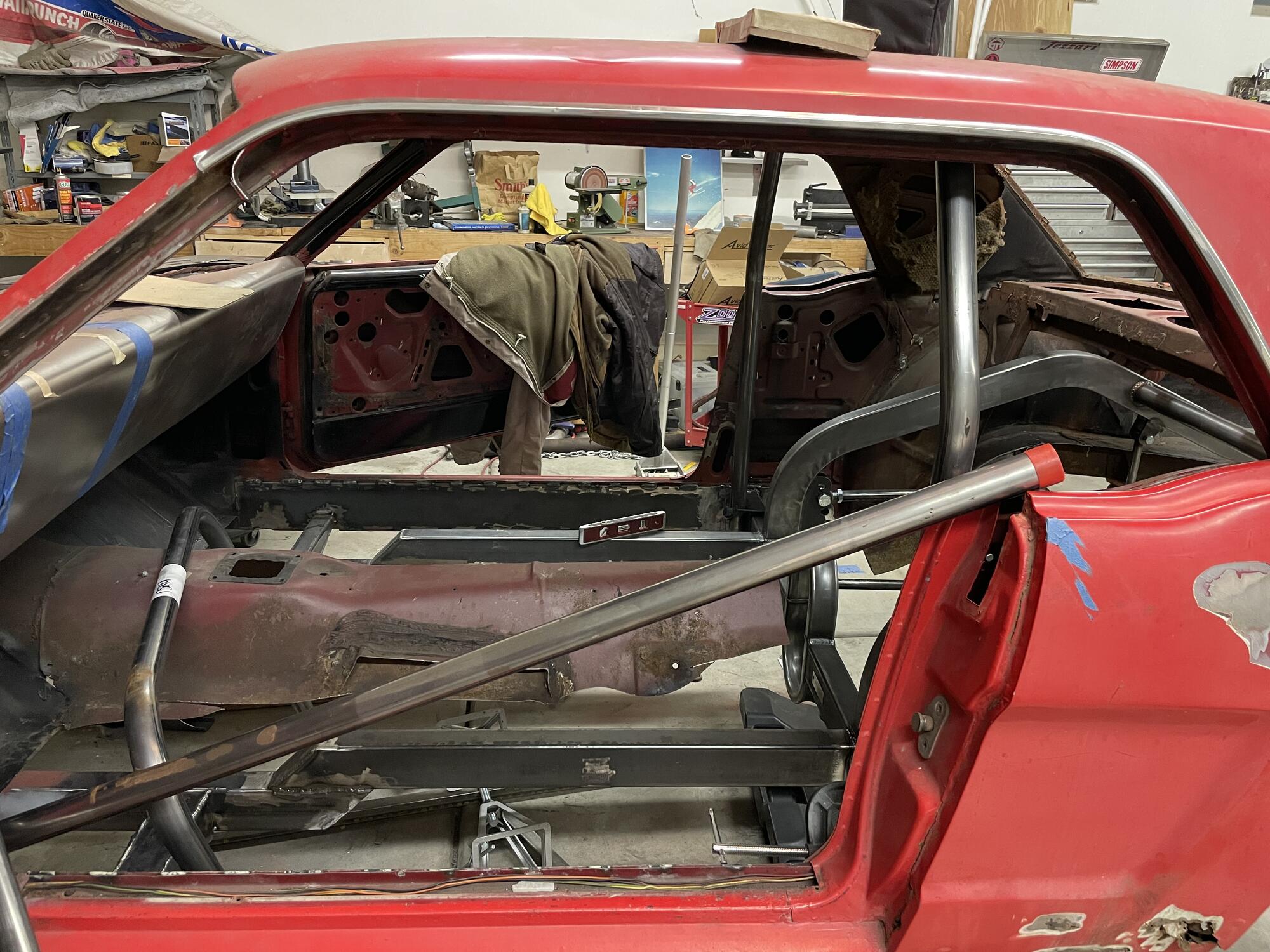

      The new roll bar showed up today. Let’s hope I ordered the right one this time. ��Name:  78D02FFF-A9F8-4419-8F05-165B113A602B.jpg
