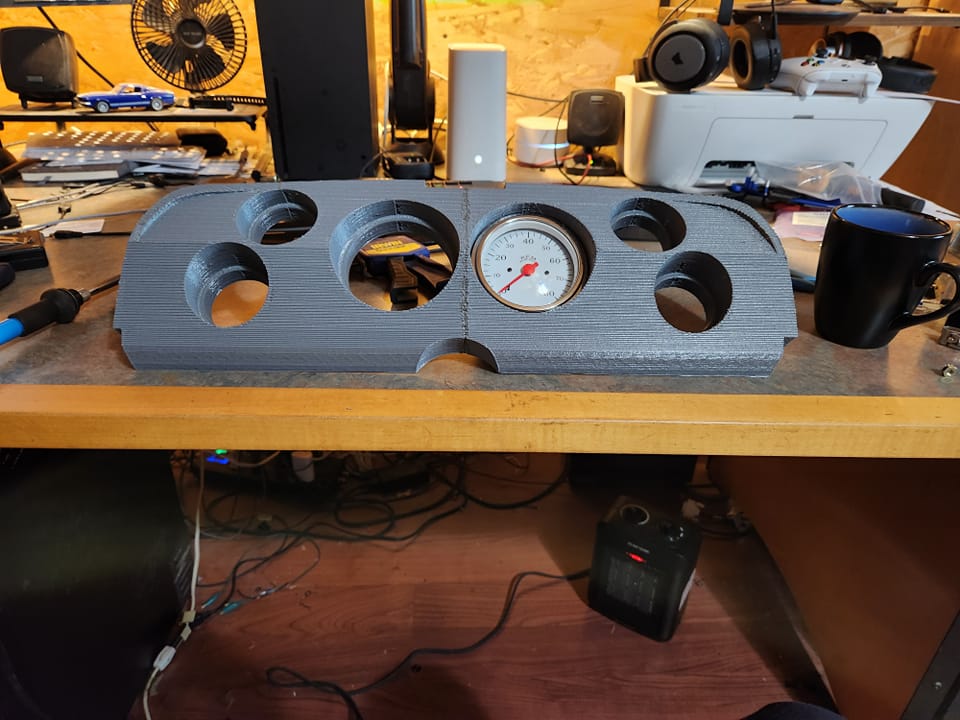

      Well ive been BUSY!!!! My Chinese gauges were a very custom fit and since the TACH wouldnt work, i ordered a VEETHREE Tach, that I know would but it wouldnt fit in my cluster..... So I just printed my different design cluster made for a more standard size Gauge setup

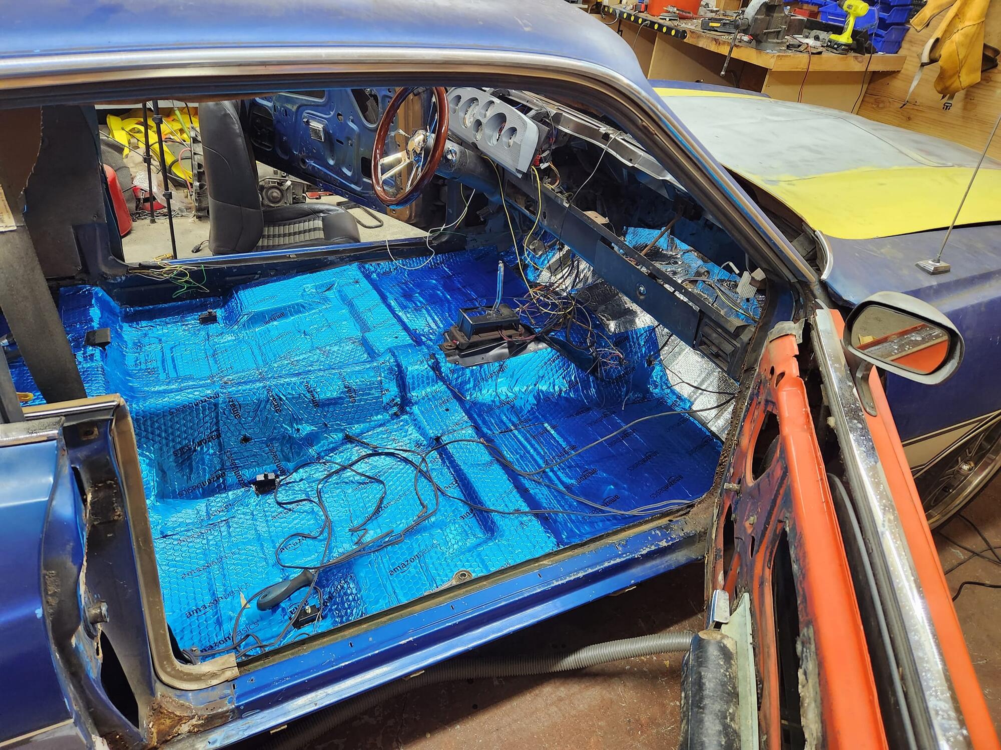

      I put some sound deadener in, installed carpet from a 68 mustang i had laying around, and mounted the GT 500 seats and center console

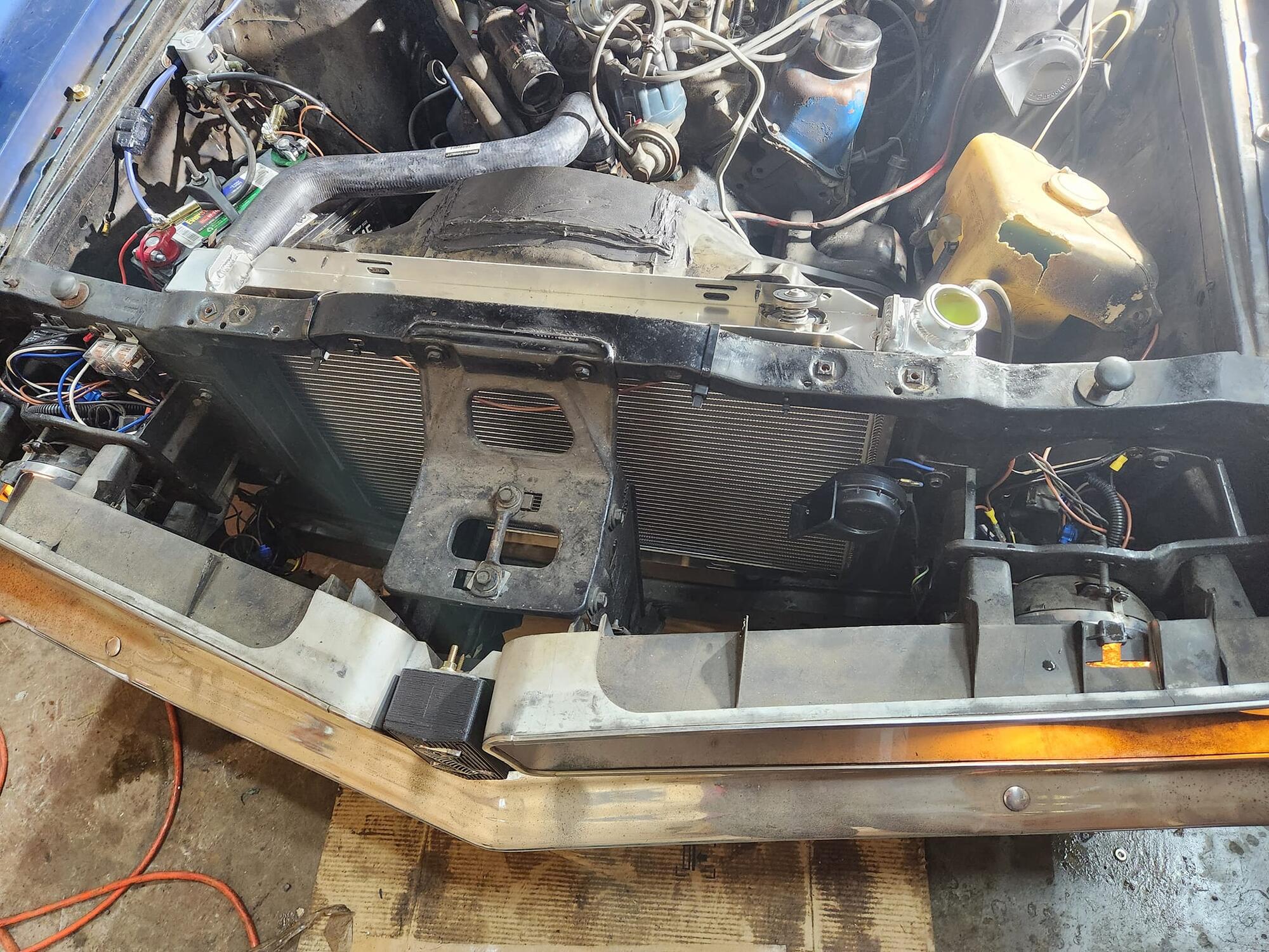

      I also Managed to get the whole front end put on and my Custom Center Emblem with Cobra. The Mounting box is 3d Printed to hold the emblem

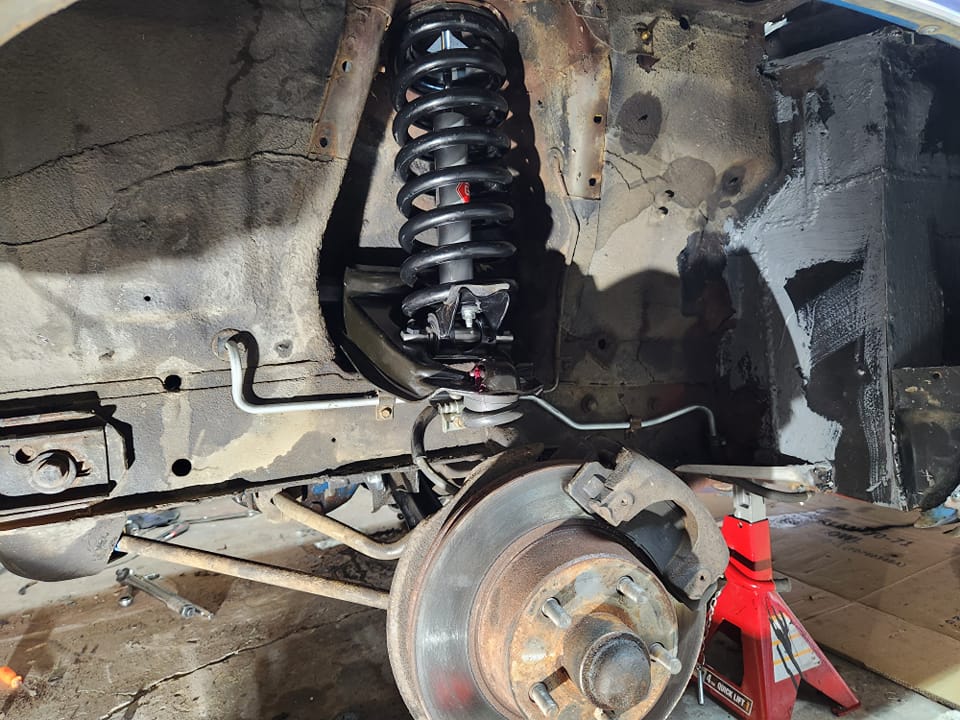

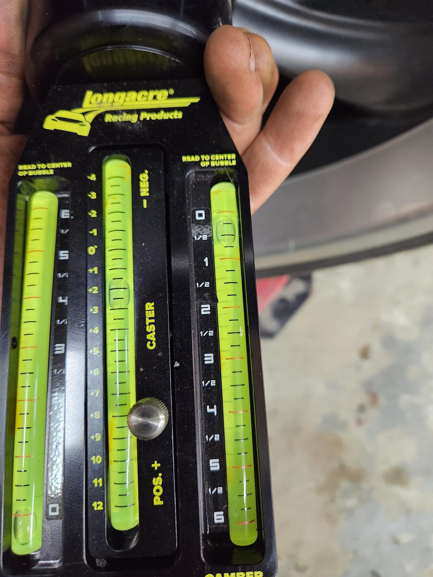

      Full font suspension in minus the new sway bar bushings and end links i should get in tonight.
      Got dialed in my Caster and Camber To -.25 ish degrees camber and 2 - 2.5 ish caster.
      So basically New:
      Moog UCAs
      Moog LCAs
      Grab a Track 1" 620 Lowering Springs
      Moog LCA Caster/Camber Bolts
      KYB KG4505 Gas-a-Just Gas Shock

      Nice. How do you like the Longacre alignment tool? Was looking at picking the same one up.

      Quote Originally Posted by chunger View Post
      Has always worked well.
      I wanted more caster And really didn't have enough room to dial it in further at home so
      Took it to the shop and got it all aligned. Took 2+ Hours but they did it
      Toe: .30 and .32
      Camber -.19 and -.24
      Caster 3.45 and 3.49
      Holds the road nice and straight

      Great work on the project, so glad that you are out driving it! I like that alignment tool, I've been looking at picking one up too go get me in the ballpark. I'm curious how close your alignment was to what the machine read off the street?
    18. #58
      Nov 2017
      129
      Quote Originally Posted by ryeguy2006a View Post
      It wasnt because i tried to adjust it again and could never get it back close. I also was being lazy and never set the TOE so i was fighting myself and getting frustrated with the lack of room i had while working.
      However, ive used it to dial in suspensions in the past and it worked great. Just wasnt this time
