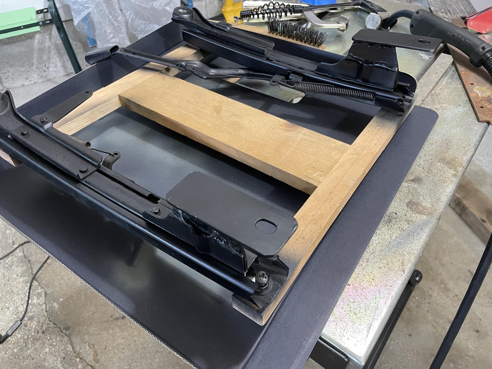

      With some minor cutting, drilling and a little welding, I retrofitted 2000 Pontiac Trans Am seats in my 69 Camaro. Drivers side only required cutting off excess metal and drilling two new rear holes to line up with original rear seat mounts. The fronts align perfectly. Passenger side I had to cut off the rear “shoe” section and fabricate a new shoe. Fairly simple welding work needed for the rear, fronts line up perfectly. Don’t know about C4 seats but these seats are extremely supportive and very comfortable AFAIC. The 6-way power and power lumbar are a bonus. Here’s some pix… I built a wooden buck to help position the seat rails and once I cut the old shoes off, I corrected the new ones so that the rails were leveled fore/aft and side to side. My welding is deplorably ugly but I have good penetration on both sides of the new & old upright sections. Made cardboard patterns to make sure everything lined up before making the metal “T” sections.

      Quality work there!!
      Thanks i will probably do the same. I have some Chrysler Sebring seats I want to put in a 1971 Chevelle. They seem a bit off if I match up the center holes to the original so I was going to fab up an adapter but before I started bending metal I was thinking of doing a Template of some type. So this "wooden buck" is a great idea so i can do it outside the Car.

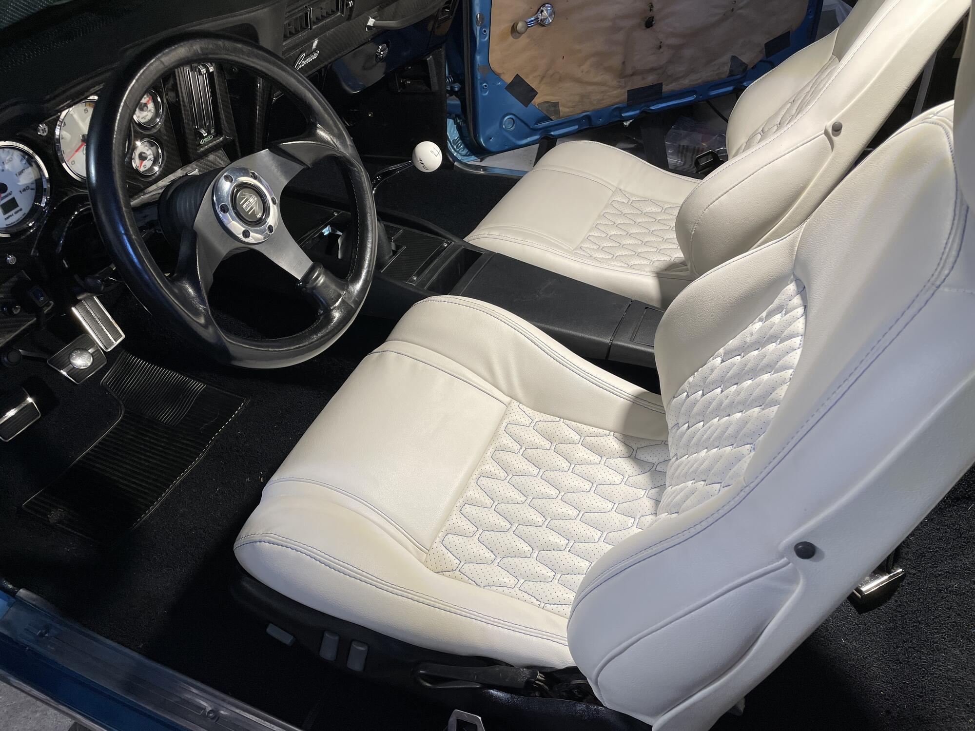

      I put 2018 mustang seats in my 68 camaro convertible, I made a template of the original floor with a metal frame, then made L shaped brackets and welded them to the mustang seat frame and used the original holes in the camaro floor to mount them, worked great, all electric is hooked up to them
