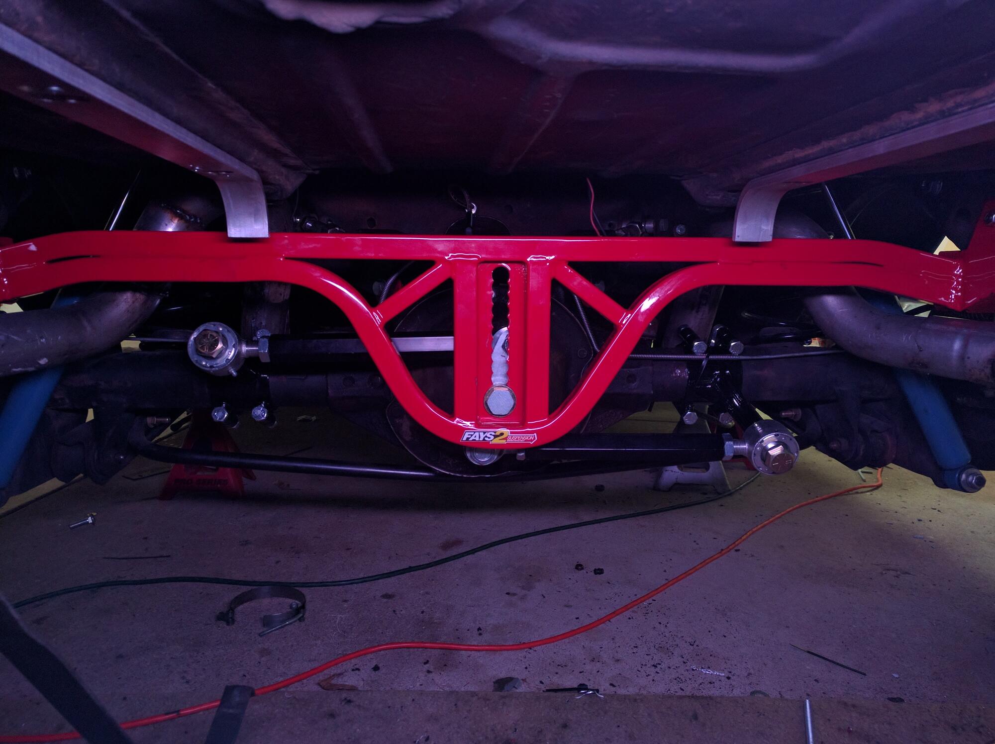

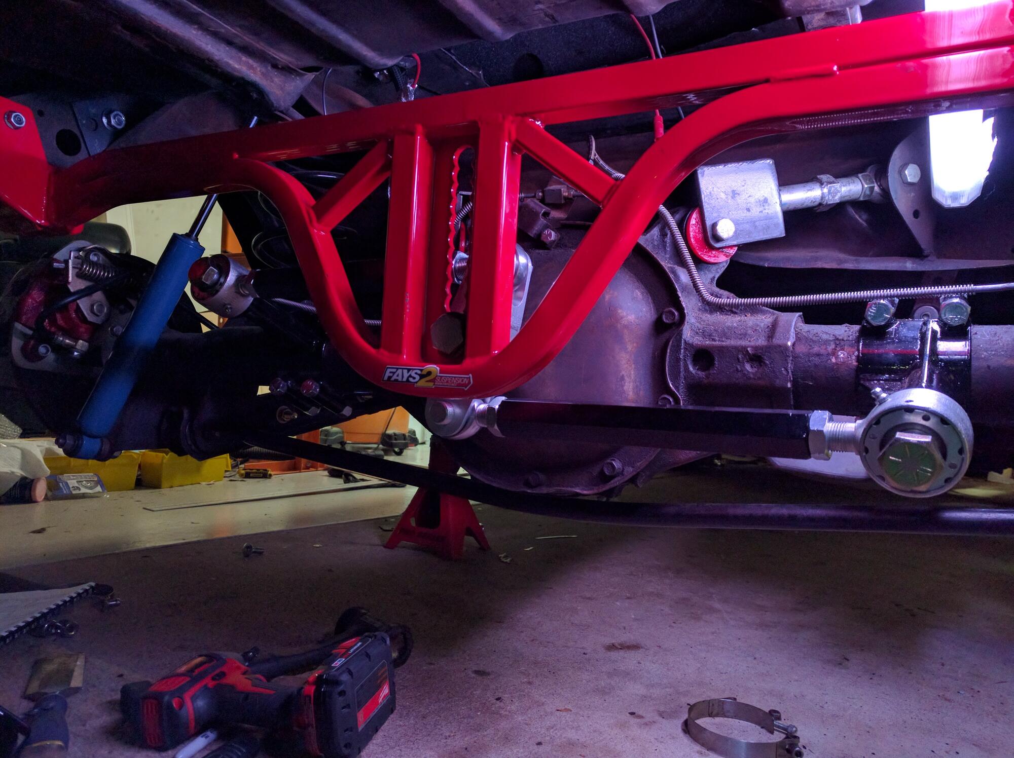

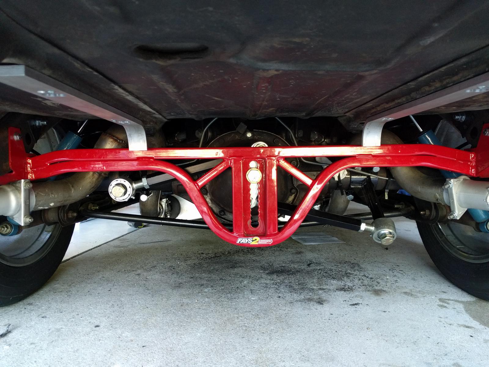

      I’ve been meaning to do a write up on my custom 3 link for a while now. I’ve also had a hard time PM’ing the450r, so I figured now was a good time to post hoping he’ll see it.
      I’ll break up into a few posts and am happy to answer any questions. I'm not an expert, but I've eaten enough Waffle House to know what's up.
      I had never had any plans of making a custom rear end. I just wanted my tires to stop rubbing. A watts link at a minimum promised to stop the 10 bolt from migrating side to side. mine moved ¾’’ each side. The big conflict I found online was the issue of having two roll centers. The location the upper arms converge from a side angle defines a “virtual” roll center, and the watts link defines a “physical” roll center(it's an actual bolt). The argument is these conflict with each other and it's a terrible idea to do this. The main argument saying it's okay is that the Watts link forces the UCA's have compliance due to rubber bushings.
      I read everything Ron Sutton posted on the subject, read Savitke’s book and also talked to him at length. That doesn’t make me an expert by far, but it gave me enough info to start making my own decisions and I ordered up the FAYS2Watts to start my learning curve.
      When I started, the setup in the rear was:
      • BOP 10 bolt with 3:23 and factory posi.
      • Adjustable upper arms.
      • Factory boxed lower control arms.
      • Varishock SS(non adjustable) with AFCO 175lb(I think) springs, lowered
      • 28.5’’ tall 295/45/R18 NT05’s. ’69 olds have a large circular arch for a wheel opening that in my opinion need a tall tire to fill it out properly, otherwise I’d run less sidewall for sure.
      Benefits of a Watts link on a triangulated 4 link.
      1. Rollcenter adjustment within a decent rage will allow you to change under/oversteer.
      2. Stops all lateral axle migration
        1. This stops tire rubbing for the most part(expect sidewall flex)
        2. It also means when you dive into a corner, the rear no longer bounces side to side several times making for a very unpredictable corner, it just hunkers down just like the front and stays there.
      3. I found the FAYS2Watts to be excellent construction, well fitting and the range of adjustment has suited my car perfect. If you’re an experienced fabricator, you can probly make your own, but for me..this was everything I hoped for and have no plans to change it.
      Cons of a Watts link on a triangulated 4 link
      1. If your car needs the watts roll center near the very bottom adjustment, it WILL bind in a corner and the resulting snap back is very unpleasant. For my setup, this only occurred in the bottom slot(where I never run because it is extreme understaeer), but I am also running a taller tire than most a bodies just due to visuals. The more flexible you can make the rear uppers the less bind you will have…think stock rubber bushings on both sides. You don’t need stiff poly anymore to control lateral movement…just let it squish.
      In short: the physical RC of the roll center overrides the virtual RC on the UCA’s…up until the UCA’s rubber can no longer squish. At that point, they bind, and when they unbind the rear end becomes an unpredictable handful.
      1. My stock frame has been abused for 50 years,and I had to push my rails apart about 3/8’th for the FAYS2Watts to slot in.
      2. You need to relocate the gas tank. I liked seeing the red frame exposed so eventually I just moved to a fuel cell(don't judge me lol).
      I probably street drove it for a year with the new Watts. I LOVED it. It was an entirely different car. I had no idea how unpredictable the rear end shuffle affected the car going into a corner. But now that it was gone(along with my tire rubbing) I noticed how good the upgrades to the front of the car had made it. I also loved that I could leave the setting a bit high on the street and have a ton of fun with an easy-to-oversteer car. If I wanted more grip in the rear..just drop it one or two notches. Unfortunately, while digging into the watts theory I didn’t realize I had jumped head first into the rabbit hole. Now that my car was stable and predictable, what else could I do to improve it?

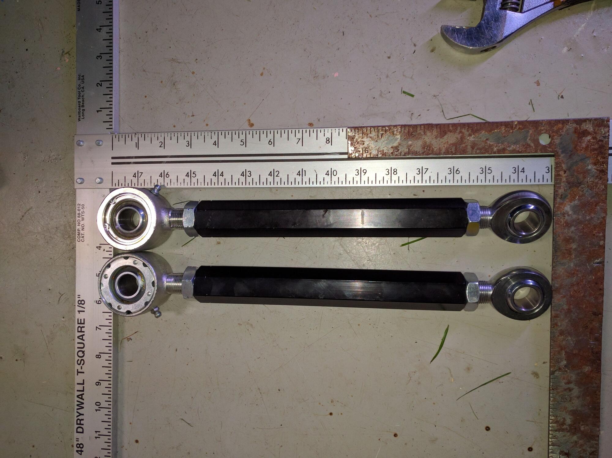

      Watts Setup thoughts.
      The arms do not have to be horizontal.
      They HAVE to be the same length and the same ANGLE. On initial setup, rotating the axle mounts so that the arms are horizontal makes it easy and in my case, packaged best.
      To get the same length, I made a quick jig out of 2x4s. It's not hard, but it's important. Any difference in length will result in deformation and ultimately binding. Again, not hard, but I used the jig because the tape measure just wasn't getting me what I needed.
      Once it's setup with equal length arms, and both are horizontal, you are good to go. Moving the bellcrank pivot bolt up or down will make the arms not parallel, and that is totally fine. They will have equal angles and that is all that matters.
