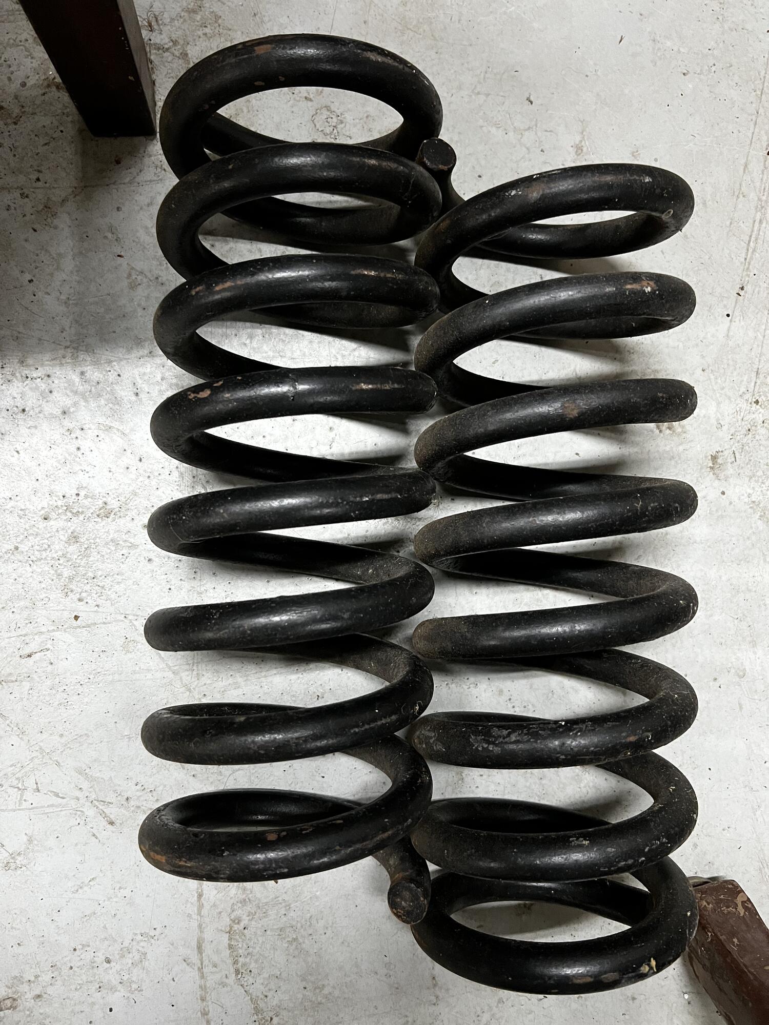

      Jay, had this info last night and forgot to post it,
      OD 5"
      Length- from the flat pigtail to the other pigtail is 15"
      Right what you looking foName:  F04E8E21-073F-4611-A522-038BDECDCE8A.jpg

      Quote Originally Posted by Steve68 View Post
      OD 5"
      Steve, awesome man thanks. These are for sure the Guldstrand springs?? I feel like an imbecile- how do I PM you on here? This is my first time actually doing something on any forum- I know, this day and age and I don't know how to do this...
