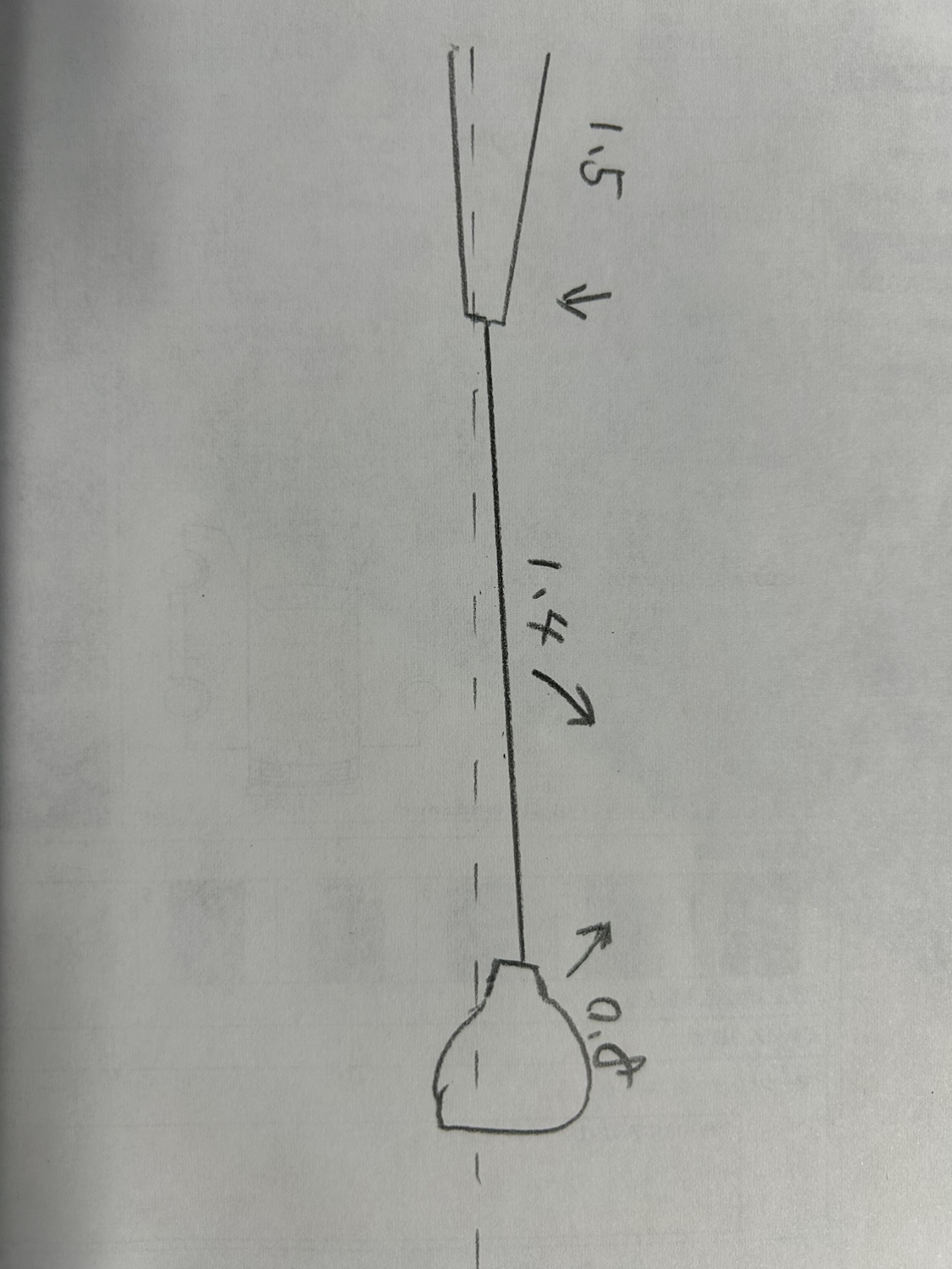

      I processed the tunnel and raised the engine and transmission. The pinion is above the transformer. "Is the angle correct?"
      Engine 1.5↓
      shaft 1.4↑
      pinion 0.8↑
