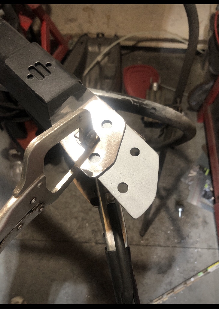

      So because the speedtech subframe has narrower frame rails for clearance and cut at a downward angle i had to fab up some plates to lengthen the sfc’s and weld them to the connectors. Since my frame was gloss black and the connectos come matte i was gonna powder coat them anyway.
      Im not too sure on the dse dimensions but the rear of the frame looks to be stock dimensionsName:  IMG_8612.JPG

      ridetech would only know the dims of the OE subframe, not the DSE or Speedtech, unless that was part of the design scope, which it rarely is as there are too many options to mail everything down.
