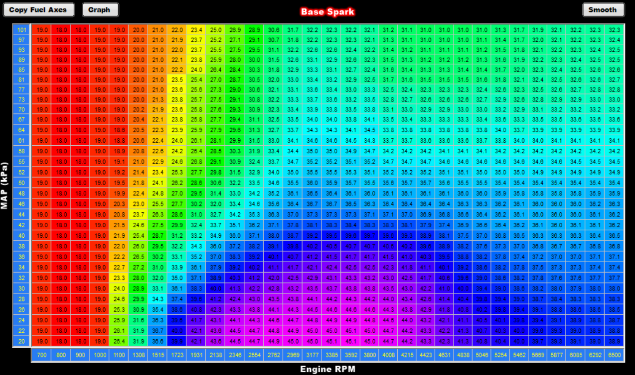

      Your cruise timing seems a bit low. Each engine combo is different, on my small block Olds I have 18* at idle, low 40's at cruise, and around 34-35* WOT.
      This timing map was created before the last few tweaks to WOT were done, so they are still in a bit low here. If you're confident the cooling system is working properly, I would highly suggest having your Sniper professionally tuned. It really makes a big difference, andrewb70 is a member here and has great reviews on tuning Holley systems.
      Name:  Sniper Spark.PNG

      Thanks, I will try adding more timing at cruise. I'm not sure how to read the chart. Are those color temps?
