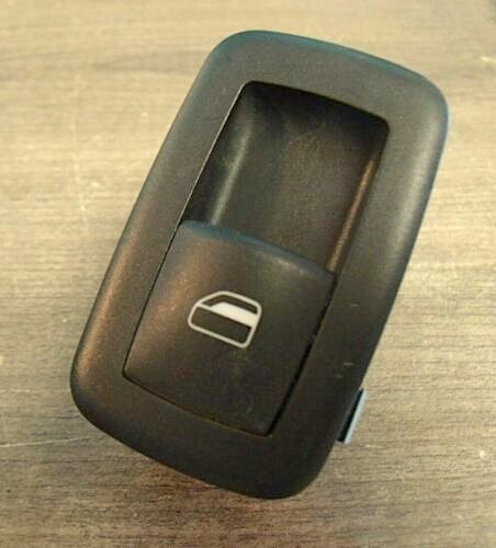

      2009-2012 Dodge Charger rear window switches are single style with a reversing pinout. Town & Country minivans have similar but slightly smaller switches if you like the style. The rear switches are a single gang style whereas the fronts are usually integrated with other functions (i.e. door locks, mirror controls, etc.). I bought a pair off eBay a few years back for like $10-12 and was planning to use them with DEI 535 window control modules in my '72 Olds 442 convertible project. I changed direction and decided to use some late 80's model, chrome switches which were more like the OEM switches that my car came with.
      Here's a pic of a Charger switch I swiped from eBay.

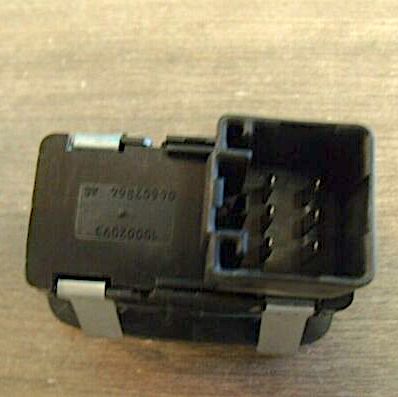

      Rodney, the charger switch looks perfect do you know what each pin does or how to wire them up?
      Apr 2018
      36
      Joe, here: http://connectors.dcctools.com/details.htm?id=63862
      pin 6 polarity input, pin 2 (down) and pin 3 (up) outputs.
