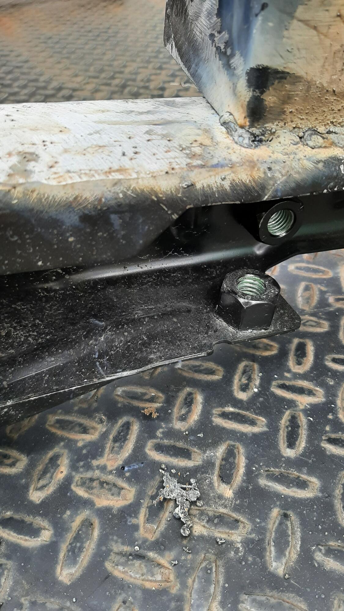

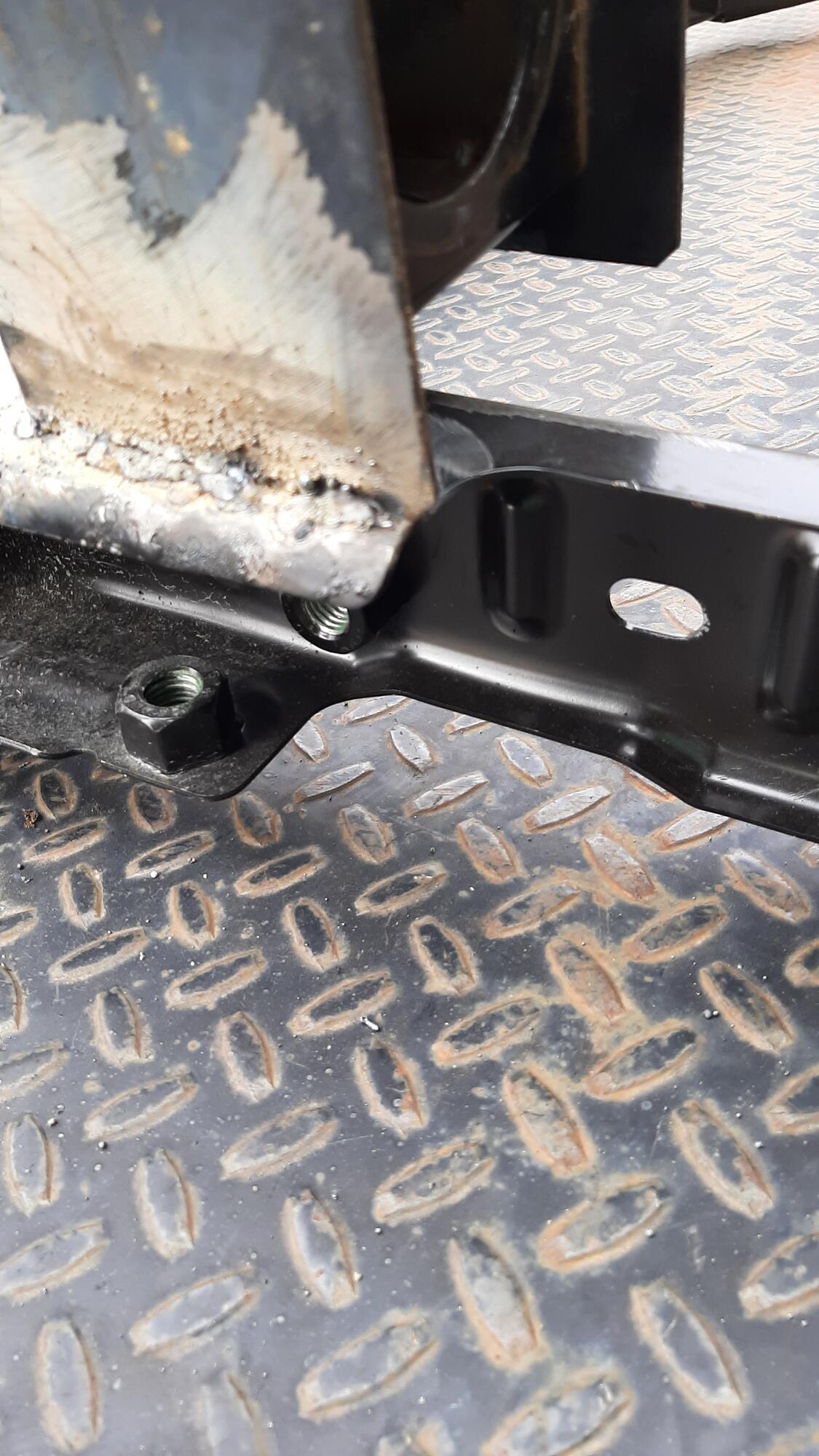

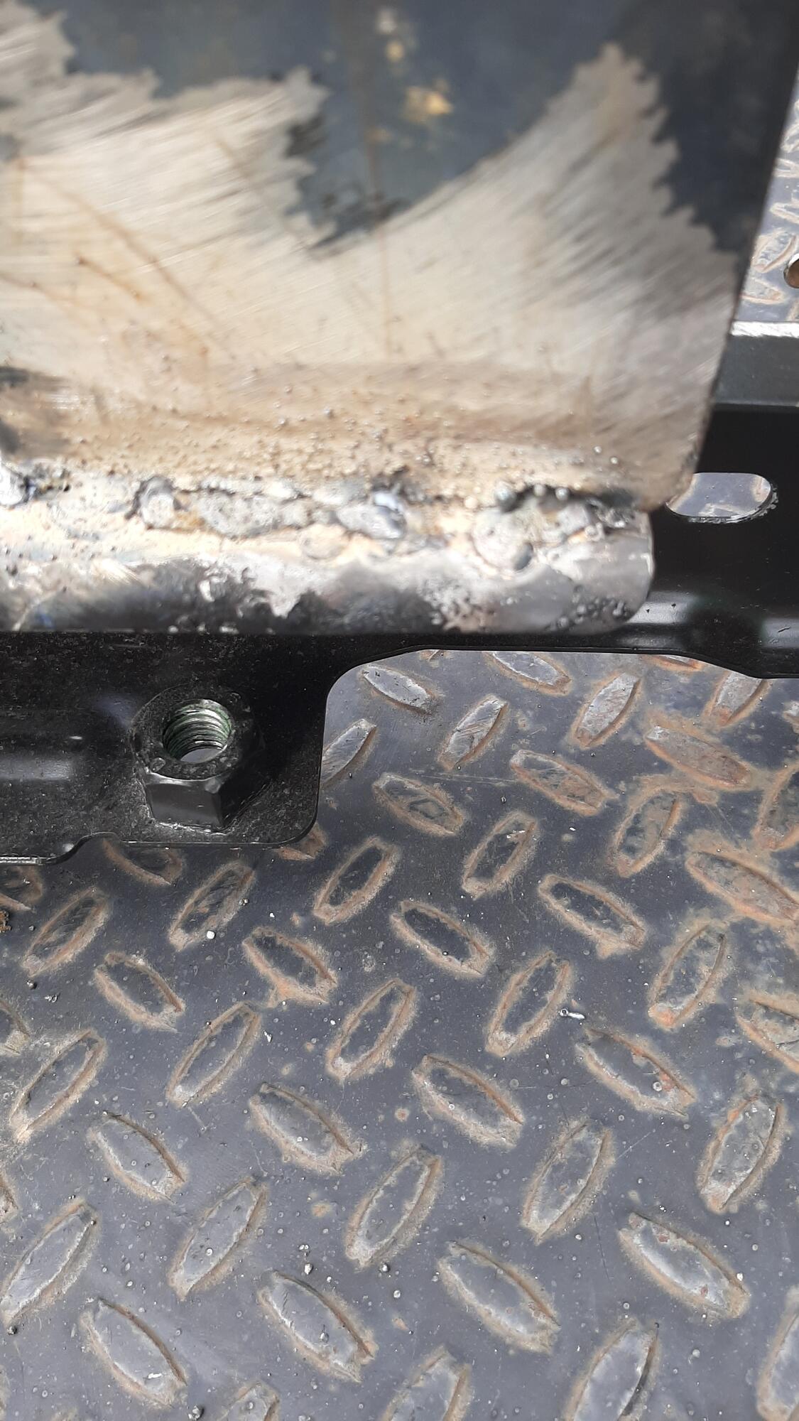

      Here are three pics showing my latest attempts. The initial ones I knocked the light housing off and ground both back down for a reattempt.

      That wire brush could be leaving behind all kinds of impurities. Something like a Roloc disc is likely a better choice to clean your metal.
      Welds look a little cold. Maybe turn up the heat.

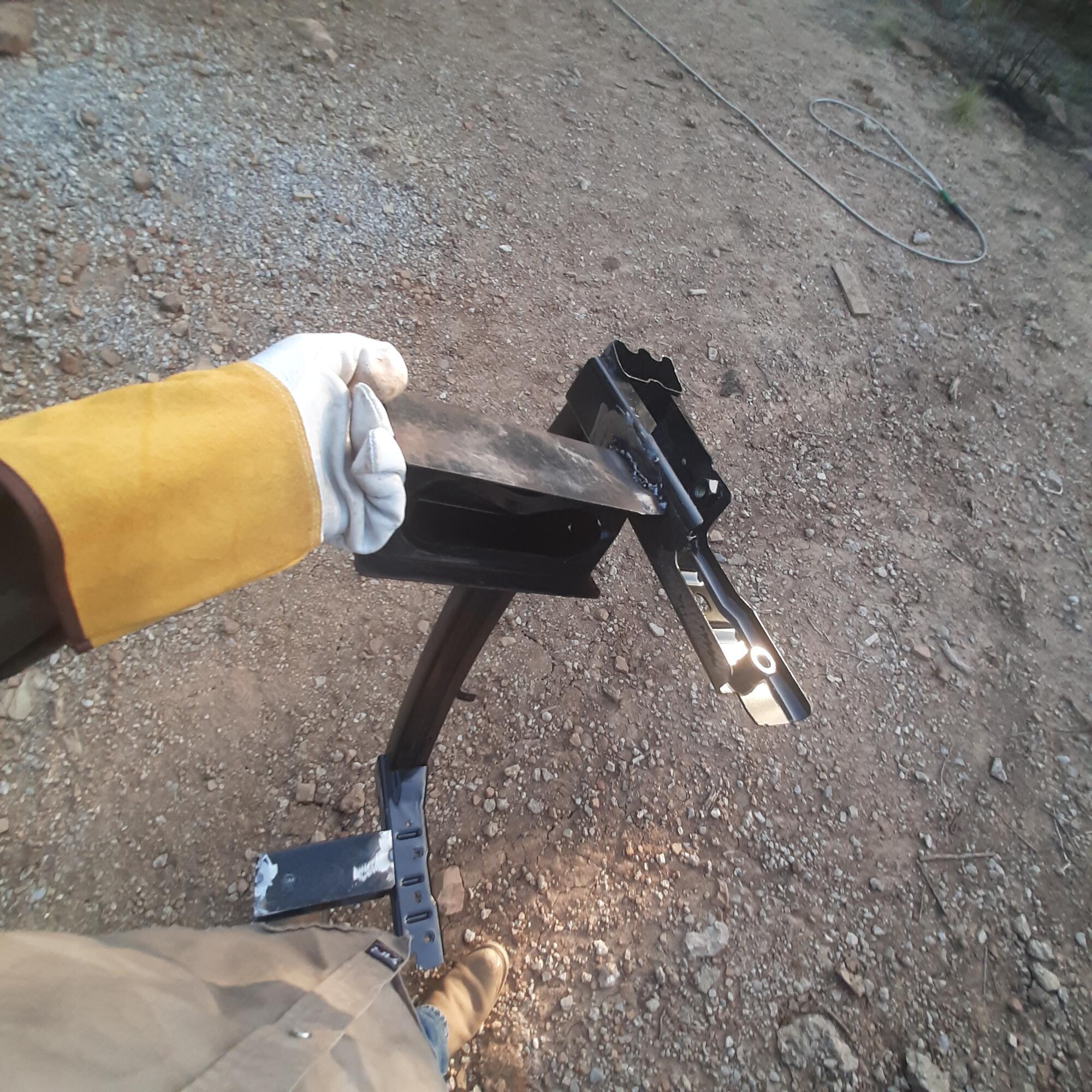

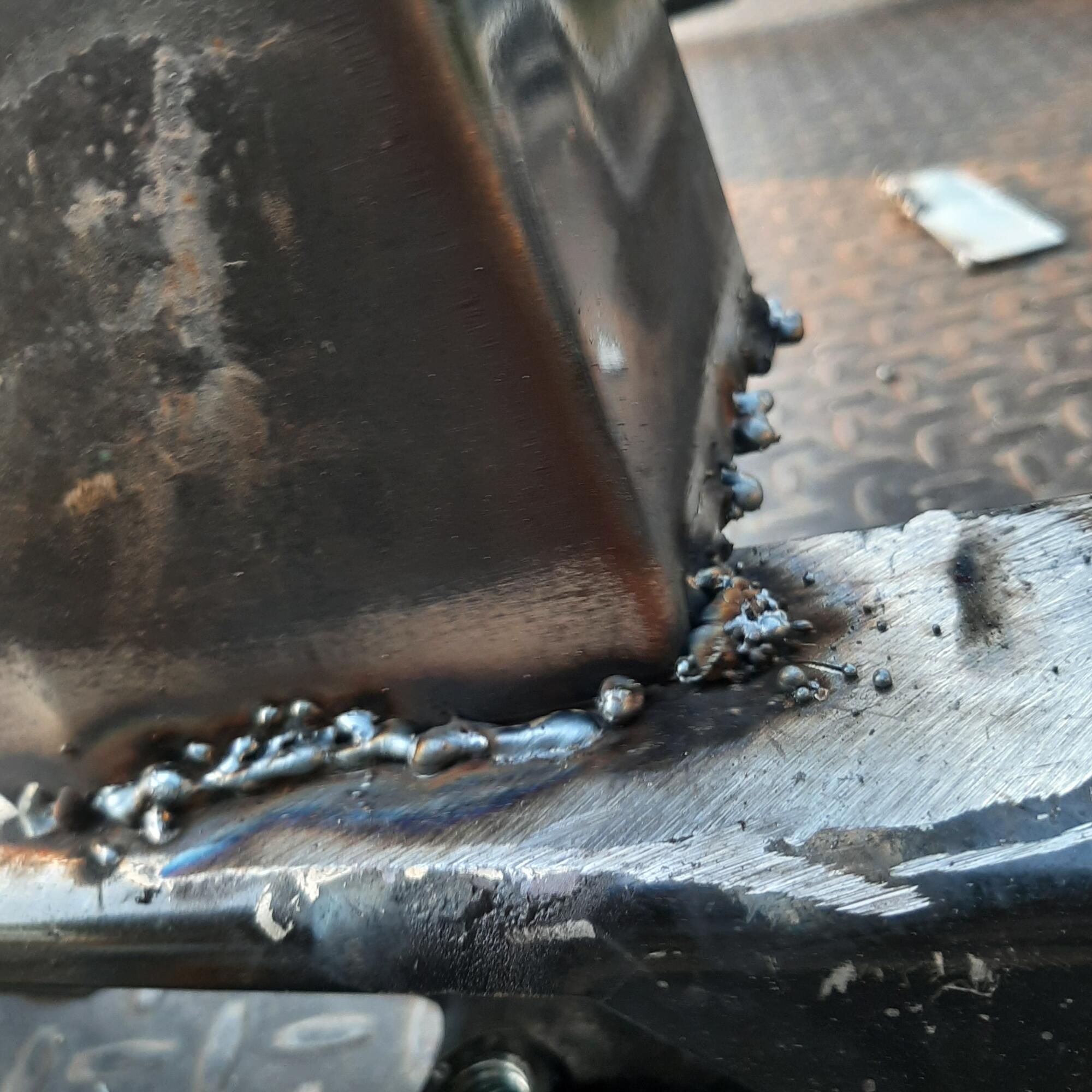

      Finally got back out to try welding today - and the gas and smaller wire helped a lot. I need more practice but the welds were stronger and looked a lot better. I initially had an issue misreading the chart and I set the welder up using 220V settings while using 110V, but once I realized what I was doing and set the machine up correctly I was getting puddling and penetration. The pictures suck, but I am holding a 30lb bumper by that little bit of weld and it didn't bend. I'm pretty happy with my progress so far although I still have a long ways to go before I can call myself a welder. I'm also working on getting 220V out there, just need to get some 4/2 solid core wire to run the plug where I want it.
      Ugly weld. This is only a single line on one side, not a 2-side weld. The weld down the side is really spatter, from when I was using the wrong setting, and isn't holding anything.
      Ugly weld held. This is suspended from my hand, not resting on the ground. I also had pretty good penetration as I gave it a few kicks (destructive testing) and it didn't want to let loose.

      Looks much better! Are you pushing or pulling when you are welding? I prefer to use the pull method when I'm mig welding since I feel it jumps around much less.
      Mountain Springs, Texas
      4,870
      Turn up the heat imho. Also watch some videos to learn how to sweep in an arc. Those welds are not ready for anything structural imho. Sorry to be harsh but this is safety.
      Maybe one of the experts will chime in.

      May 2010
      kitchener,Ontario,Canada
      2,358
      Get closer .. keep the tip about 1/2 ..3./4 away from the metal , move slower and more heat ... best of luck
