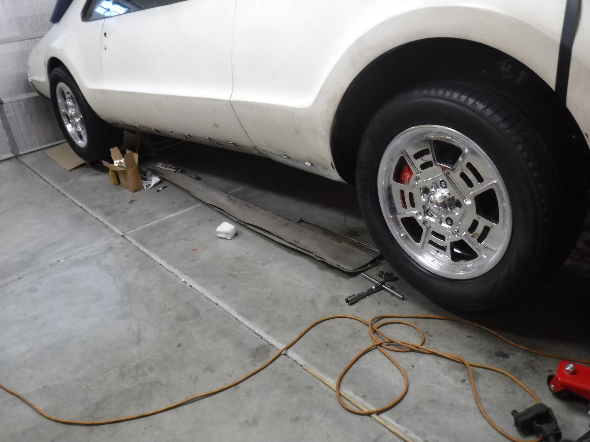

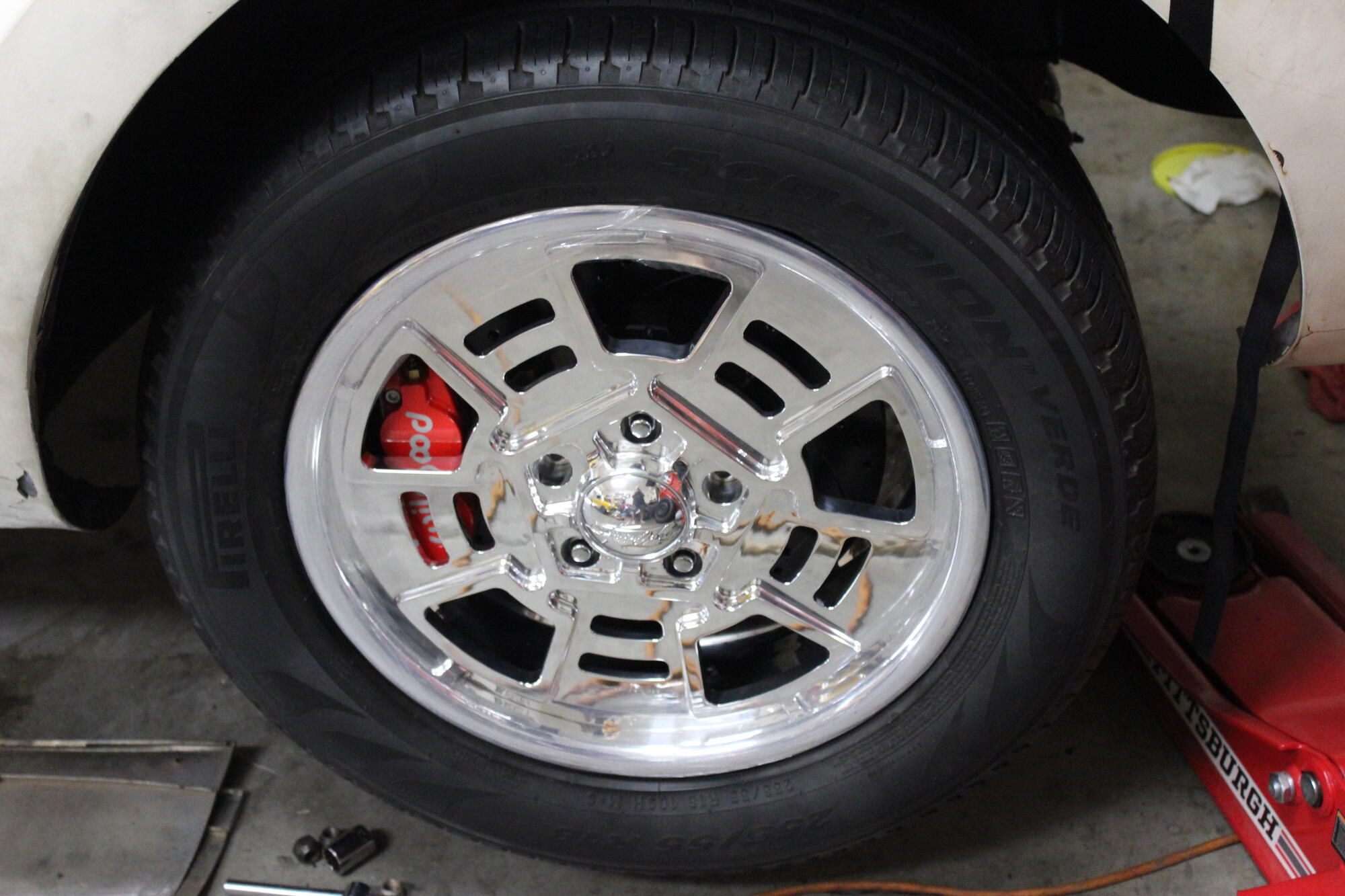

Size:  239.9 KB The front suspension and wheel, brake upgrades. Four wheel drums replaced with Wilwood 14" discs. The system is custom built by a local business, that can put great brakes on about anything.

      Nice - what else have you done to the car?

      More pictures and information please - Love those Toronados - really cool cars!

      May 2020
      3
      We're rebuilding the engine with Offenhauser aluminum heads, low profile aluminum intake (to clear the low hood line), electric cooling fan, Coddington wheels, Fuel tank from an Olds 98 to bump capacity from the original 19 to 26 gallons, although possible custom tank once all is done and I know exactly the space I have. The rear shocks, all four, are upgraded, installed a rear anti-sway bar, upgraded rear drum brakes, ditched the vacuum operated headlights for Honda Prelude/Accord electric lift motors.
