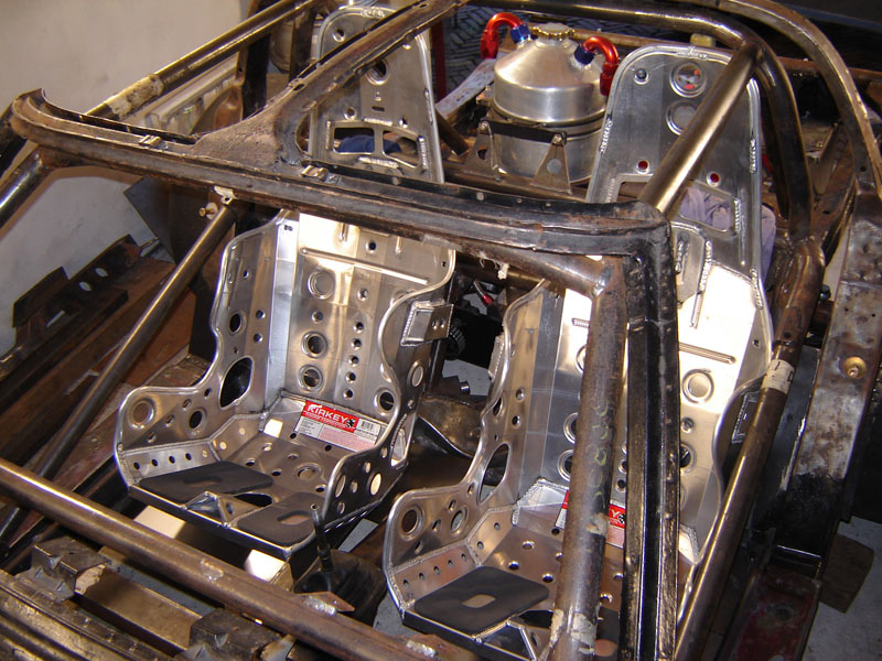

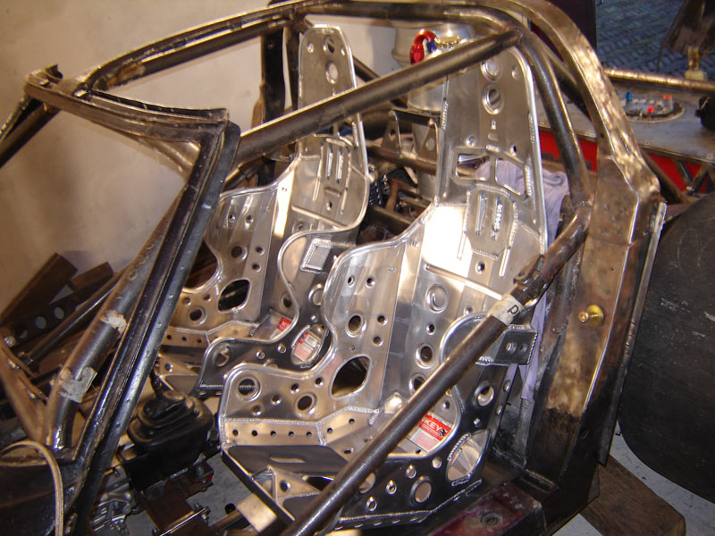

      I installed 2 kirkey ultra light layback seats today. They are very comfy but getting in and out is a lot more difficult. Not that big a problem for me, don't really are and the steering wheel is removable but still..

      Quote Originally Posted by Twin_Turbo
      In a crash I would be a little leery about those Kirkly seats because there is no upper body support; example shoulders or head. So the only this slowing you’re lateral acceleration in a side impact crash is your ribs.
      I’m surprised that no one has mentioned Racetech http://www.racetechseatsna.com/start.html. I’m running the 4009hr, while Racetech seats are a little pricey I believe they are well worth it being that they are a safety device. Also all there seats are HANS compatible
      Stuart Seitz
    17. #57
      Nov 2004
      444
      Country Flag: Netherlands
      what do you mean no upper body support? these have more support than just about any other seat on the markey and I have a 5pnt harness to go with them. What seat supports you above the armpit area?? I don't know of any apart from a full containment seat. And even if the seat had some kind of support in the shoulder area, they will never fit in a cramped car like a c3 corvette.
