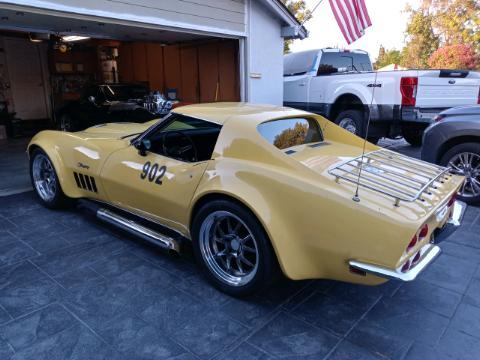

      I have a 69 vette any ideas on a semi comfortable autocross seats that will fit in my 69 vette thanks .Name:  new 69 drive way.jpg

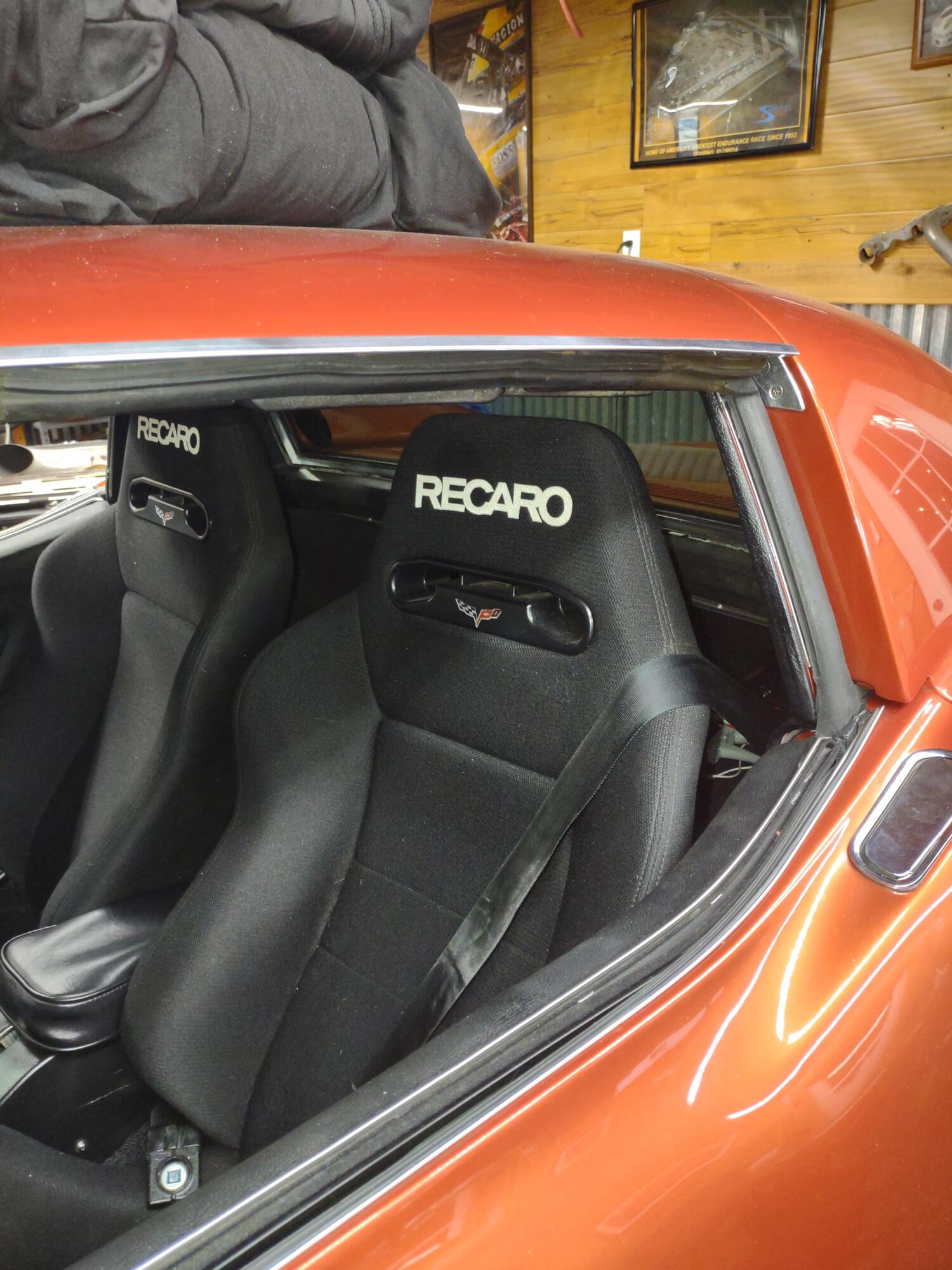

      I put the Recaro Speed in my 69 C3. It's a tight fit, but I was able to use after market sliders after I built some slim line mounts. The seats had to be mounted on the wrong side with the adjuster knob in toward the center instead of to the door. I'm 6'1" and 215lbs. They are snug but comfortable and supportive. My helmet does touch the roof, but I don't think it was any different with the stock seats.
      If you'd like any more pic's or measurements, just PM me your number or email and I'll send them.
      A lot of C3 guys use Fiero seats and get new covers from Mr Mikes. That's not a bad way to go either. The fiero seat are also much better than the stock seats and look pretty good in the early corvettes.

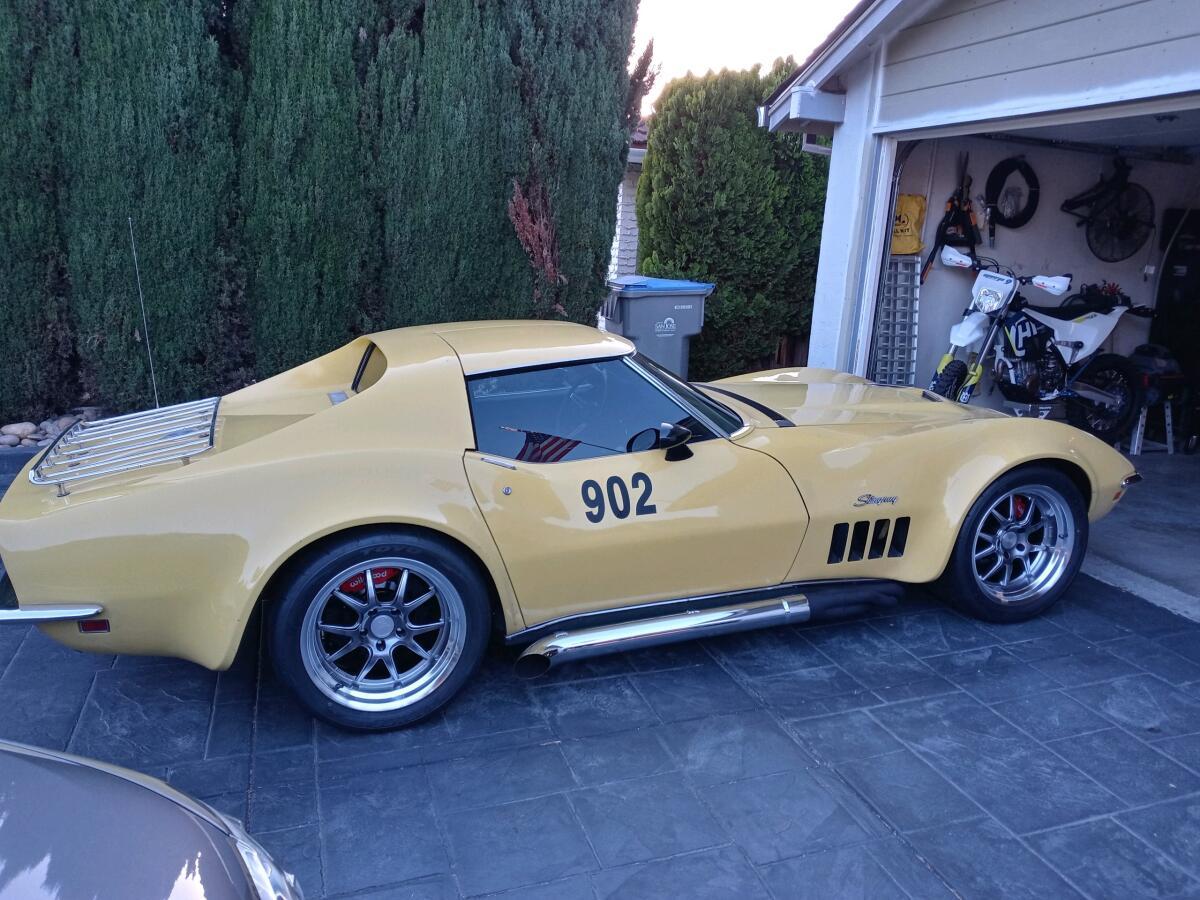

      Thanks I just ordered the corbeau a4 seats and now looking for a roll bar any suggestions I am also having a 434 small block built and should have in a couple weeks and ended up going from 18 by 10'' went to 18 by 11'' wheels and had them powder coated bronze chrome and will run the falcon rt 660 315/30/18 squared.

      Nice you were able to keep the Husky! I had to sell my KTM to make room for the Chevy. 15 lbs. since and climbing...
