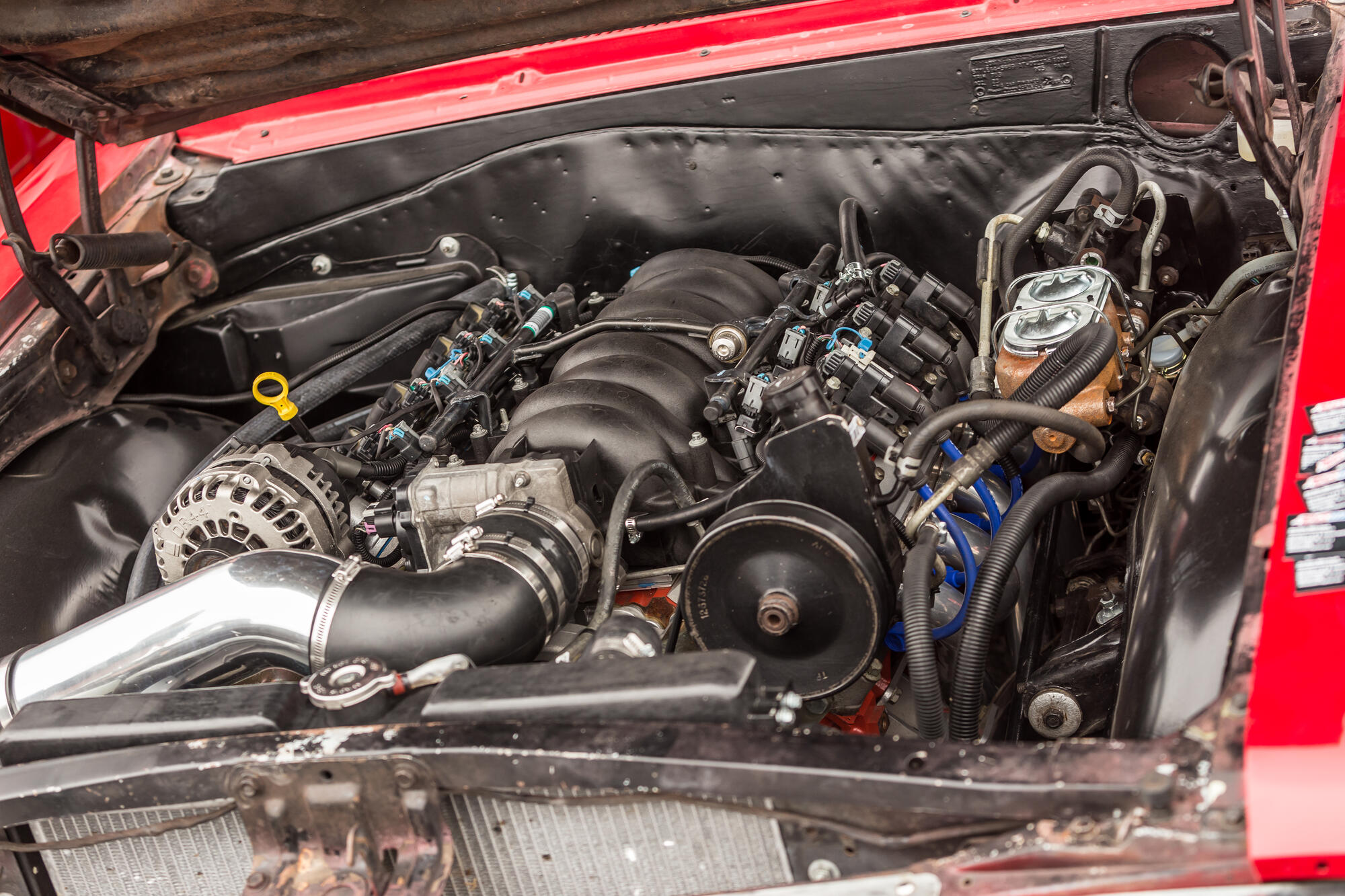

      I'm with you and understand what you're trying to do. I went the STUPID hard route of taking the underhood truck fuse box and repurpose it as my main, then integrated it to the chassis harness of my 64 Chevelle. It works well, but it took time and planning to get everything done. Main issue was the underhood harness has a lot of battery fed circuits so I had to turn a few into ignition fed or run separate relays to get ignition feed. The dash fuse box has the ignition fed fuses. I converted my headlight switch to ground feed, that runs the headlight relay in the fuse box. Nabbed a firewall grommet off a 2005 yukon as my passthrough, cut a 3.25" hole in the firewall behind the intake and fed the wires through.
      If you do as you're planning, label EVERY wire coming out of the ECM and depin all of them. Untangle every wire and route it exactly as you want it to lay, you can use a heat gun to help get the wires to straighten out. Leave a little service loop at every component, I ran heat shrink up to every plug to clean up the look as well. Amazon has some great braided loom (alex tech) that is inexpensive and bundles the wires tightly, I just used junkyard split loom (serious ebenezeer budget) You can click on my build thread in my signature, wiring started on page 8 but there's a lot of talk in between, it's a long winded thead..
