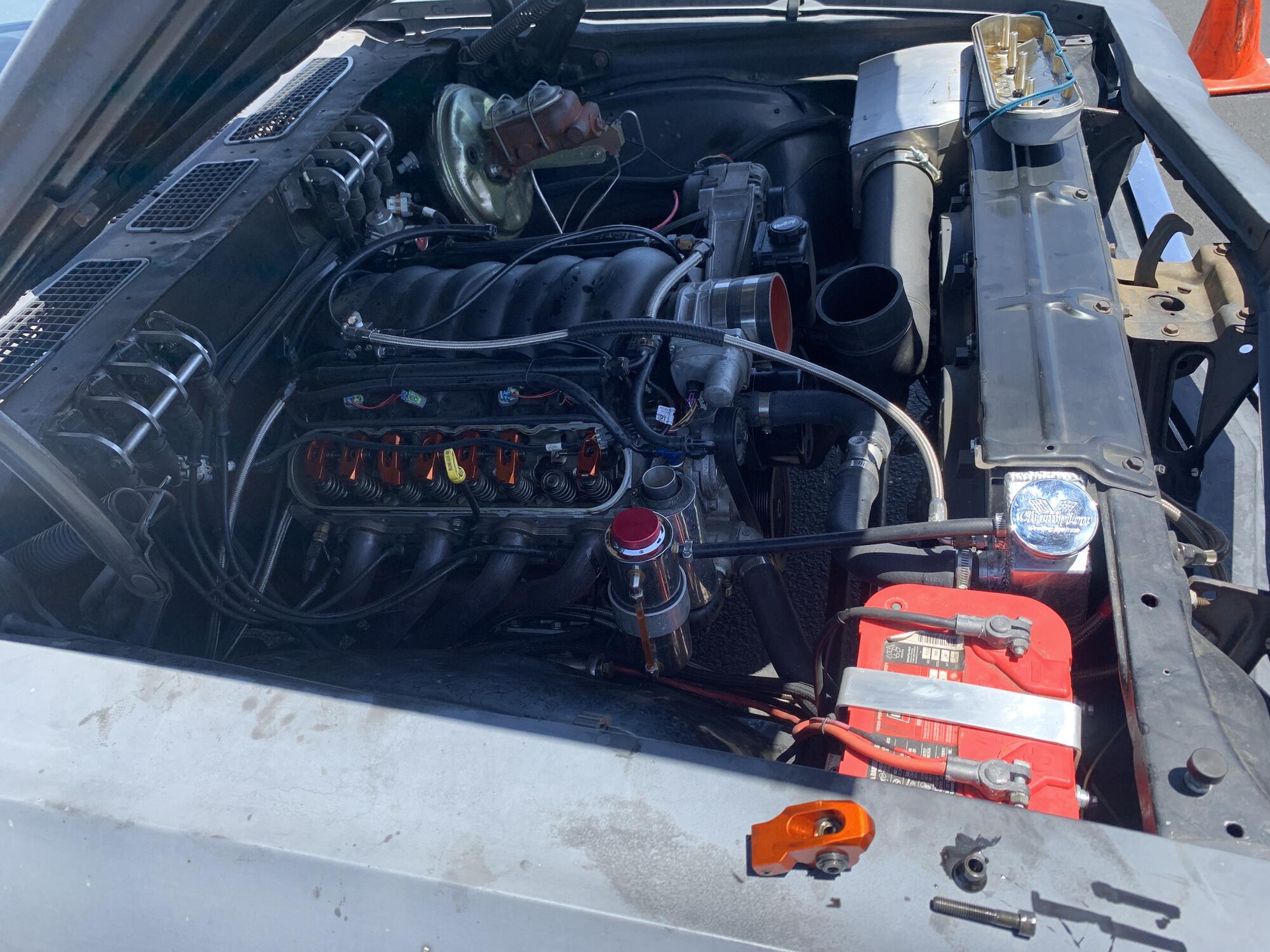

      Car currently has a 720hp (estimated :D) 416 LS3 i built, no trans but soon-to-be RPM T56 Magnum, 12 bolt with 3.42s, F&R UMI control arms, coilsprings, 17" wheels, not sticky enough tires and not a good enough driver.

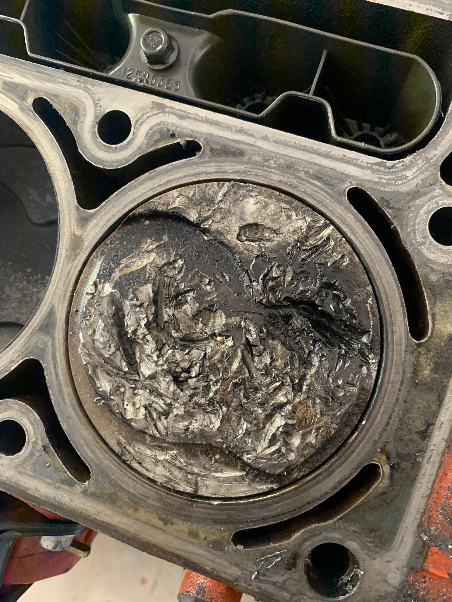

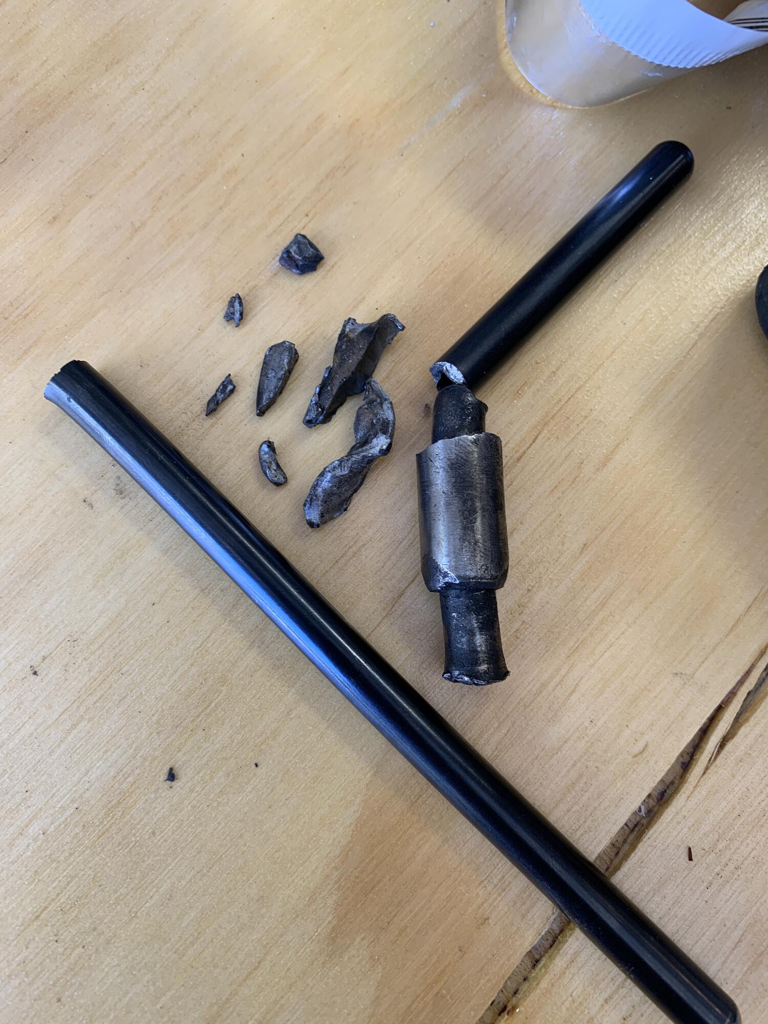

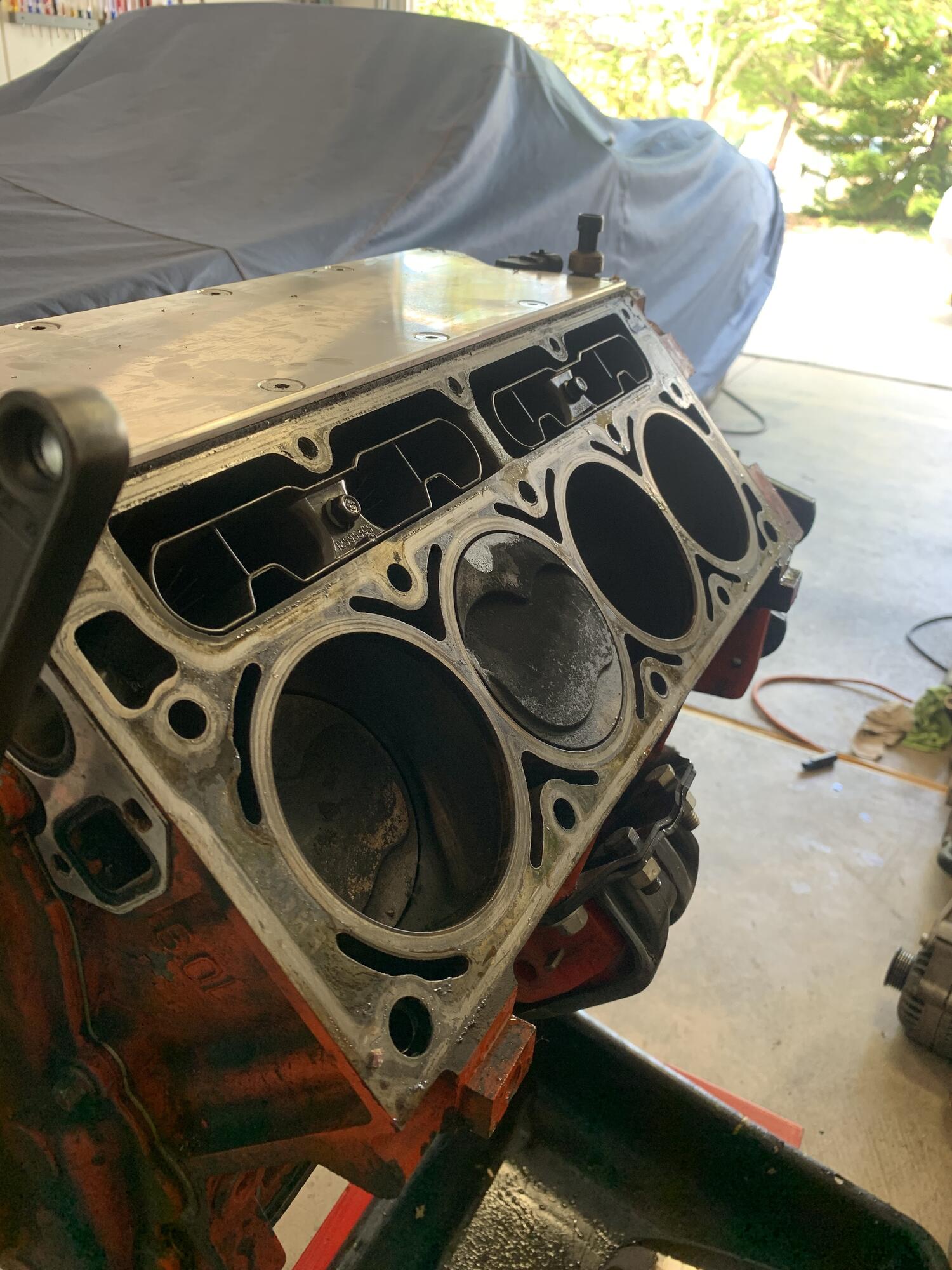

      Some of my favorite pics of the car come from Palomar Mountain in california and from the track day i blew my engine at, Chuckwalla Valley Raceway.
      Engine failure was 2 dropped valves due to valve float from me raising the rev limiter to 7600RPM to be able to wind 2nd gear higher without shifting, because i lost 3rd and 4th gears from the 106° heat. Spectacular souveneirs from that breakage though.
