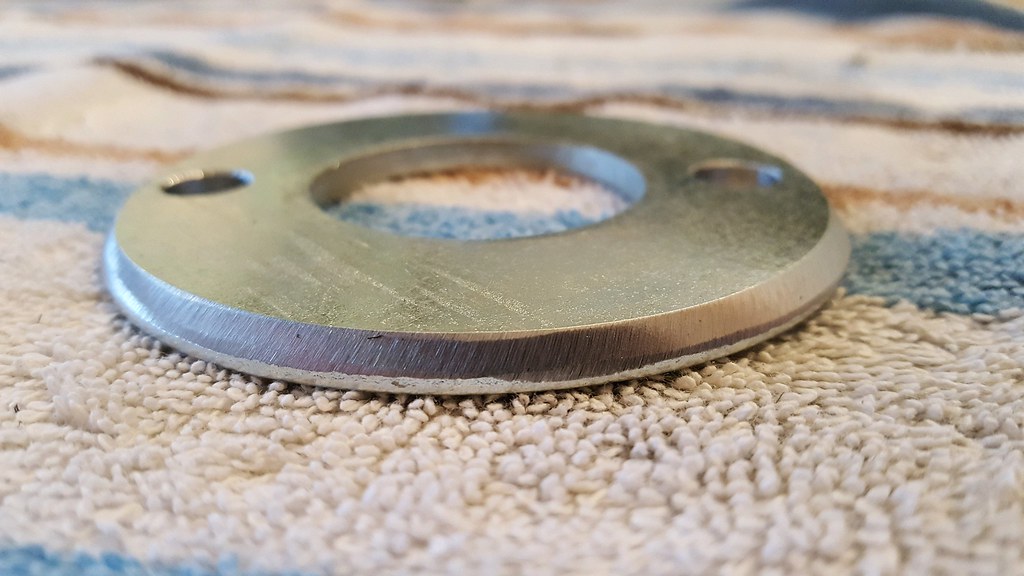

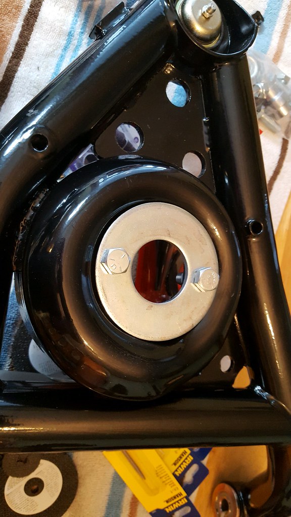

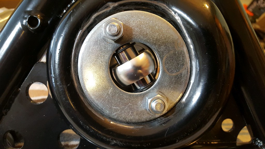

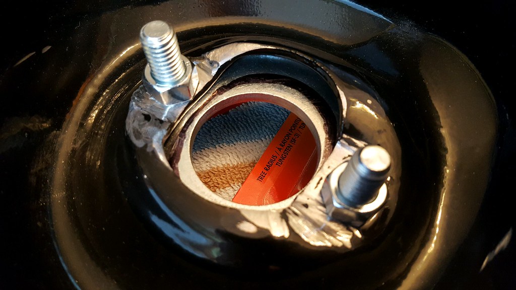

      I used coil overs in a Chinese tubular arm which has the same style lower mounting, 2 threaded nuts. I used a large thick washer from an industrial hardware store, removed the welded nuts and drilled holes. I tapered/beveled the side of the washer to fit better in to the underside of the A arm and then welded the washer to the underside of the lower spring pocket. I didn't get any pics after it was all welded.
