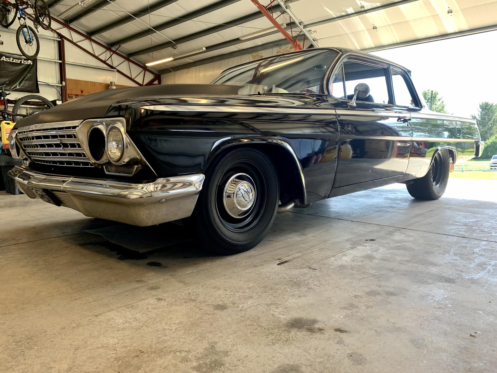

      Hey guys, I decided to give my 62 some love. 10 years ago I got it out of my dads garage where is has been setting for 30 years or so, put a 496 in it, picked up dirt bikes as another hobby (which consumed me and is still trying to pull me back ha), and parked the car only driving it 1 or 2 times a year since.
      In September I decided I wanted to change it up a bit, take it from the old school look it had going on and turn it into a Pro Touring ride.
      I've made pretty good progress since then.

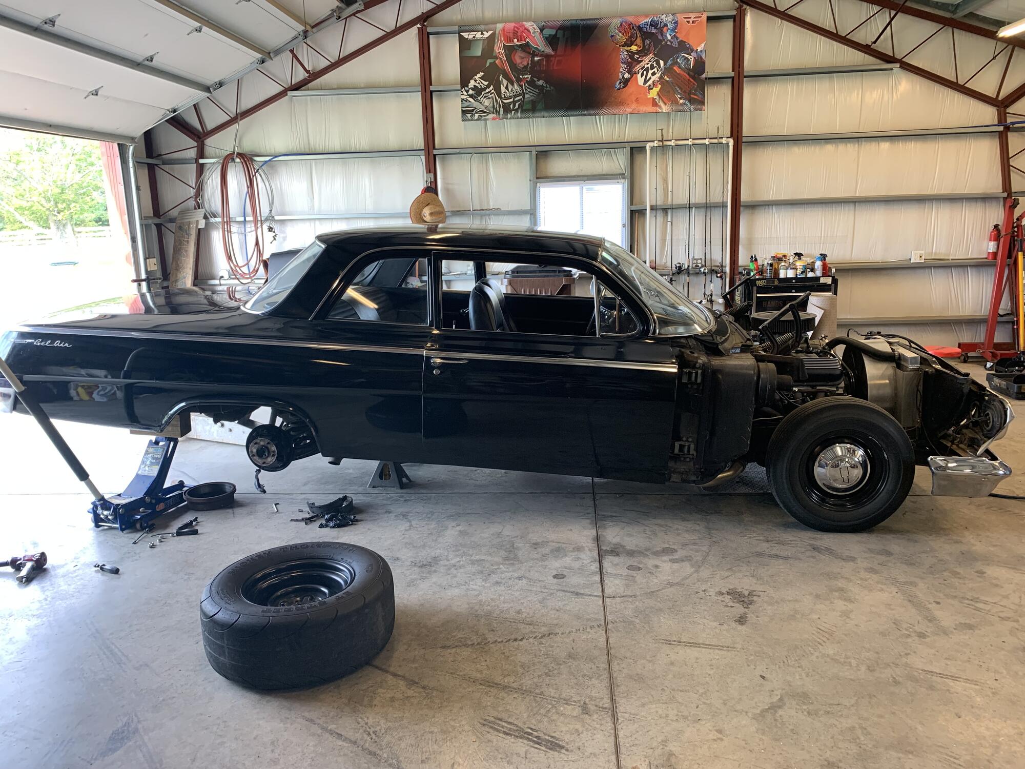

      The car before I took it apart.

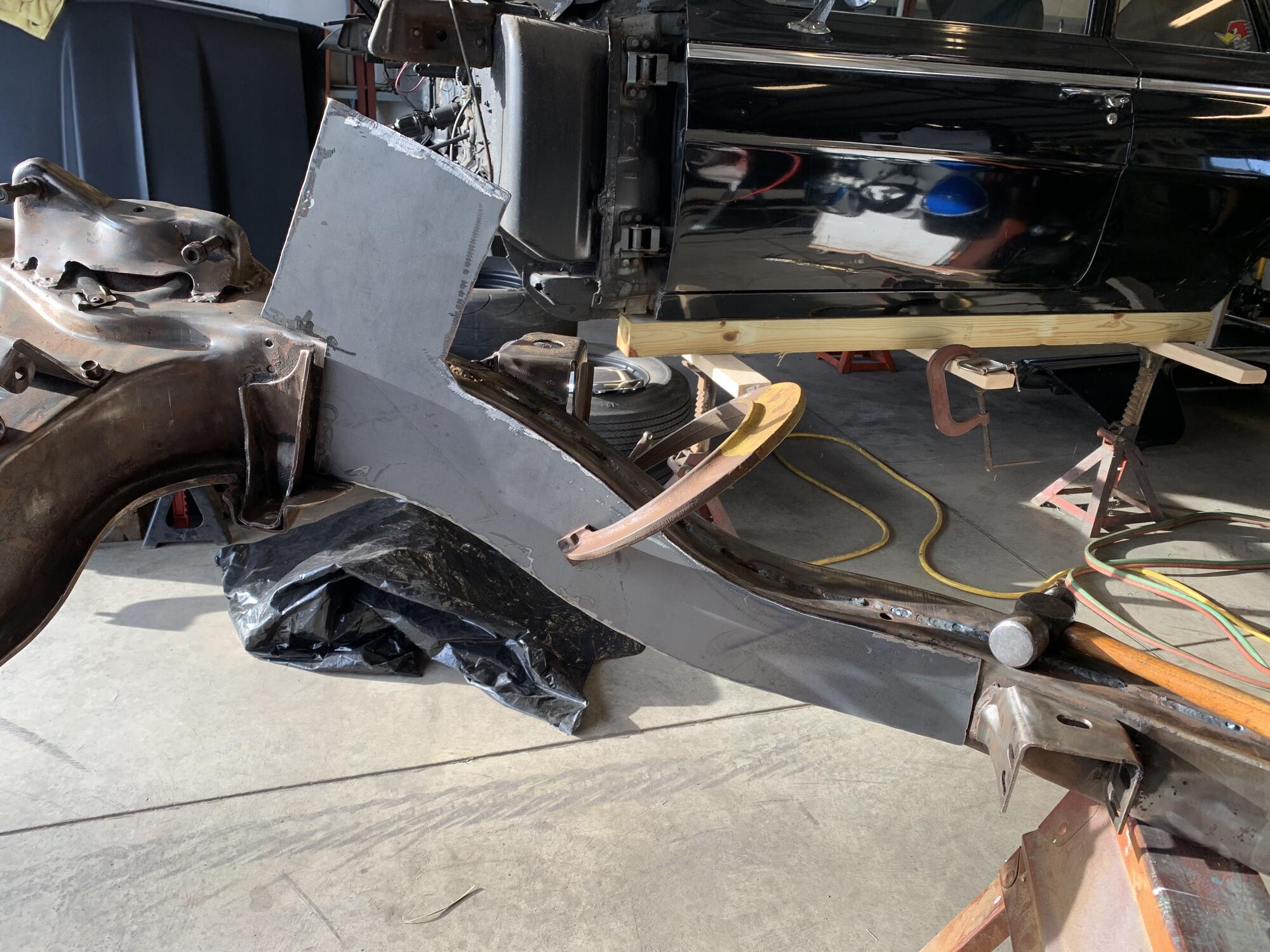

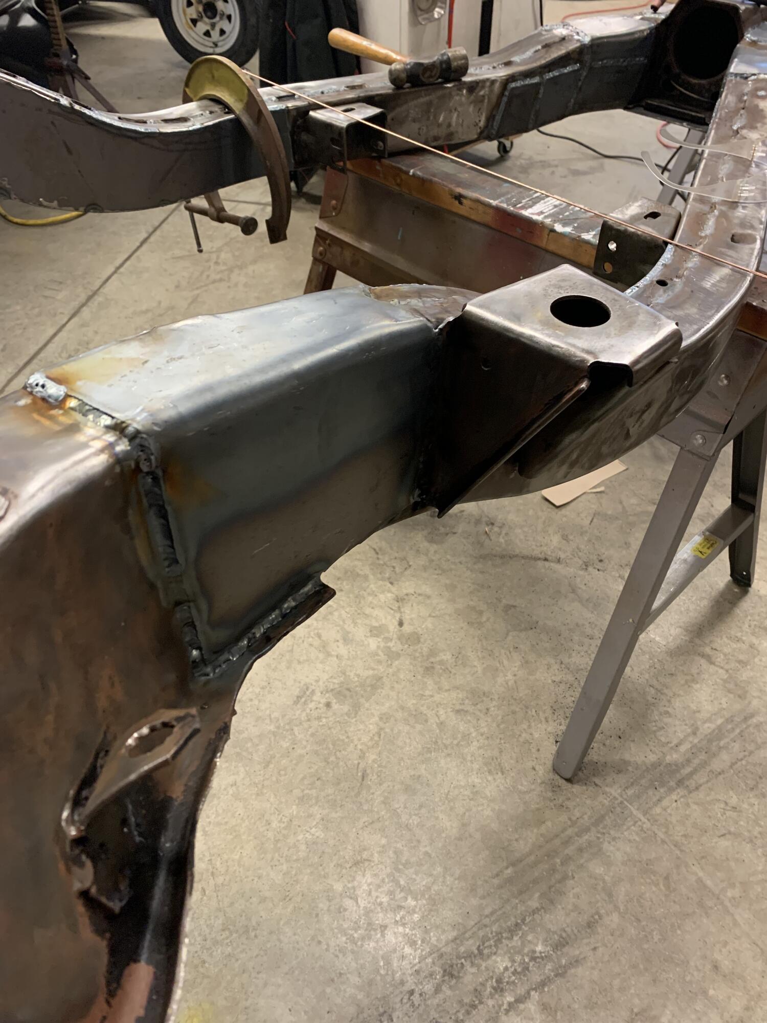

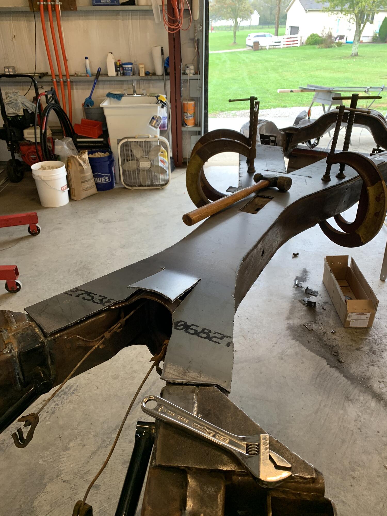

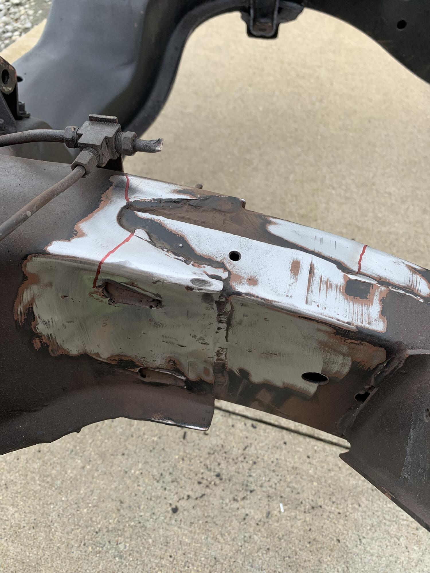

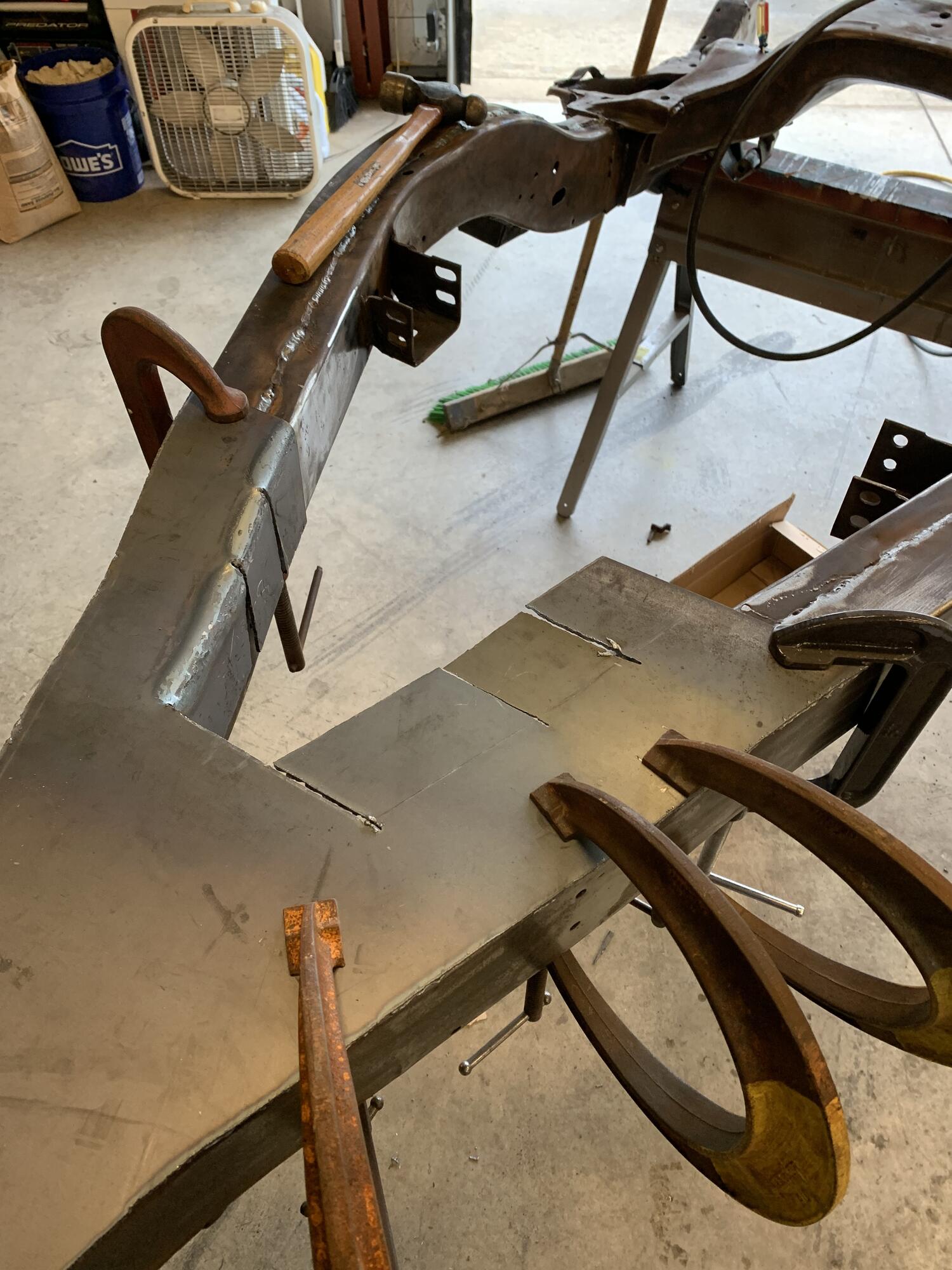

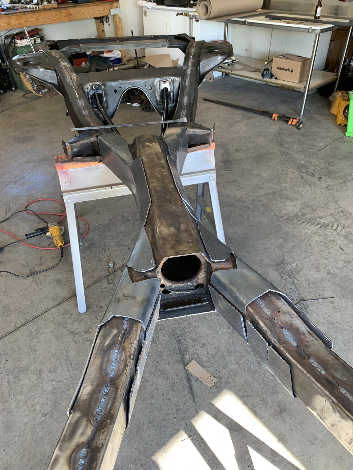

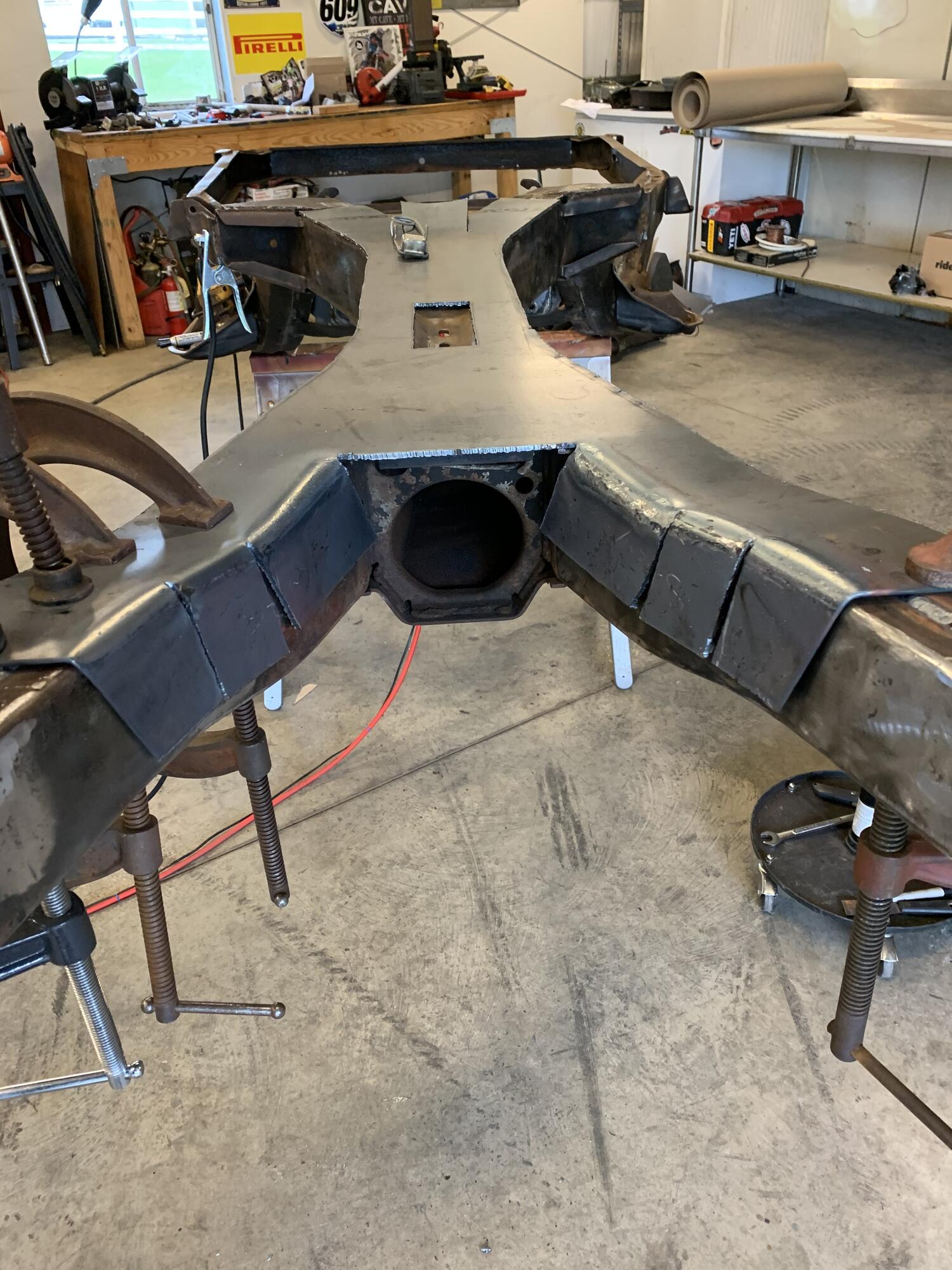

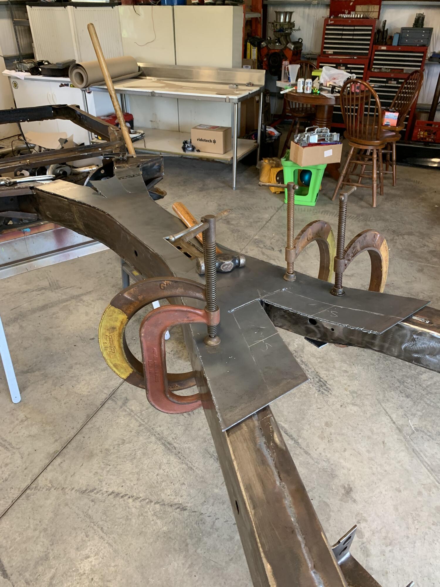

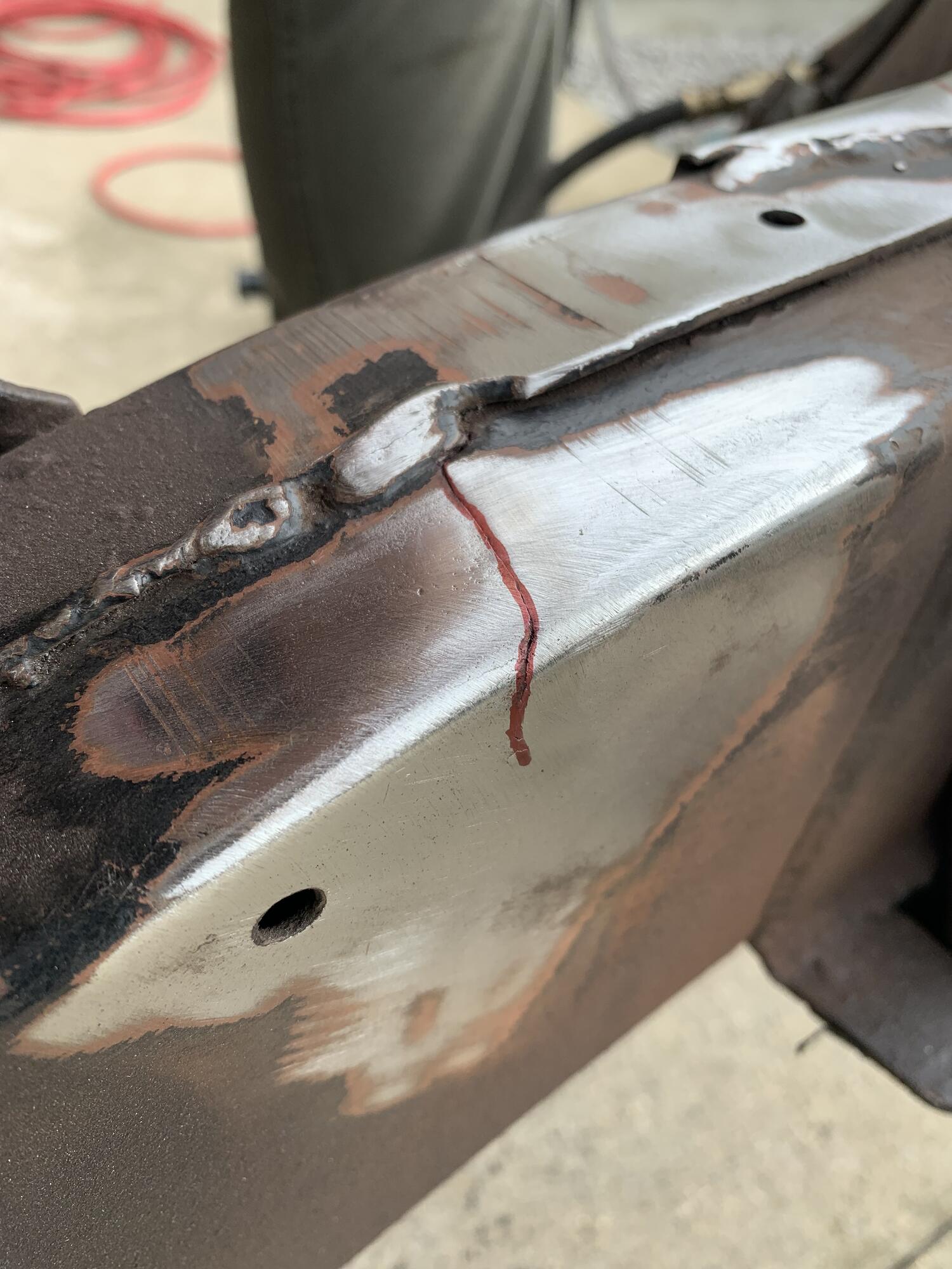

      Fully welded the frame and added reinforcements to the X and front frame rails.
      Cracked Frame
Size:  255.7 KBName:  IMG_1023.jpg
Size:  344.9 KBName:  IMG_1025.jpg
Size:  277.8 KBName:  IMG_1026.jpg

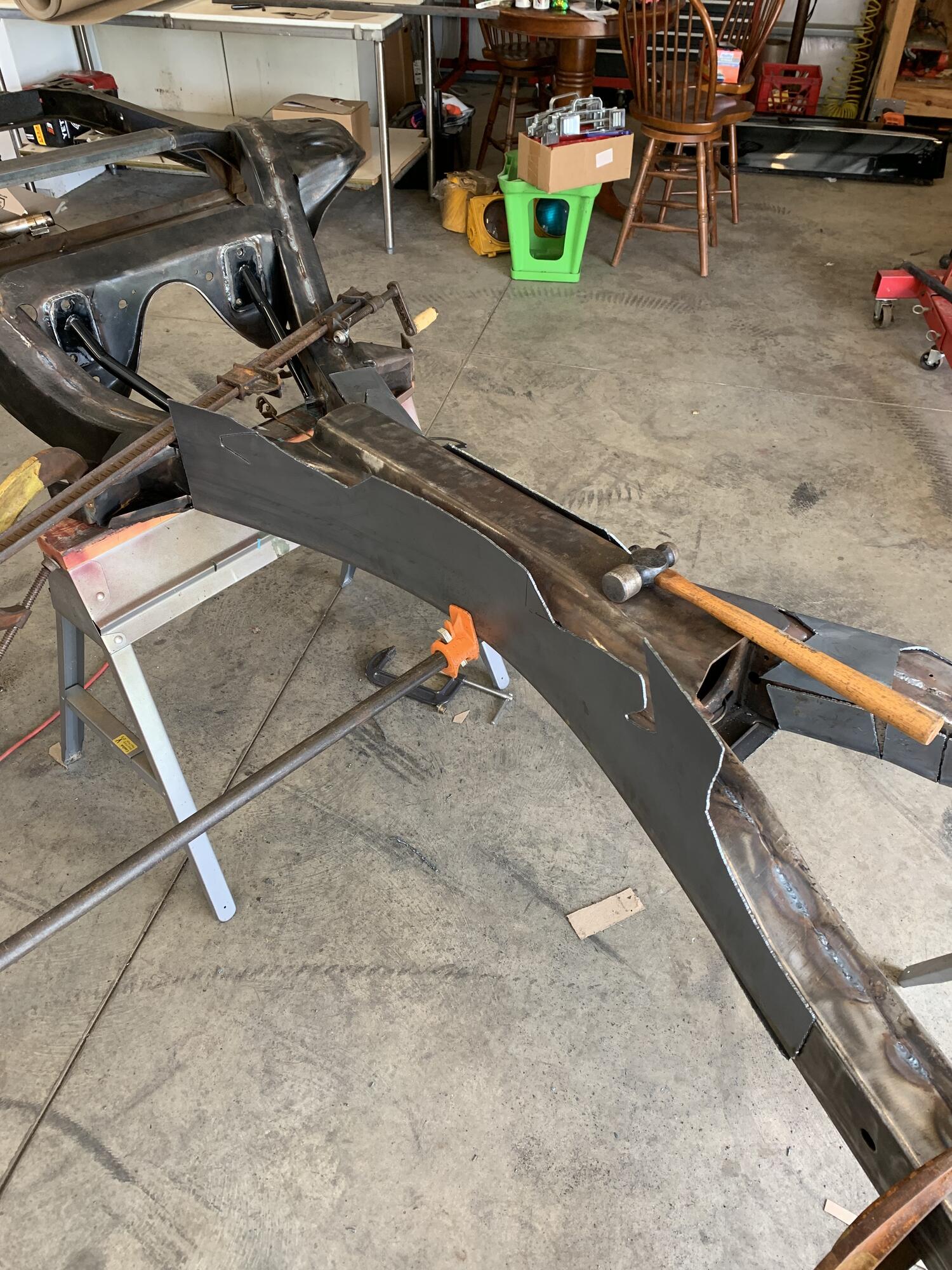

      X Reinforced
Size:  414.4 KBName:  IMG_1152.jpg
Size:  347.7 KBName:  IMG_1154.jpg
Size:  468.9 KBName:  IMG_1151.jpg
Size:  324.1 KBName:  IMG_1150.jpg
Size:  287.5 KBName:  IMG_1146.jpg
Size:  377.5 KBName:  IMG_1145.jpg
Size:  313.6 KBName:  IMG_1144.jpg
Size:  354.6 KBName:  IMG_1143.jpg
Size:  372.5 KBName:  IMG_1160.jpg
Size:  289.3 KBName:  IMG_1158.jpg
Size:  341.4 KBName:  IMG_1159.jpg

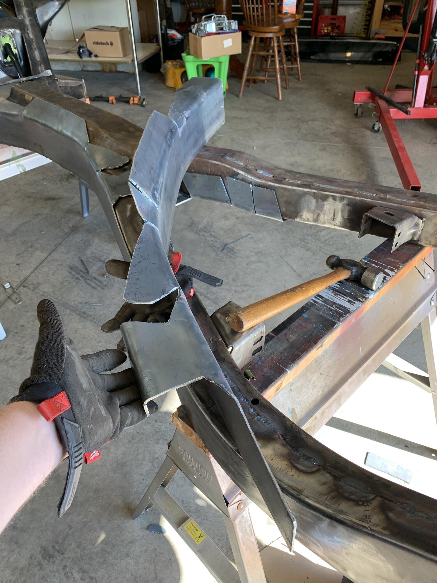

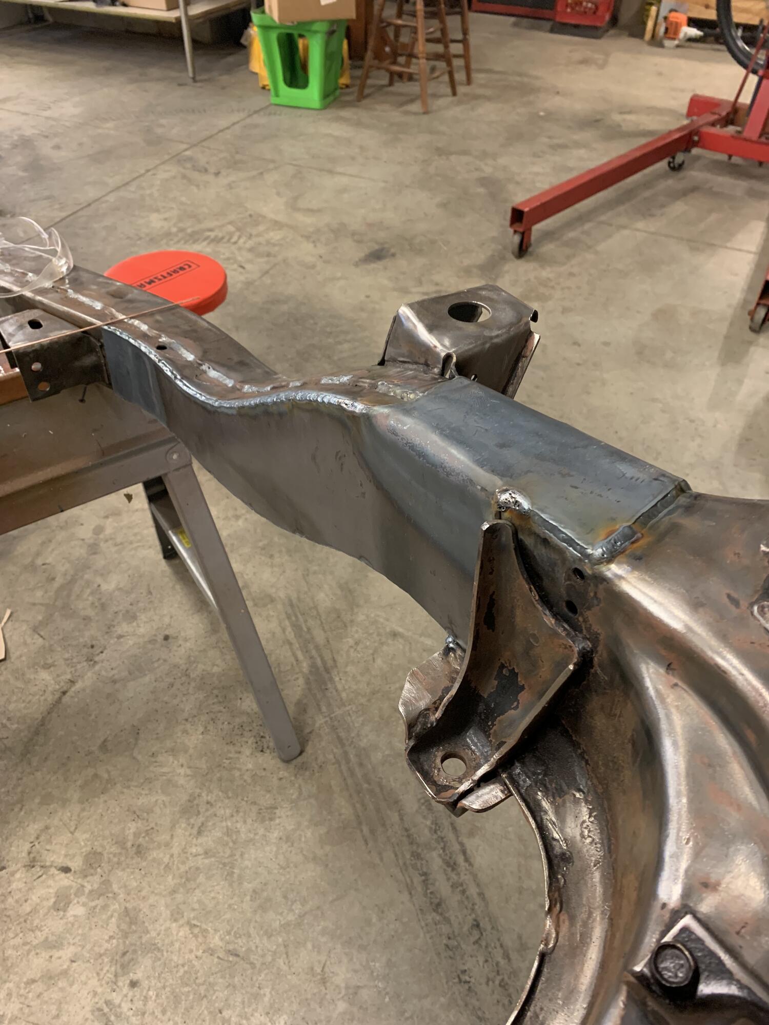

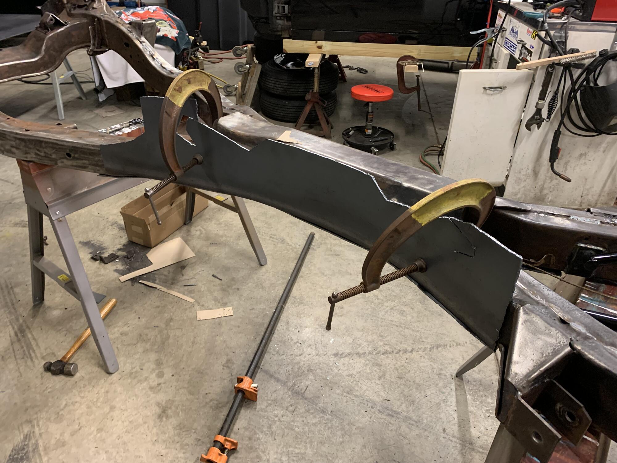

      Front frame rail reinforcement.
Size:  285.1 KBName:  IMG_1203.jpg
Size:  384.8 KBName:  65920751764__5BF58B31-59C1-4D50-ABEE-59FC511E3B95 2.jpg

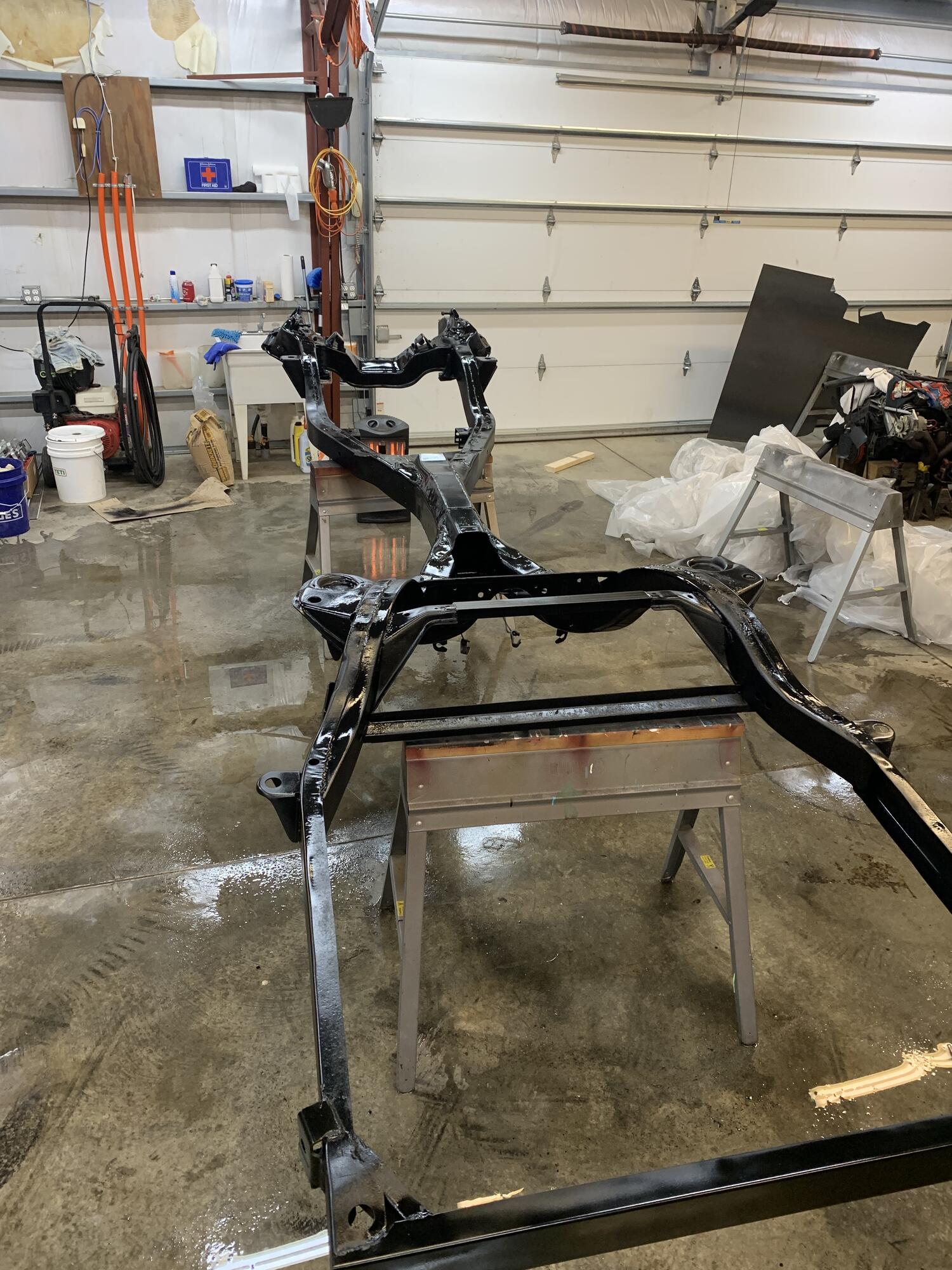

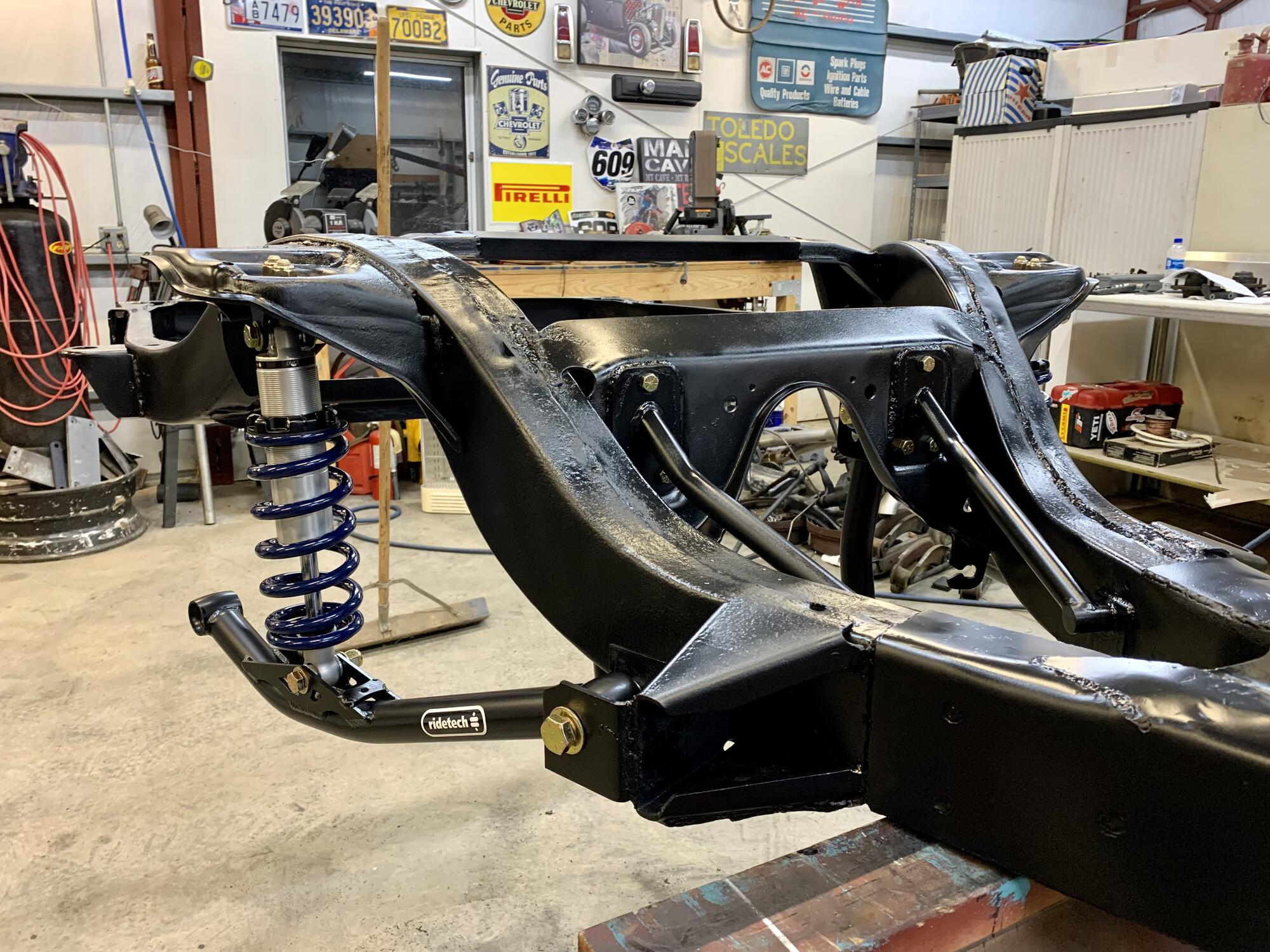

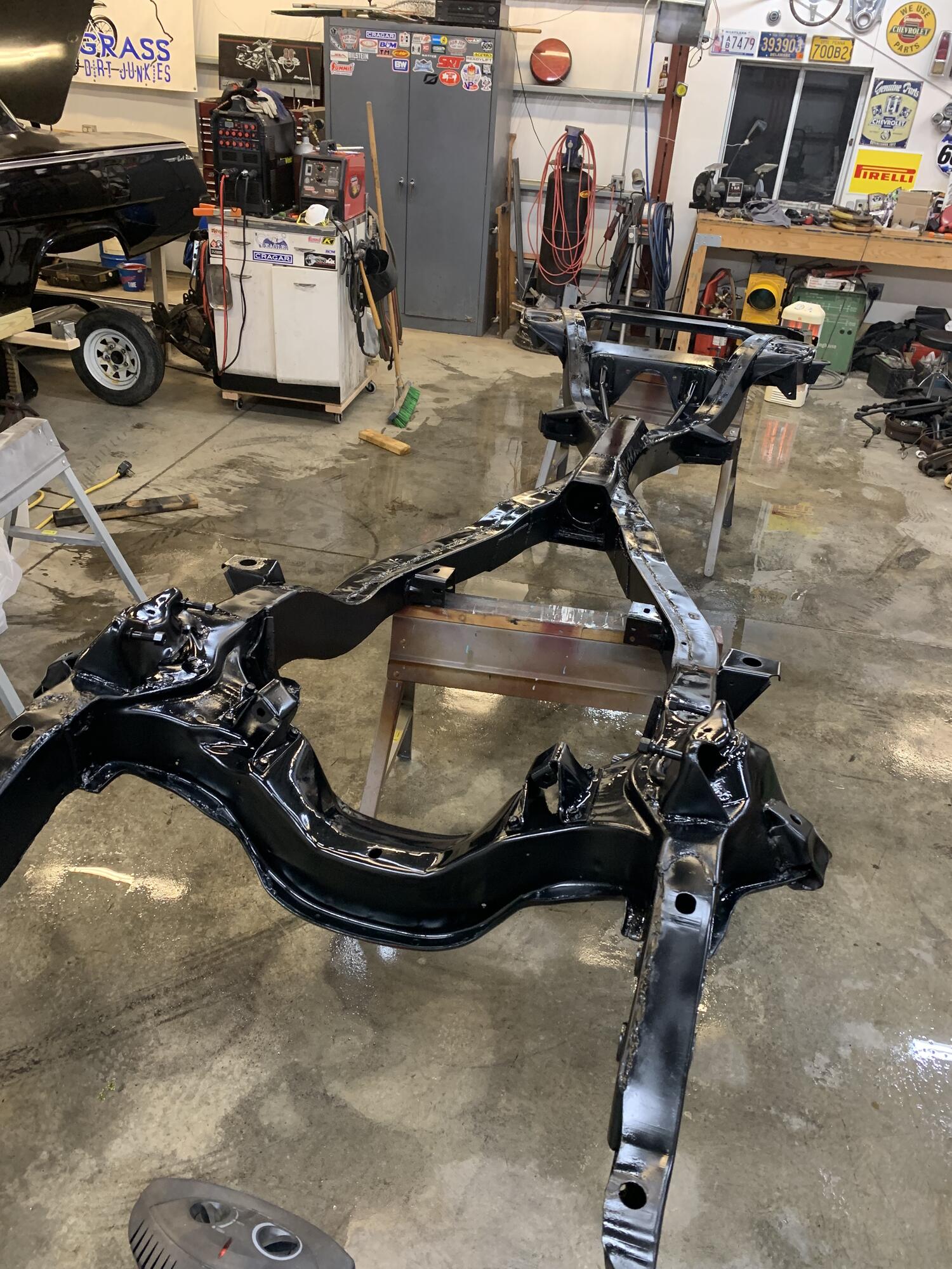

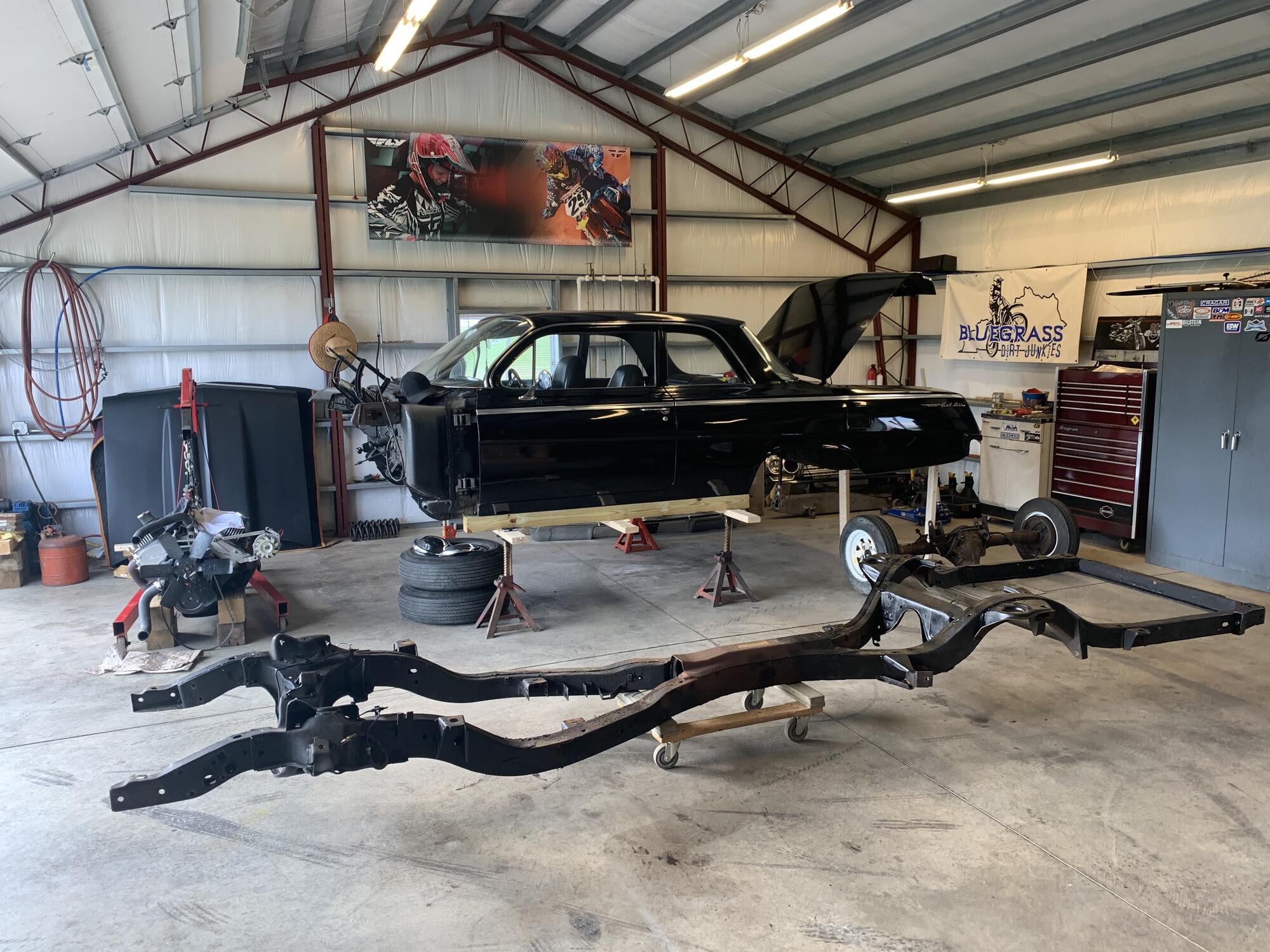

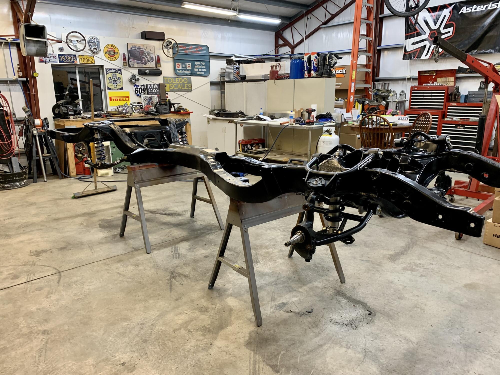

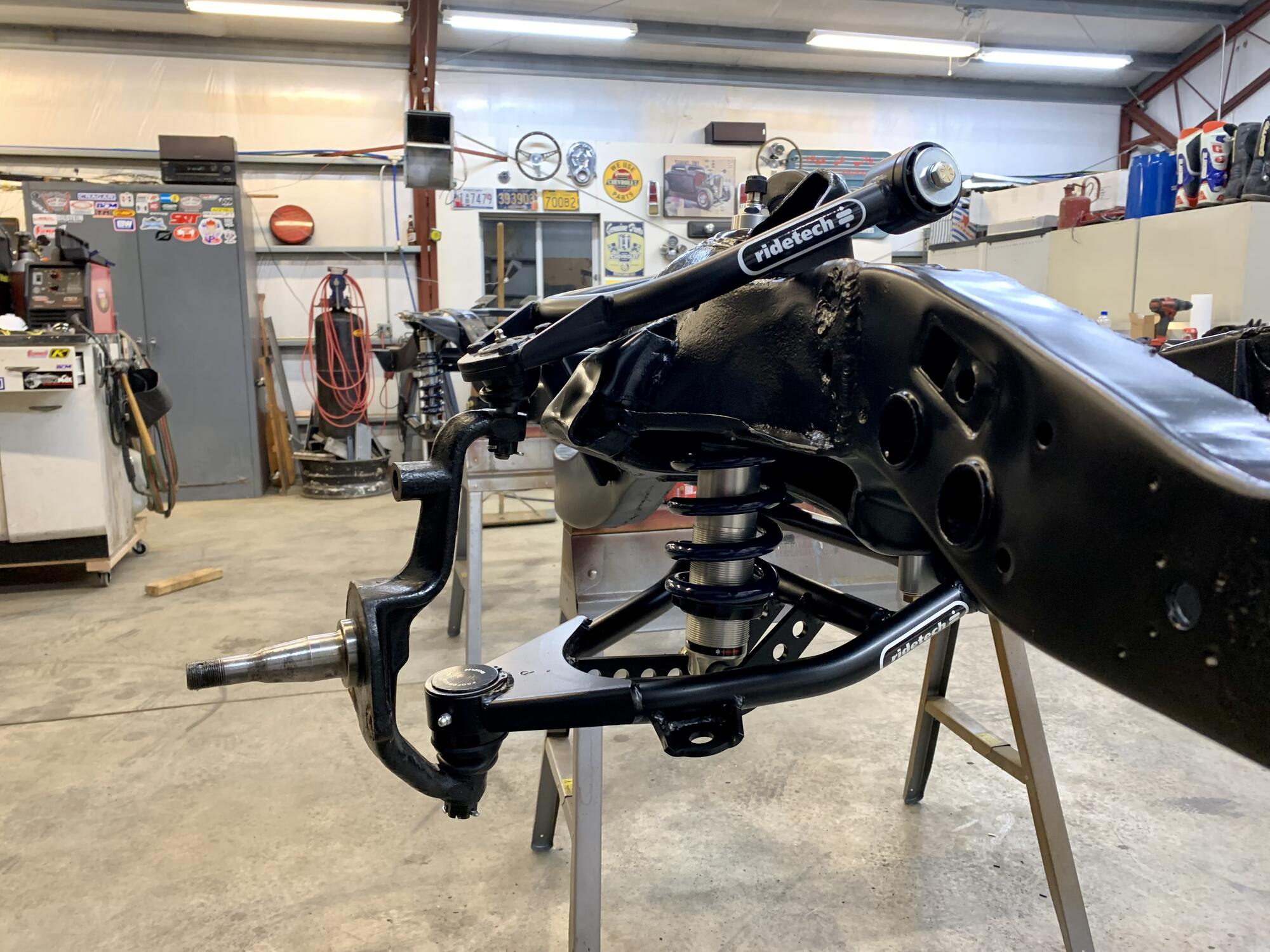

      Frame painted and suspension test fit.
Size:  430.1 KBName:  IMG_1236.jpg
Size:  472.9 KBName:  IMG_1242.jpg
Size:  367.5 KBName:  IMG_1235.jpg
Size:  432.3 KBName:  IMG_1296.jpg
Size:  484.9 KBName:  IMG_1297.jpg
Size:  342.4 KBName:  IMG_1298.jpg

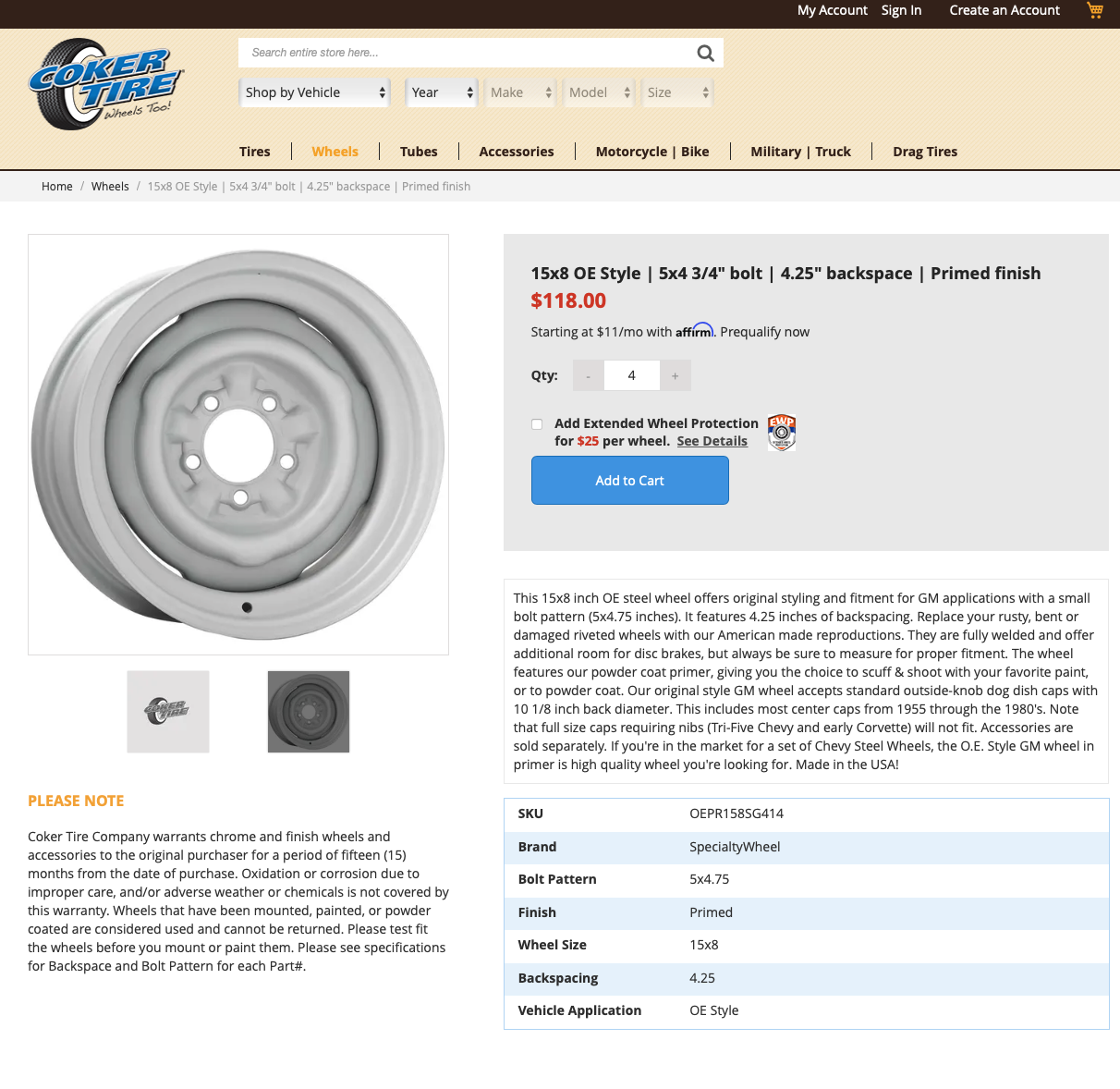

      They are 4.25in backspacing. I'd say they are these Cokers.
      Name:  Screen Shot 2021-12-21 at 5.24.00 PM.png
