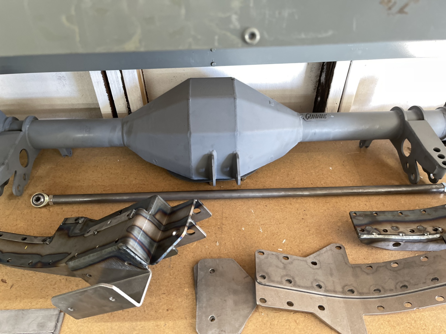

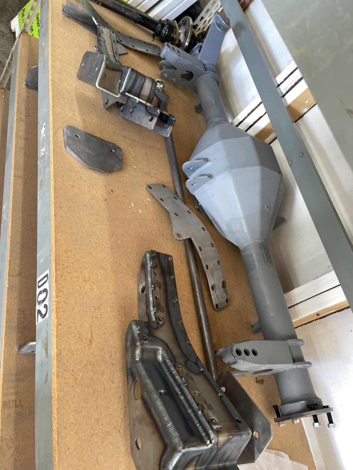

      so i just could not get over the standard rear width rear end, so i called tci and talked with them for a while, i got the narrow housing and other little related parts ill need to install the kit i have with the narrow rear end, should be here the first week of February, im super excited. that also means ill have a std width currie fab 9 housing for sale with axles. willing to make someone a killer deal on it, can include a few items so you can use the tci kit if you give them a call and get the misc parts youll need from the, or you can cut the brackets off the rear end and use it on anything

      All my narrowed pieces came in from tci
      Going to start to really tear into this thing
