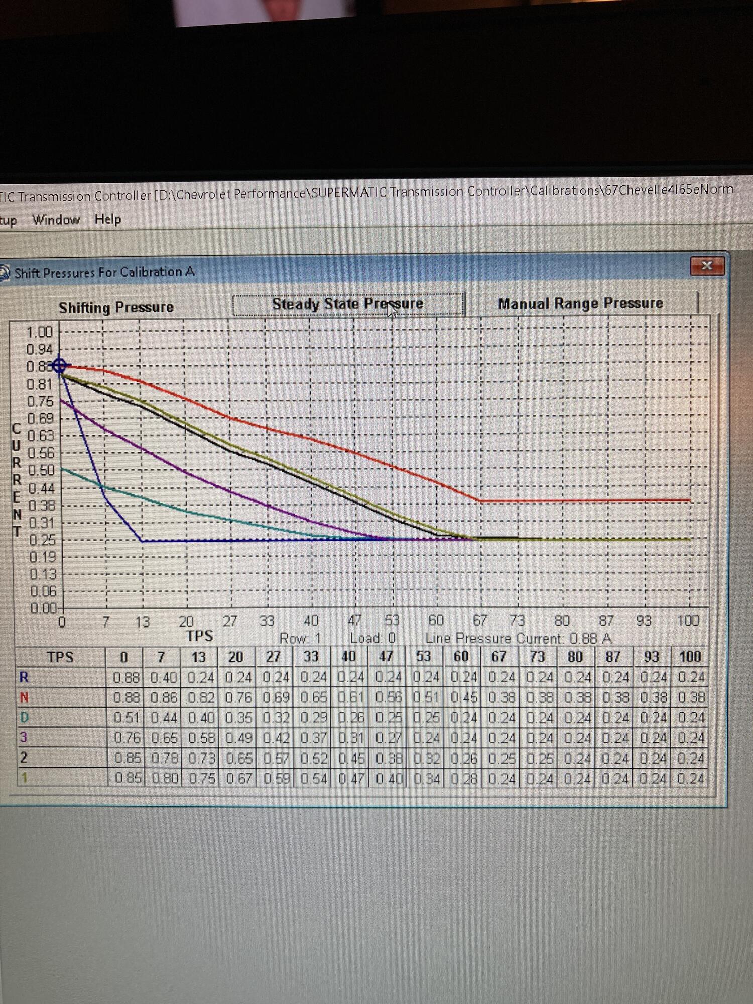

      Not physically measuring yet. Just trying to get a starting point for the pressure valve current vs throttle position graph curves. The only chart I have for this is the one for the drag racing tune that I was given by GM. I’m attaching the chartName:  5D59B256-C872-41C1-ADE0-D3138A36960B.jpg

      Trying to figure out if I should pair this same setup with my custom street shift pressure tune or if i need to modify these steady state pressures too.

      I understand that but I did not get a tune for the street from GM and they can’t seem to get me one so I’m having to create one from scratch. I don’t know where to set the pressure curves for the steady state pressure. I’m asking if I need to soften them up or not? The image above is what they sent with the drag race tune. I modified the shifting pressure curves to suite me for street driving. Just looking for help with the steady state pressure curves. The car drives fine with the steady state values in the chart above but runs the trans a little hot. I assume pumping the pressure up and down generates heat so I was wondering if these steady state pressures are higher than necessary for a street tune since these above are for a drag race tune. Should I soften them up a bit or leave them alone?

      If I knew what the actual pressure should be at minimum throttle and at maximum throttle for a street tune for each gear I could extrapolate a linear curve between the two points for each. That would probably get me close to right.

      After installing US Shift's software and looking at their ready to use, out of the box tunes I was able to deduce that the steady state pressures are nearly identical for all of their tunes for a given transmission. So I will assume that the steady state pressure curves that came with my race tune from GM are satisfactory for my custom street tune.
      Thanks for all the feedback/help.
