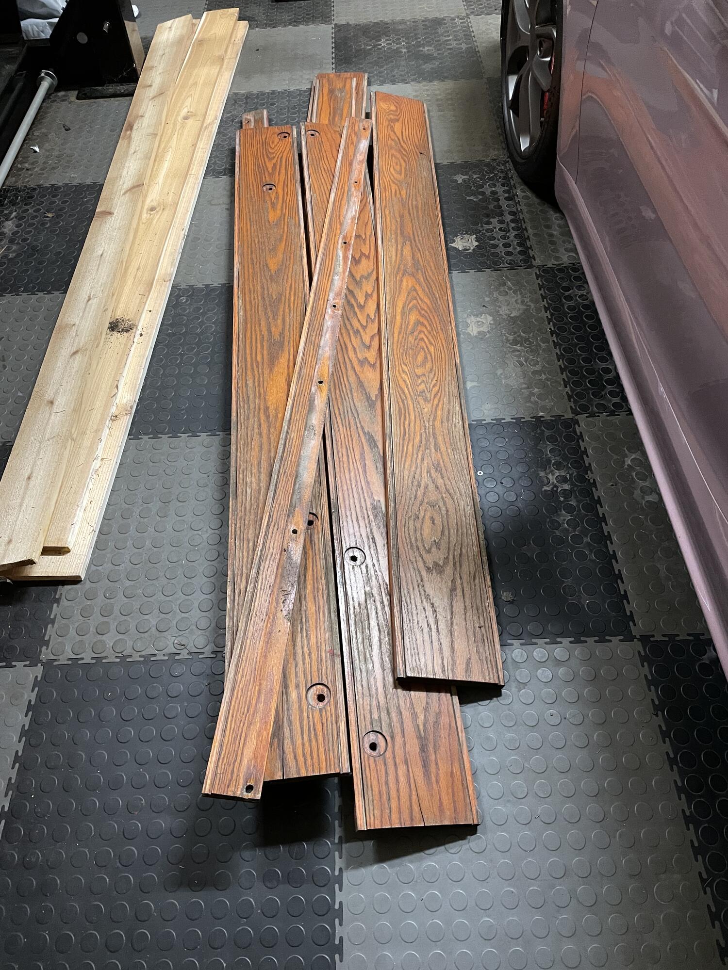

      Working on cosmetics and creature comforts while I wait for a friend to open up space for me so we can do the heavy mechanical lifting. Inside, I did the door panels and added stock looking radio, kick speaker & sub as well as finishing up the mag safe wireless mount/charger. Been looking at the bed deciding what to do with it and today I took out the wood and ss strips, thankfully I have a lift because, at least at my age, it’s not a job I’d want to do on my back. I took 1 piece down to bare wood to see if it was worthy of restoration but the wood wasn’t finished properly and has too much checking to make me happy. I have a well stocked wood shop in the house to feed my other hobby so Friday I’ll be off to the lumberyard where I buy my furniture wood with the plan to use the old pieces as templates. Currently debating between mahogany and tiger maple but it’ll likely come down to what is in stock. An aside, the white wood on side of the pile of old bed wood is rough cut white cedar that my 2 grandsons and I are going to make bat houses to put in the woods for some natural mosquito control.
