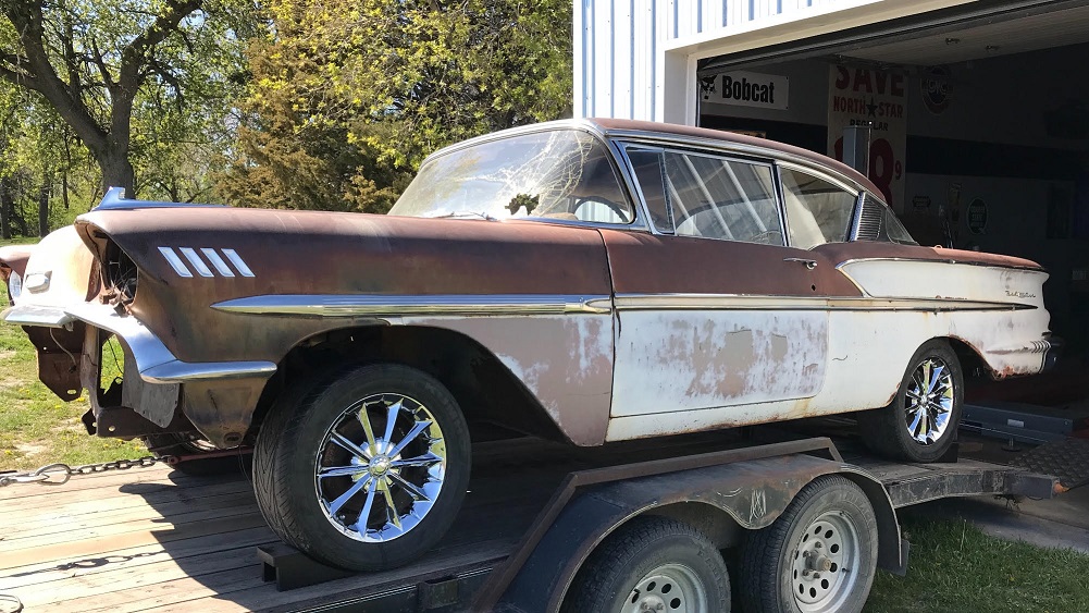

      Relatively new to the forum, but I have been doing lots of reading. I come from the street rodder world, but I am in the process of buying a 1958 Chevy Bel Air coupe and my goal is to turn it into a really nice driver while not spending tons of money. No track days etc., but just a nice handling car that I can take my two grandsons for rides on Sunday afternoon. I am thinking of running some sort of pull-out LS, but haven't decided on manual or automatic at this point.
      Question regarding suspension; Obviously, the car needs to be a lot lower, but no engine or trans in the car right now, so it sits really HIGH! I am leaning towards the street grip suspension from ridetech (I don't want the budget to get away from me). This car has a really weird rear end mounting brackets. Has anyone worked with this set-up? I know the 1958 is a little different even than the 59. Maybe I should be considering something like the Global West upper A-arm setup? Any advice is greatly appreciated!
      I will want to upgrade the front brakes to disc, but will probably just run drums on the back. Any advice on brakes?

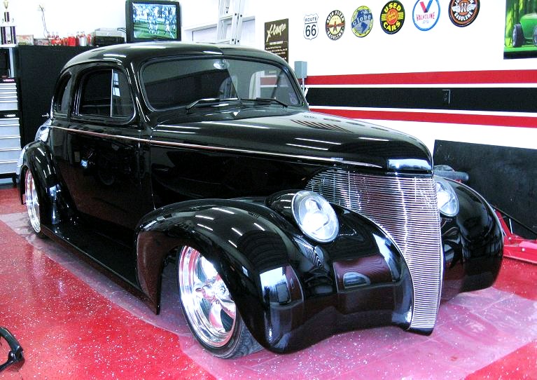

      I love Camaros, Novas, Chargers, etc., but I always like doing something different. When I did my street rod, everyone was doing 32-34 Fords so I did a 39 Chev.Name:  Red XP and a couple of the 39 001 resized.JPG

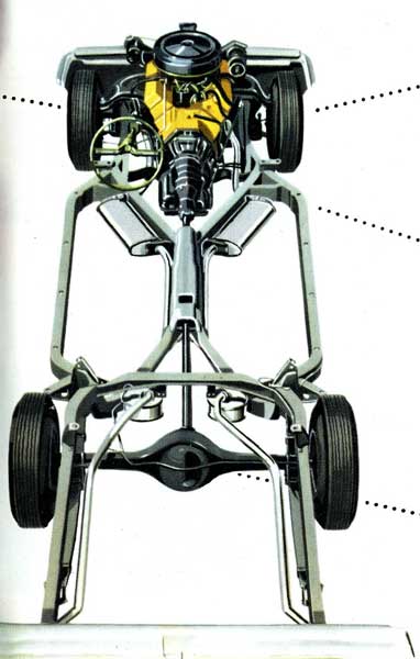

      Too bad a custom frame/suspension setup like Schwartz chassis is not in the budget. Then you totally get away from the x-frame and get a better suspension setup.
      Convertibles GMs were supposedly reinforced. If you could find an Olds version of the x-frame, it has a perimeter type setup (better torsional rigidity and safer).
      At a minimum try reinforcing whatever frame you get. Here's some ideas. https://www.youtube.com/watch?v=ShTpzNSjKTQ
