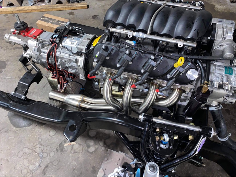

Size:  204.3 KBName:  9094ED29-5CAE-4342-8A82-B3875F8EE5E0.jpeg
Size:  199.7 KBI just went through this. I used the DSE sub, DSE setback stands, Holley headers for DSE sub, and the Holley crossmember for the first Gen sub. I also used the Holley exhaust for the quadralink. I contacted Toddoky and he was somewhat helpful. Todd was the PM for the stock sub stuff. He did try to relay questions I had for the DSE stuff through the guy who was that PM. No one at Holley (or DSE) could tell me what trans crossmember to use. DSE wants you to use their headers and the bowler trans crossmember . The bowler crossmember doesn’t work with the Holley exhaust kit.
      Using the parts I mentioned (all Holley with the DSE stands) you have to put approx 1 1/4” spacer (used 1” aluminum block and other trans shims) to achieve a 2.0 engine angle. Do not get the exhaust kit with the resonators. They hang too low. If you decide to use the Holley exhaust, the drivers side crossmember cutout will need clearanced (opened up slightly).
      Lots of aggravation initially but it works great. Let me know if you have any other questions.
      It had to do I over again, just order the DSE headers and bowler crossmember and have a shop do your exhaust.

      Andy, Yes you do have to raise the tunnel with the DSE sub. The DSE engine mounts raise it up similiar to the stock 67-69 mounts. I used a bowler tunnel cap.
