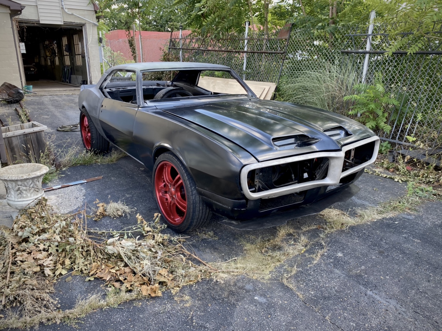

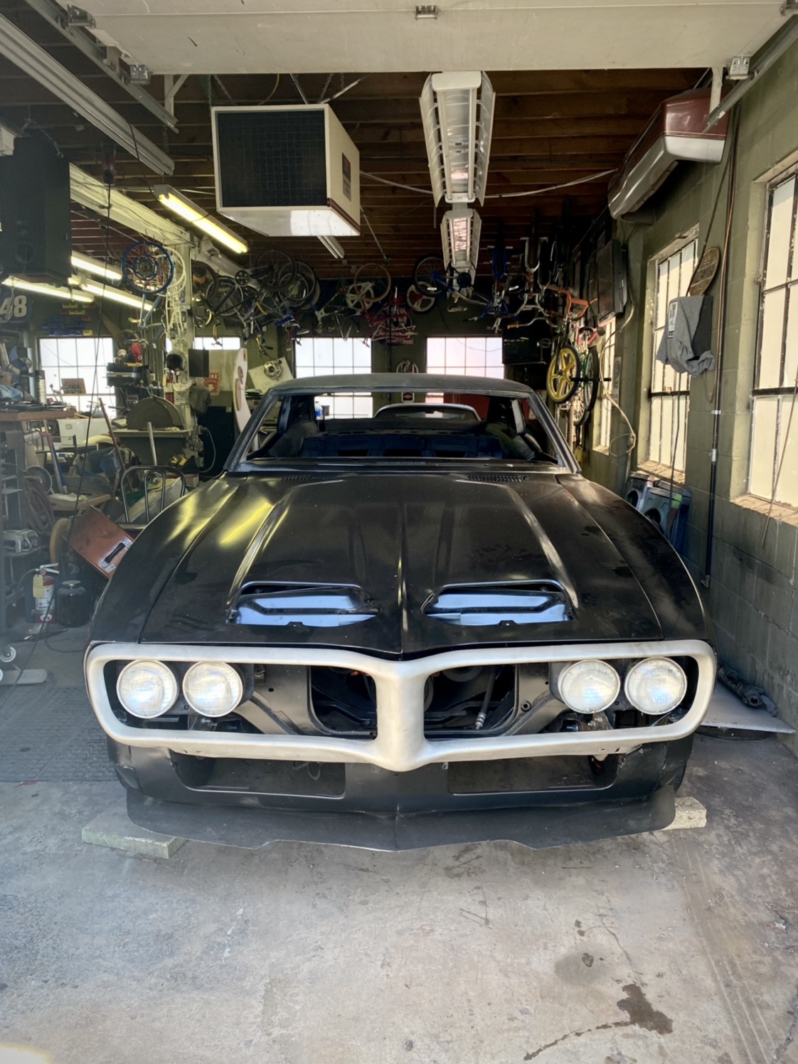

      Nice.
      The bumper looks like it needs a bit of tweaking. Almost looks to short on each side.
      I'm doing this now on my 68. Not much after paint and chrome.

      Great job so far Evan! Thank you for deciding to post a build thread, its great to look back on your progress. Your Firebird has come a long way in a short time and it looks really good, I love the smoothed bumpers! Keep up the great work, I look forward to seeing your future progress.

      I haven’t had a chance to work on the front bumper yet, but I plan on making it transition a lot better with the fenders. It’s an original bumper with aftermarket fenders, so I figured the alignment would be off. I am going to run an accent color like black for bumpers, so luckily I won’t have to worry about chrome prices.

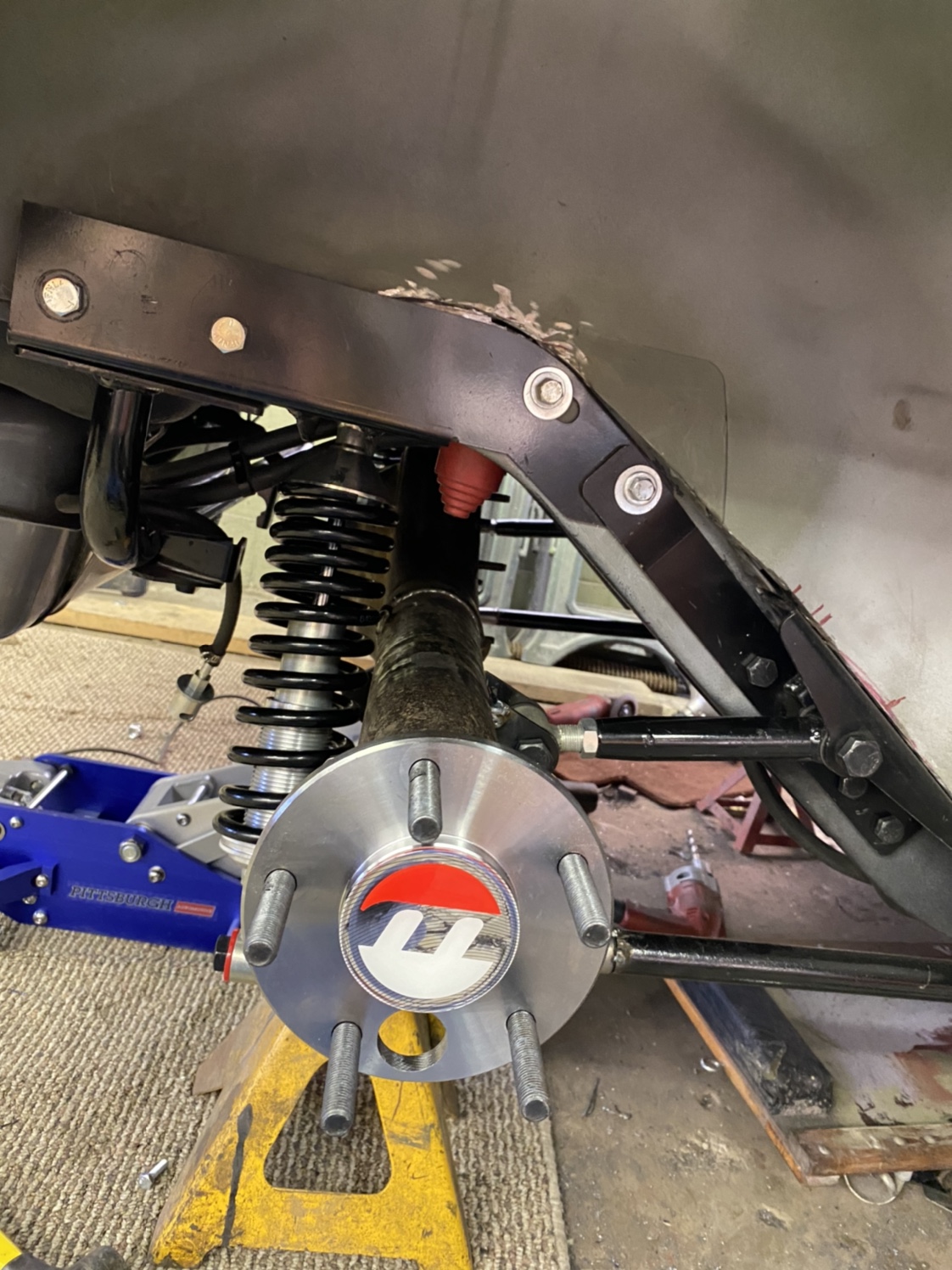

      - 4-Link Rear Suspension and Ford 9”
      I finished up the 4-Link kit from Helix Suspension. The install wasn’t the smoothest, however I got everything working with my Ford 9” and will just have to dial on my pinion angle. My Moser axles came in and I am very impressed with those so far. I just have to get a rebuild kit for the third member and change out the gear ratio to something around a 3.50:1 and the rear axle should be all set other than getting a custom driveshaft made.

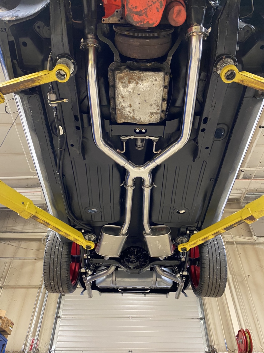

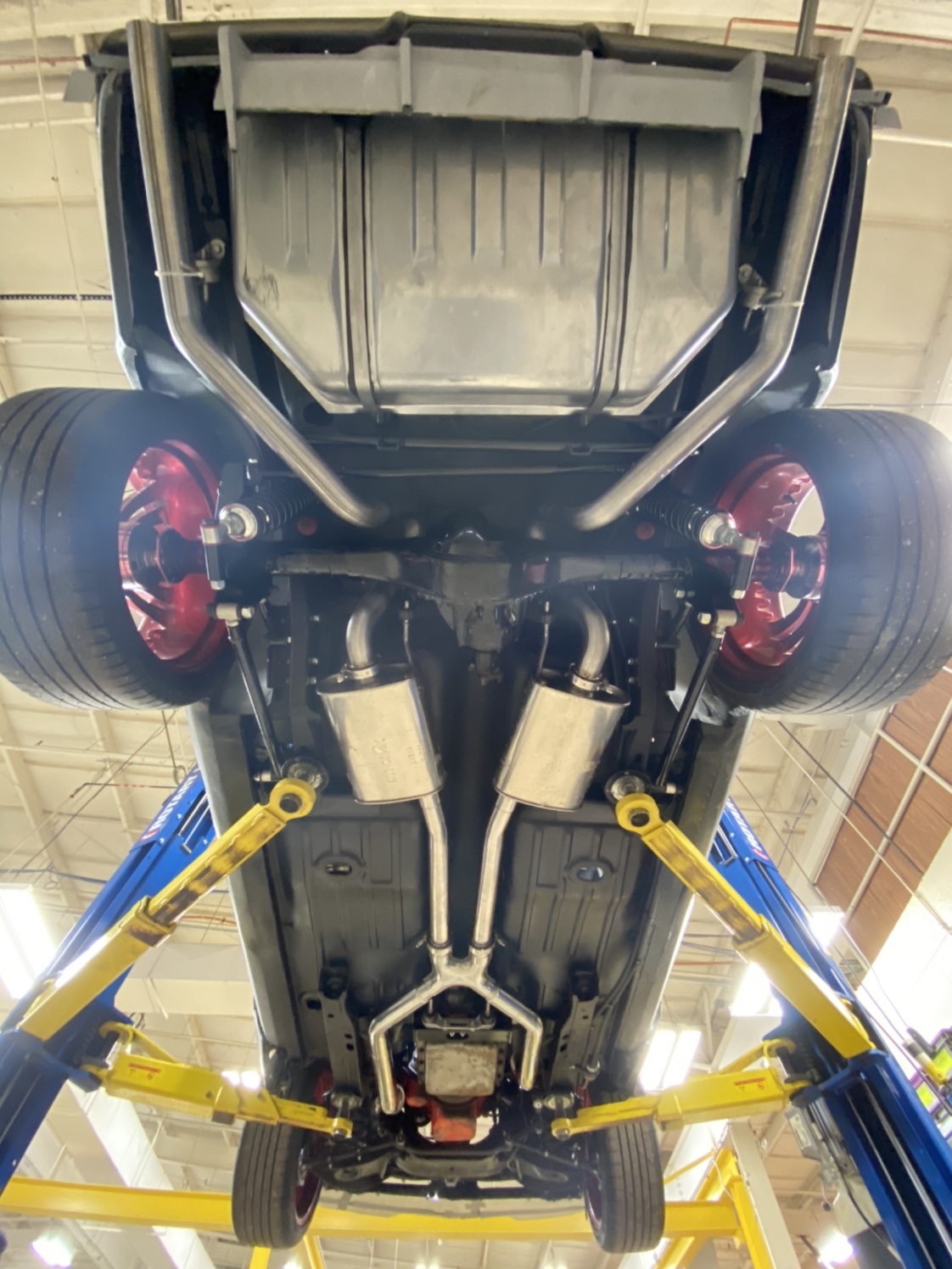

      -Exhaust System
      The exhaust system has taken up the majority of the last month or so, but I have basically wrapped it up. I swapped the stock manifolds over to some headers my friend had, and surprisingly they fit perfectly other than having to slightly dent near the AGR Steering Pump.
      The entire system is mandrel bent 439 SS with .063 wall for long term durability. Most systems are slightly thinner at .055, but the additional weight isn’t a huge deal for me. There are 3 main sections that are all connected by V-Bands for easy disassembly. The Header Collectors to X-Pipe, the Mid-Pipe to Muffler, and the Over-Axle Tailpipe are the main sections right now. Eventually, the Y-Pipe and tips will be welded in once I finalized my diffuser location.
      The system is 3” out of the collectors and then is sized down to 2.5” before going into an X-Pipe. The X-Pipe worked perfectly to tuck the system tightly down the driveshaft tunnel. After the X-Pipe the system goes into Dynomax mufflers that are tucked up in the pocket by the rear seat. The over the axle piece is made in two sections due to the fact that the mandrel couldn’t bend the entire pipe in one piece. Name:  IMG_3827.JPG
