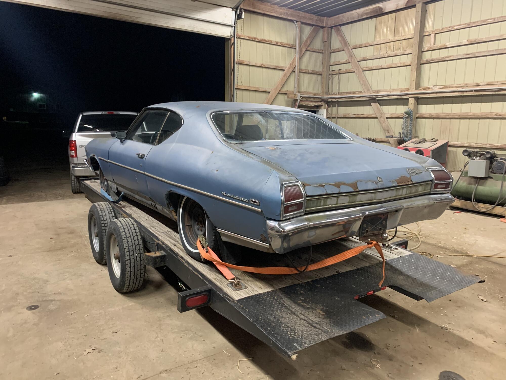

      i picked up a 69 chevelle malibu this April 2021 after having wanted one for about 2 years. I wanted a rough and cheap one since i knew id be redoing the whole car anyway. The previous owner had it since 72 and was forced to sell due to changing properties and having no way of moving the car really. It sat parked outside for about 20 years so its a rust bucket. It looked better on the ad but after a 6 hour drive to pick it up there was no turning back. Got back home at 4am and back to work at 7 haha.
      Blue exterior. Blue interior. Original 307.

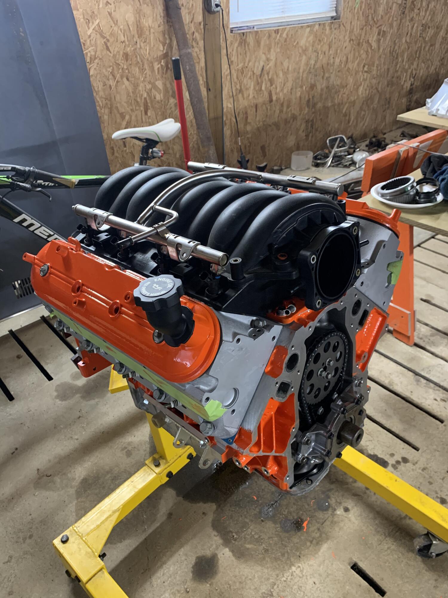

      bought an fresh build ls2 with forged internals and a custom cam.

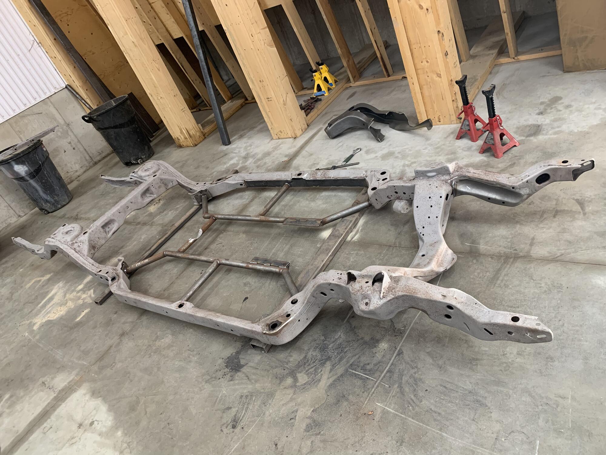

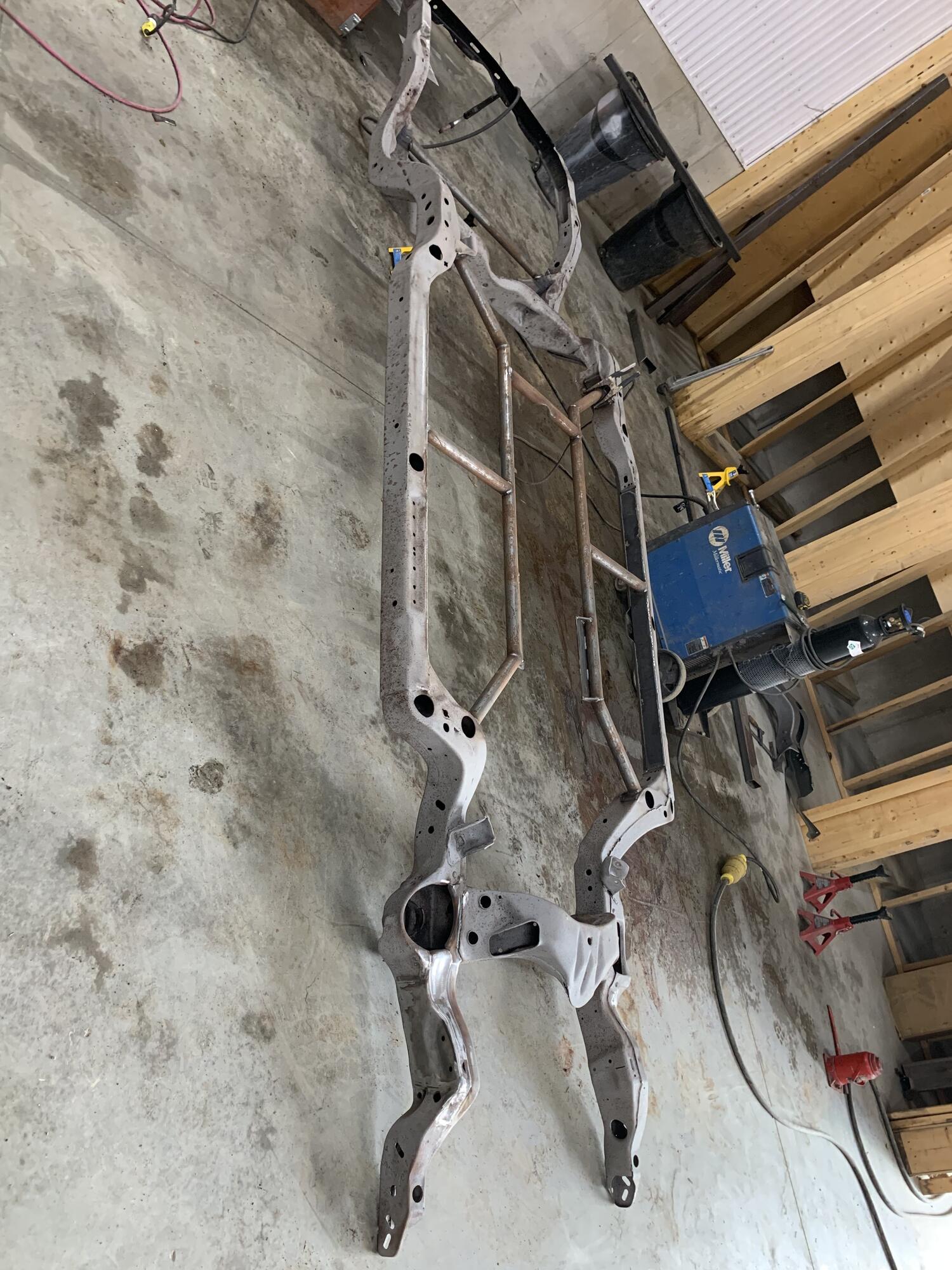

      straightened and repaired the frame. Then boxed and braced it with 1 3/4 pipe. Then galvanized. I have yet to confirm it didnt warp during that process

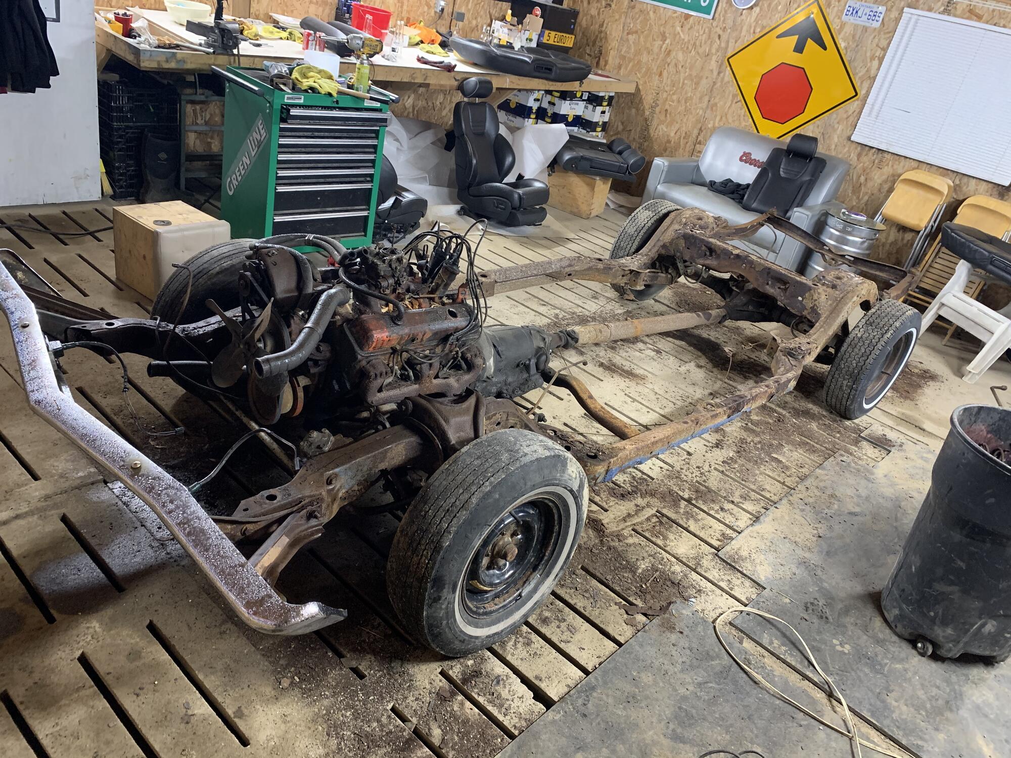

      Sep 2021
      72
Size:  439.9 KBName:  19262819-BD9F-4265-8554-E9B586886001.jpg
Size:  335.0 KBName:  3EB6F648-7240-4E96-BBEC-5676DADF1411.jpg
Size:  331.7 KBName:  FFF4677D-8F2F-4E7A-B82A-E451FFAD71BA.jpg
Size:  367.8 KBName:  3DE8F72D-CCC8-44DD-BCAA-7ED8D968C6E0.jpg
Size:  382.1 KBName:  CAFD8D40-E05B-4CD4-B22A-7667546B439B.jpg
Size:  407.3 KBName:  7F1F96A5-B43F-43A5-8CCA-497BD3D4D5D6.jpg
Size:  566.9 KBName:  AC0025F3-DABF-45E3-9BD4-6C3EBE5F15D3.jpg

      Engine is starting to look good

      Frame is back from the galvanizer.
      I was really worried about warping but it came back straight.

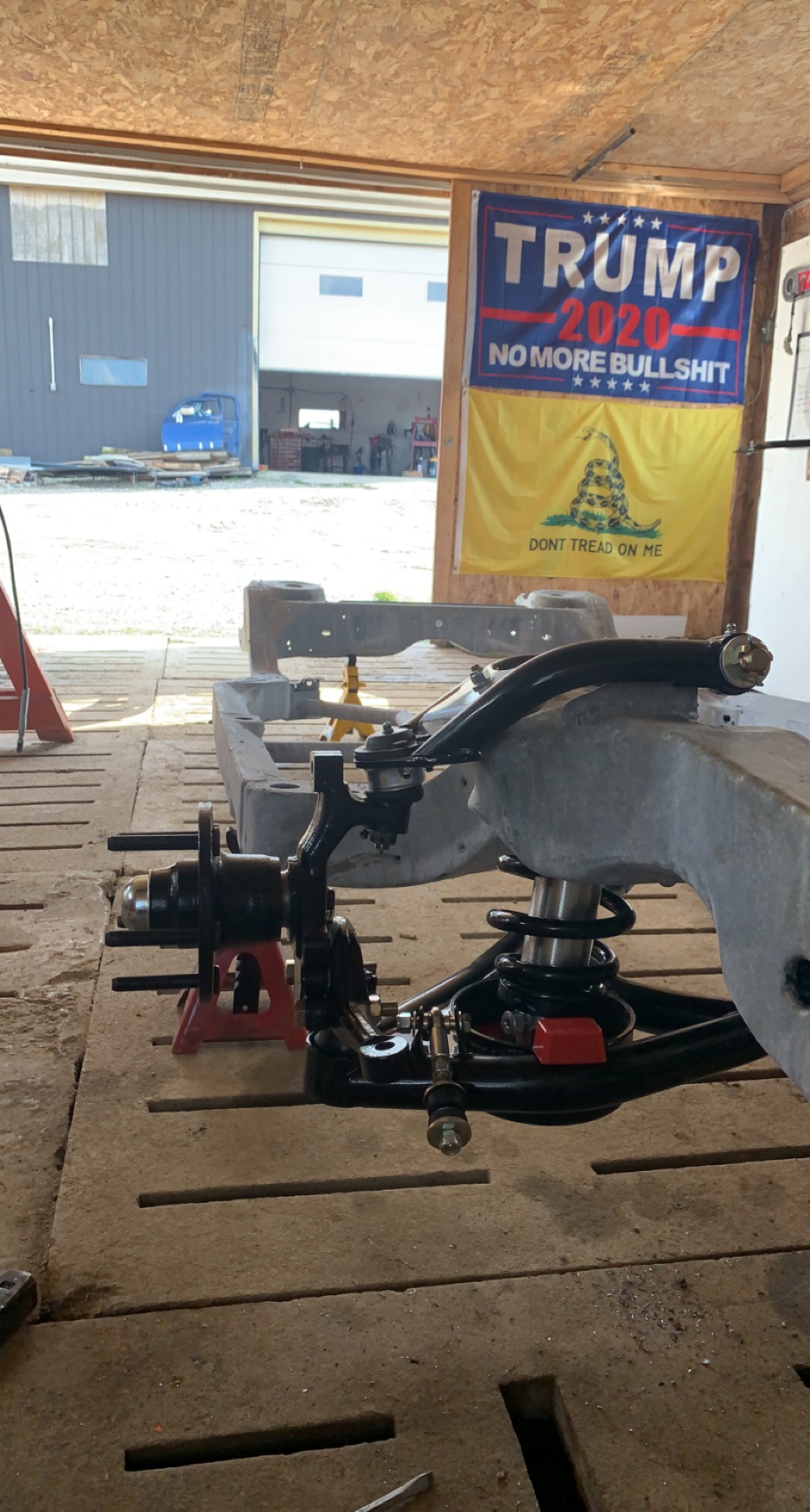

      Bolting up the front suspension now
      Ive used the drum brake hub on a disc brake spindle. It requires a 1/2” bushing on the top bolt hole to mount the laser cut plate. Then i can bolt up the 4 piston cadilac brembos. But i still need to purchase rotors yet too.

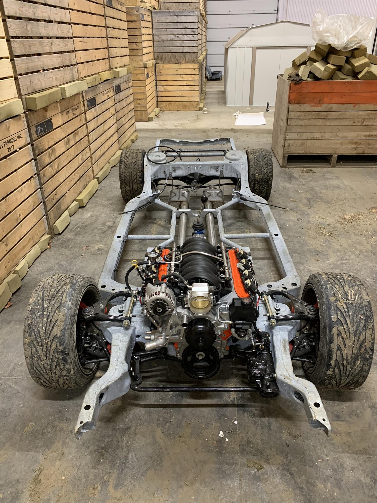

      Ive made some progress in the last few week. Got all the suspension and brake components on the car. Next up is engine removal one more time to notch the cross member a bit for my headers to fit. As well as to drill and tap the ls2 knock sensor holes bigger for ls1 knock sensors. Ill be using an ls1 computer and all sensors.
      Front brakes are c7 corvette. I had to machine my hubs smaller to fit the rotors.
      The rear are ls1 camaro brakes. Bolted right up to my 12 bolt but i needed to space out the calipers to line up with the rotors perfectly.

      I got a rolling chassis. That is 90% done
      But recently ive been working on the body.
