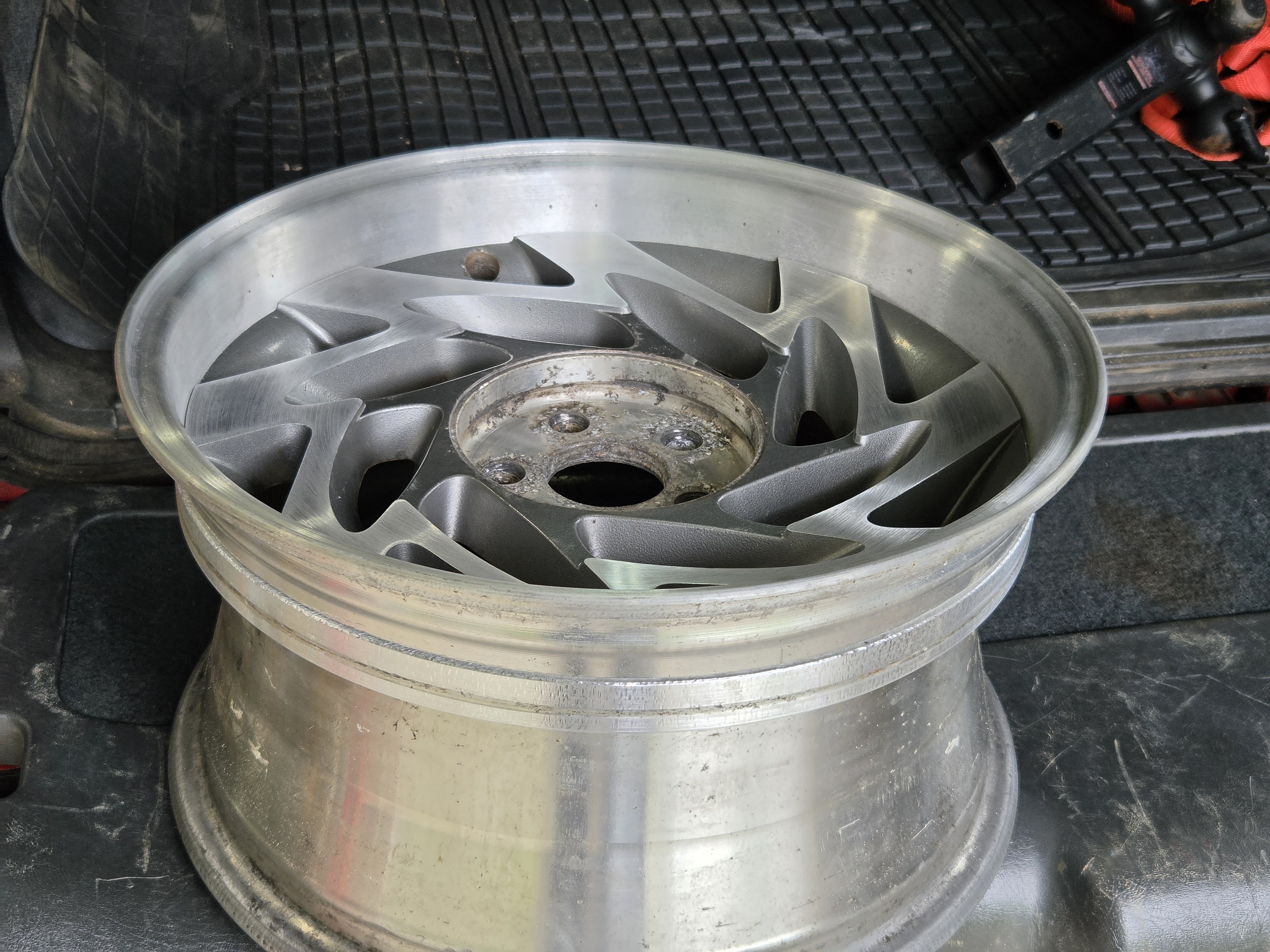

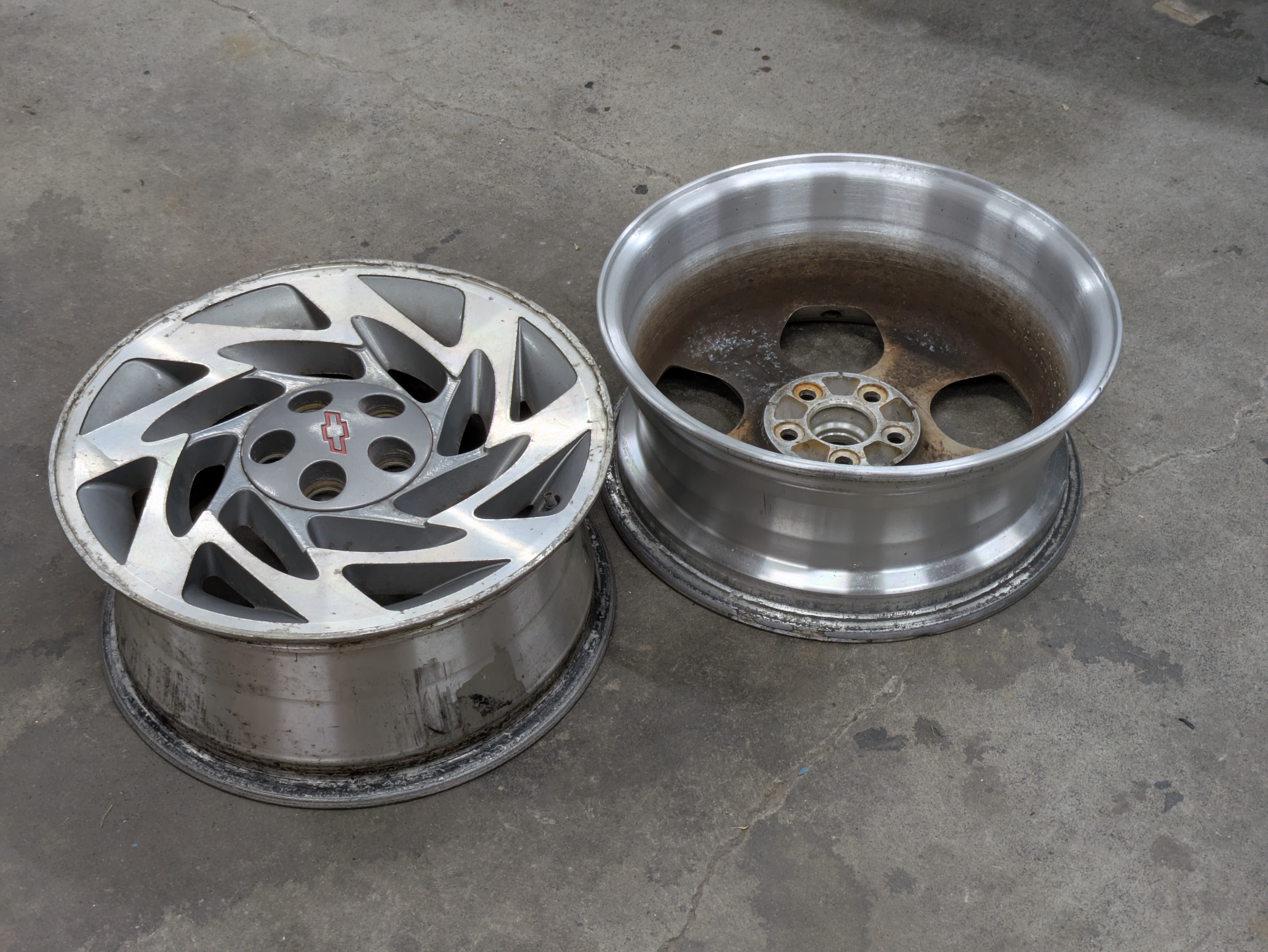

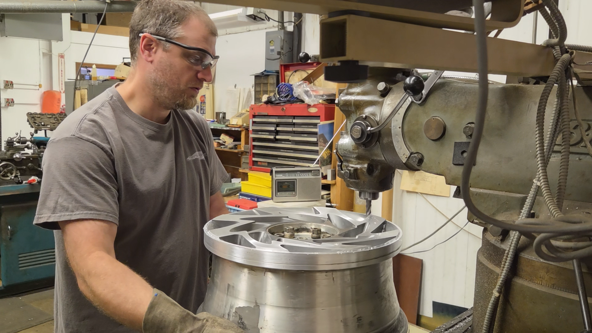

      New video with a few updates and a crazy idea underway. Cut 2 inches off the inside of another wheel and adding it to the face of a Z26 wheel. I'll just put these on the back with some fatter tires. Still gotta dial in the runout and weld em, but the initial results look good. I just bought an AC TIG a little while back for aluminum.

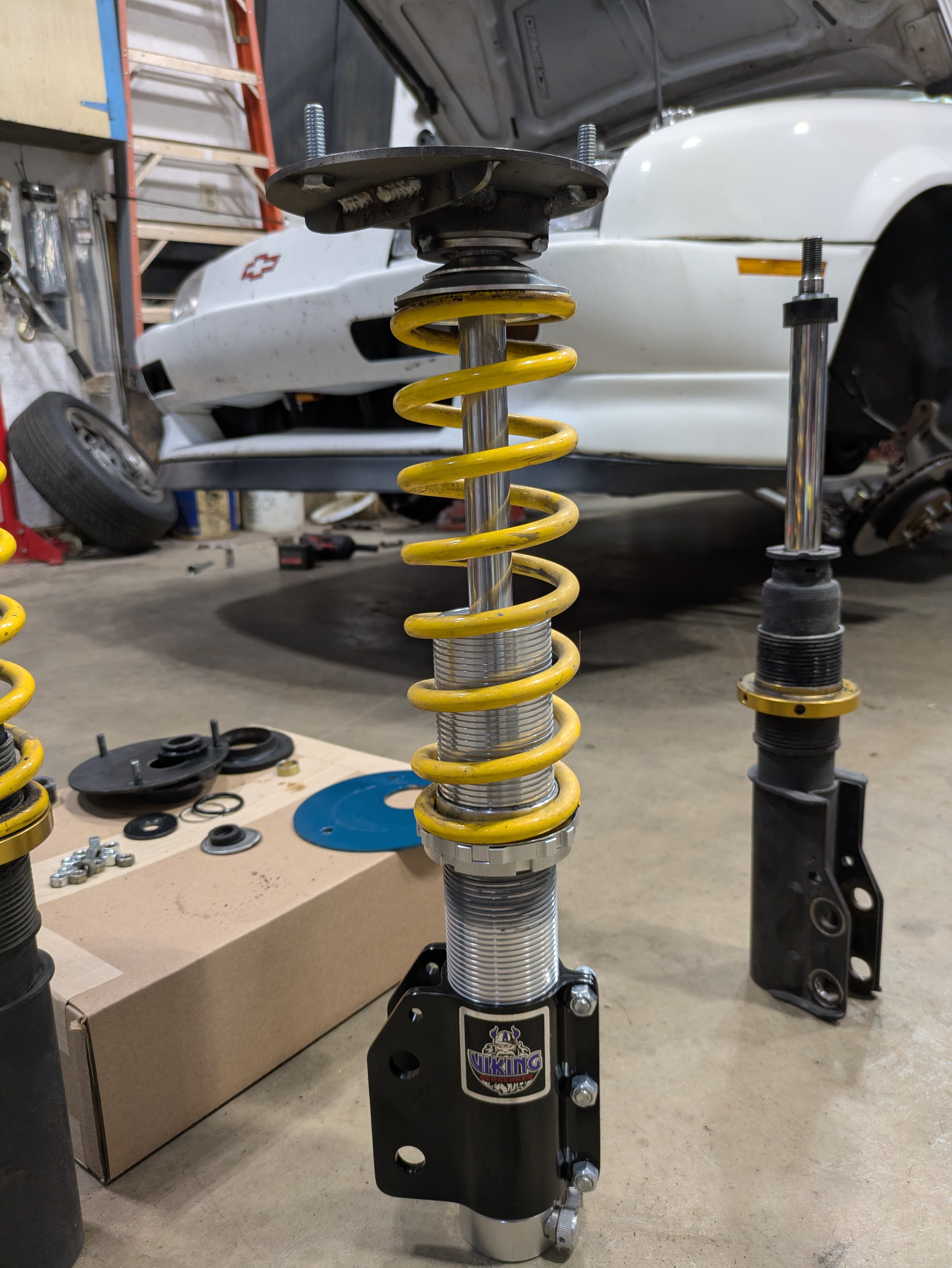

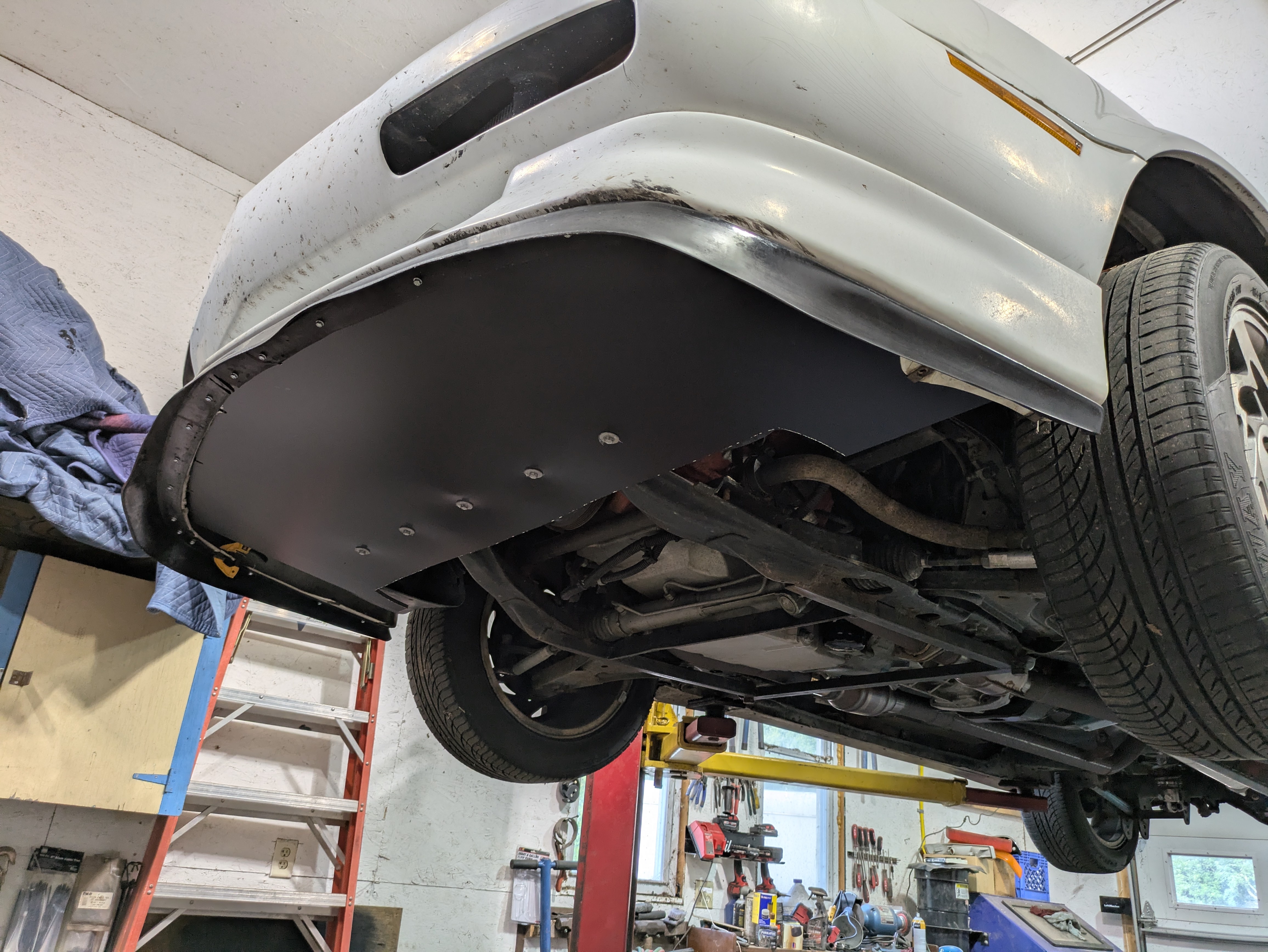

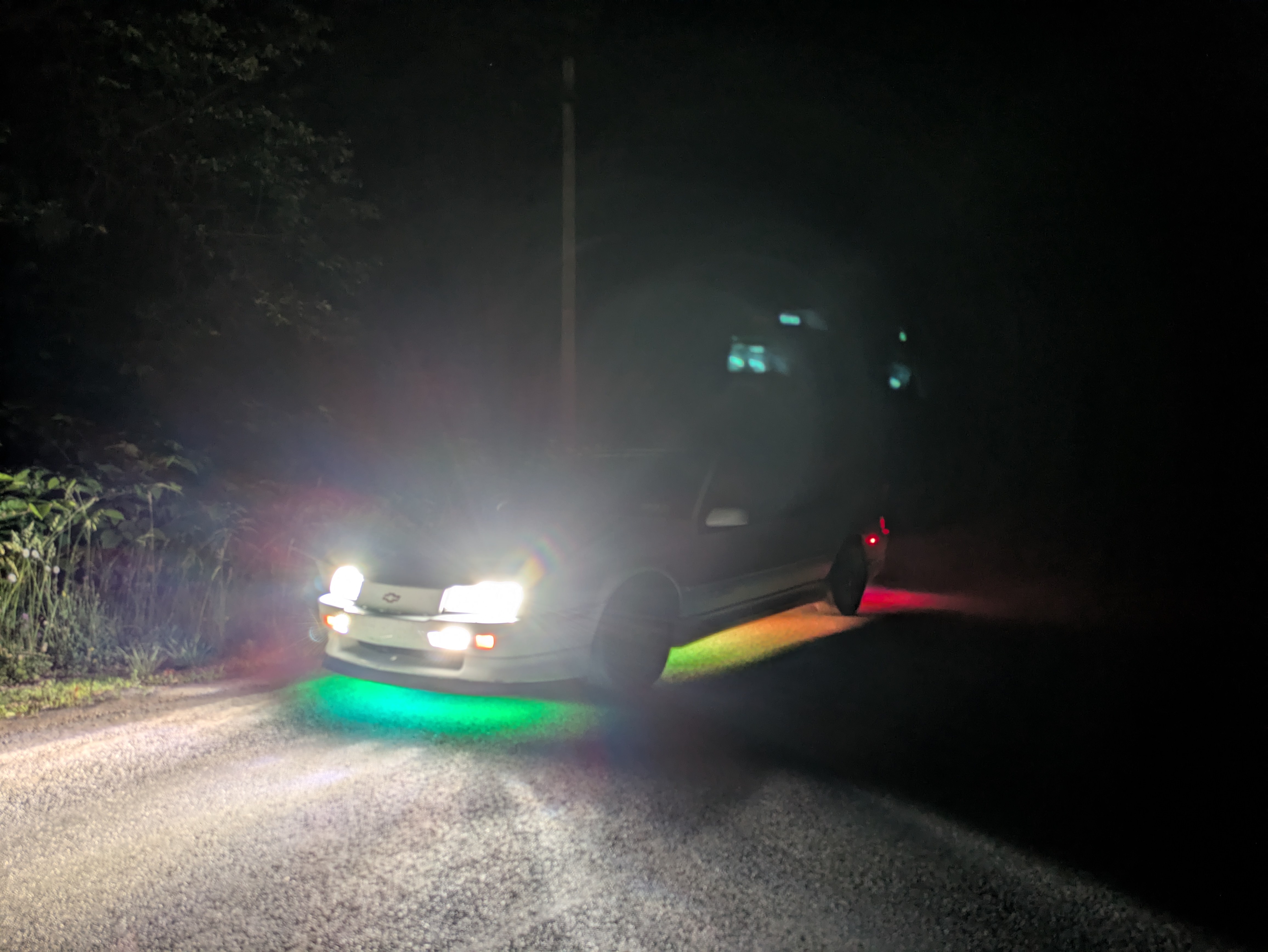

      Also got my Viking double adjustable Camaro struts in, needed some slight tweaking to fit...and my new strut mounts with a spherical bearing are much nicer than the poly. Also recreated the front belly pan & lip combo from my 91 with some new LED underglow. Came out nice.
