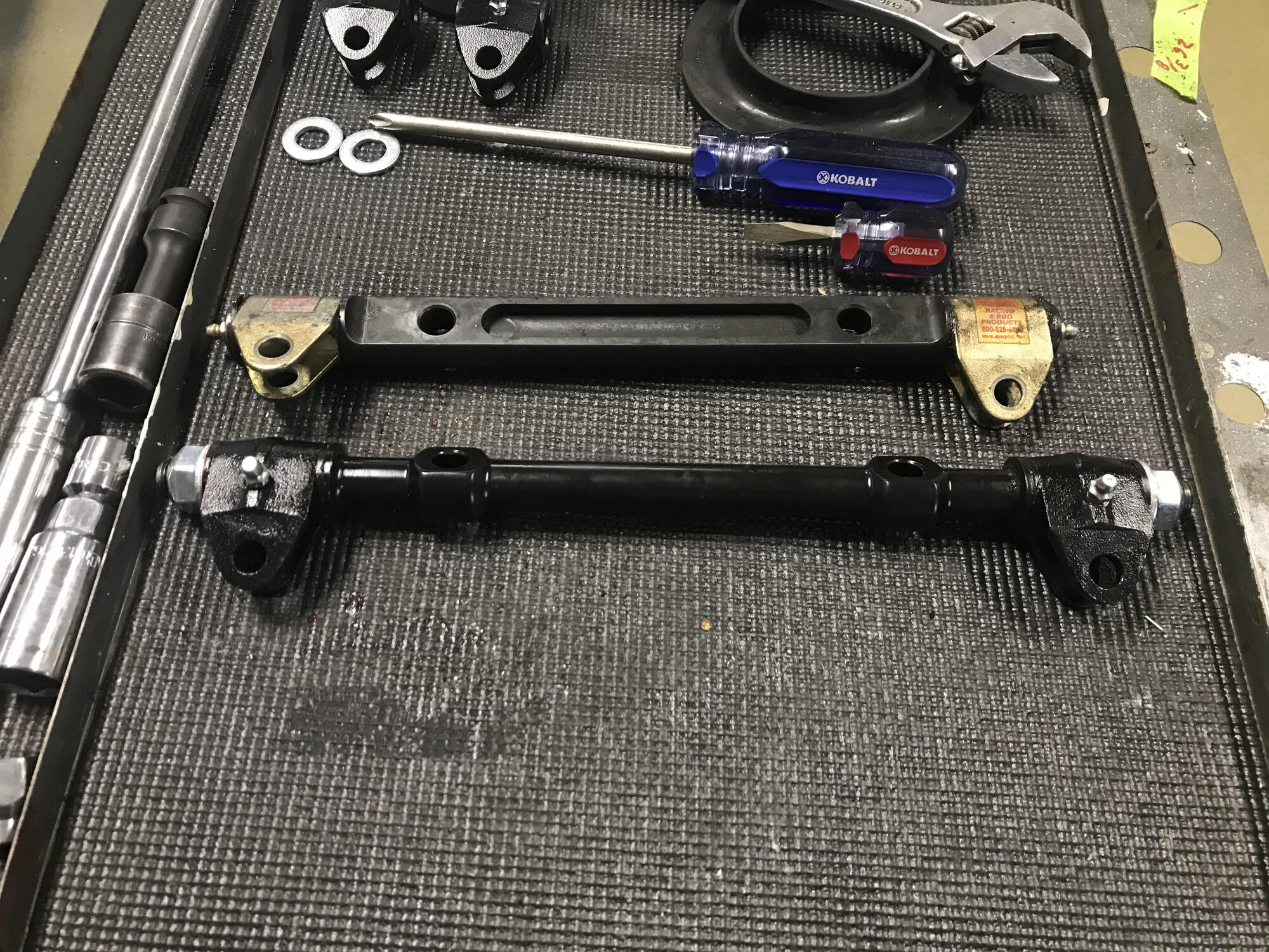

      I have the old style arms, and changed out the cross shafts to the newer style. Here is a comparison, old style on top of course.
      I had a version in between those ones haha. SPC has changed a ton!
      The tech at SPC did say my style of arm was OLD and they rarely see them any more. I got them from Mark at SC&C in 2009.

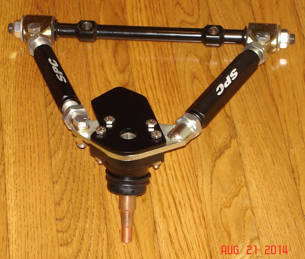

      SPC Upper Arms with Bump Plate
      I bought my SPC upper arms in 2013 during a clearance sale from an on-line seller called Ultra-Rev. I guess I have the second version as the cross shafts are of the weight reduced design. I don't know what bushing these arms use, but it doesn't look like rubber and they don't have grease zerks either. My car is not on the road yet so I can't speak to any ride quality/harshness issues. It seemed to me (after I bought them) that rubber and/or greaseable bushings might be s better design for a street driven car.
      I fabricated the bump plates out of 3/16" steel plate and mounted them to the top of the ball-joint plate using longer 1/4-28 grade 8 bolts. Here's a pic.

      Early SPC arms had a straight cross shaft with pivot tabs to the ball joint being centered. The next revision had a weight reduced cross shaft that looks like a bone. The pivot tabs to the ball joint were also changed to an offset. From there SPC came out with a forged ball joint holder vs the plate style with welded components.

      Quote Originally Posted by protour_chevelle View Post
