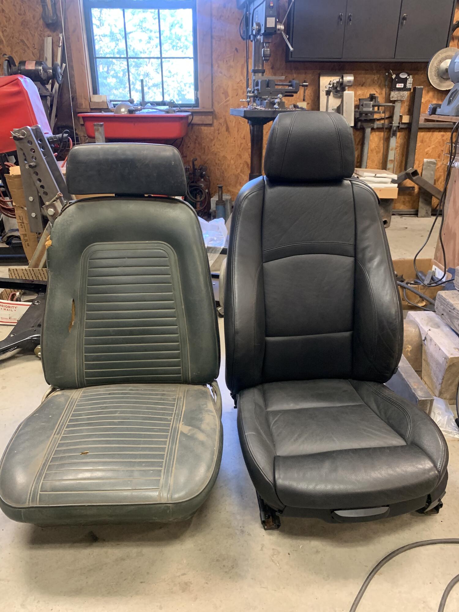

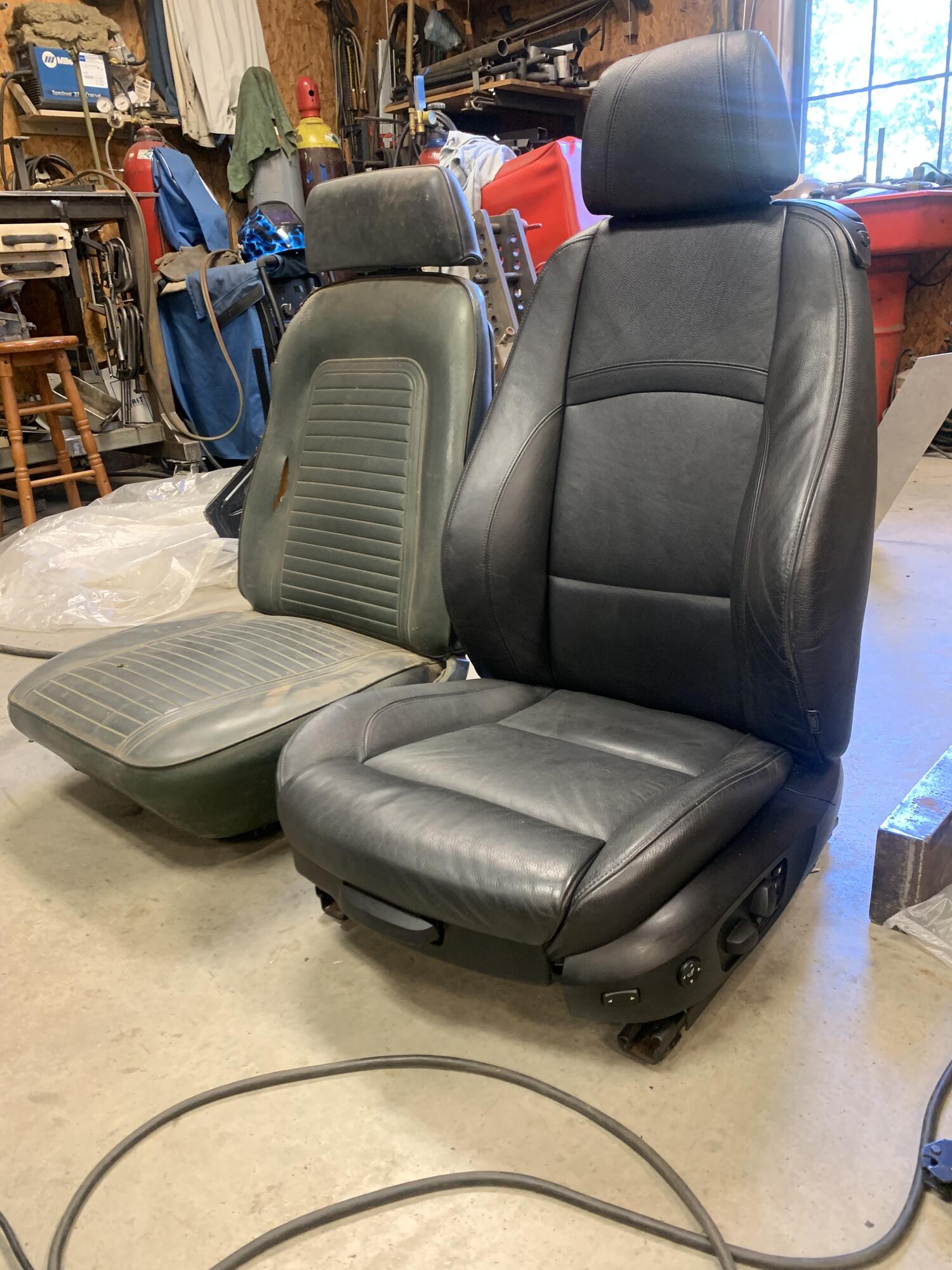

      I’m In the process of mounting my seats and I don’t want to crowd the doors but I have a 5th gen console which is a bit wider. So I’m trying to split the difference. I bought a pair of BMW e92 seats. They are a little lower than the stock seats but the stock seat springs compress further so you actually sit a bit higher. I am going to rework the seat support to gain about an inch of headroom but there won’t be any side to side adjustment so I need to get it right the first.
      I'm posting a couple pictures of the seats compared to the stock seats just for the guys out there looking for comparisons. Side be side pictures were few when I was hunting them. Name:  0E2D447F-D1DF-4B74-96AA-8F4ABD88A475.jpg
