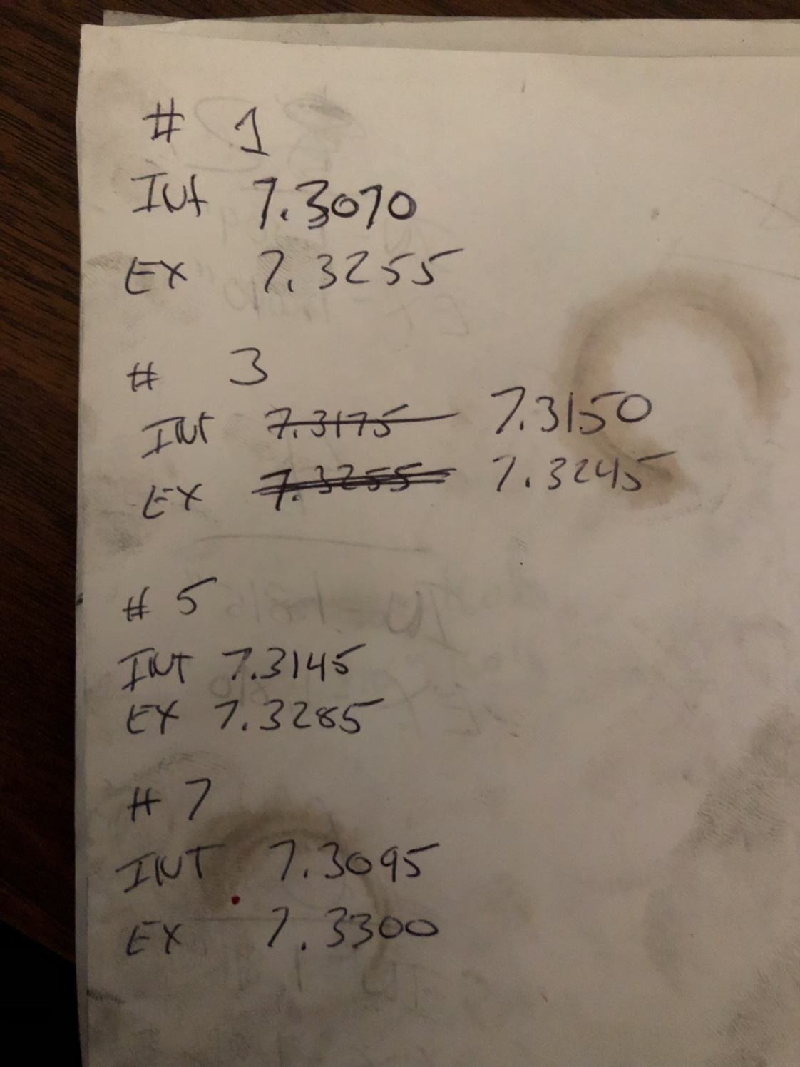

      Pushrod length
      Bone stock ls3 besides summit 8707R1 cam with .600@ lift on both lobes
      And johnson 2110 lifters
      Is it normal to measure varying pushrod lengths?
      Using ms racing ls pushrod length checker and checking springs
      I did the odd bank today and these are my results
Size:  299.1 KBName:  IMG_6341.JPG

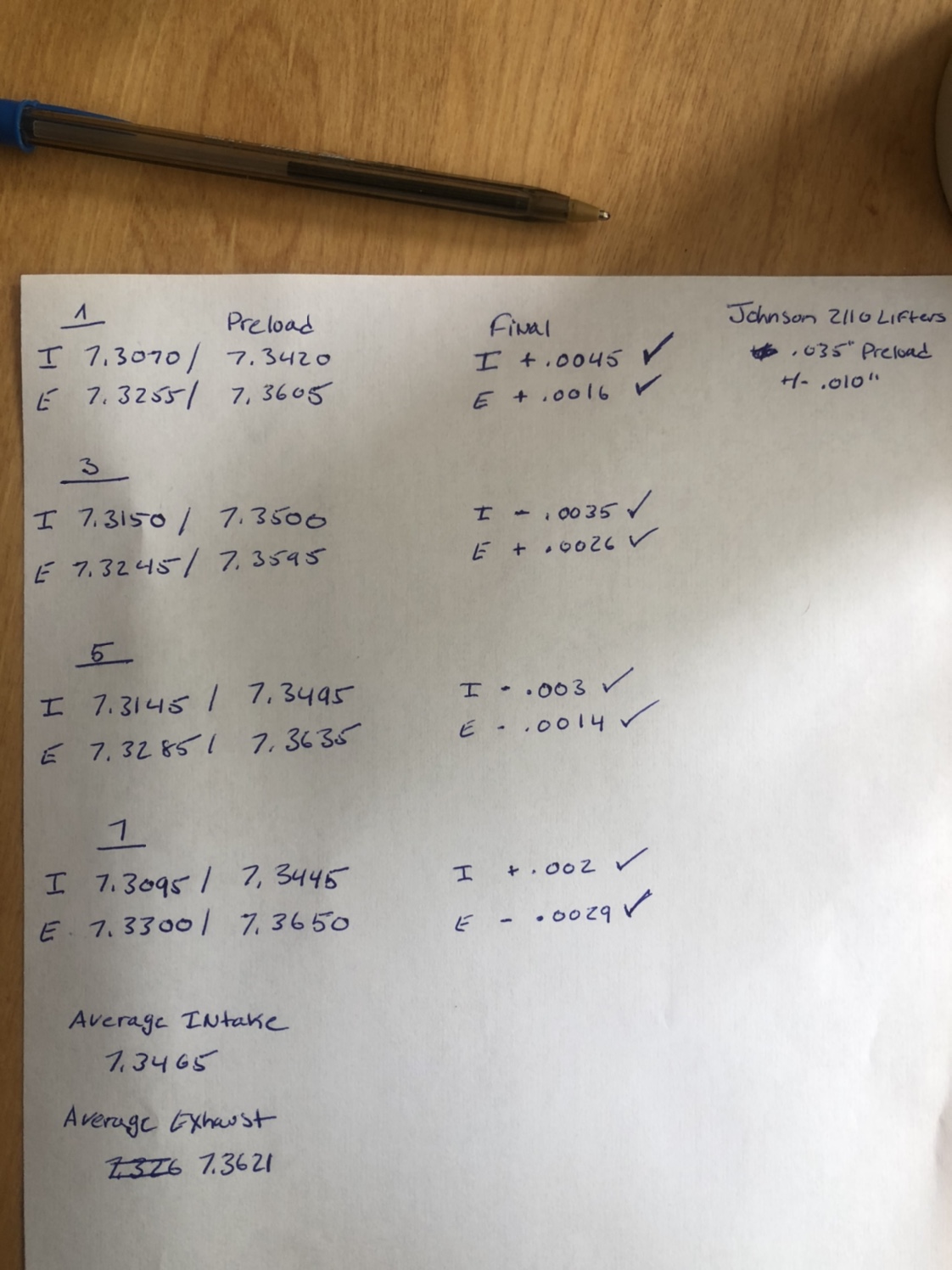

      Figured i would try some math
      Is it good to add up all my intake #’s with the .035” preload and then divide by 4 to get the average pushrod length then add or subtract that average number to each individual intake to see if i am within the recommended .035” preload +/- .010”
      This method i became well in spec
      Same was done with exhaust
      Once i do the even bank i will divide by 8
      But doing this experiment has my intake length at 7.3465” and exhaust at 7.3621”
      I can easily order custom length pushrodsName:  IMG_6349.JPG

      Are you checking and verifying the wipe on the rockers?

      Thats my next step

      Hmmm I thought the wipe determined the pushrod length. Admittedly it’s been a while and I dont do this very often.

      Its an ls3. Bolt down the rocker to zero lash on the checker then add preload to zero lash length so i dont think u need to check wipe
