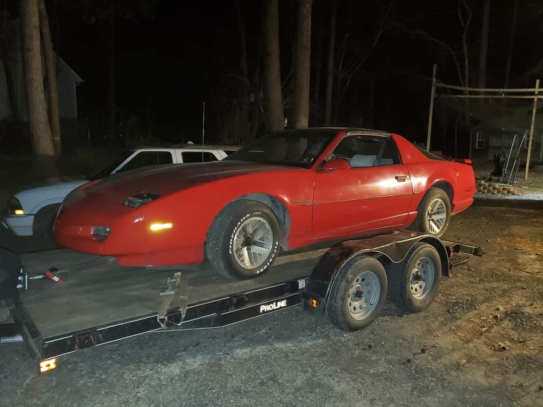

      Here's when we brought it home.

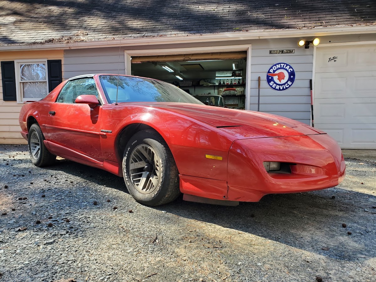

      Unloaded and reinstalled headlights

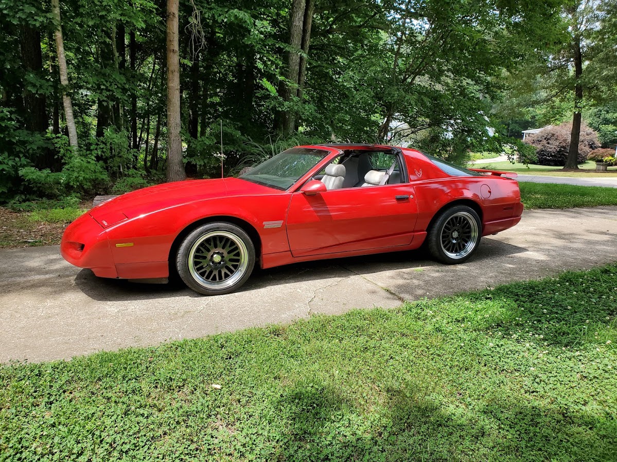

      After we got the car looking good, we had to set our sights on getting a hair less altitude. I was getting tired of the 4x4 jokes, so had to do something. I plan on doing something good with the suspension on the car at some point, but for now wanted to get it lower on a budget. Back into the attic I went and dug up a set of BMR lowering springs for the rear. Then I pulled the soft factory springs and cut half a coil off. Got about 1.5" drop and looks so much better. I still need to install some new shocks in the rear but pretty happy with how it sits now.
