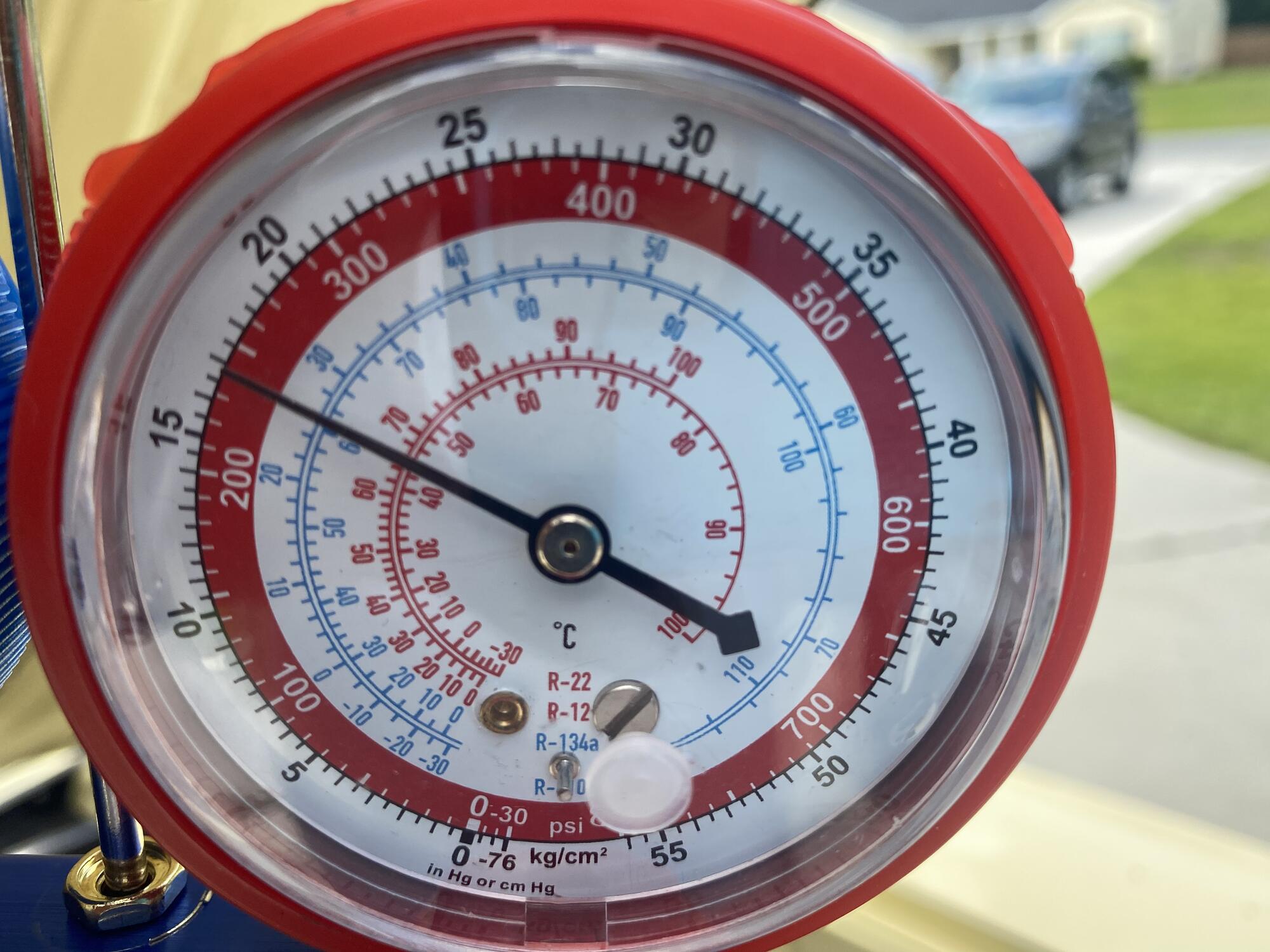

      I just put in a ACsystem vac it down no leaks put the pag oil like required then tried to gas it could not get the low side to come up? Anyone have any ideas what wrong. It was 95 here as I was trying to has it.

      1.7 pounds. It’s not weird that the low side is so low?
      Sep 2010
      Beach Park IL
      3,052
      Not to me......It is the suction side. If it wasn't making cold air, I would be alot more concerned. High side is higher than I would prefer but if it is holding there I wouldn't worry about it.
      Donny
      Jul 2012
      eden ga
      679
      I just have never seen a system have so low pressure on the low side.
      Sep 2004
      Vacaville, CA
      133
      Quote Originally Posted by 5spd540 View Post
      We see that regularly with VA. Not to worry. I used to have a Lexus tech service my VA installs and he said a system can’t possibly work with that low a pressure on the low side. But it does!
      Tim
      67 Camaro RS
      64 Nova SS
      1,753
      Some aftermarket manufacturers intentionally run low suction pressures to address the use of a smaller evap. Refrigerants have a steep boiling point vs pressure curvein thi region, so a few psi suction pressure reduction makes a large change in evaporator cooling. Low suction pressure evaps do run a higher risk of evap freeze-up
      OEM's address this by using larger evaps and higher suction pressures.
