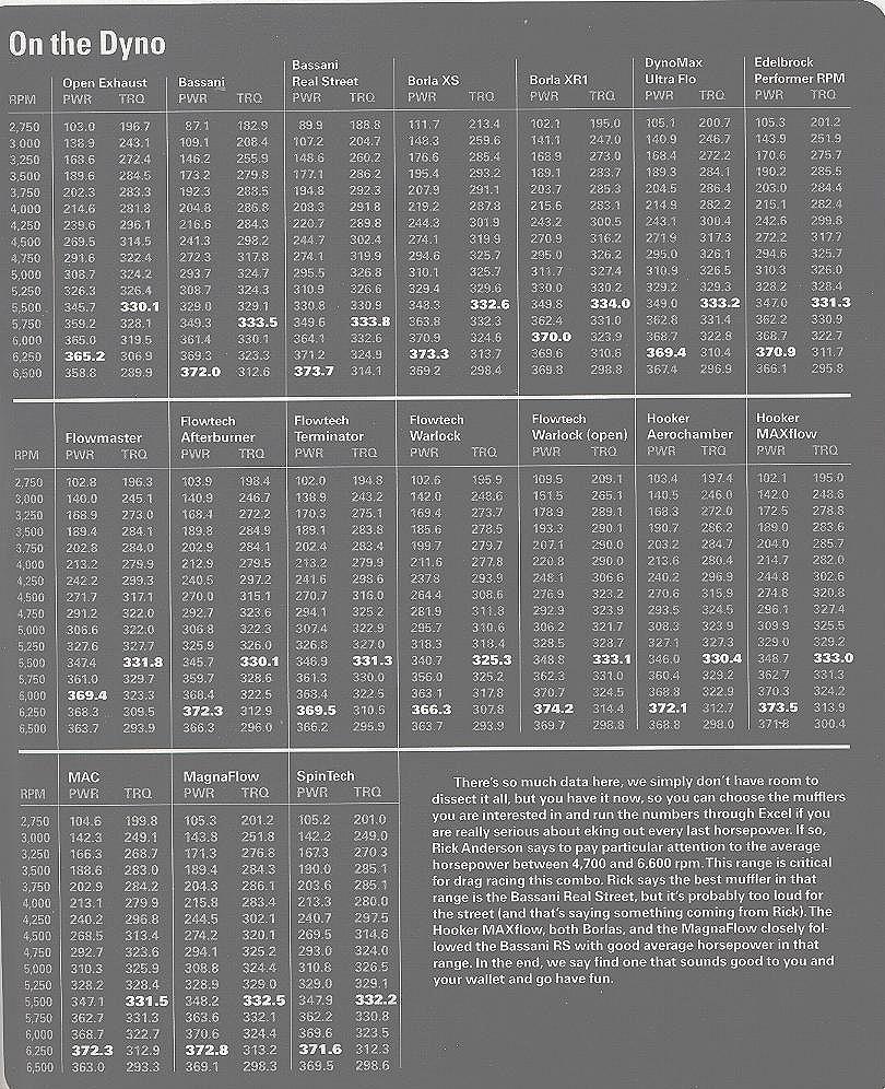

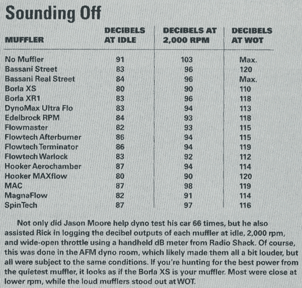

      Borla XS are one of the most quiet yet best performance mufflers you can buy. Great tone as well (low).

      I got this Magnaflow kit, I had to shorten the length of some pipes and I dumped the exhaust right after the mufflers because of my IRS, but overall it fits really well. I also have long tube headers with Magnaflow high flow cats. According to that sheet, Magnaflow are 2nd quietest muffler and gained HP and torque. Can’t comment on how quiet the ride is just yet

      68Formula, I was looking at that exact test and came to the same conclusion about the Borla ProXS. I ended up buying a pair yesterday and Jeg's is saying that I'll have them by Friday. I bought a set of 3" tailpipes since I'm boosted. If I was running N/A I'd definitely be running the 2.5" for an easier install and like you say, no real penalty.
