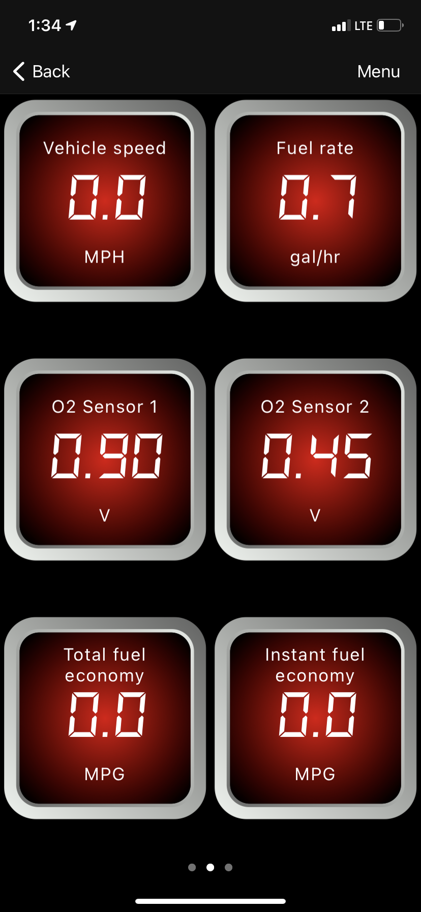

      Thank you Tim, so update: OHM test was good. Back probe was good with a test light saw flicker at pin # 38 of the ECU. Then retested with node light and it started working. But the header pipe was still cool ... pulled the plug, found a crack in the porcelain. Changed the spark plug.. boom nice color on the Exhaust Pipe.
      Then #8 started same problem no light at injector... I figured messing with the connector may have disturbed connections.
      cleaned reseated then 8 lites up the noide light. Still doesn't feel like its running on all 8 though.
      P0141 and p0171 and p0174 .... One o2 is pinned at .45 the other cycles between .90 and .04
