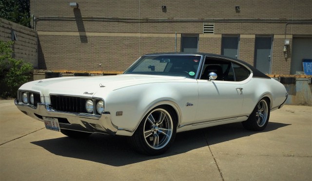

      C5 brakes as well, 18x9 front and rear. 255/45 and 285/40 in this photo.
      Not a 71-72 obviously, hope this helps.

      Still a 285/40 in the back, but it has 255/40 in the front in these photos.

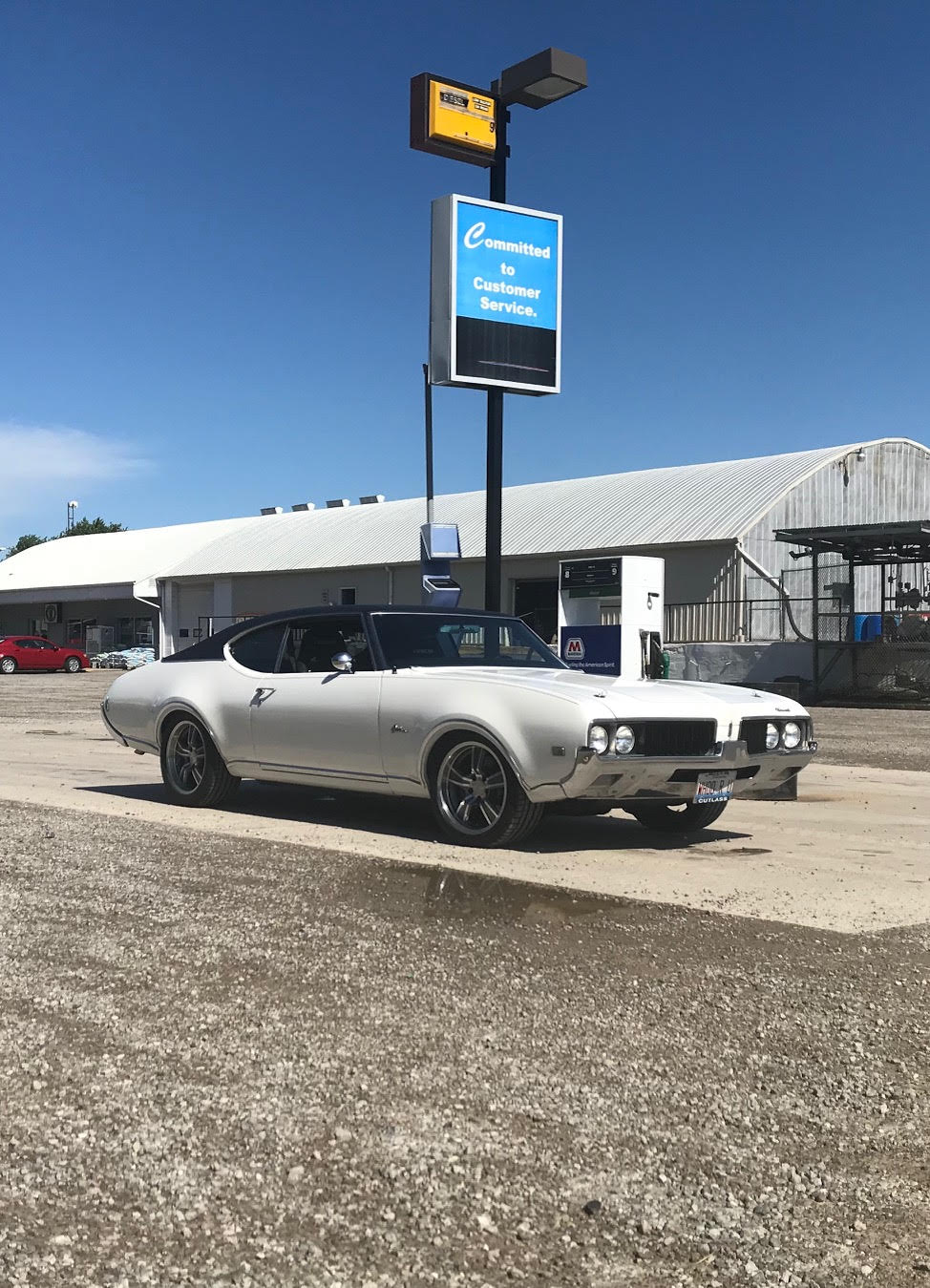

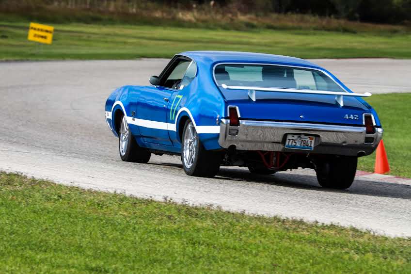

      Not a '71 either, but I'm running 285/295 front back. Wheels are C6-Z06, 18x9.5 all around with a hubcentric wheel adapter at 1.375'' thick.
      In the pics I was running 2'' drop spindle, 1'' drop Hotchkis spring, tall upper and lower BJ and SPC 3/4 spacer(to cancel out the drop form the lower BJ that was too much). My new setup sitting on the hood at the moment is stock spindle, 1'' drop hotchikis spring, SPC lowers with 1/2'' spacers under the spring.
      Brakes are Kore3 hubs with 14'' Z06 rotors and Aero 6 calipers.
      I like my setup for now, but I love the look that Mr. Nick is running above and would probly head back towards a dished lip front/back when I get enough money to spend on legit rims.
      I'm pretty sure after '69, the fenders actaully flare out, instead of ours where they heavily curve back in, so you should be able to go a bit bigger...

      Jetmech - are your wheel openings trimmed at all? Running plastic inner fenders up front? I'm surprised you're able to clear those tires, be that low, and chuck it into a corner. I dig it!

      Hey Nick,
      Yeah I should have added that the rear lips are fully rolled, and in corners they would still rub hard on the inside and outside due to axle movement-then I added the Watts link and haven't had it touch since. `
      The front lips are not rolled and I still run the red plastic inner fenders, the tires will kiss them on hard bumps, but not corners. I'd like to address it, but it's low on the priority list you know? Also, at full lock I can get the tires to rub the frame, but that's only ever at parking lot speeds(again not ideal, but it doesn't cause me much worry).
      Im in the Schaumburg/Naperville area. Those pics are from Blackhawk Farms Raceway just below the Wisconsin border. If I could dig myself out of all these other projects, I could get the new brakes on the car and get to Autobahn Country club, and Gingerman. Road America is close as well, but I need a lot more confidence and seat time in the car before I try that one.
      I gotta say man, the more I look at your car the more I feel comfortable with reducing my rear tire height. you've nailed that perfect balance of "clean sheet metal" and perfect wheel/stance.
