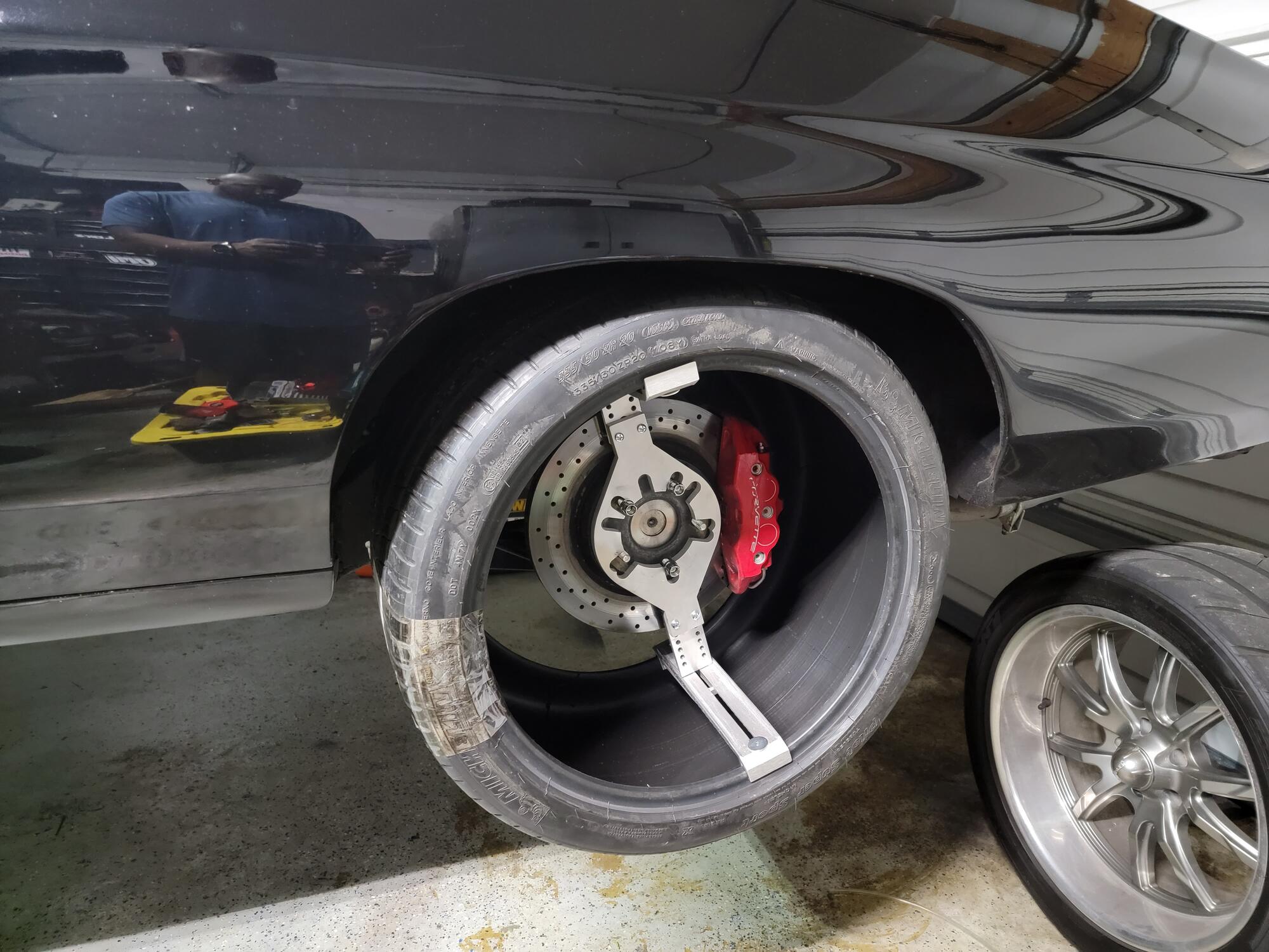

      I got the wheel fit tool in the other day. Had to mount it backwards to figure out the backspacing. The instructions for it aren't very clear. Looks like a 4.75 backspace on a 12 inch wheel with 335 30 20 with an inch clearance all around. Name:  20210407_204552.jpg

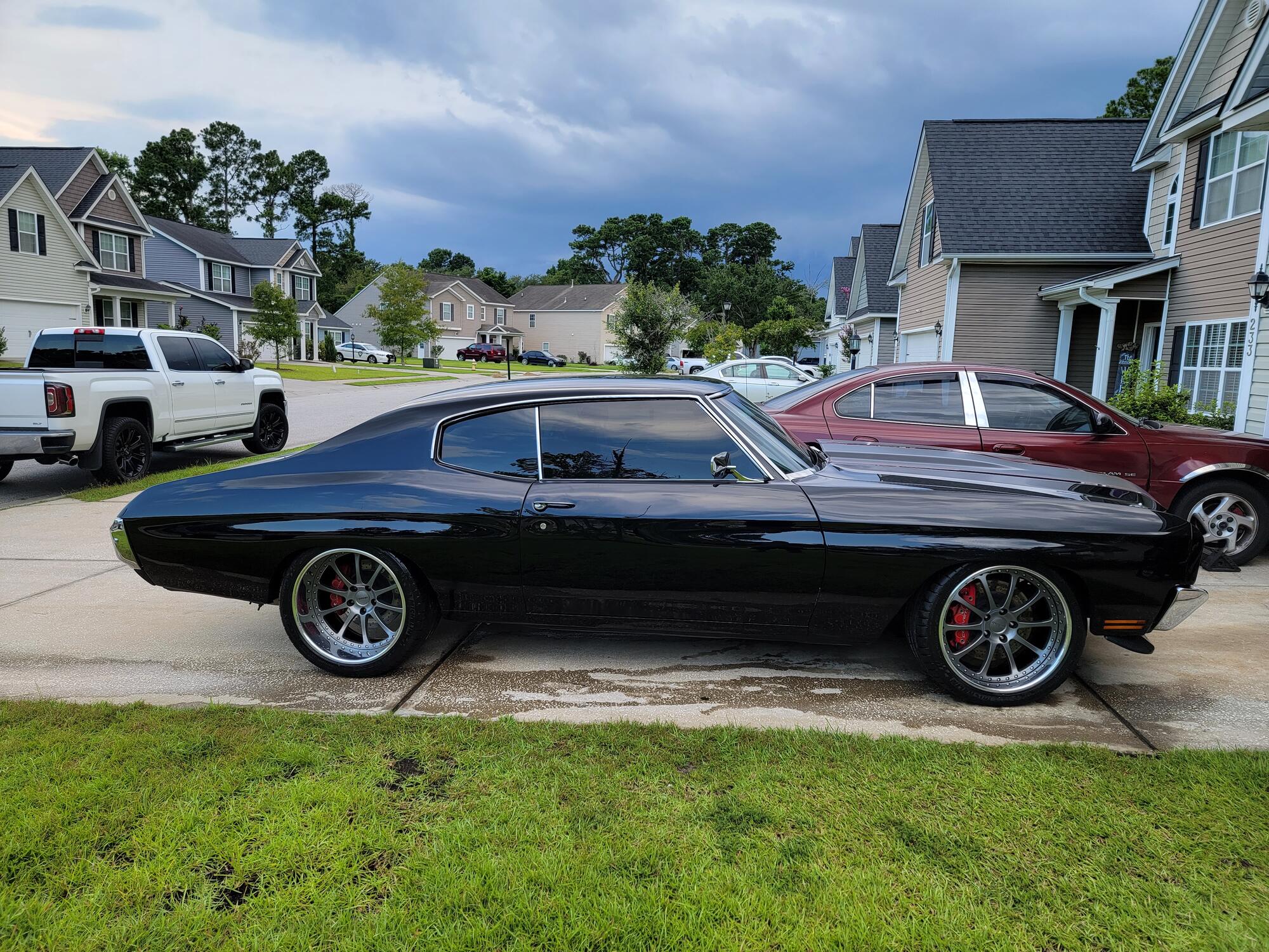

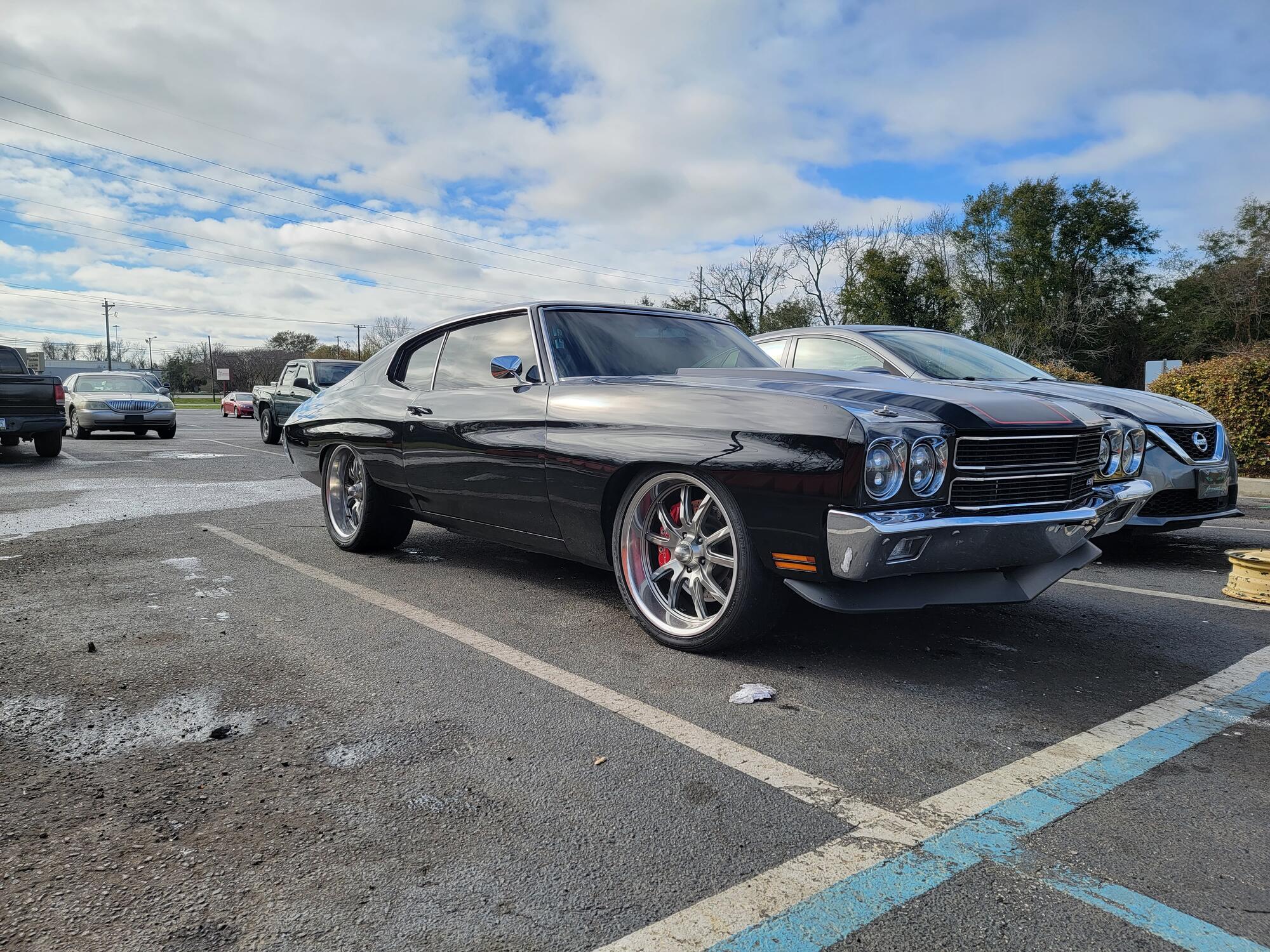

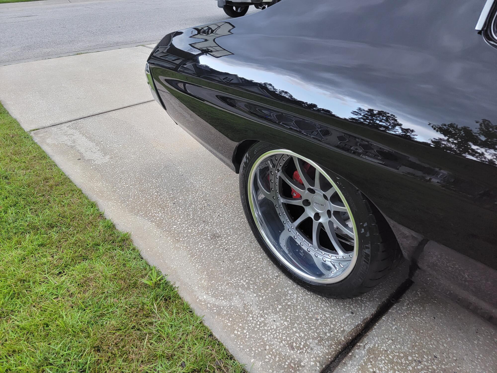

      Got my wheels in, everything fit prefect, wish I went with a 345 wide tire on the rear as there's plenty room. Name:  20210709_182259.jpg

      Very nice! Yeah, when I ordered mine I just told them C6 Z06 calipers and they got it perfect.
