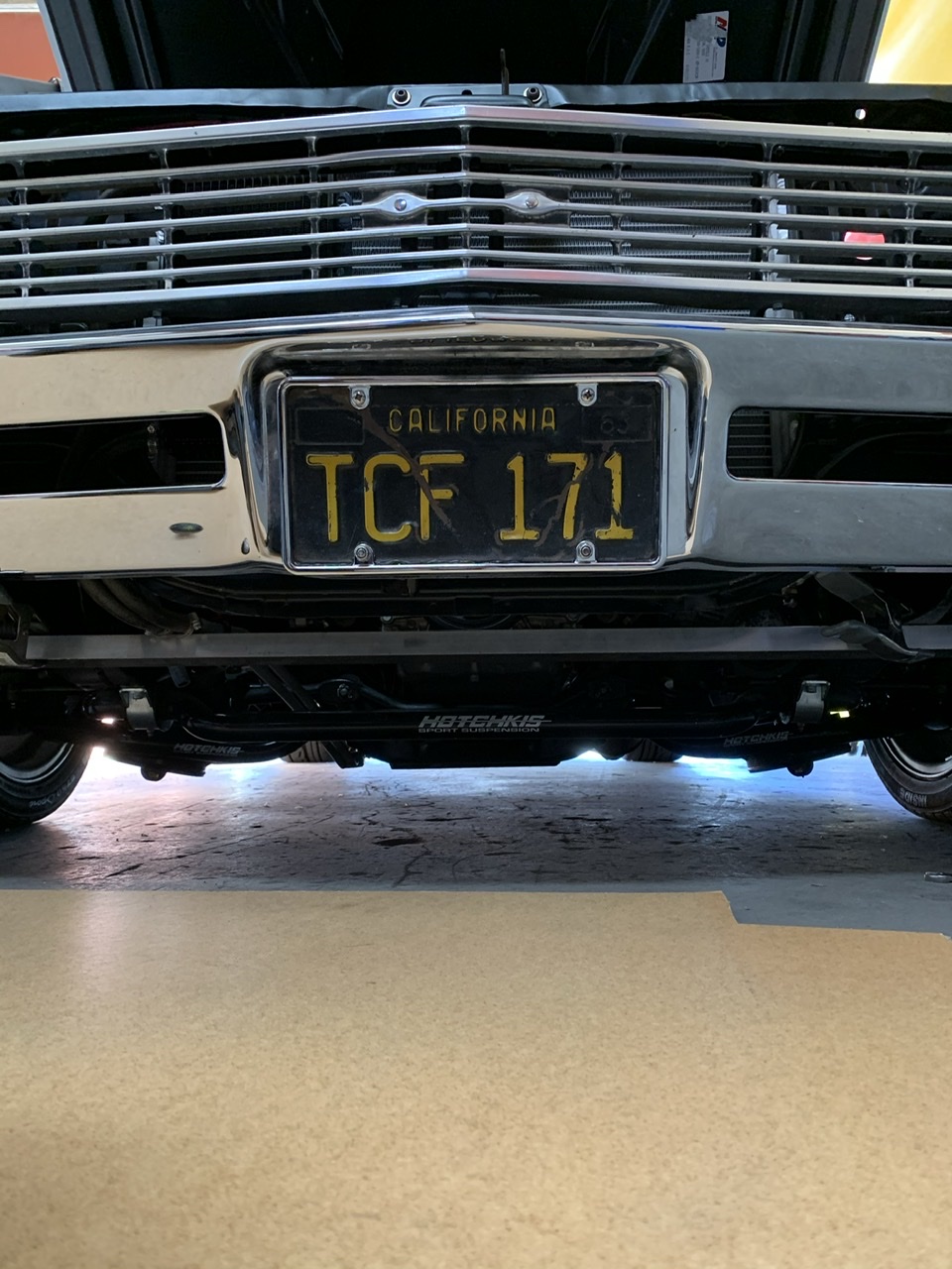

      I too have a 66 Chevelle but looking at it closer I may be to low for one of these. I’m thinking of making one too but going over the top of the sway bar.
      Here are a couple pics of mine with a piece of scrap aluminum across the frame horns a couple inches behind my radiator. You can see how low I’d need to go to go under the sway bar.
Size:  309.3 KBName:  E657C5D9-F238-490B-B0F3-52DE879D2E99.jpeg
