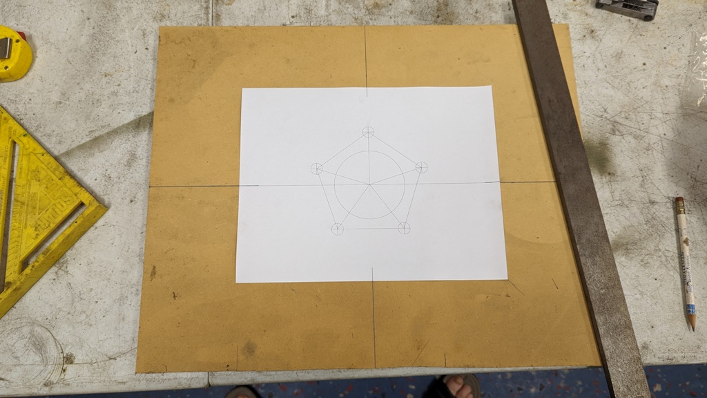

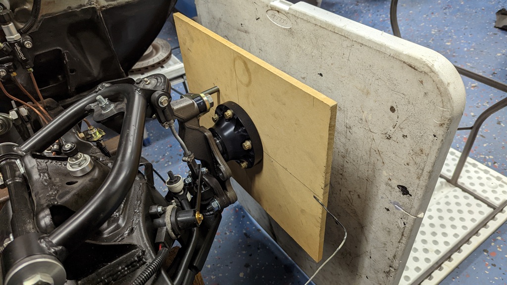

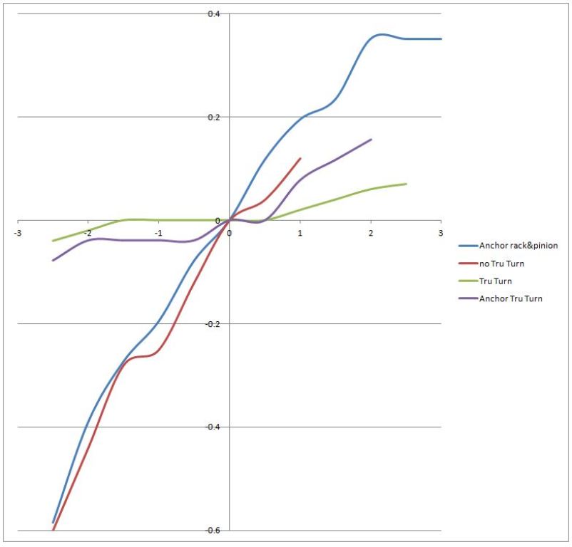

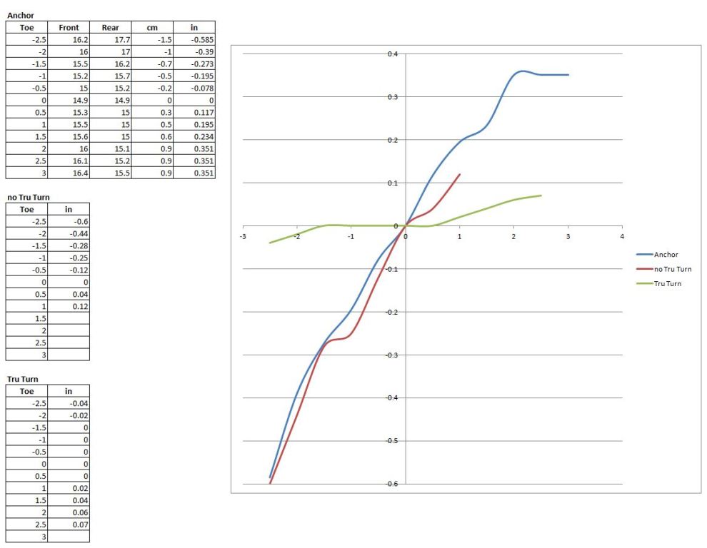

      Time to re-visit the front end alignment. As you may recall I am using a Flaming River power steering rack and pinion with the original steering arms. I'm also using hubs from Kore3. I want to see how bad the bump steer is with this setup compared to stock settings and the ridetech Tru-Turn setup that uses a stock steering box.
      I dialed in the camber, caster and toe settings the best I could before measuring bump steer. I made a tool to measure the bump steer from a piece of MFD board.
      I used my folding table as a flat stationary plane and a bolt in the brake caliper bracket to prevent the board from rotating on the spindle. I then measured the distance from the front and rear (spindle center point) of the board to the folding table then subtracted these values to obtain the toe-in/toe-out values as I compressed and de-compressed the shock from the middle riding height in one half inch increments. I used a wire mounted to the subframe as a pointer to the board. This method may not be as accurate as using a tool designed specifically for measuring bump steer, but this is free whereas the tool is kind of expensive for something I probably would only use twice.
      I found a good thread on this forum that had some data of the stock settings before and after installing the Tru-Turn hardware. From that data (columns A and B) I added my own measurements for comparison.
      It appears that the Flaming River is pretty close to the stock bump steer and of course the Tru-Turn looks much better. Sooo that means I'm going to forget that I ever seen this data and keep the Flaming River setup for now since this car is primarily going to be driven on the street. I may however change my mind once I attempt to get the engine and headers installed. Comments?? Is there an inexpensive way to improve bump steer?

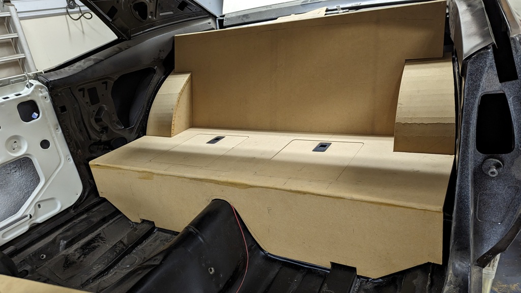

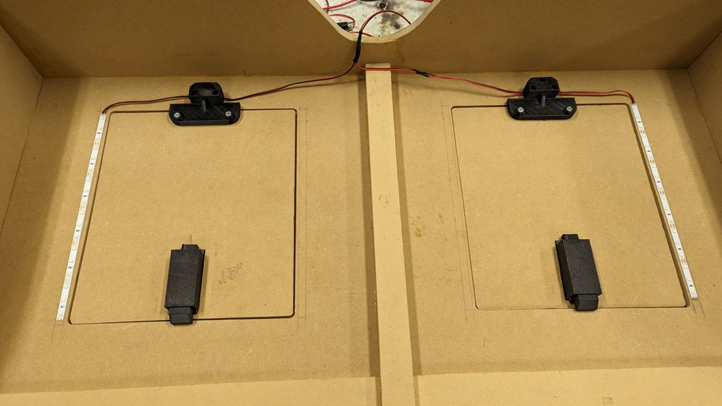

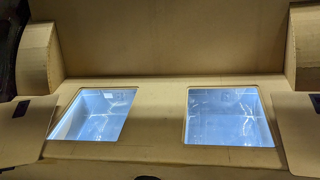

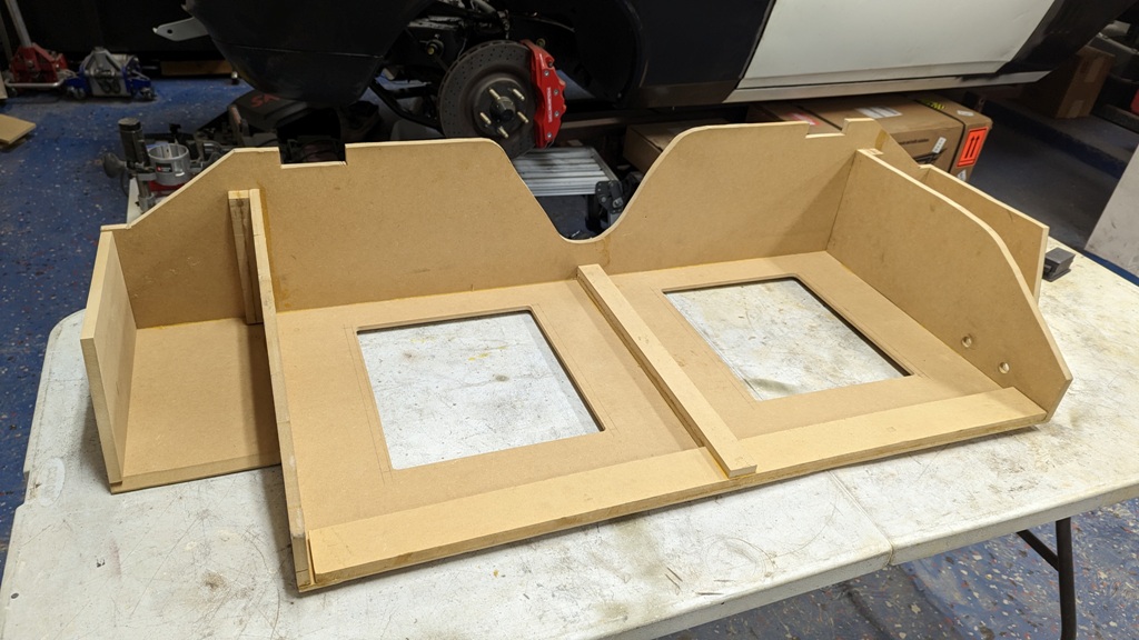

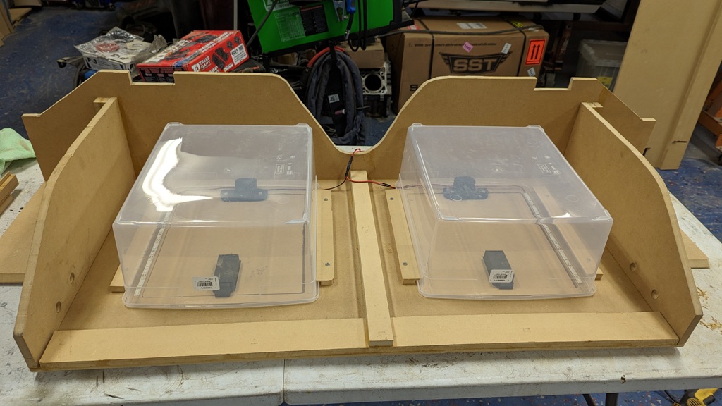

      Started working on a rear seat delete. The design is pretty close to what I made for my Camaro but with a few improvements.
      I changed the inner structure braces so I could accommodate some plastic storage bins.
      Made some changes to the latches and now they are counter sunk into the lid so that the top of the latch is flush. Also added some LED strip lights and 3D-printed some switches so they only come on when the lid is off.
      I plan to line the inside of the tubs with some unisuede fabric so you can't see through the tub, but that will happen latter.
      The back of the top fits over the existing seat hooks in the car. I will be adding some cross bars into the slots latter to hook it into place and some tie down straps mounted from the back of the board down to the original seat mount points will lock it down. I'm also thinking about putting in some forward facing speakers into this board.
      There's some other minor improvements I want to make before I call it done but that will have to wait until I start working on the interior in full force.

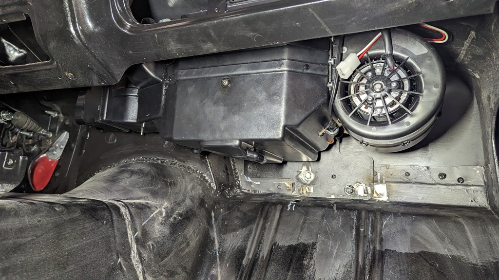

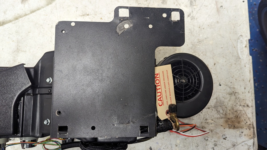

      I modified the Vintage Air bracket so the evaporator box now slides onto a bracket then locks down with 2 bolts. I did not want to make any holes into my smooth firewall.
      This bracket also fixed the oil canning I had in the firewall.
      It's pretty easy to install and remove the evaporator now.

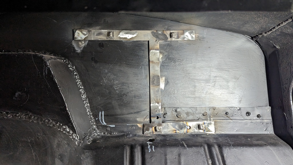

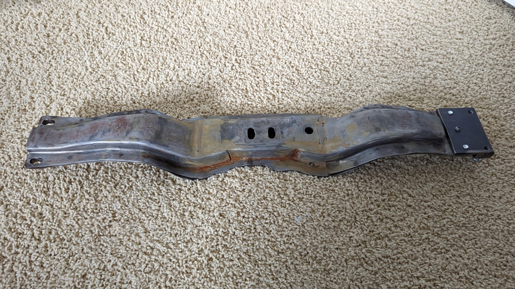

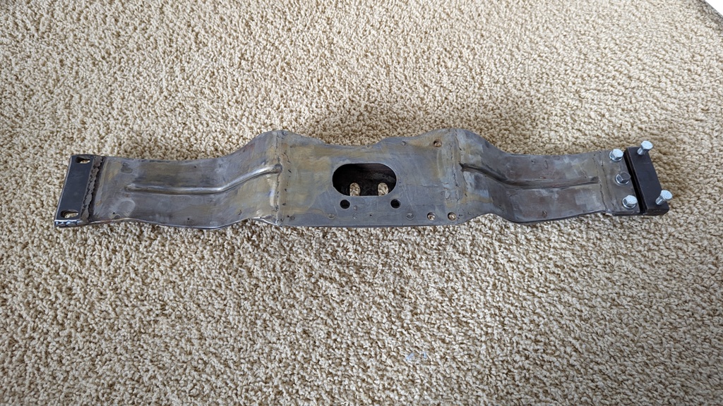

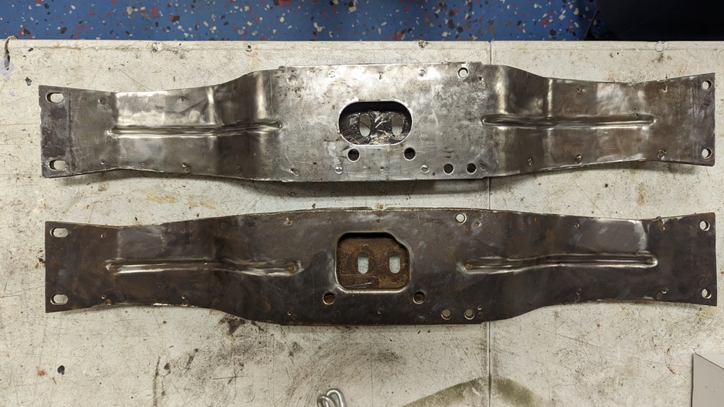

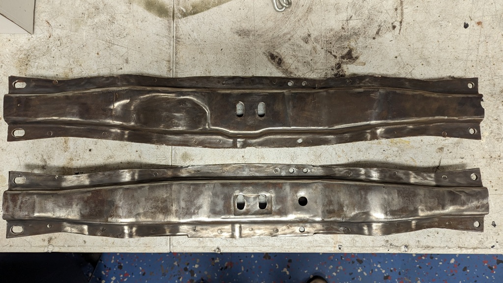

      Test fitting the Tremec TKX. I started with modifying a cross-member that I already owned. I had one cross-member from my '67 camaro and the original from the '68 firebird. I thought they would be the same, but they are not. Top is firebird and the bottom the camaro.
      I ended up only using the cross-member from the camaro. I cut the center section and moved it back to align with the TKX mounting holes then welded it back together with some additional support material. I also added some spacers on each end to lift the transmission as I want it as tight as I can get to the top of the transmission tunnel.
      I modified one side so that I can install the cross-member by simply lifting it into place and bolting it in with 3 bolts. If you ever tried installing a stock cross-member after subframe and transmission is in place then you know how much of a pain in the ass in can be to slide into position this mod make to super simple.

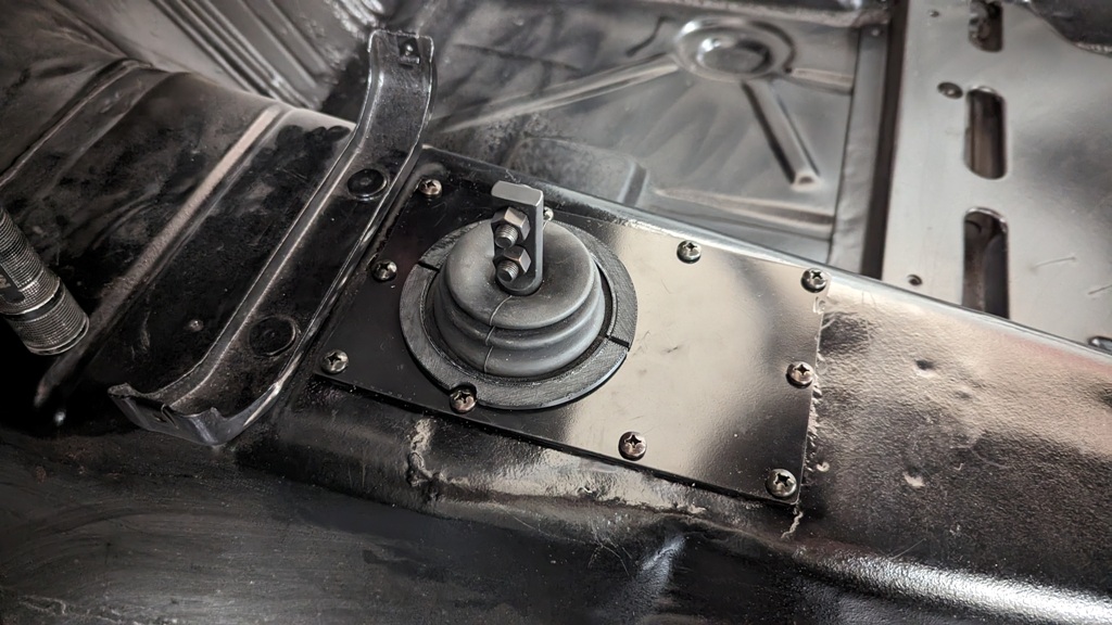

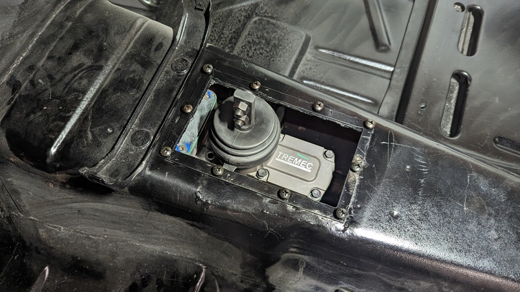

      I created a trim ring around the hole for the shifter.
      Then used my 3d printer to make a gasket holder around the shift boot. I used some 1/2" foam weatherstripping to seal the gap.
      It tucks up nicely. I'm right at 3 degrees down.

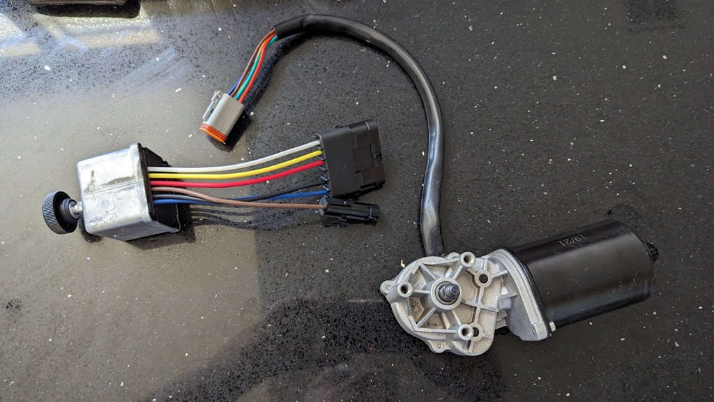

      Got the wiper motor installed. I did a poor man's version of the raingear system. The wiper motor is from a '97 Jeep TJ and a Cole Hersee 75600-04-BX intermittent wiper switch with washer control. The motor is mounted behind the firewall under the cowl.
      I created a simple L-bracket with side support for the wiper motor and spot welded it onto the firewall. I used the original wiper arm but modified by twisting it 90 degrees so now it mounts to the wiper motor horizontally instead of vertically. I also had to re-key the hole so that the park position was in the right place.
      I made a wire harness that connects the switch to the motor. I forgot to take a picture of the finished product but you get the idea.

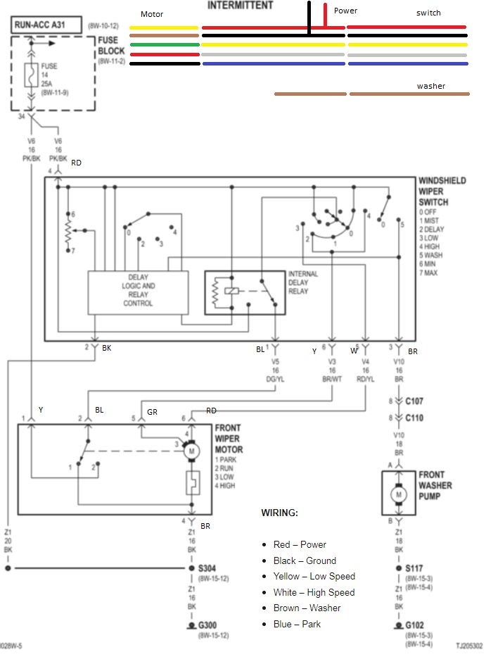

      Here's the wiring diagram showing how the wiring harness connects the switch to the motor. Note that I added the correct colors for the switch and motor that I used.

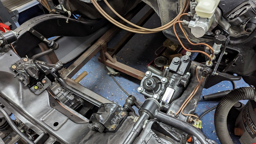

      I ended up ditching the Flaming River rack and pinion in favor of the ridetech Tru-turn system with a quick ratio Borgeson steering box. I did not like how the Flaming River steering column shafts aligned with the steering column. It looked like it would bind and interfere with the exhaust pipes plus it did nothing to improve bump steer. The more I worked with it the more I hated it.
      I had to make a new bracket for the wilwood proportioning valve to move the brake lines over a bit.

      I took some new bump steer measurements using the same exact technique I used in my previous post. There is a notable improvement over the rack and pinion system.

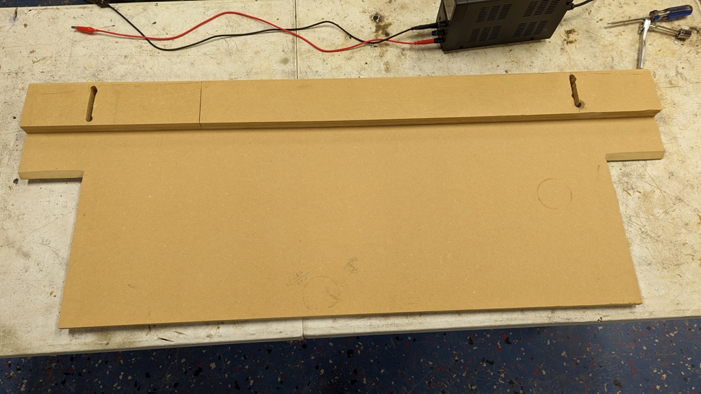

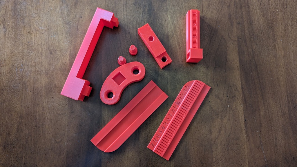

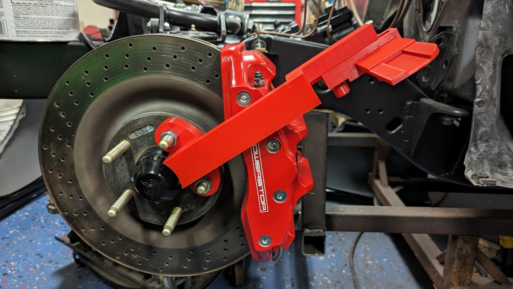

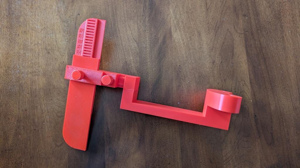

      Not much action on the Firebird lately but I did fix some problems in my original wheel fitment tool. Here are 3d printer STL files for anyone who wants them: wheel_fitment_tool.zip

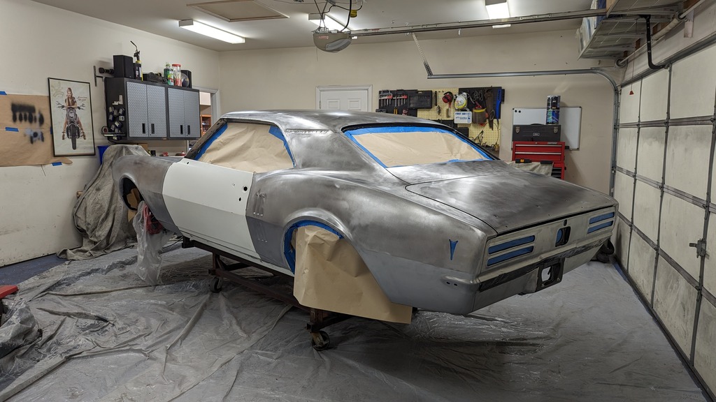

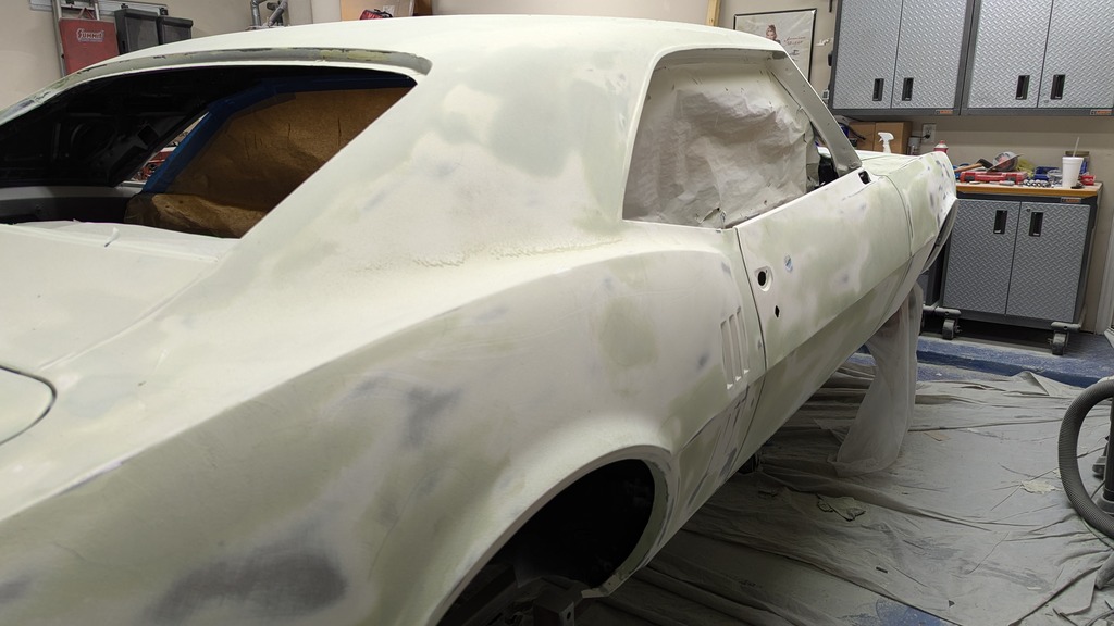

      I'm long overdue for an update. Year 2024 was spent doing the body work and getting the car into an epoxy sealer. I haven't decided on a final color yet, so I think I'm going to wrap the car and try out some different colors before going to paint.

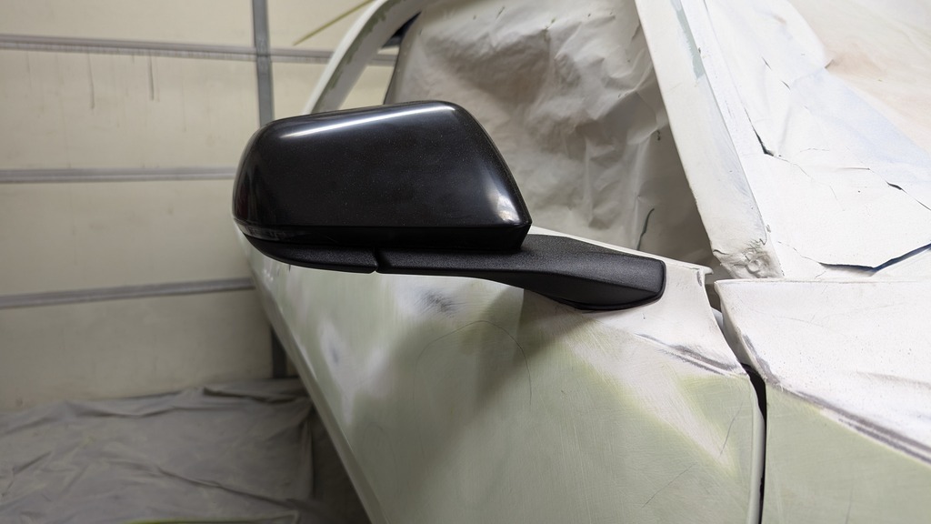

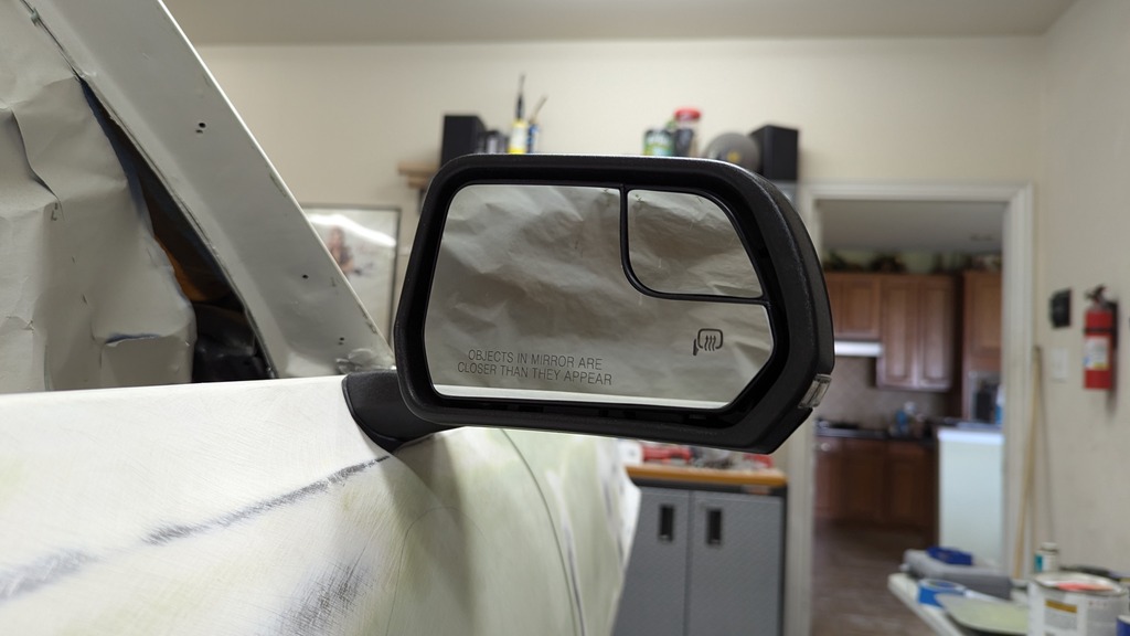

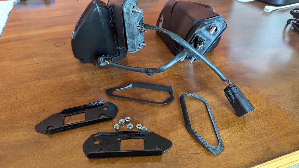

      I realized that I still need to install some sideview mirrors while doing the bodywork. I like the look of the Mustang mirrors although they don't fit as perfectly as some people have stated on other posts that I have read. The Mustang panels have more of a 90 degree swoop to them than the Firebird, so I made some gaskets on my 3d printer to fill that gap on the bottom of the mirror mount area. I also made some backing plates from metal instead of welding in a bracket. I felt this works just as well, and I don't have to weld on the galvanized metal that is inside the door panels. The mirrors have the blinker lights built in and defroster. I may not wire in the defroster function as I don't see myself every using it.

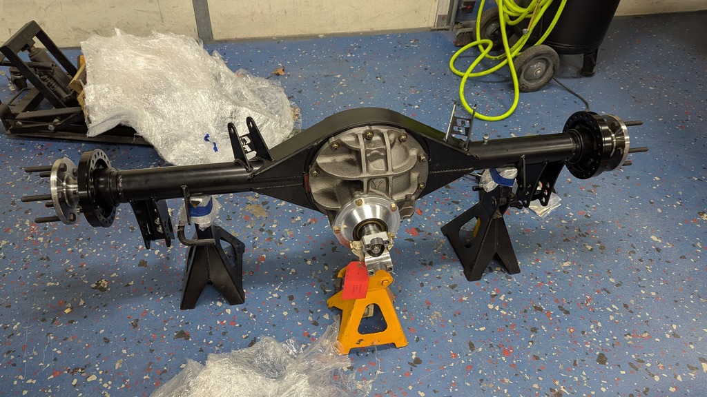

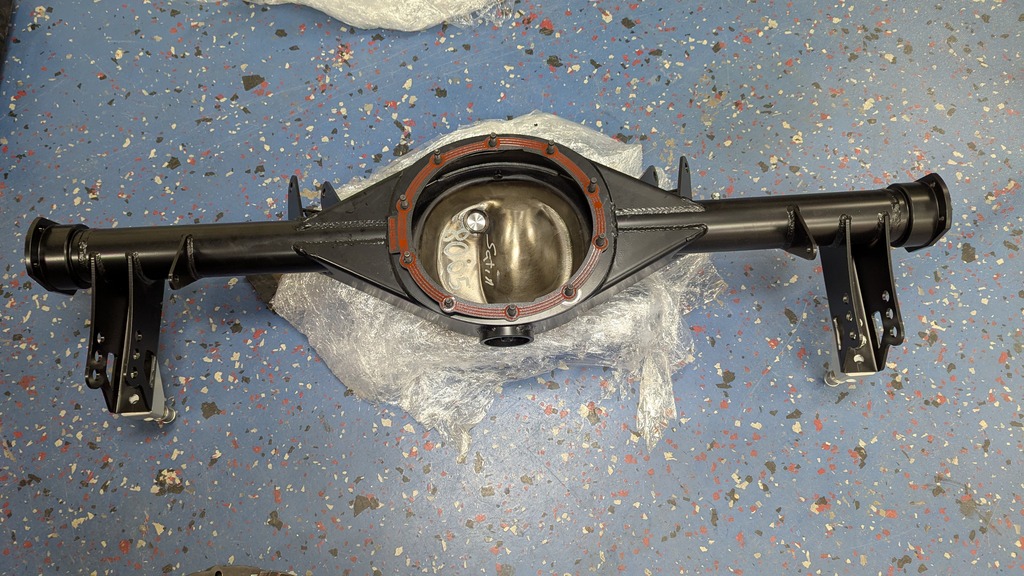

      Order my rearend for Quick Performance. I had them weld on the brackets necessary for the ridetech suspension and muscle bar. I also had them power coat it black for me. I went with 31 spine axles, 1/2" wheel studs, nodular iron center section with Eaton Truetrac and a 1350 yoke. The gear ratio is 3.25 keeping with my intentions of using this car as a long trip cruiser. The AF to AF is 54" and using the big Ford new style housing ends. I was worried about having them weld all the brackets and getting the pinion angle correct but they nailed it.

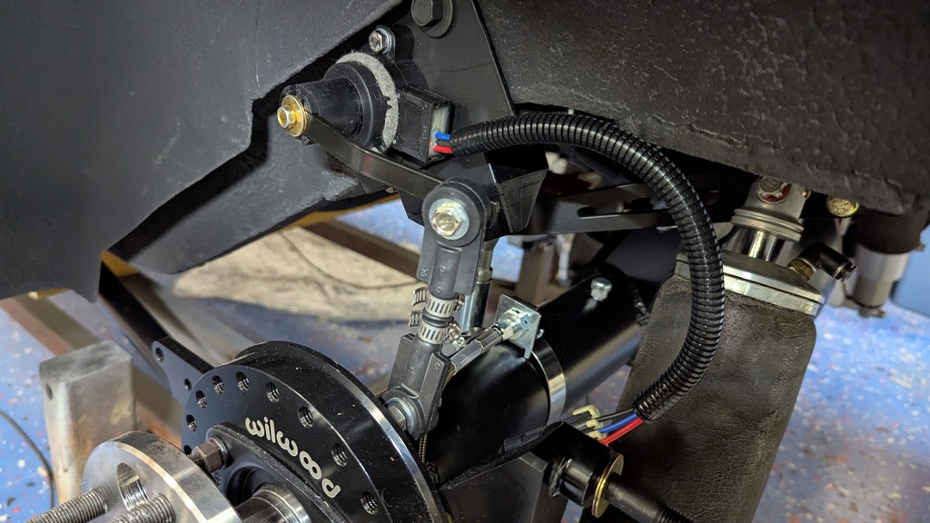

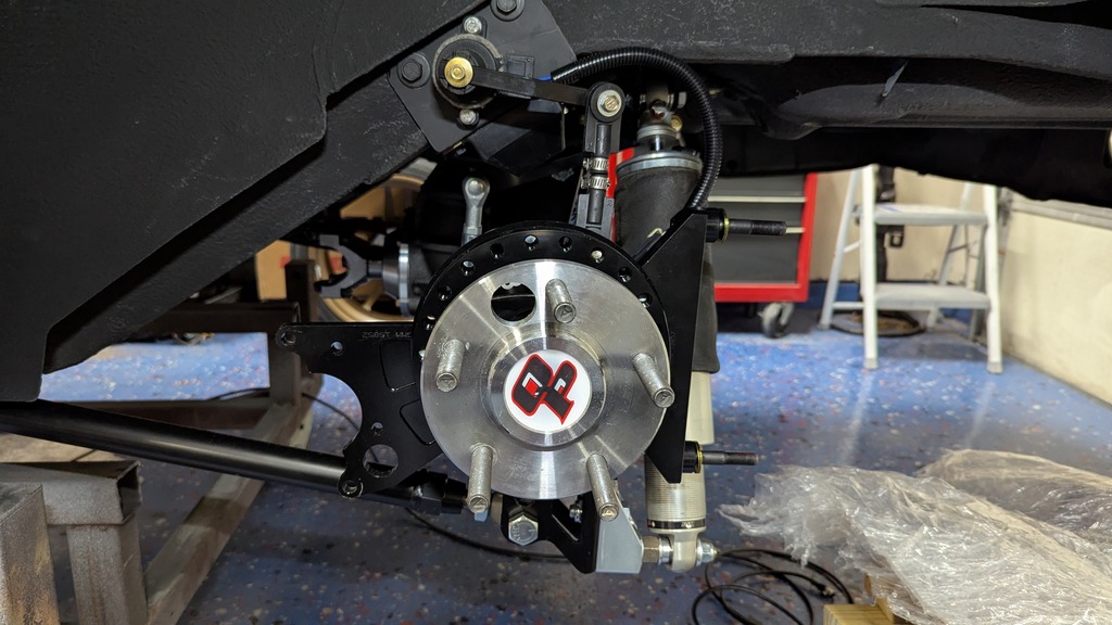

      Installed the rear end with the air shocks and ride height sensors. The Wilwood attachment point for the caliper brackets made a convenient location to attach the sensor arms. The sensors are attached to new bumper stop brackets that I fabricated.
