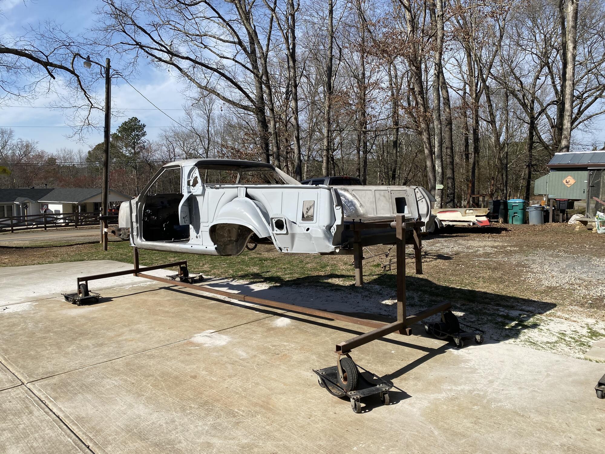

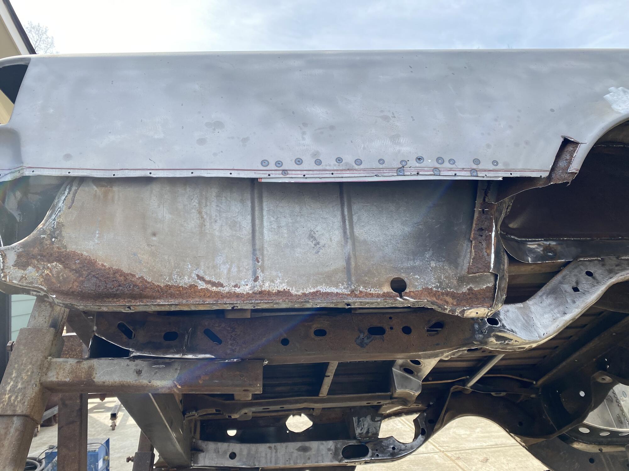

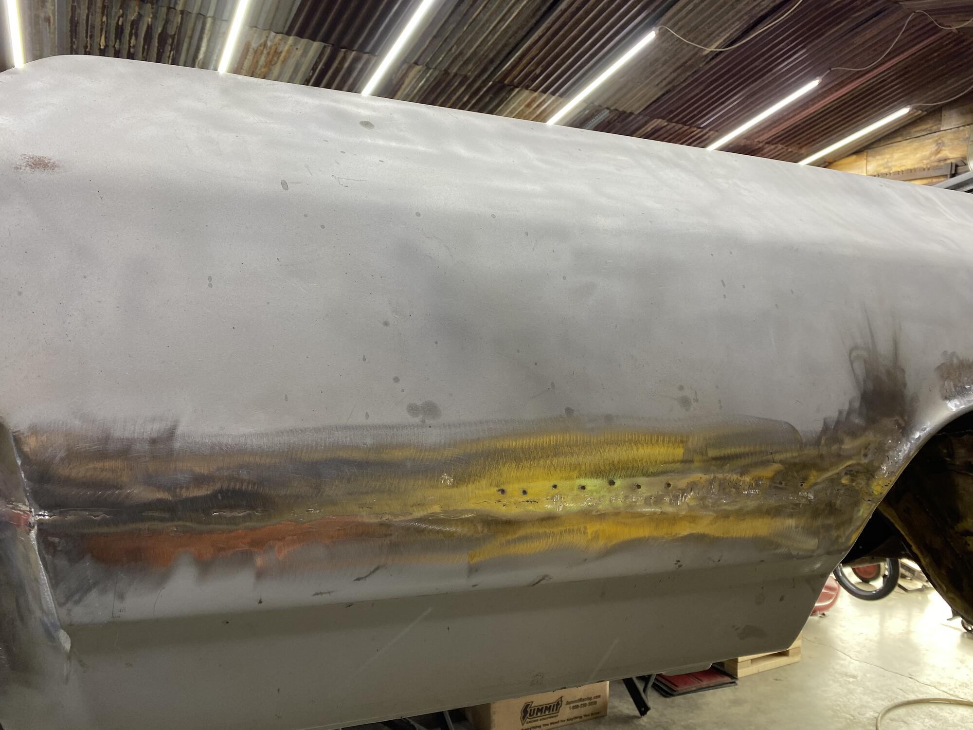

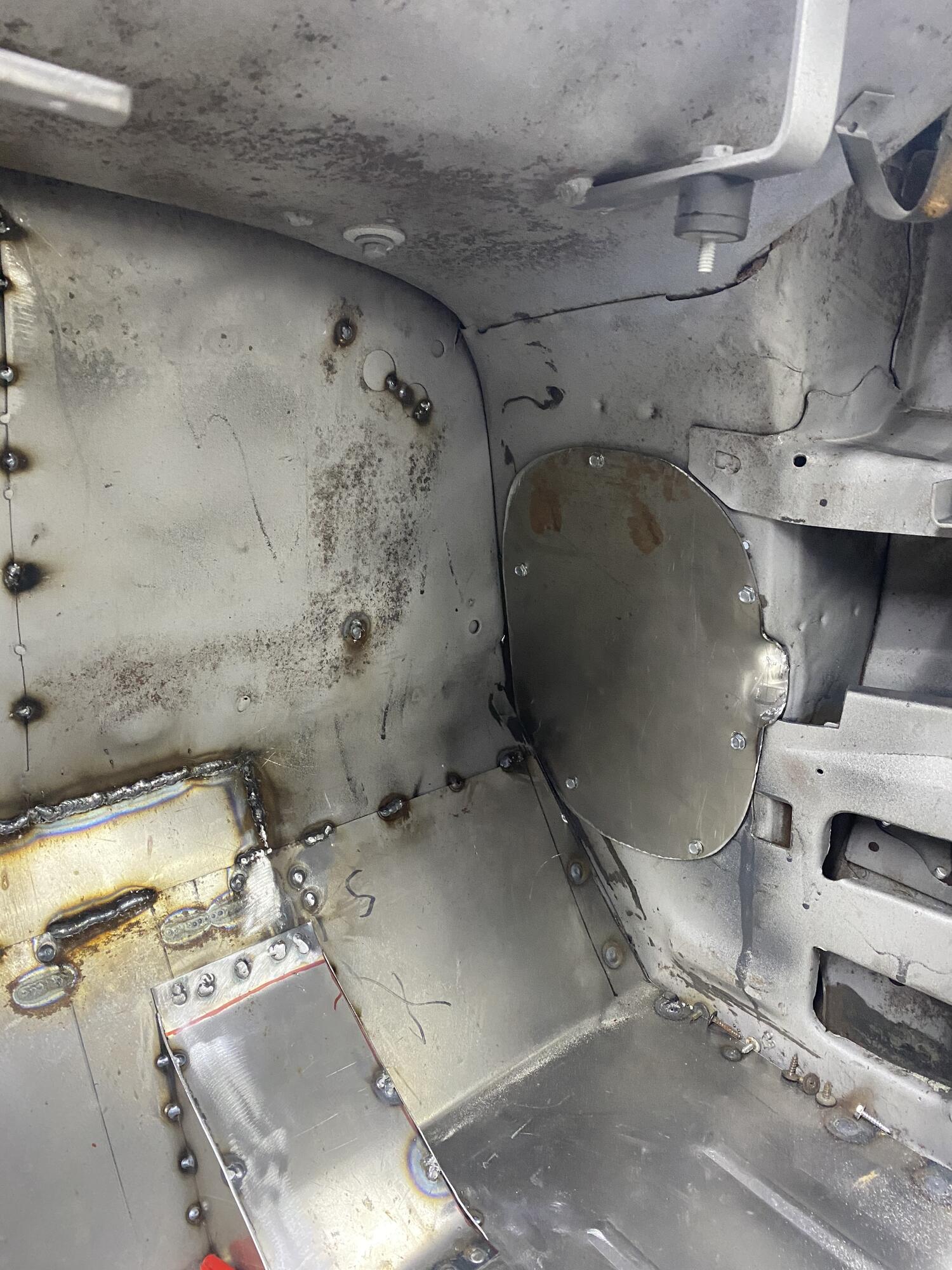

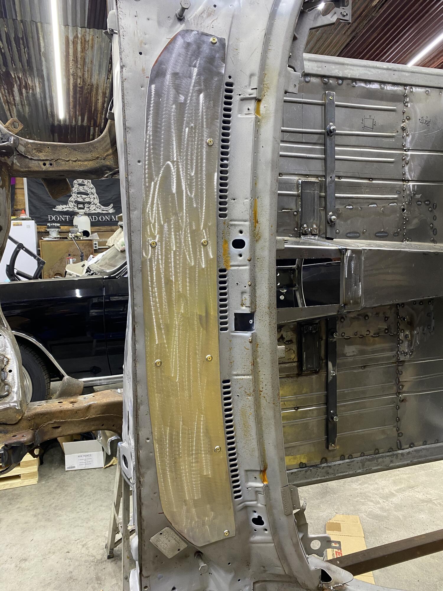

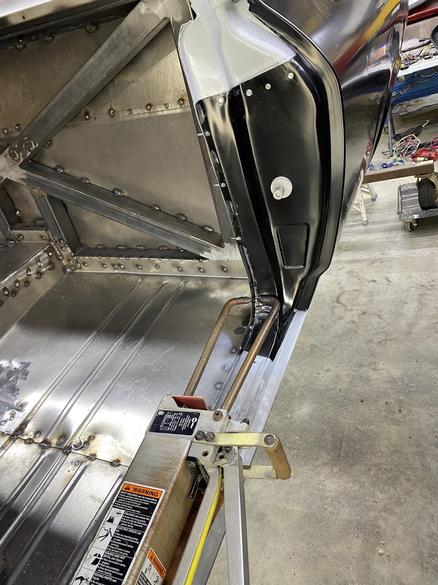

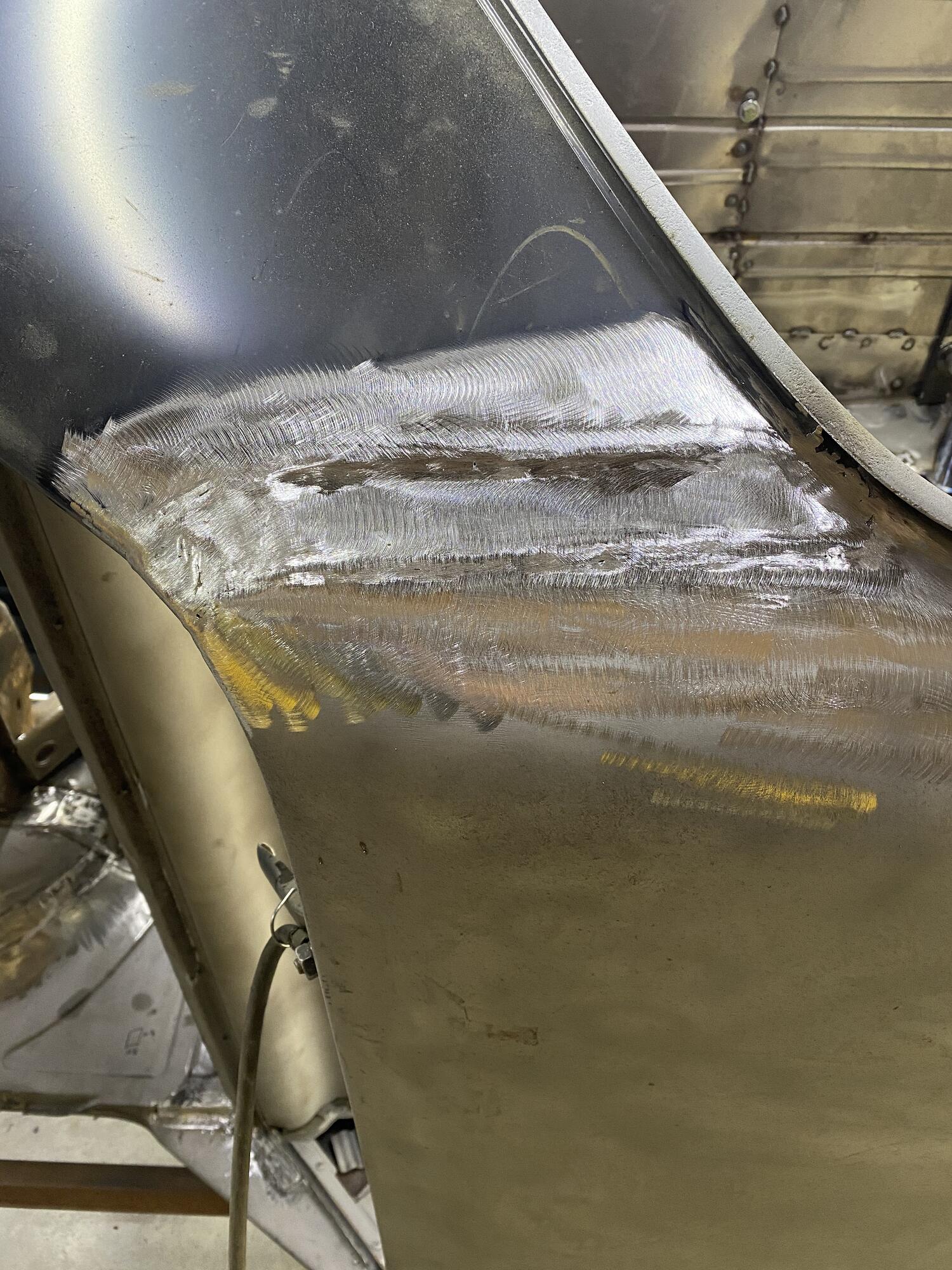

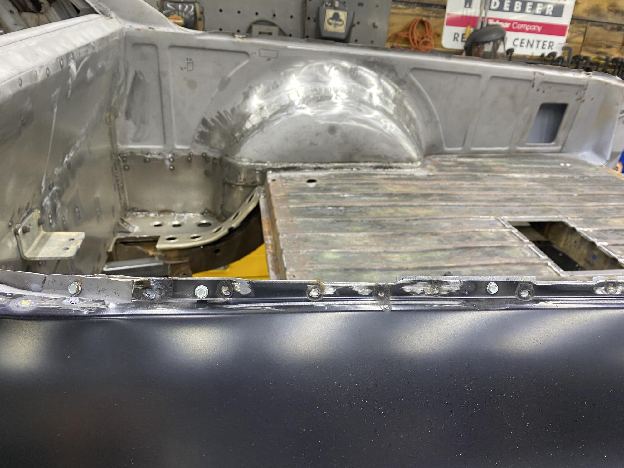

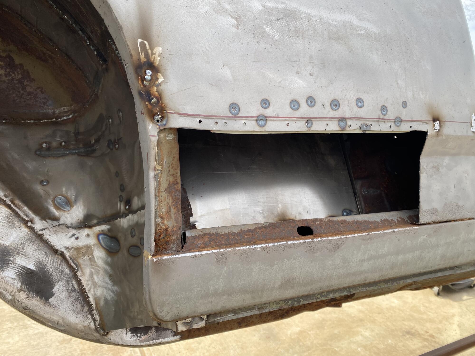

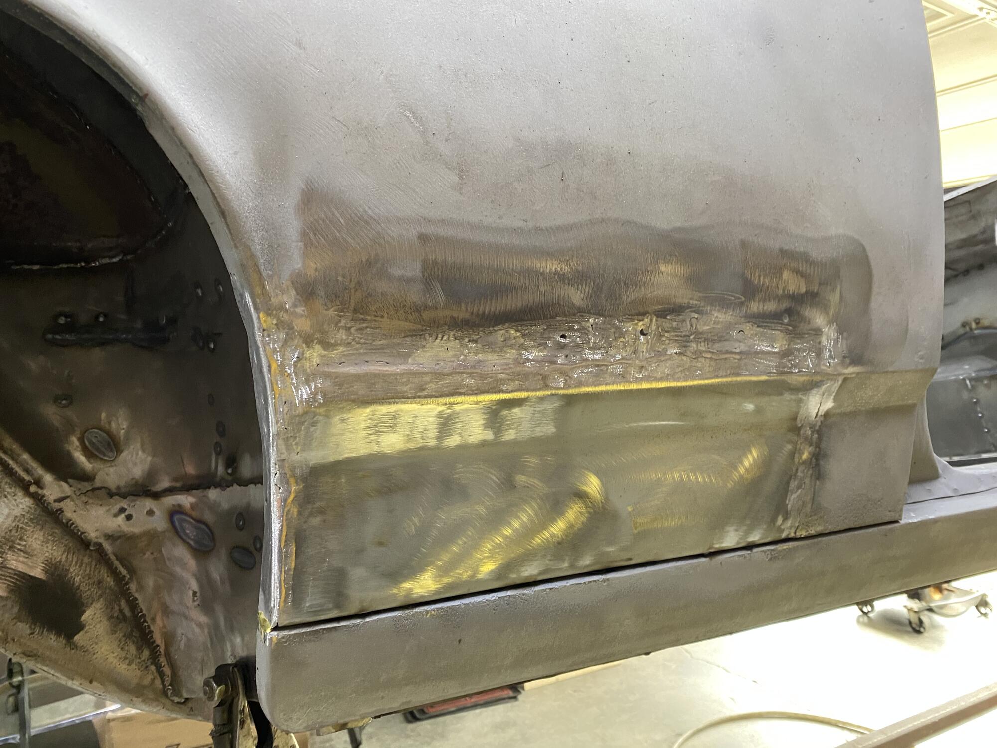

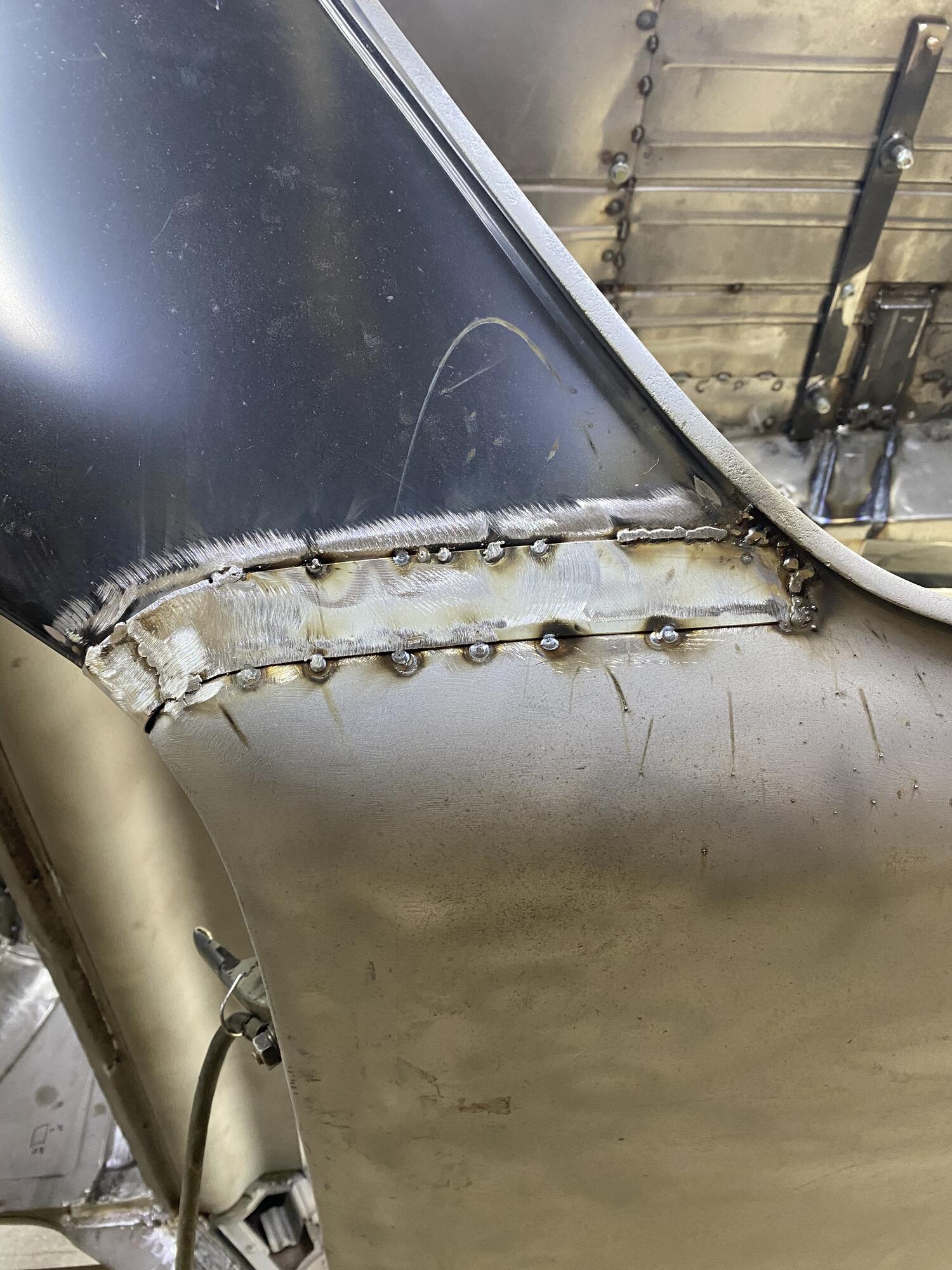

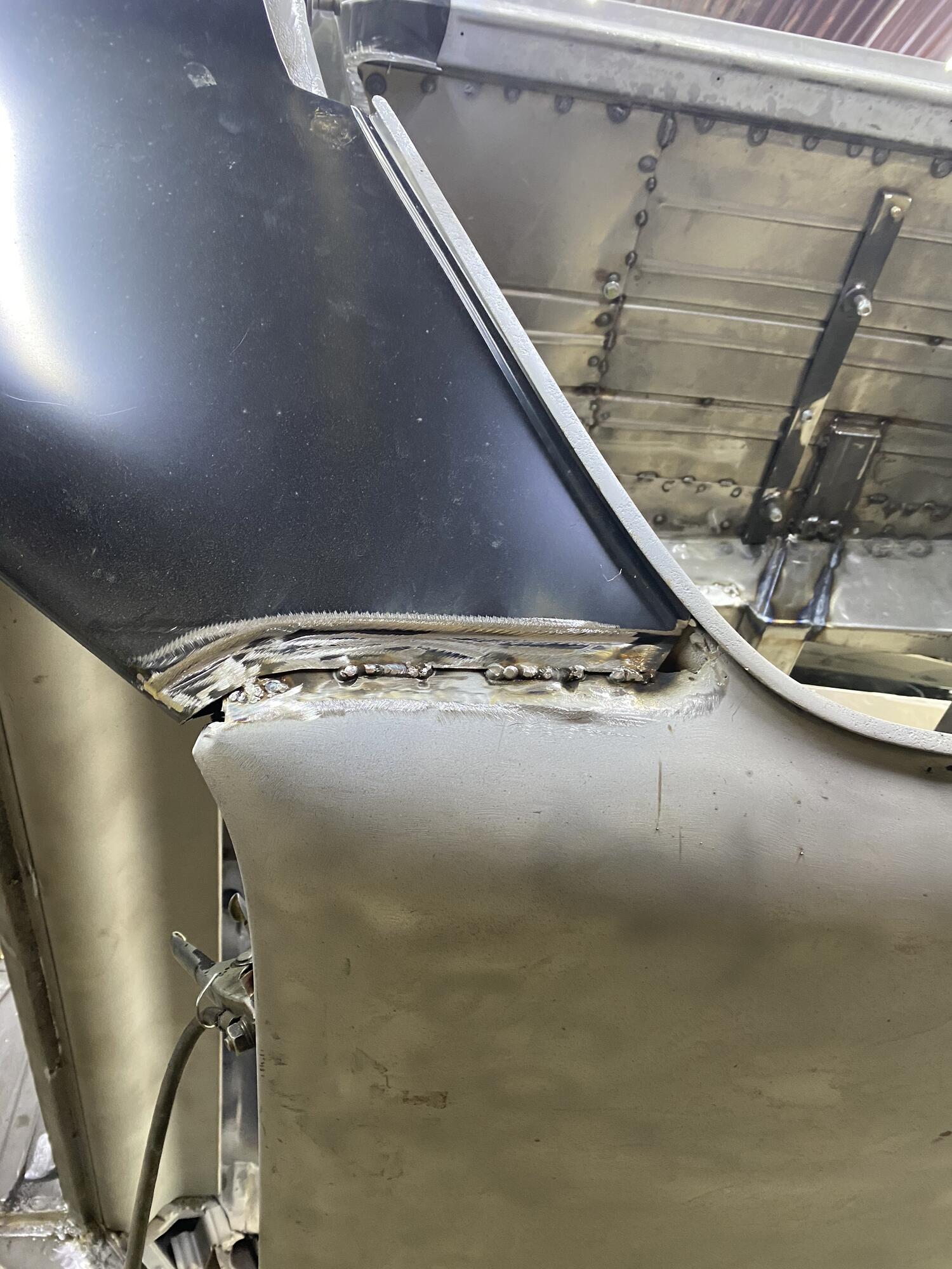

      Finally got some good weather. I got the inside of the quarter panels blasted and epoxy primer yesterday
      Welded in the patch panels on the passenger side.
      Did a little more fitting of the driver side quarter panel and started welding it on.Name:  CF0461F0-8B98-4663-B863-FF72F26E0F6B.jpg

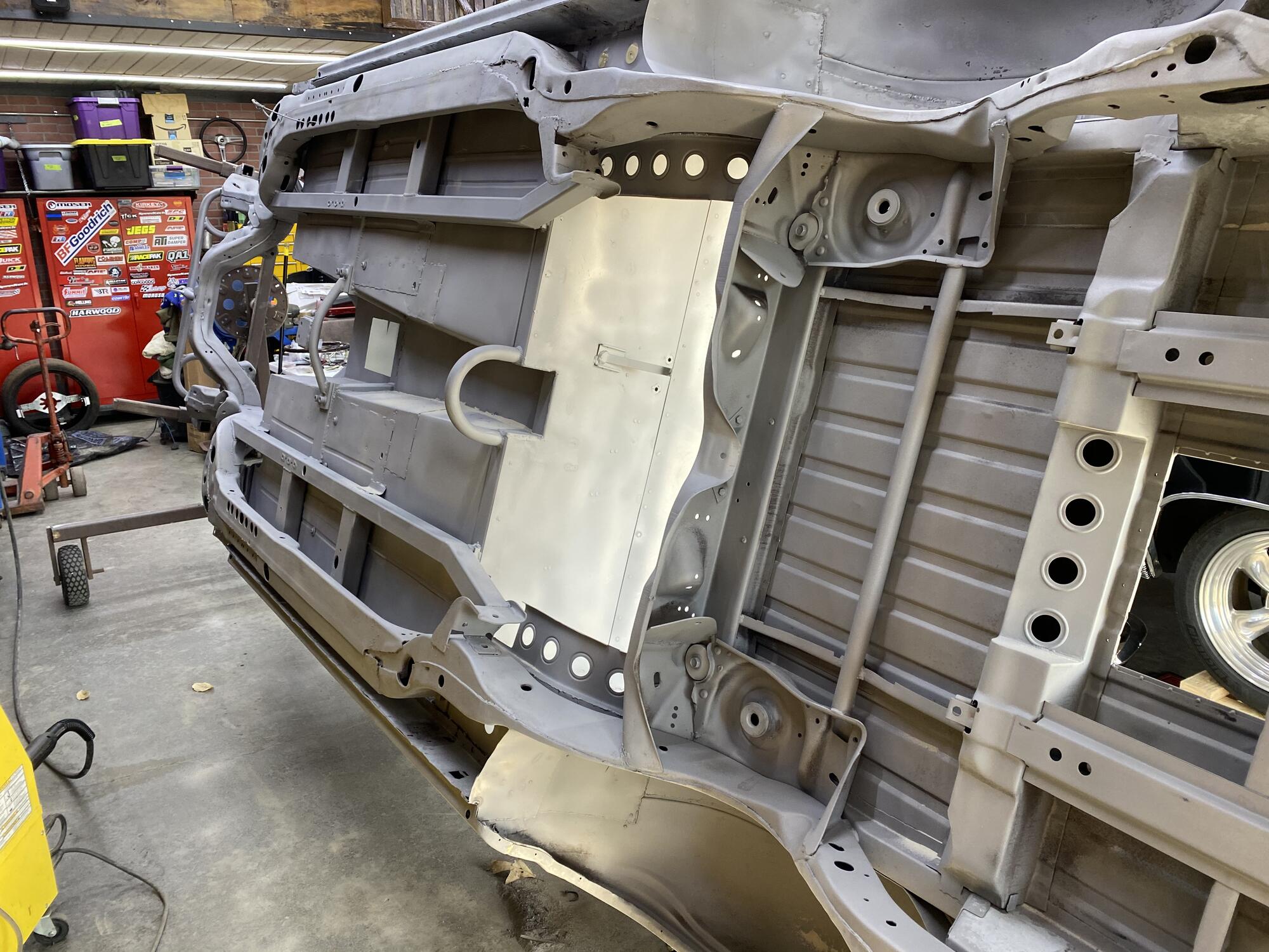

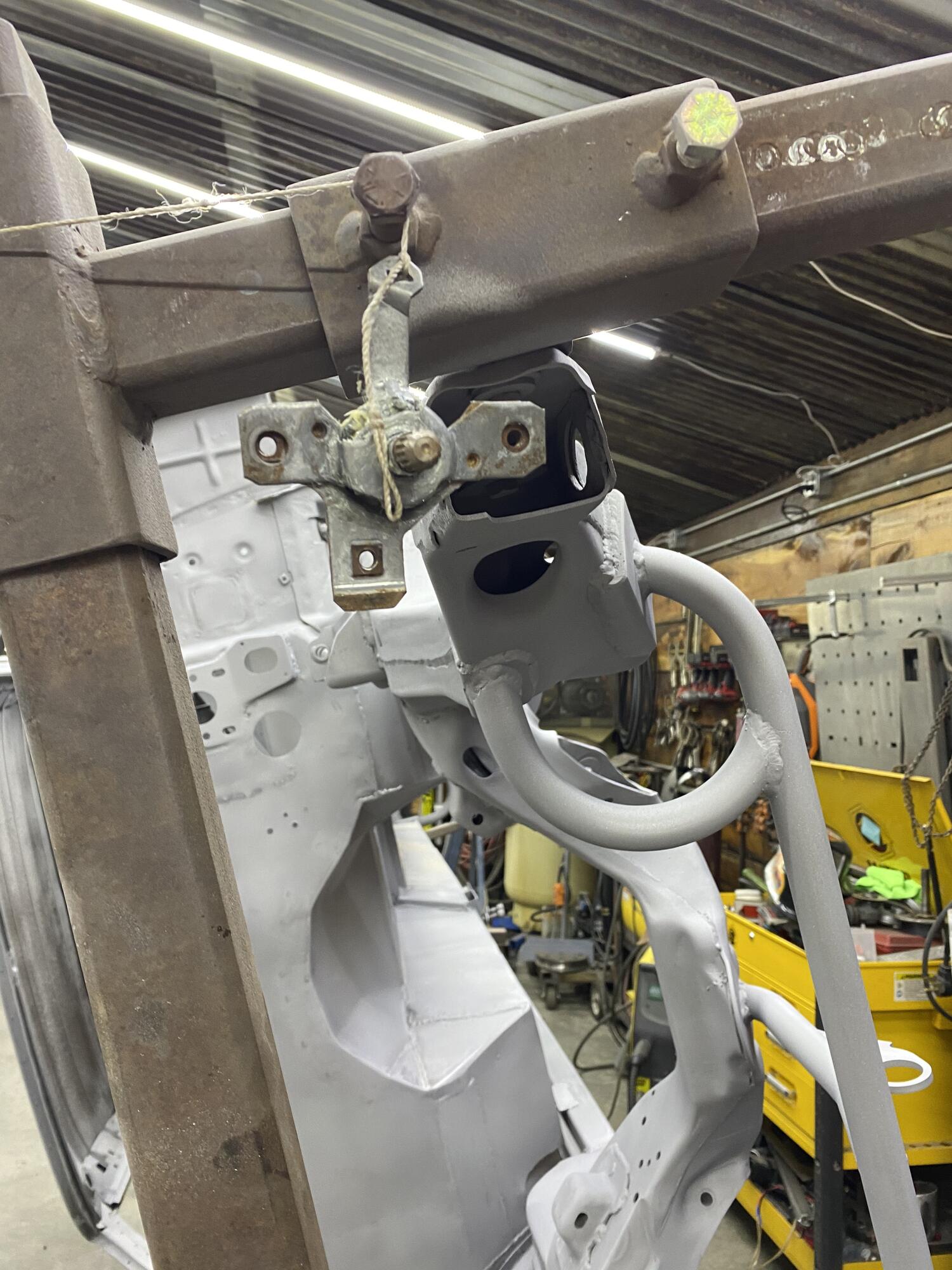

      Moving along, getting close to epoxy primer Name:  A73EF84D-EDFF-468F-B02A-4080578DC7DE.jpg

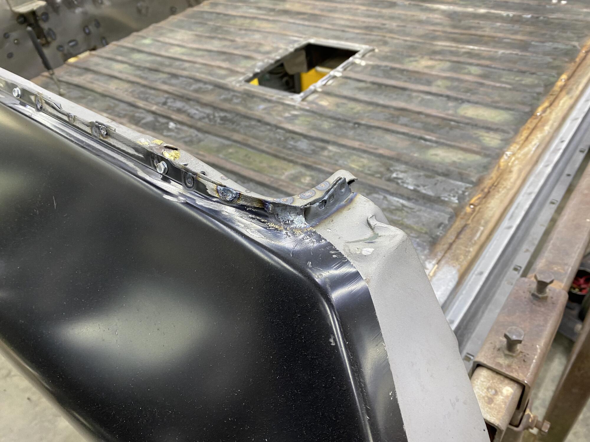

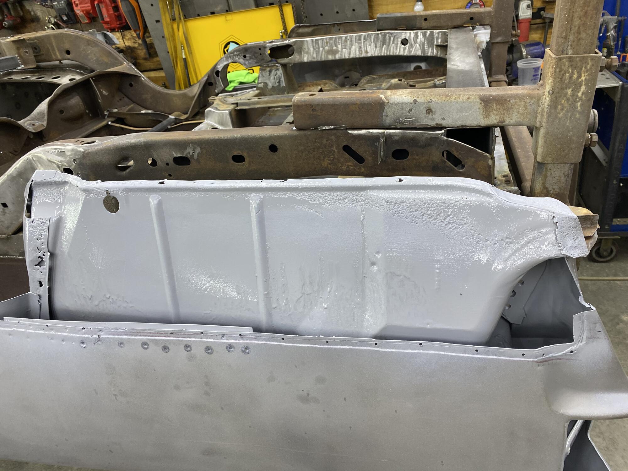

      Not much to report cut out a couple close out panels.

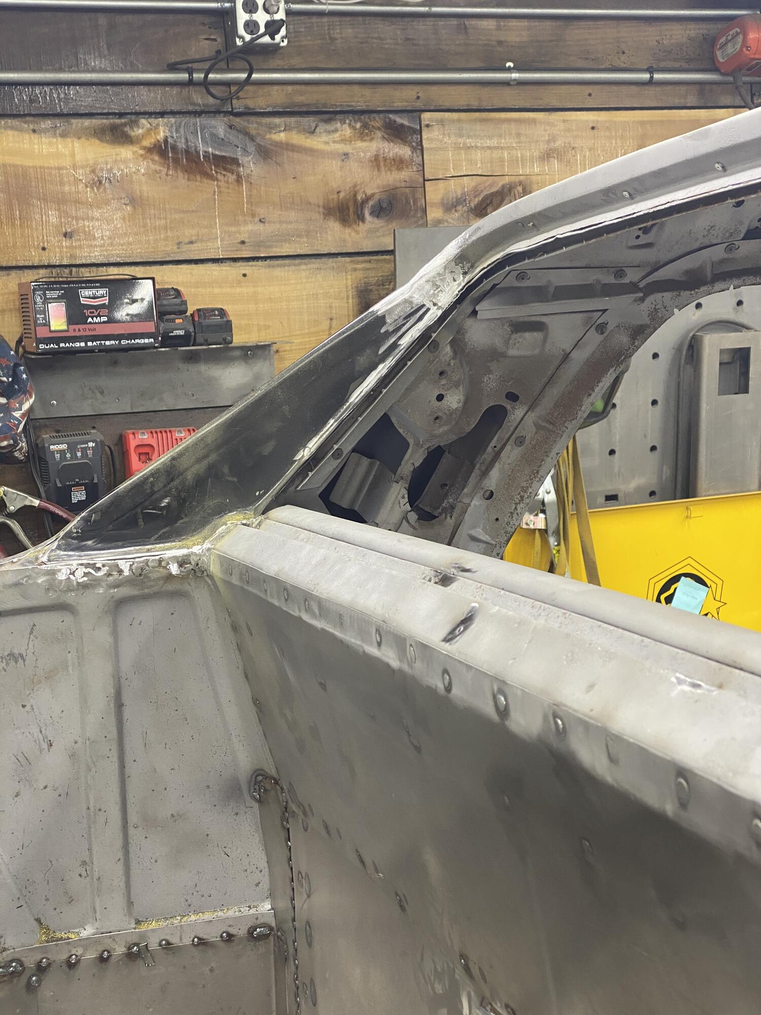

      Another close out panel done.

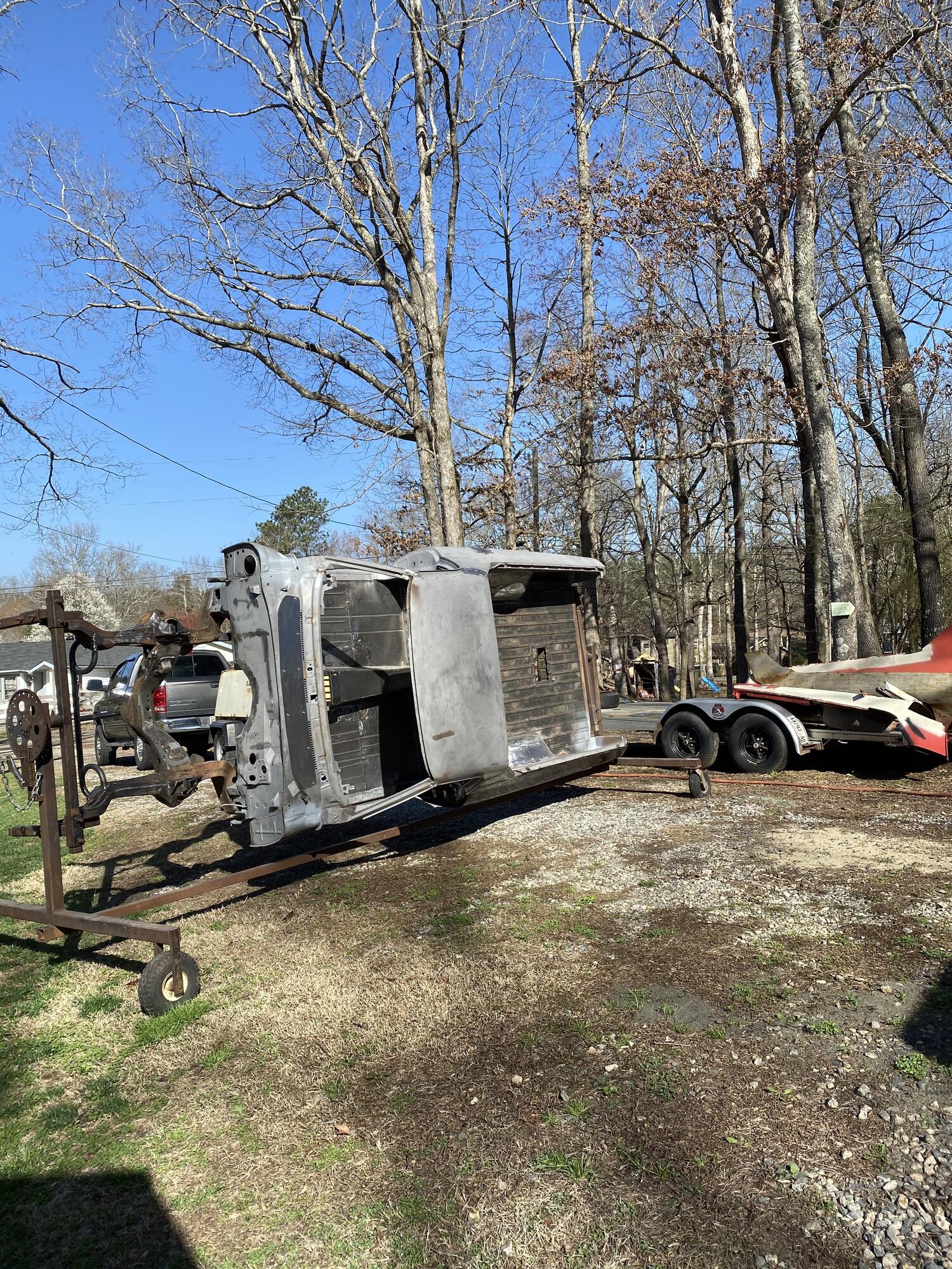

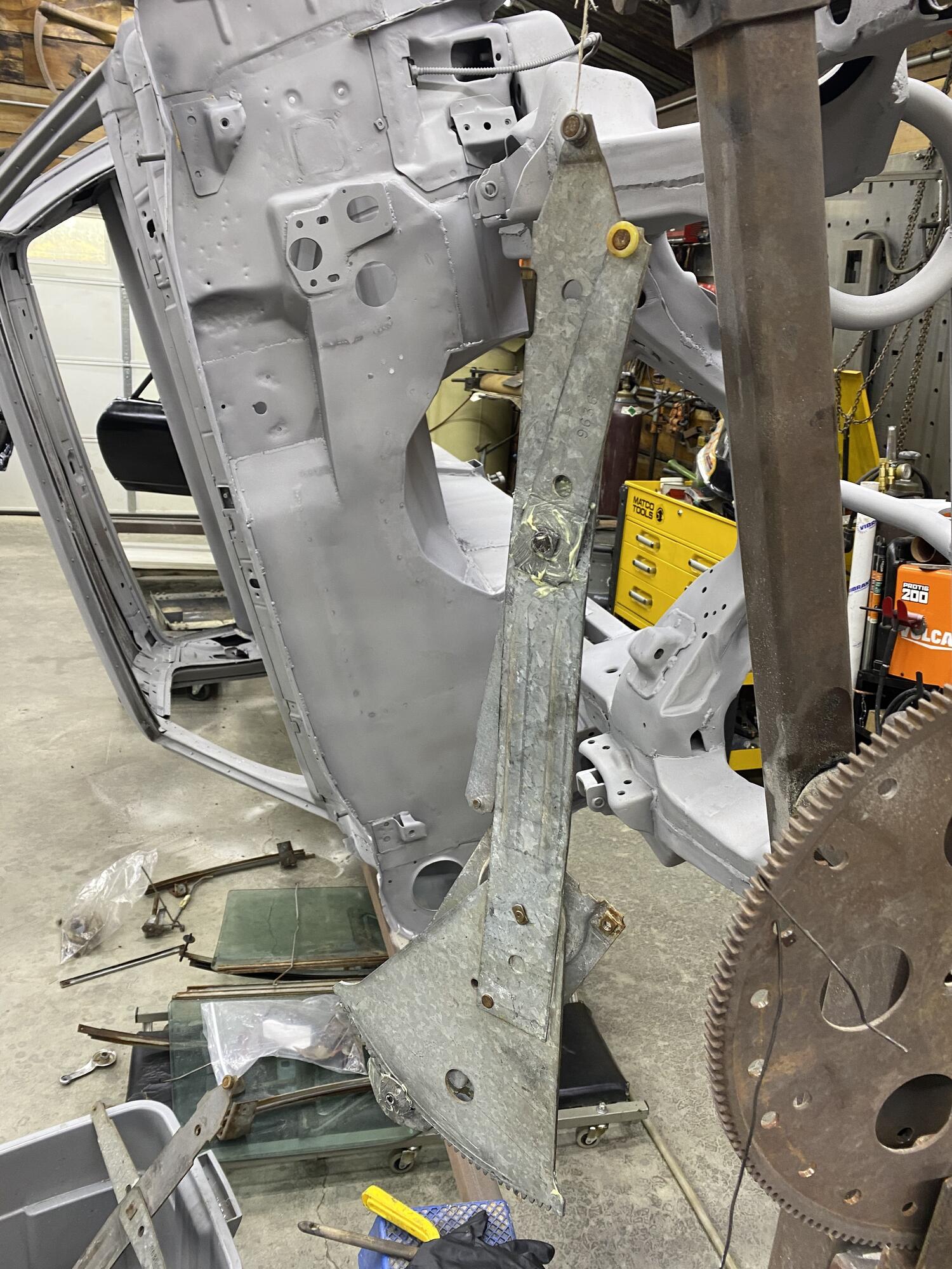

      Found out I’m 65 years old today and I fill it.��

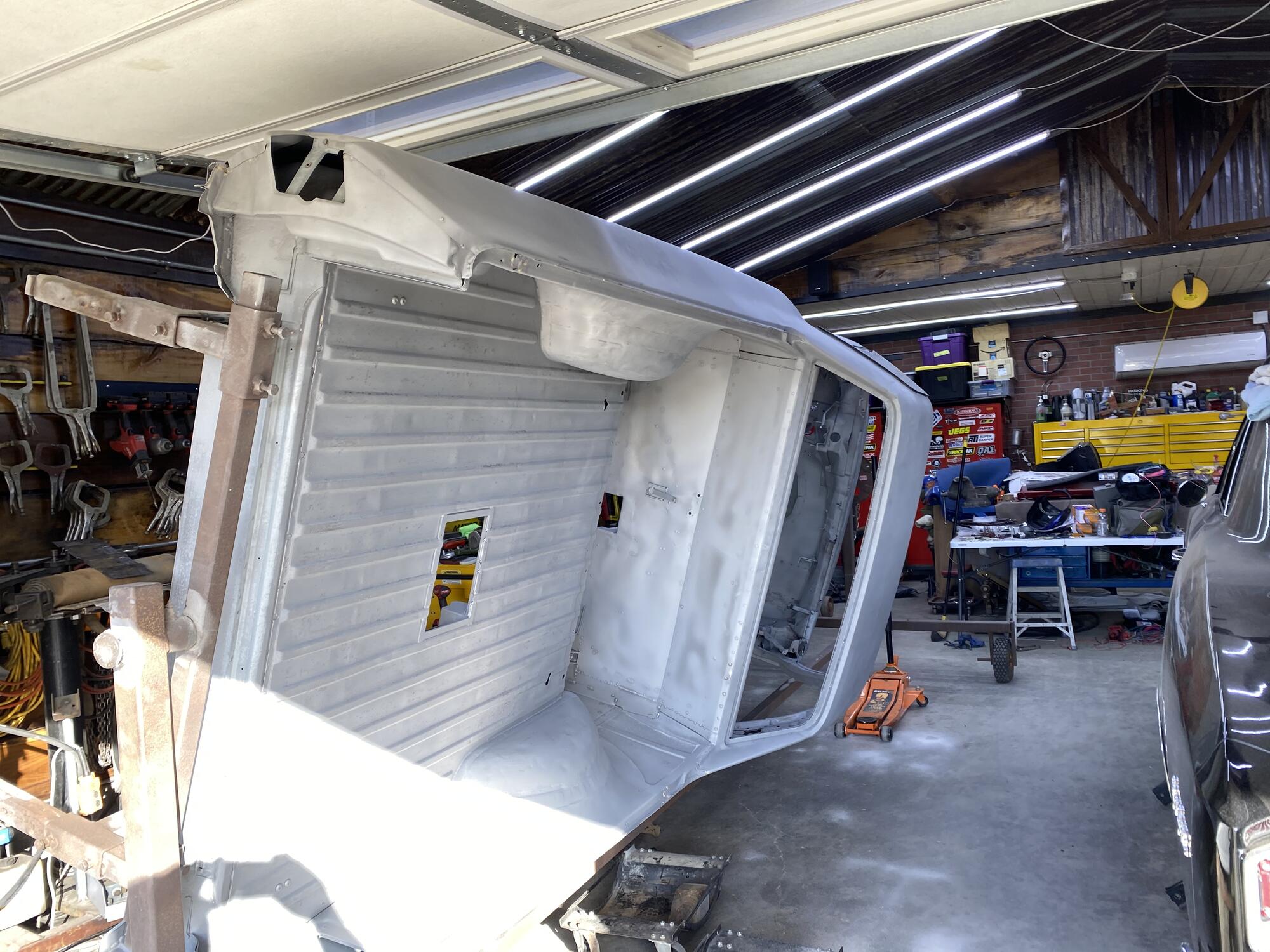

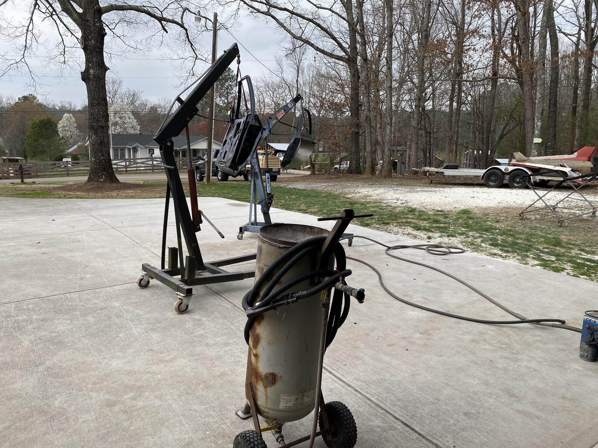

      15 one hundred pound bags of sand loading the blaster and blasting.
      Whup my assss!
      Everything blasted except the doors and tailgate.
      No it’s not my birthday just realizing how old I am.��Name:  61B5243D-C367-482F-A3A8-779DF92C80BF.jpg

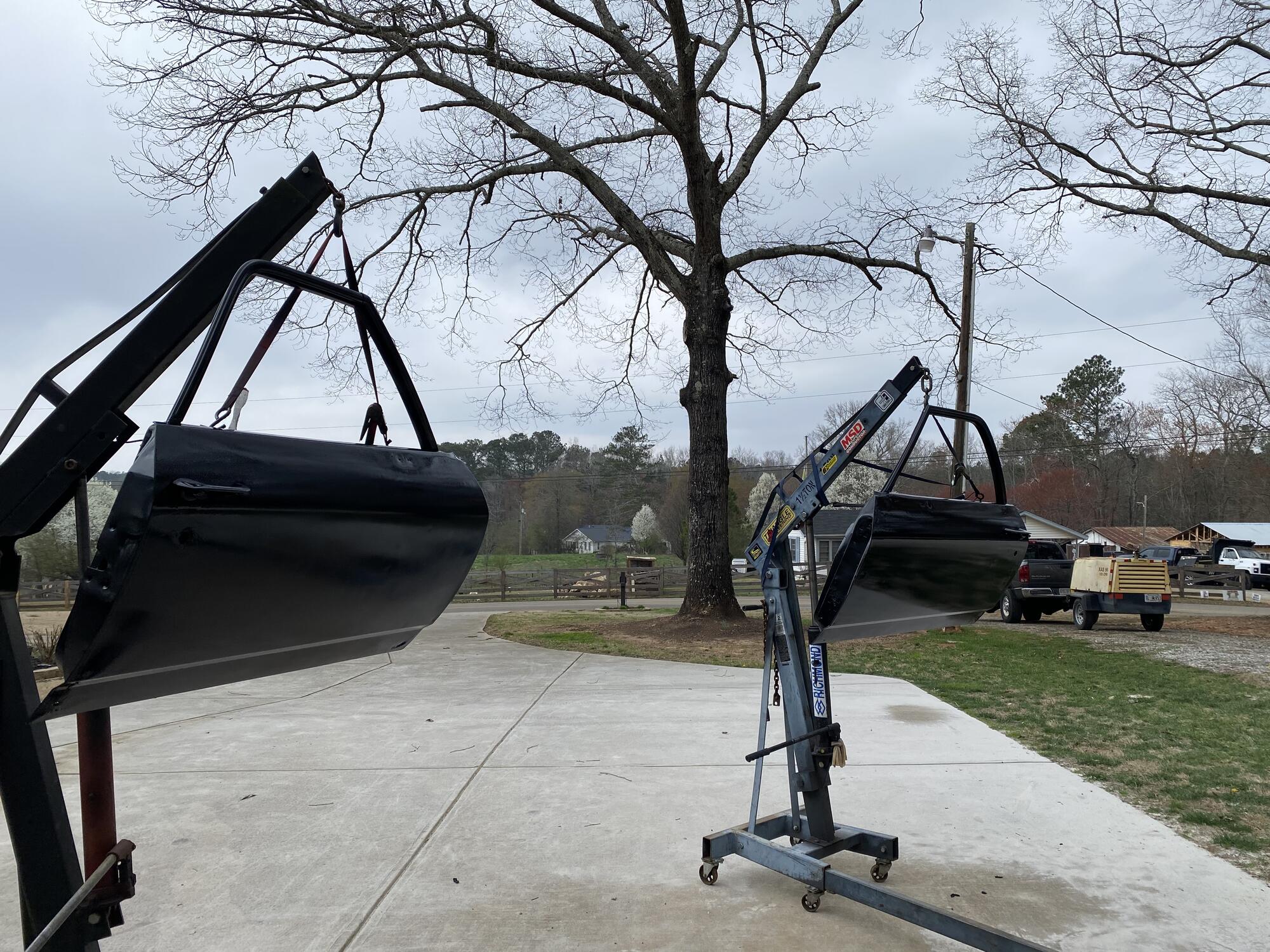

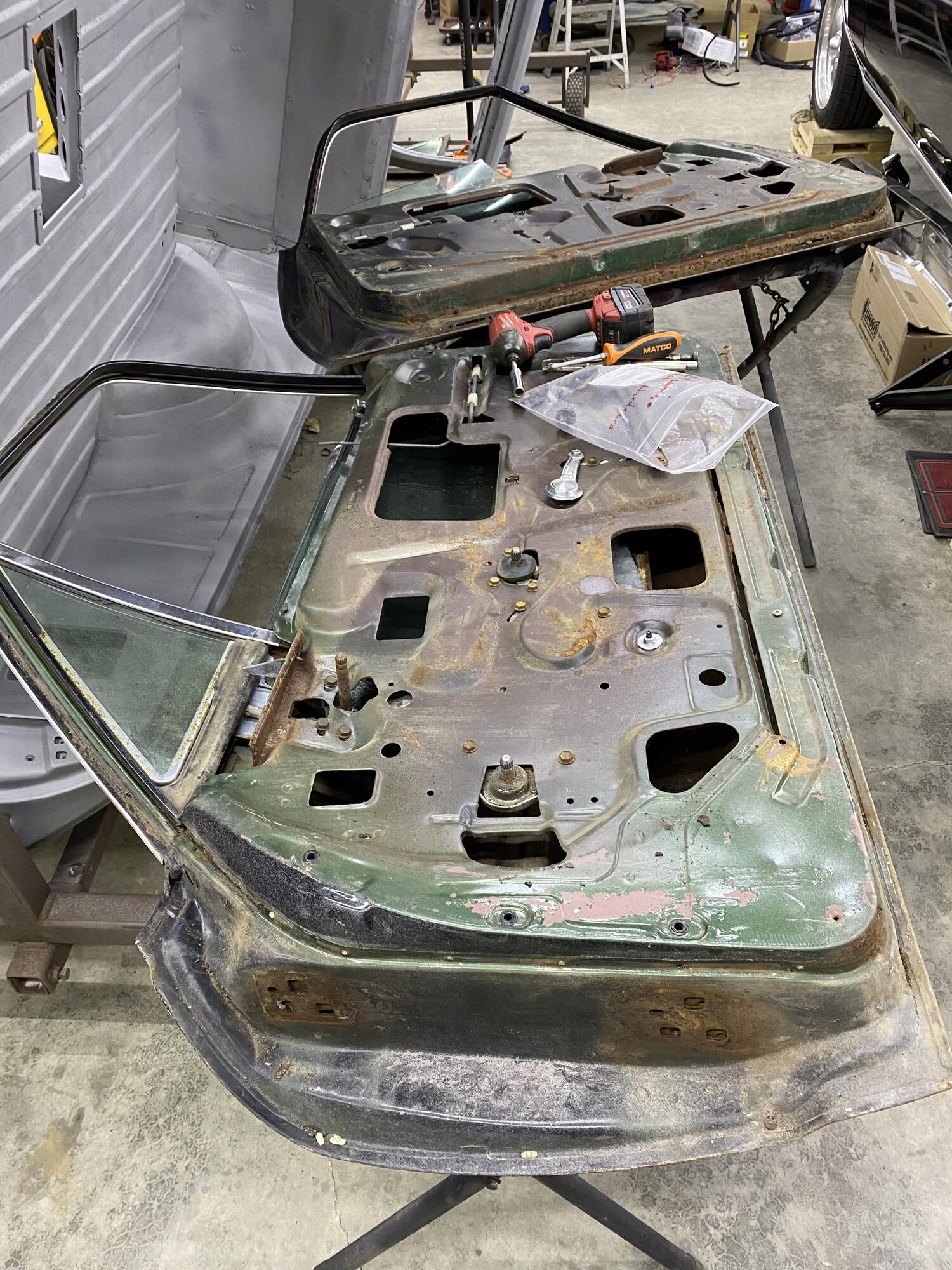

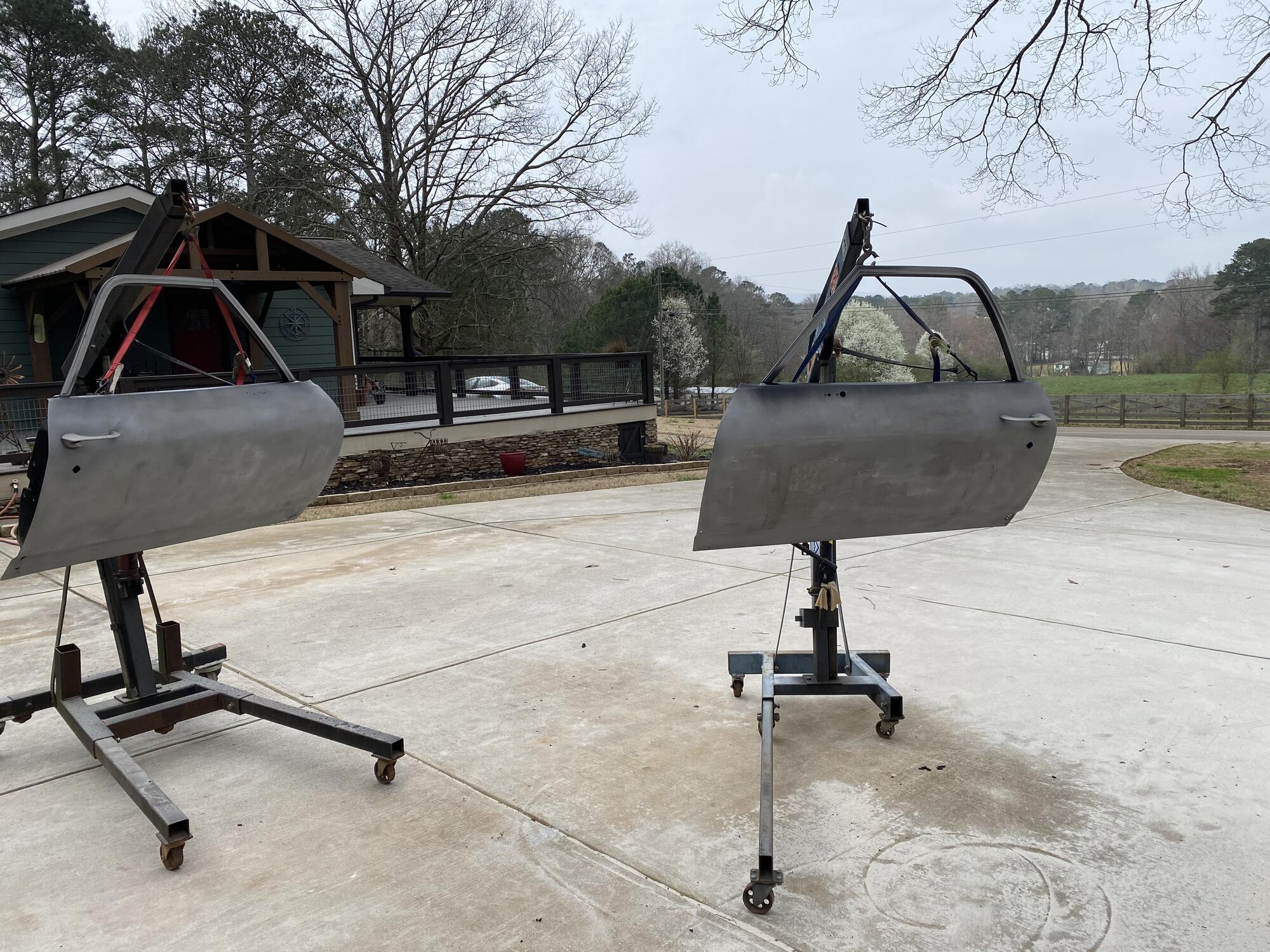

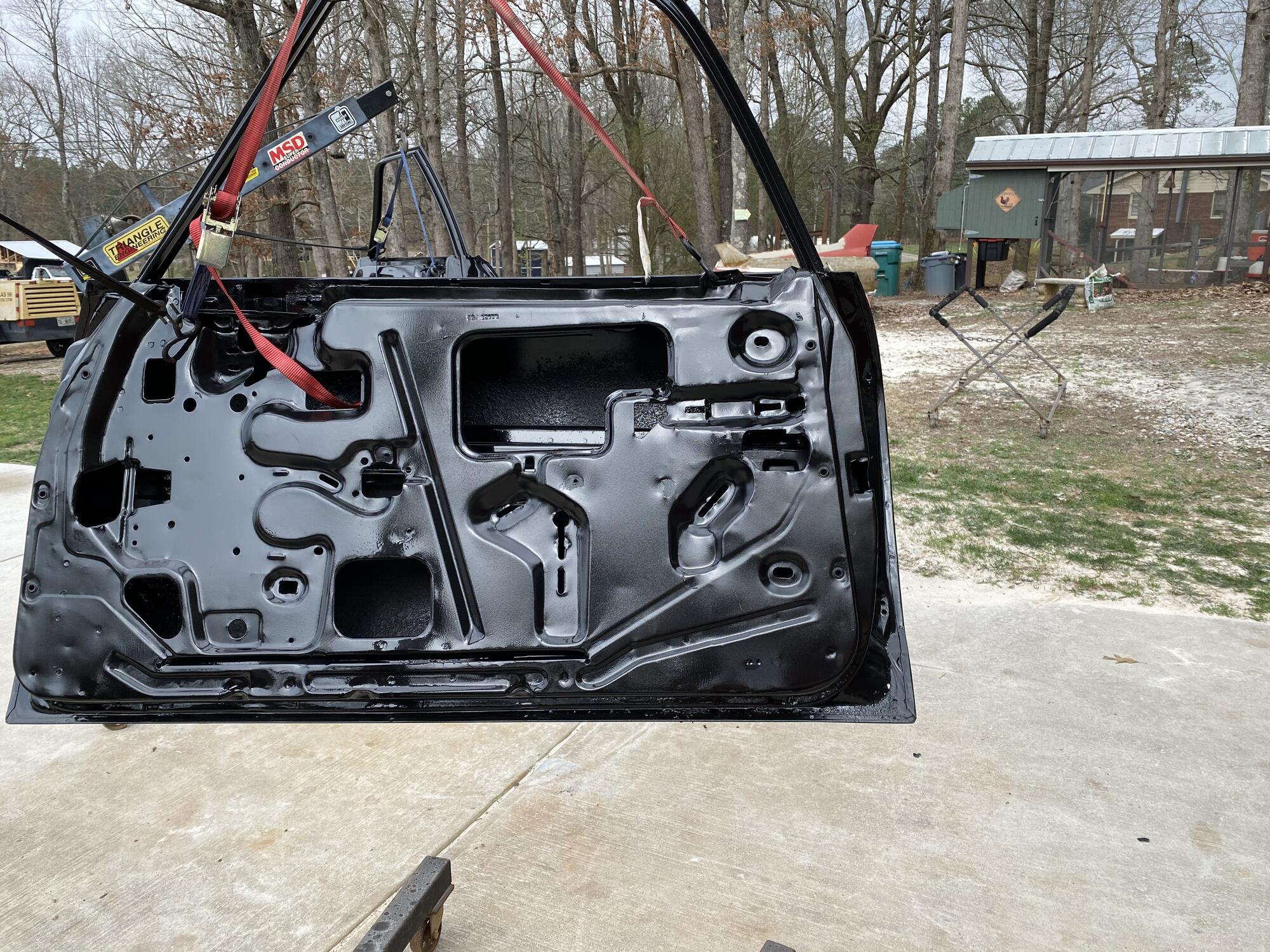

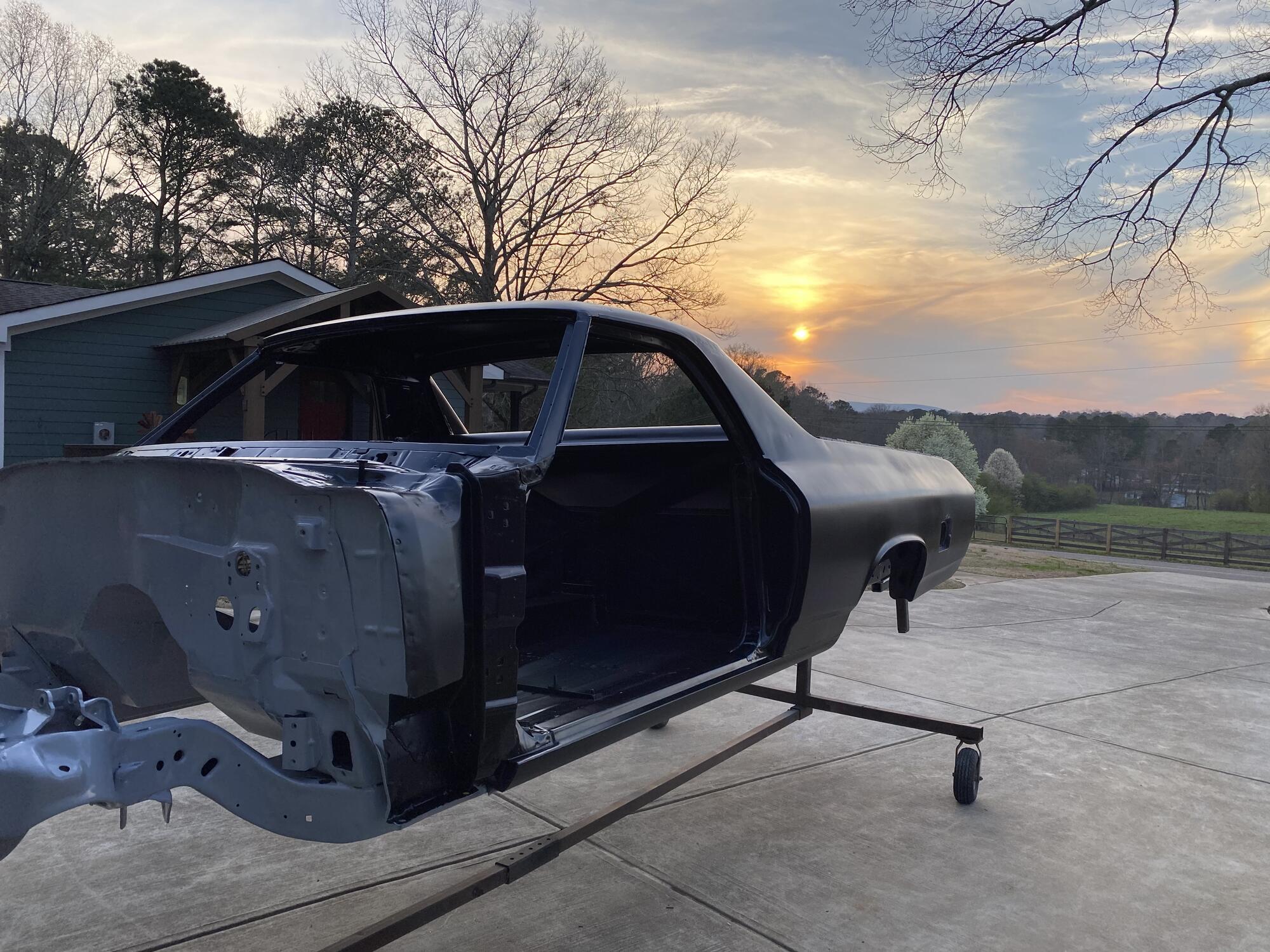

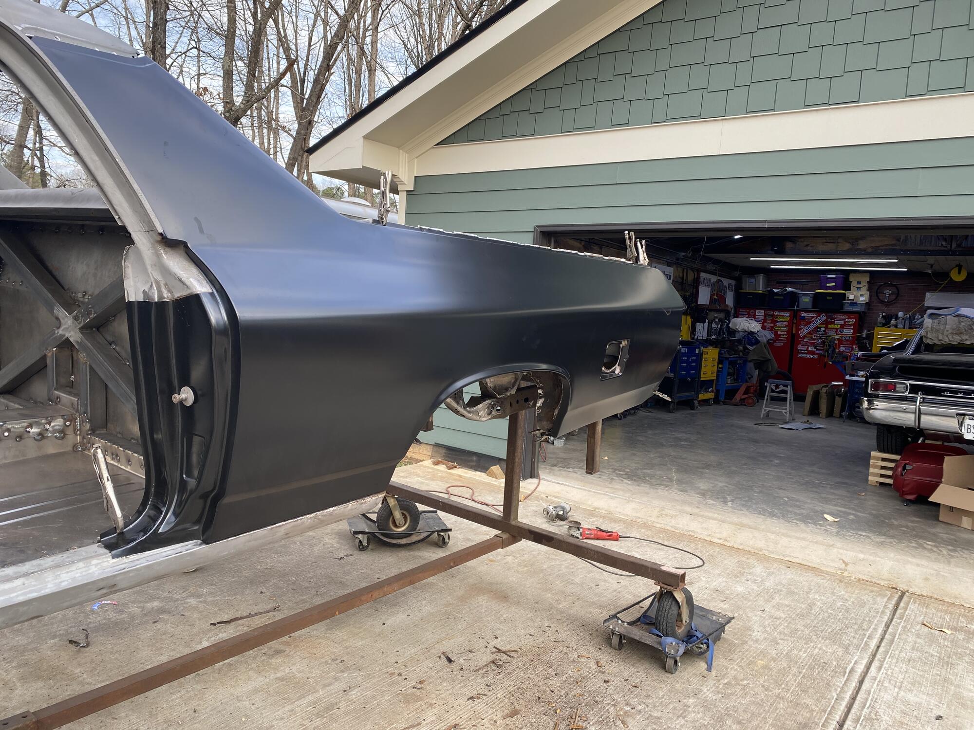

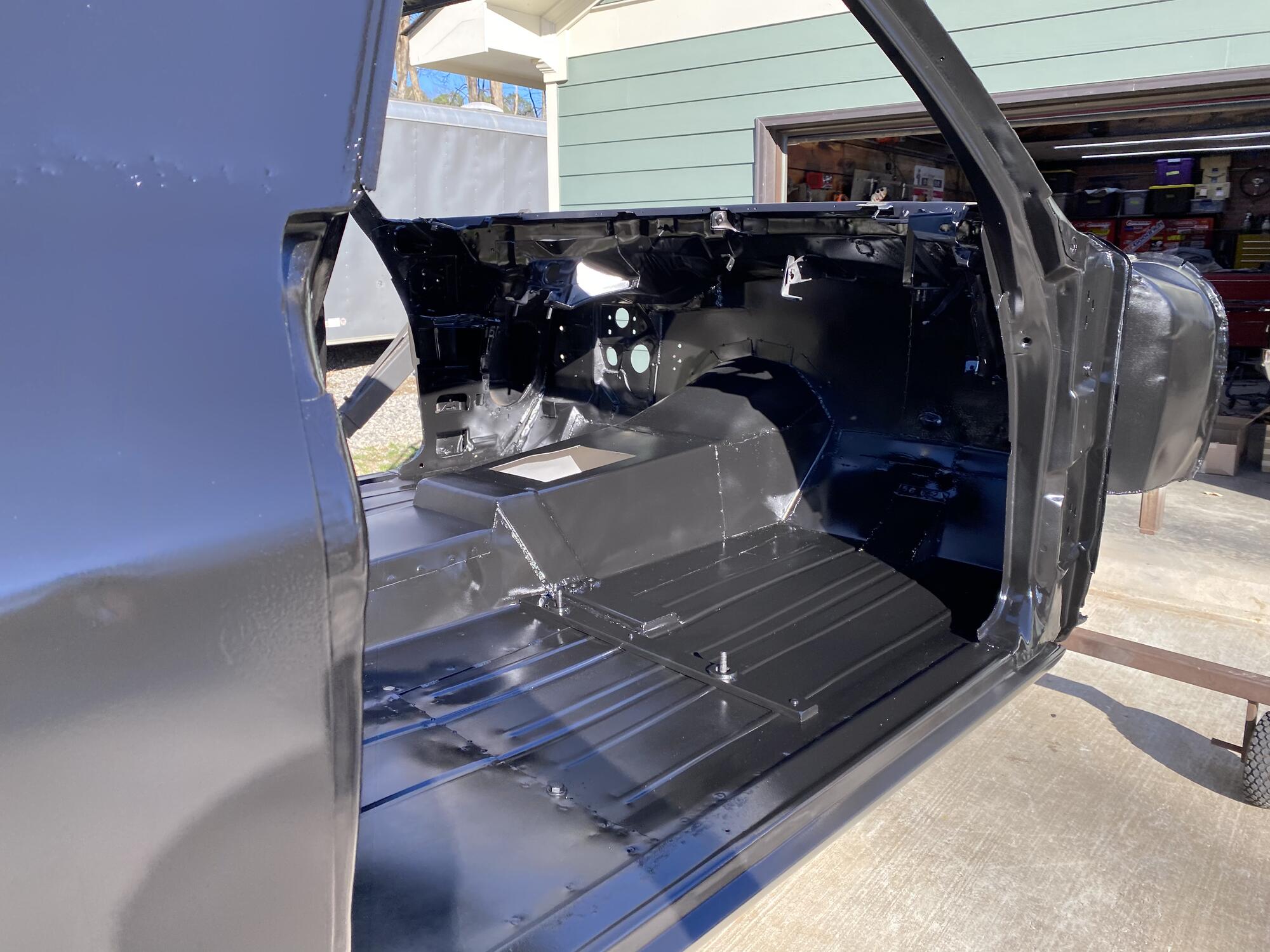

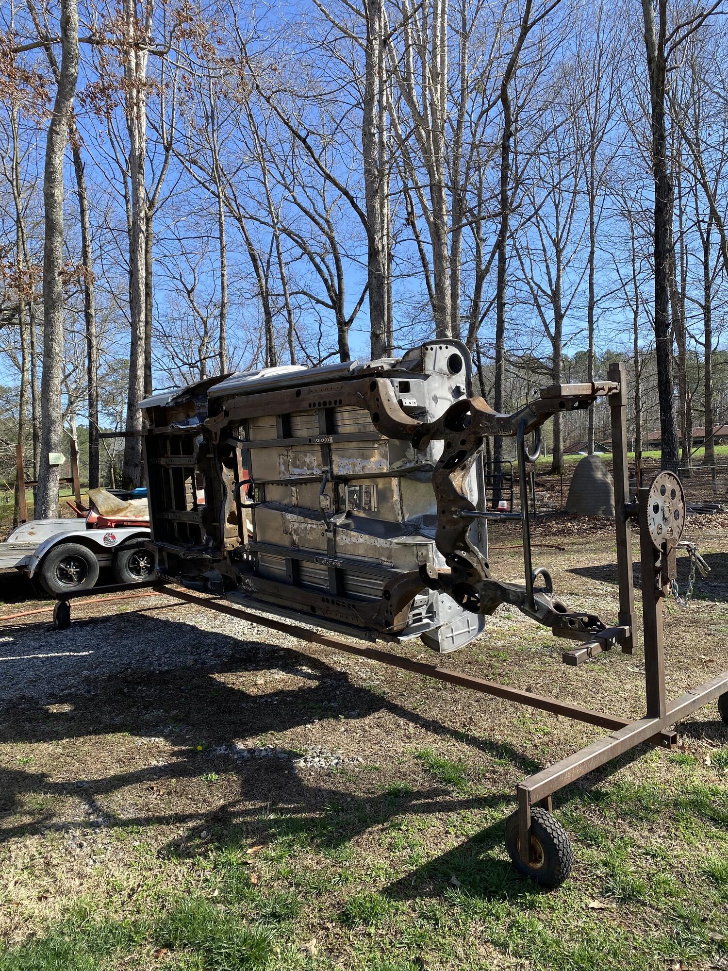

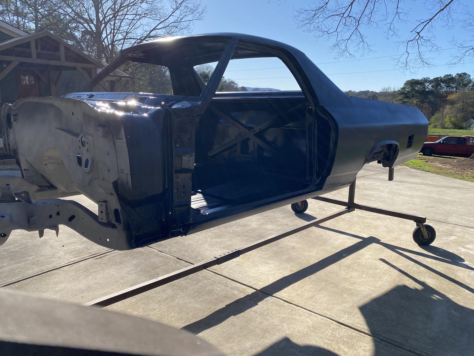

Size:  613.8 KBSo after yesterday work I was pooped went to sleep around 9:30esh woke up at 3:00 came out to the garage 4:30 esh took the glass and latch mechanism out of the doors so I could blast them.
      1:15 now and I’m done primering.
      Watching paint dry now.
      Doors are sandblasted and 3 coats of black epoxy
      In case anyone is wondering I’m leaving the car in black epoxy primer, no body work no paint.
      Just the black and a couple coats of satin clear.

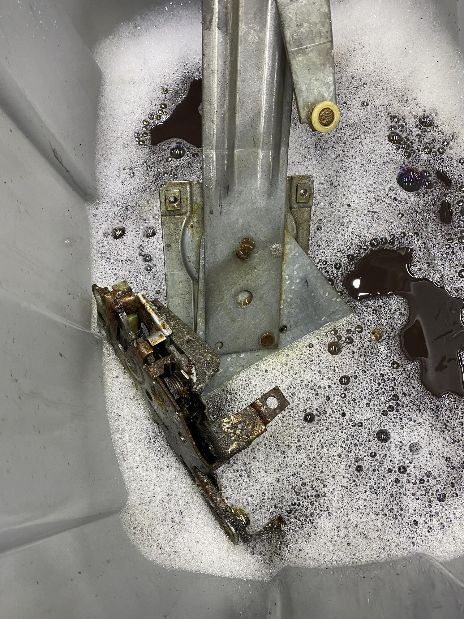

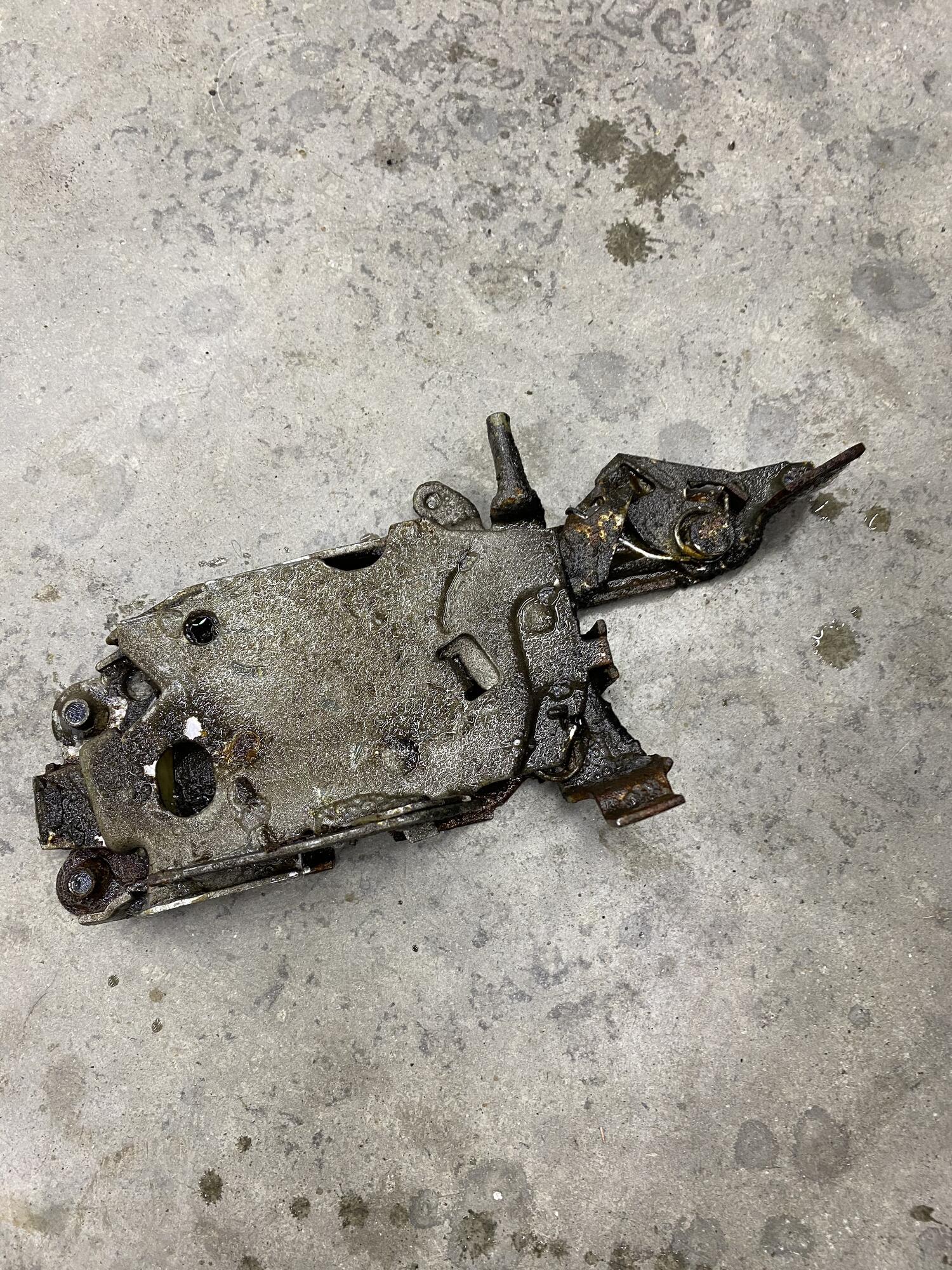

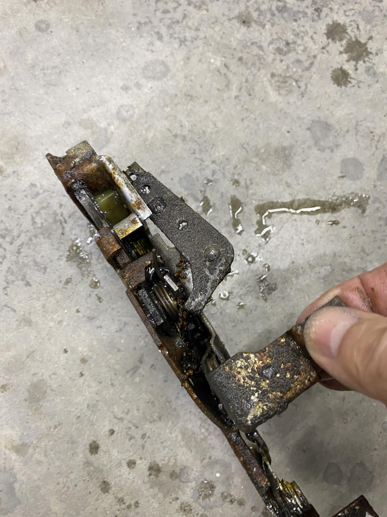

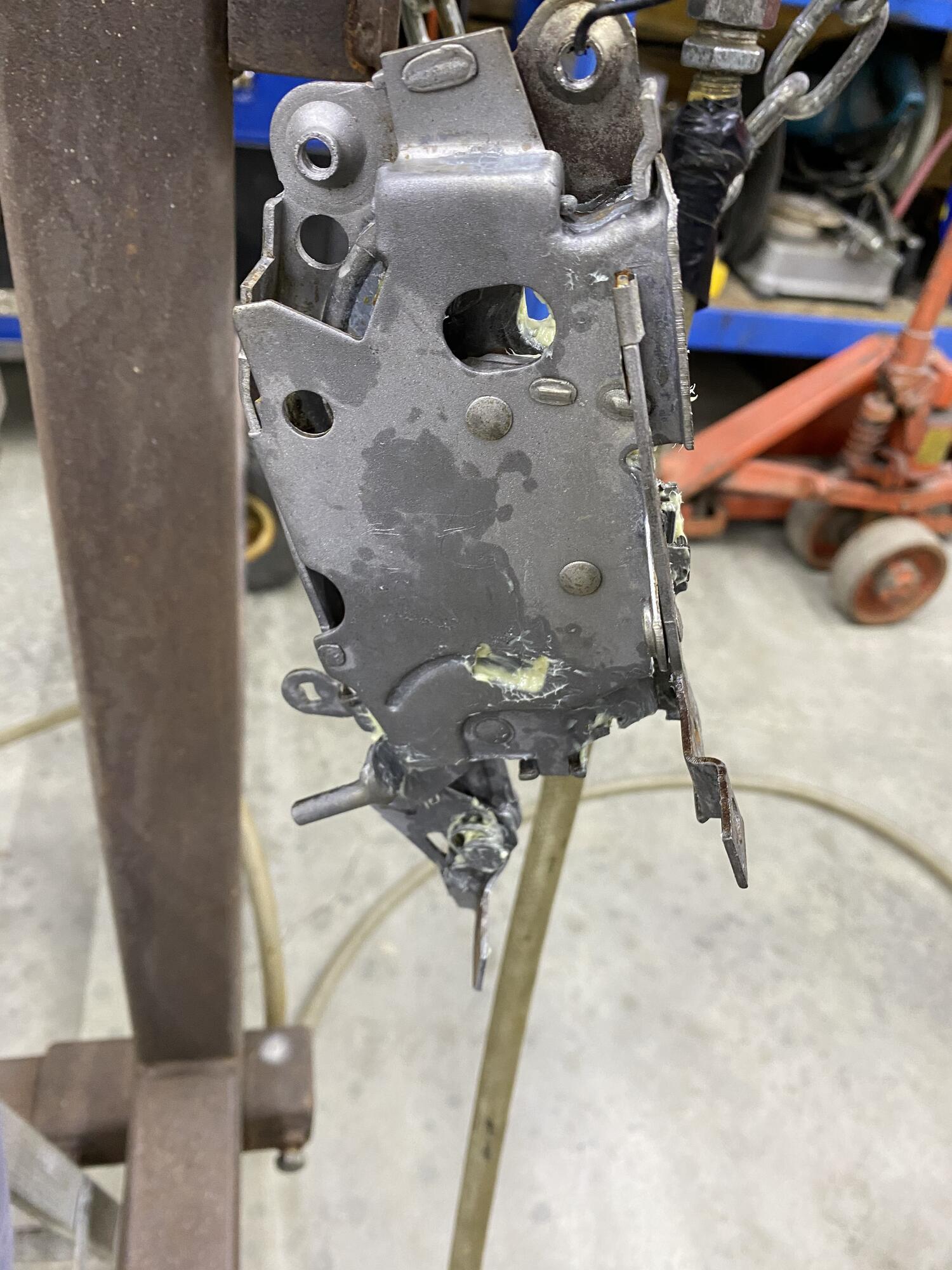

      Since we’re getting rain today and I wanted to keep moving forward with this I’m cleaning up the door latches and window regulators
      After cleaning a little lithium grease works wonders.Name:  4D006A82-30EB-41EF-9A4F-6B725C0426A9.jpg

    12. #172
      SF Bay Area
      463
      wow, your cleaning agent really works! What did you soak them in?
      chunger
      '68 Ranchero 500
      '70 Cougar XR-7 Convertible
      '98 Mustang GT Convertible
    13. #173
      Aug 2002
      Waleska Ga.
      2,722
      Quote Originally Posted by chunger;[URL="tel:1388009"
      1388009[/URL]]wow, your cleaning agent really works! What did you soak them in?
      It’s purple power degreaser and some dawn dish soap and a little water!

    15. #175
      Nov 2000
      O-town
      4,330
      Quote Originally Posted by David Sloan View Post
      David, PP works great, just don't use it on aluminum, it turns it white and fuzzy instantly, I have a Safety Kleen parts washer and put that in it, cleaned some Toyota engine parts and bam!

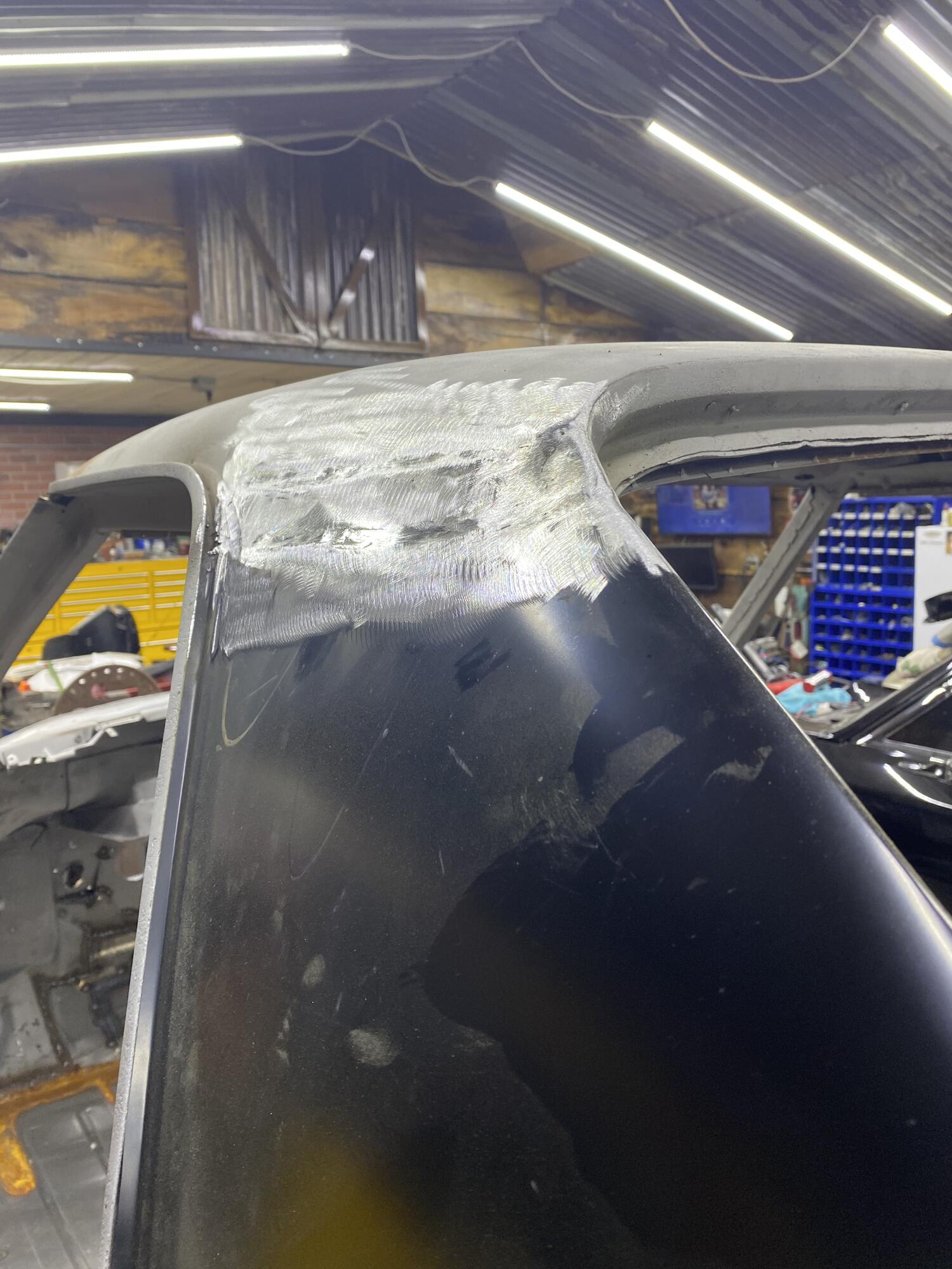

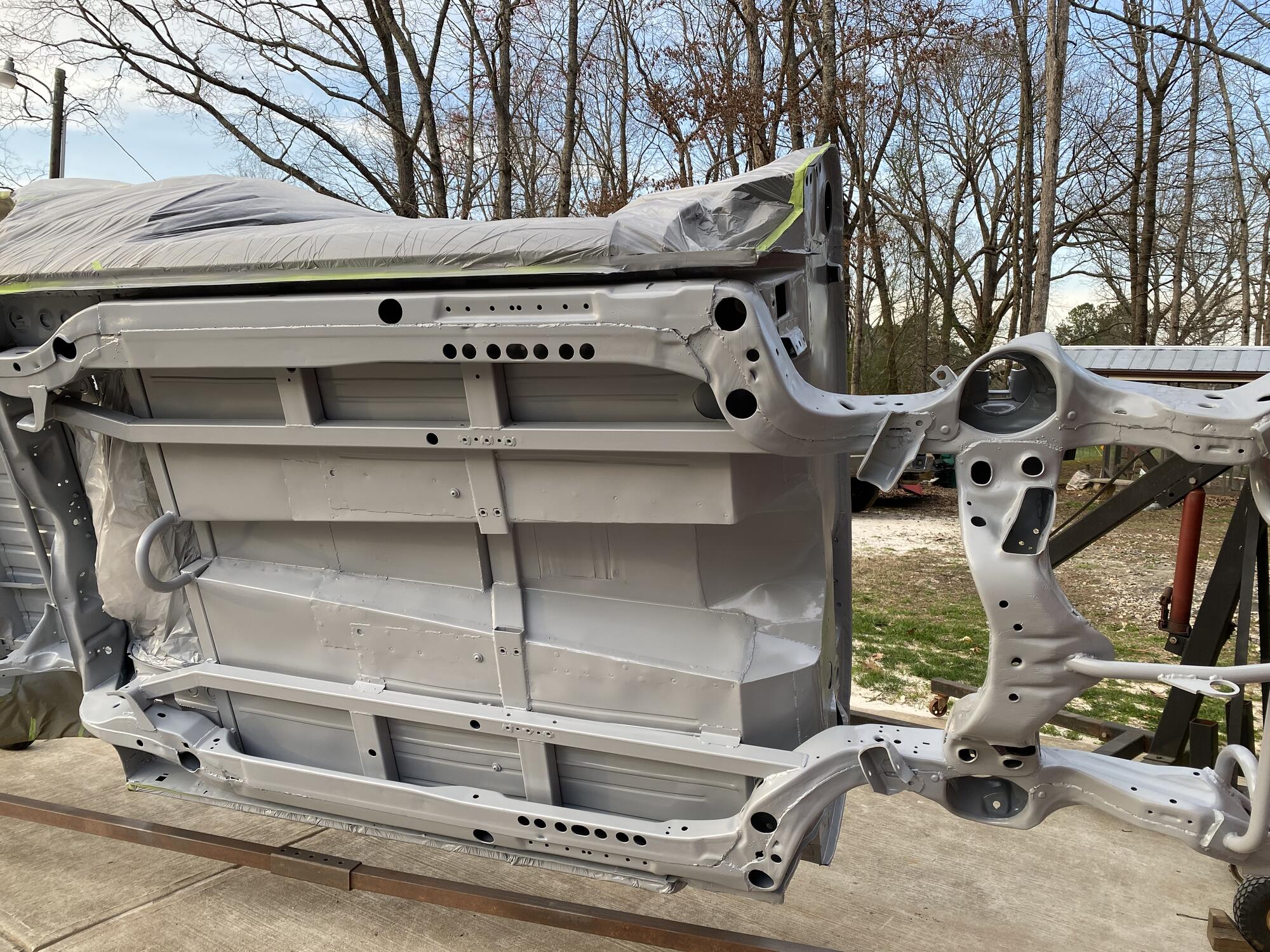

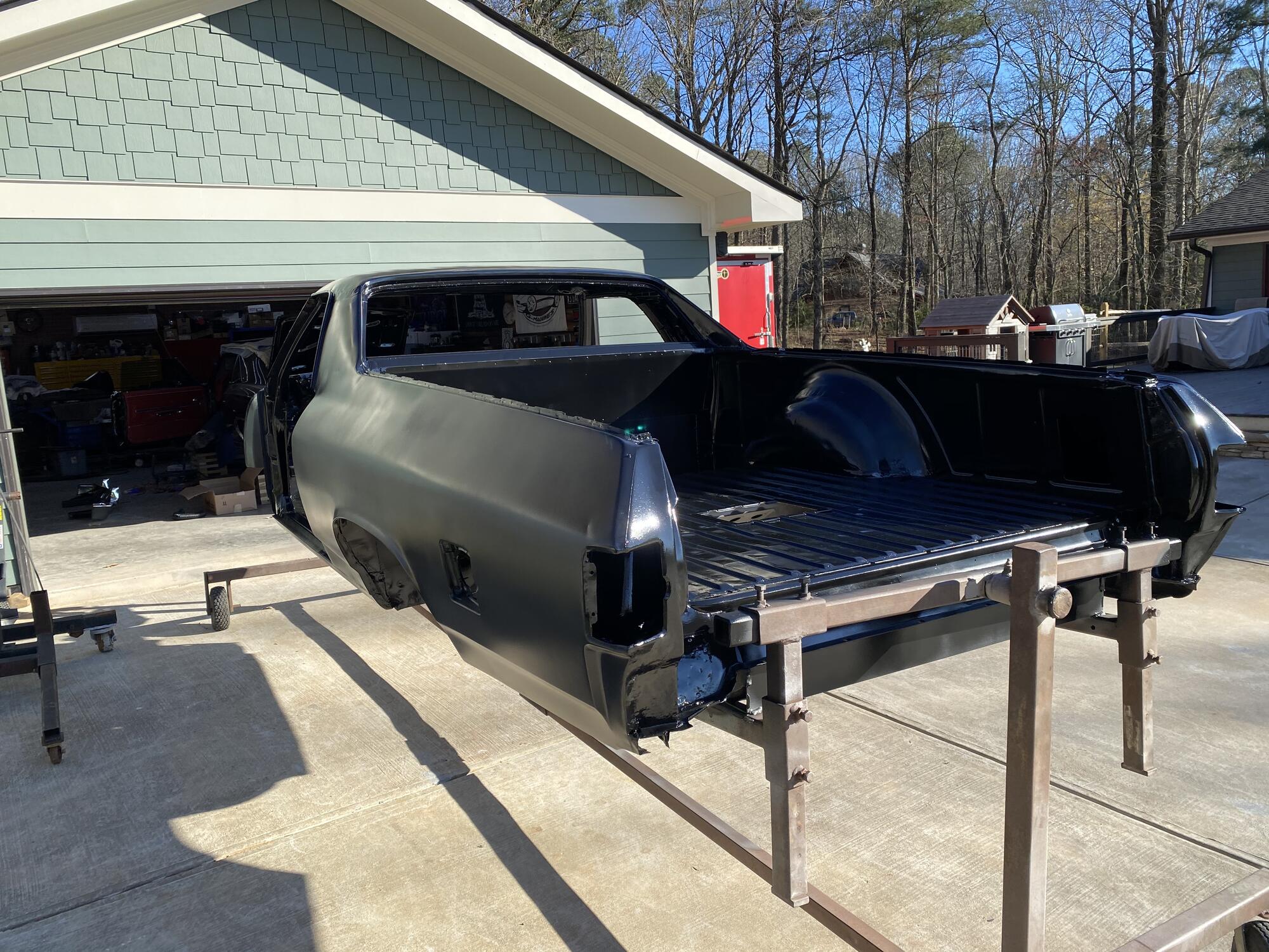

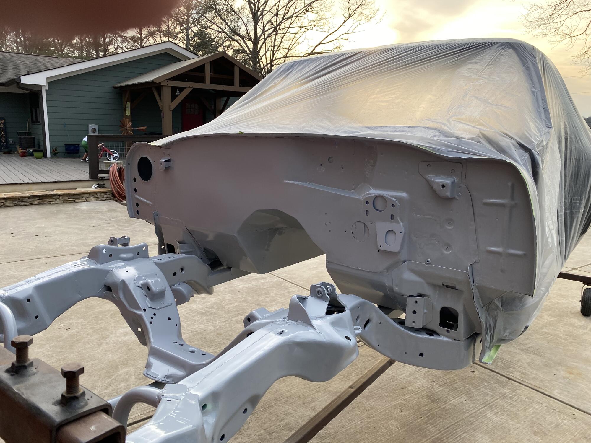

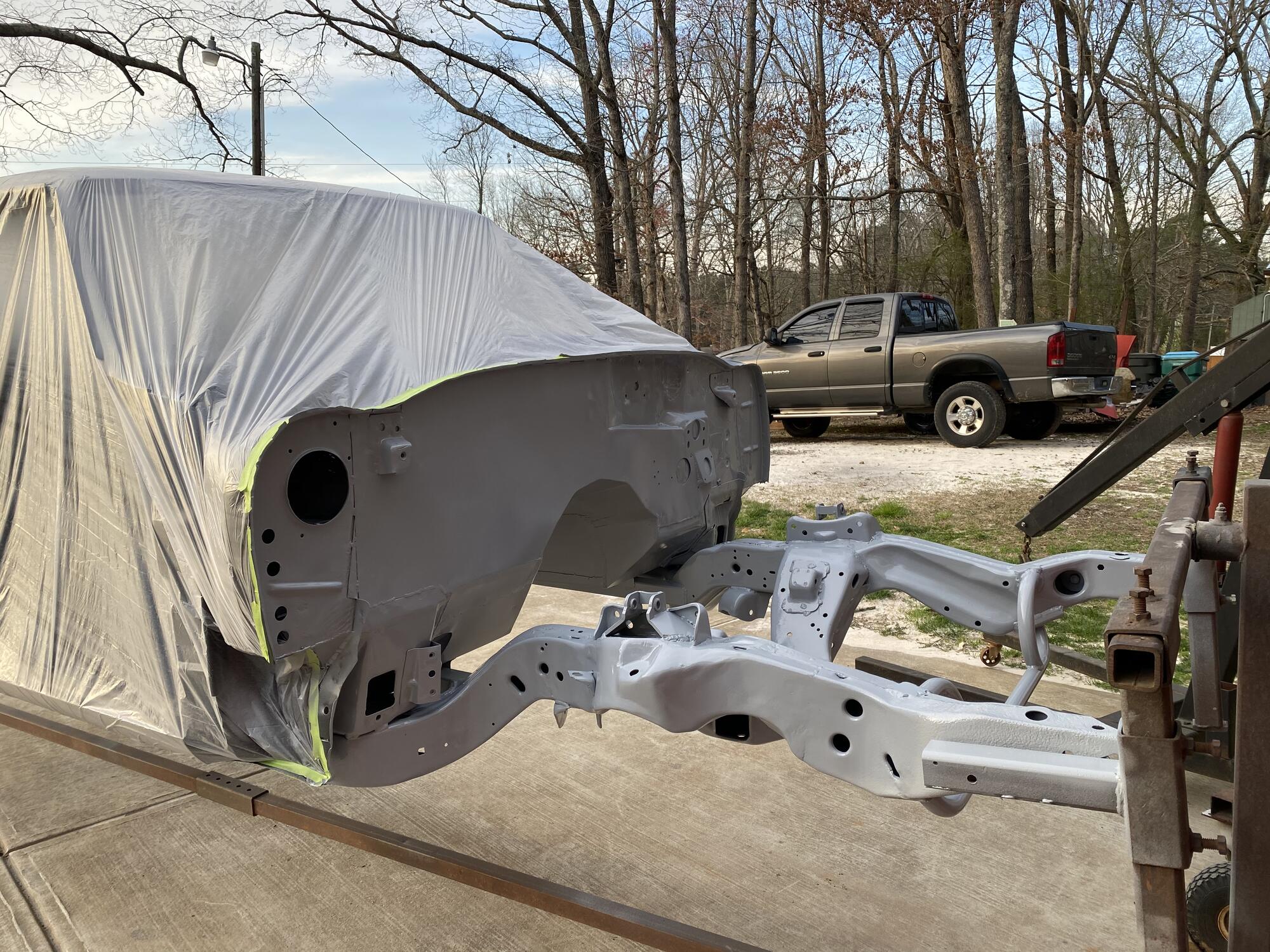

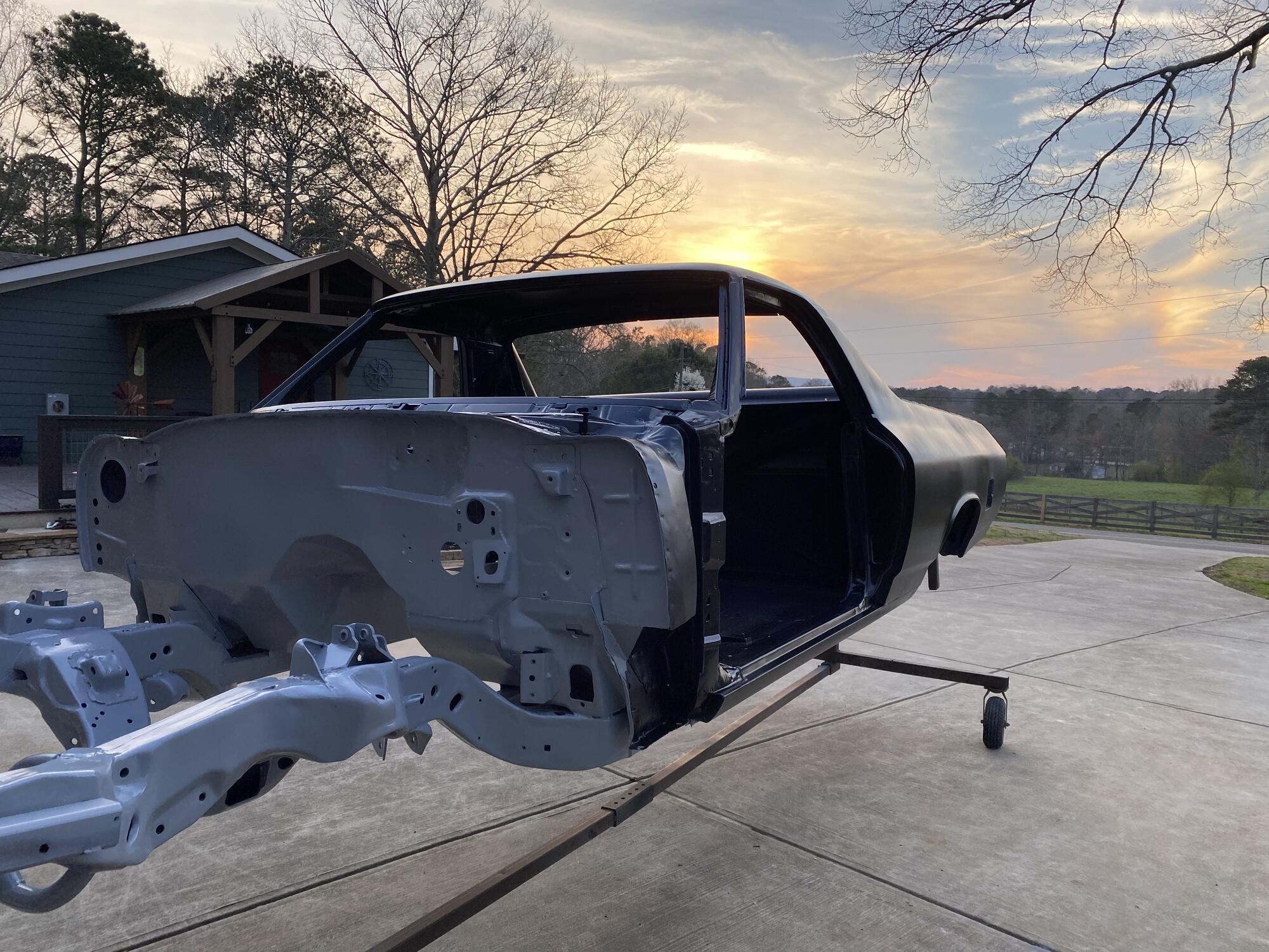

      Body in black epoxy primer, hopefully can get this thing taped off tomorrow then the gray epoxy to the frame and the floors.

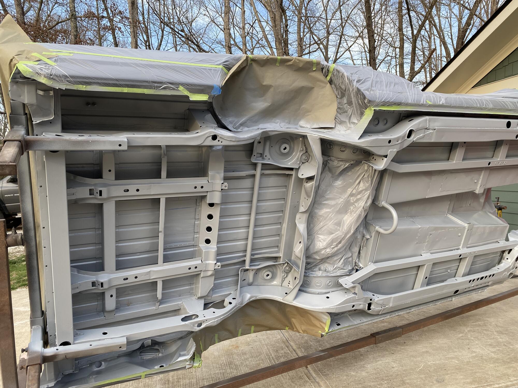

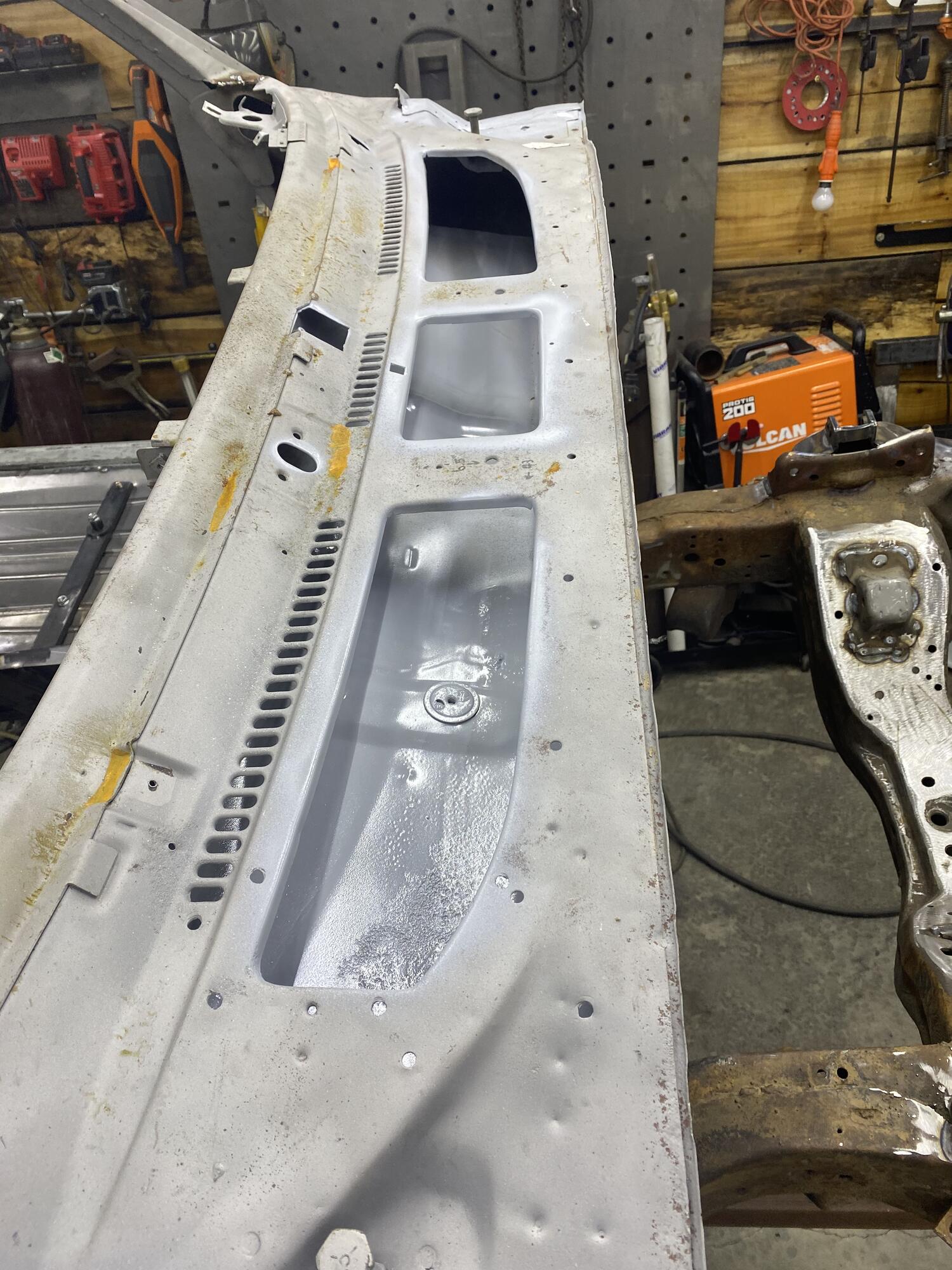

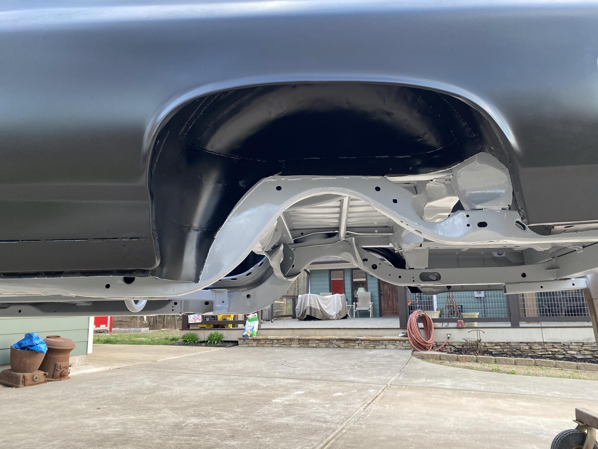

      Frame and floors in gray epoxy primer.Name:  813E1D53-7E3C-4FA7-9CB5-2736B7FFA8ED.jpg
