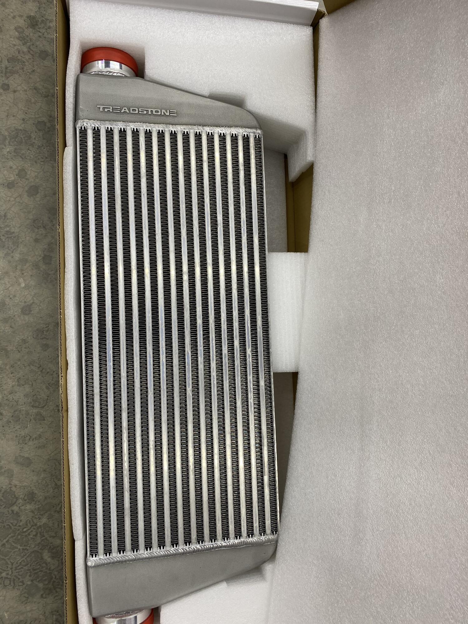

      I was working on the the garden and some of the turbo parts I ordered showed up! The inner cooler and the 3” stainless to finish the exhaust with. Still waiting on the 2.5” stainless for the cold side.Name:  E899FFCA-10F7-4AF2-8DB5-9BA105E7B6FB.jpg

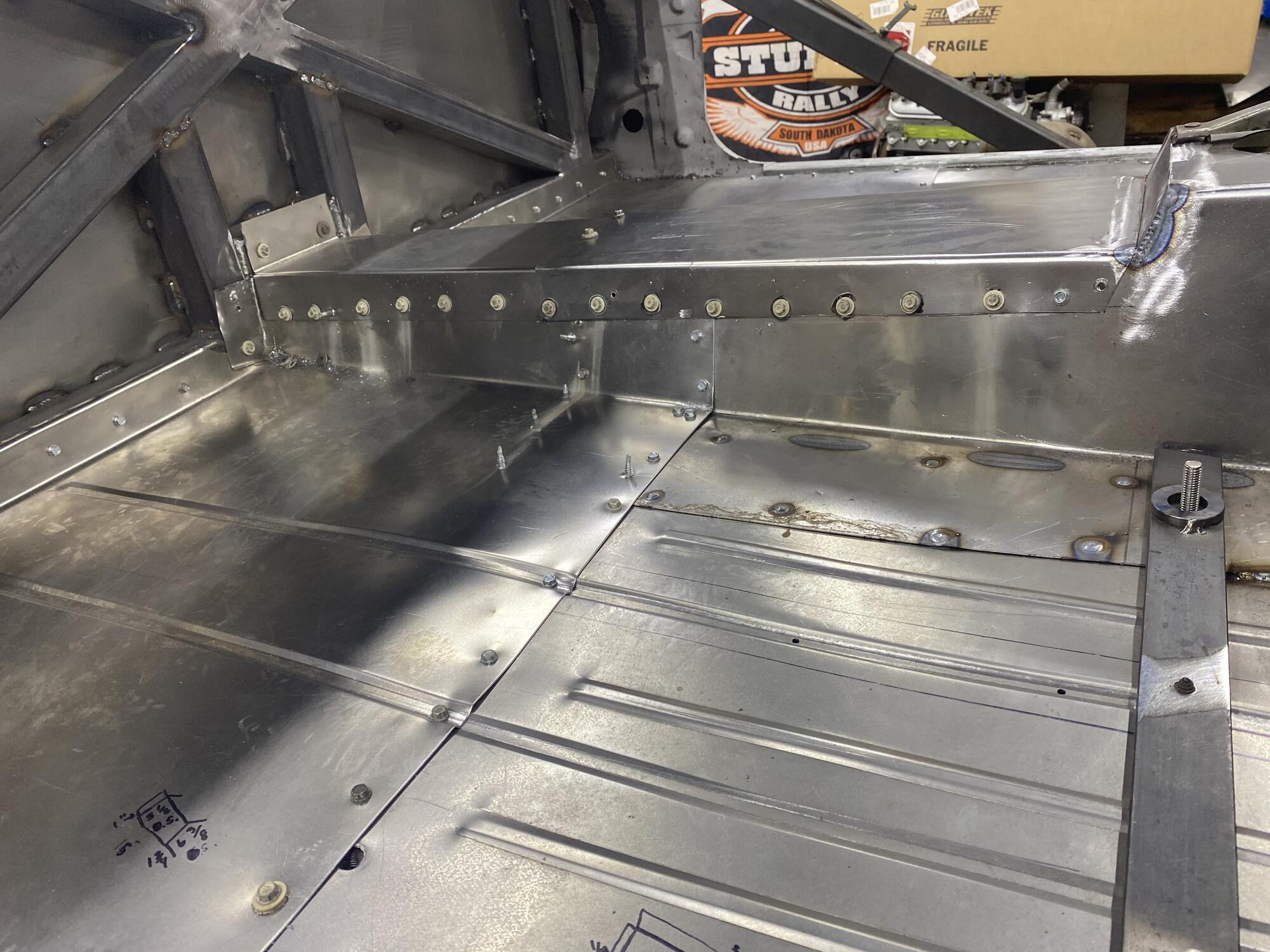

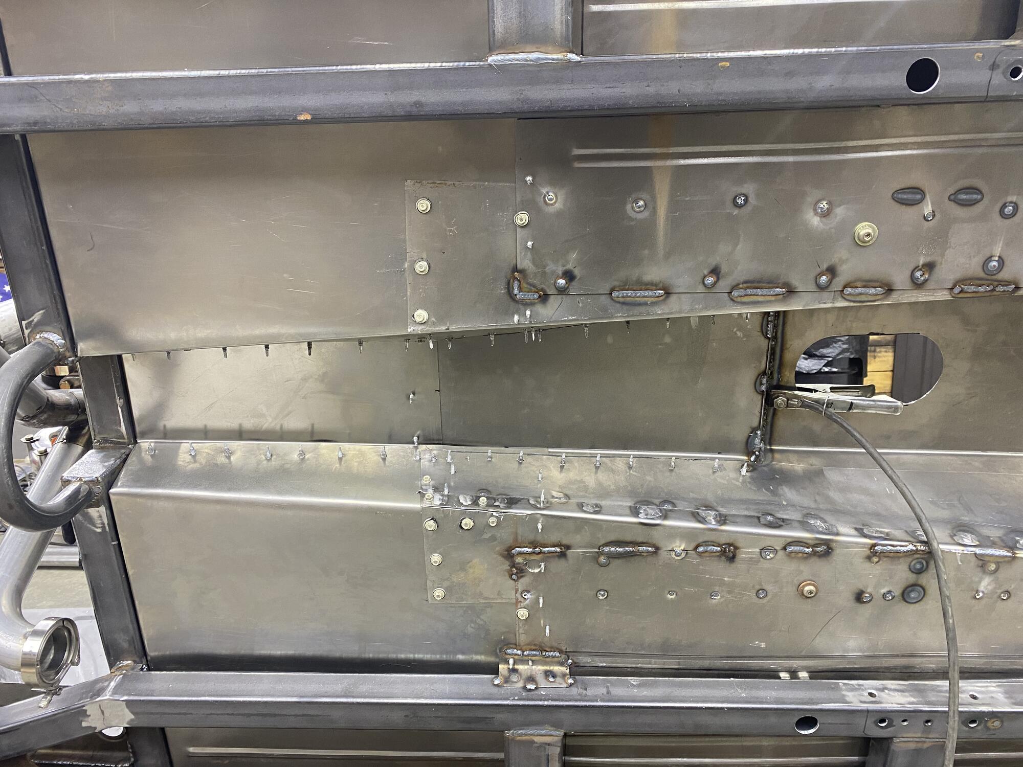

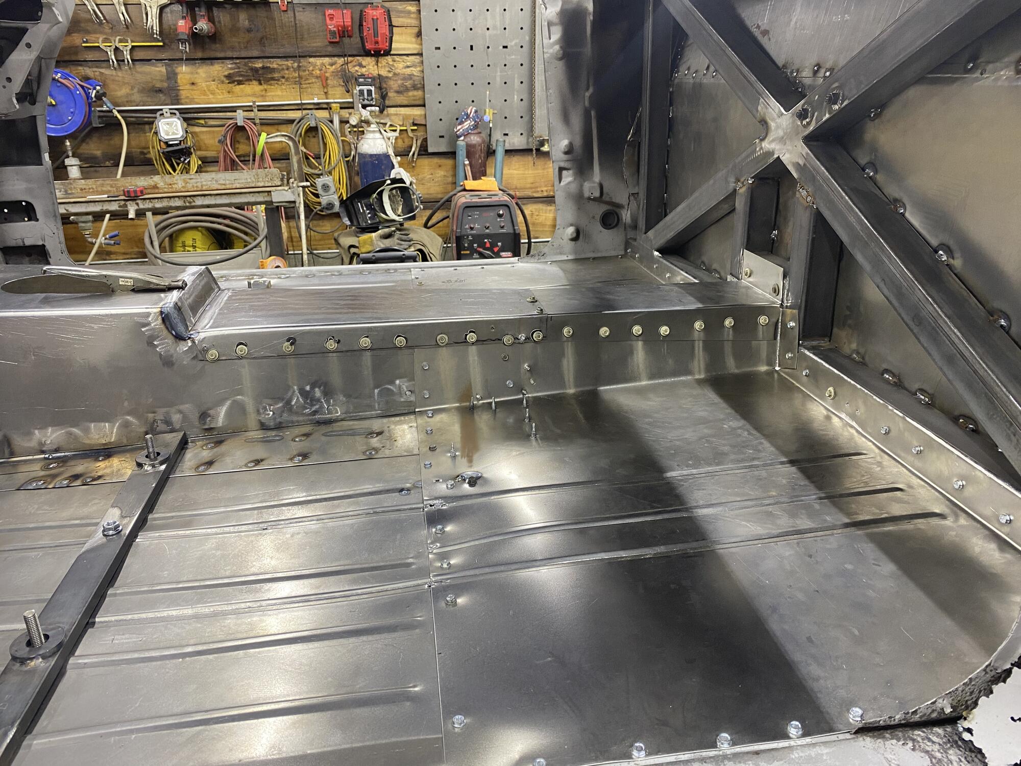

      Little more work on the floor pans/transmission tunnel.Name:  F1309B01-DDD2-43CC-9EBC-E56D9AFC336F.jpg
Size:  437.5 KBName:  5182E1FE-9038-41BD-A995-DD58F7774E92.jpg
Size:  348.8 KBName:  9E957E90-7C5C-42FE-B46B-35EC5CB84175.jpg
      Everything is fitted and tech screwed in place Name:  F1309B01-DDD2-43CC-9EBC-E56D9AFC336F.jpg
Size:  348.8 KB[ATTACH=CONFIG]186430[/ATTACH. It ant pretty but very functional.
      David Sloan

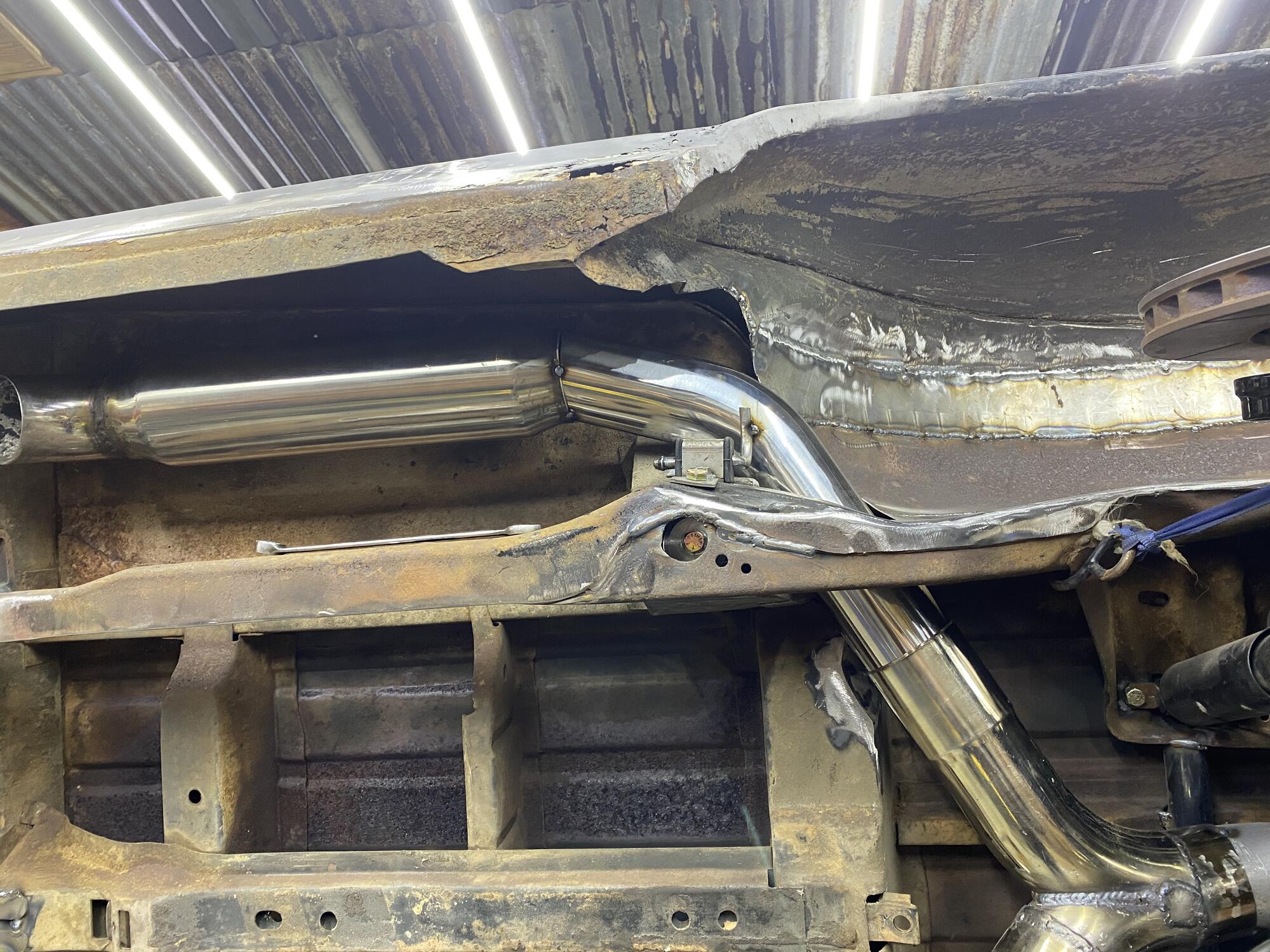

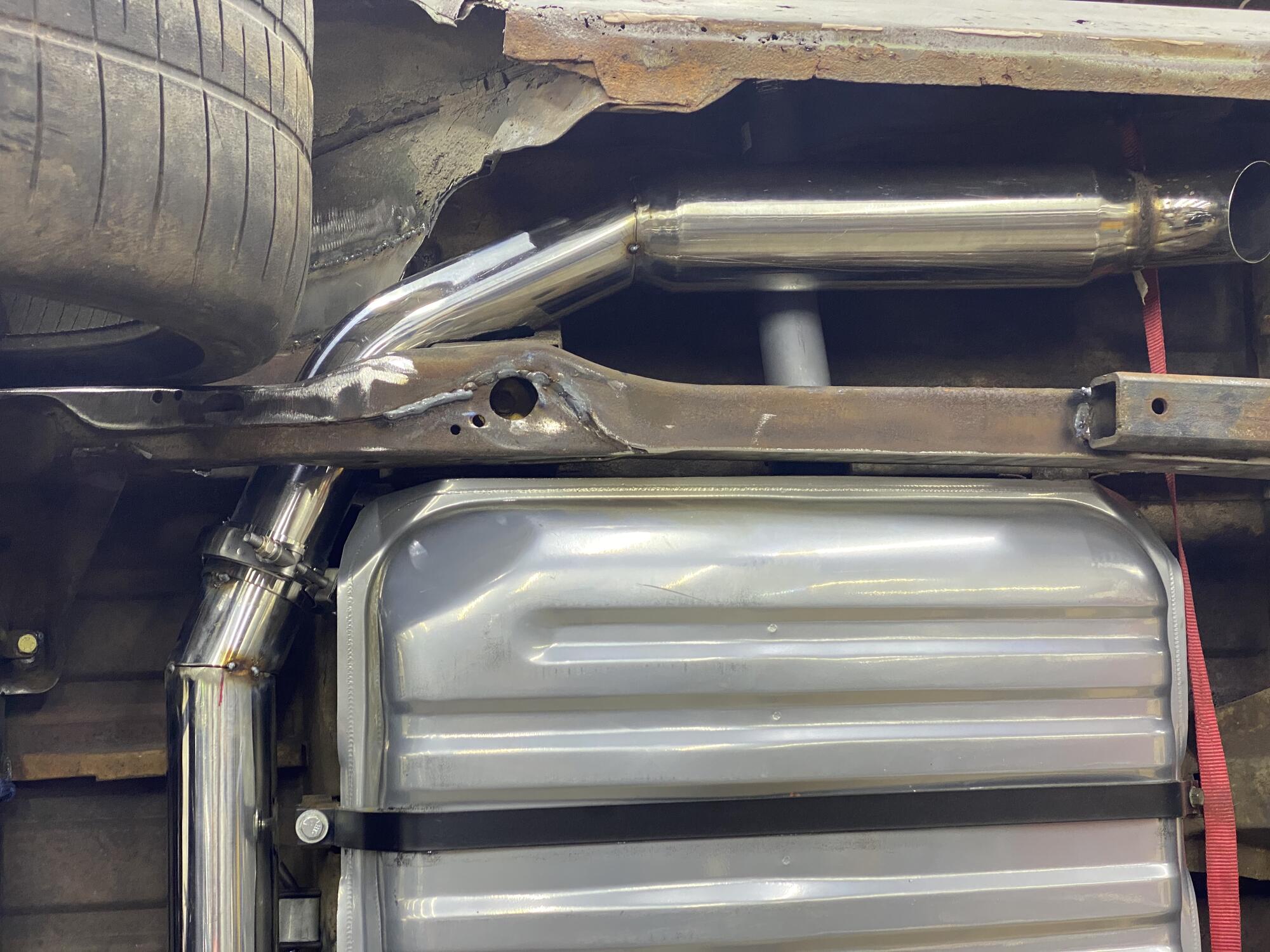

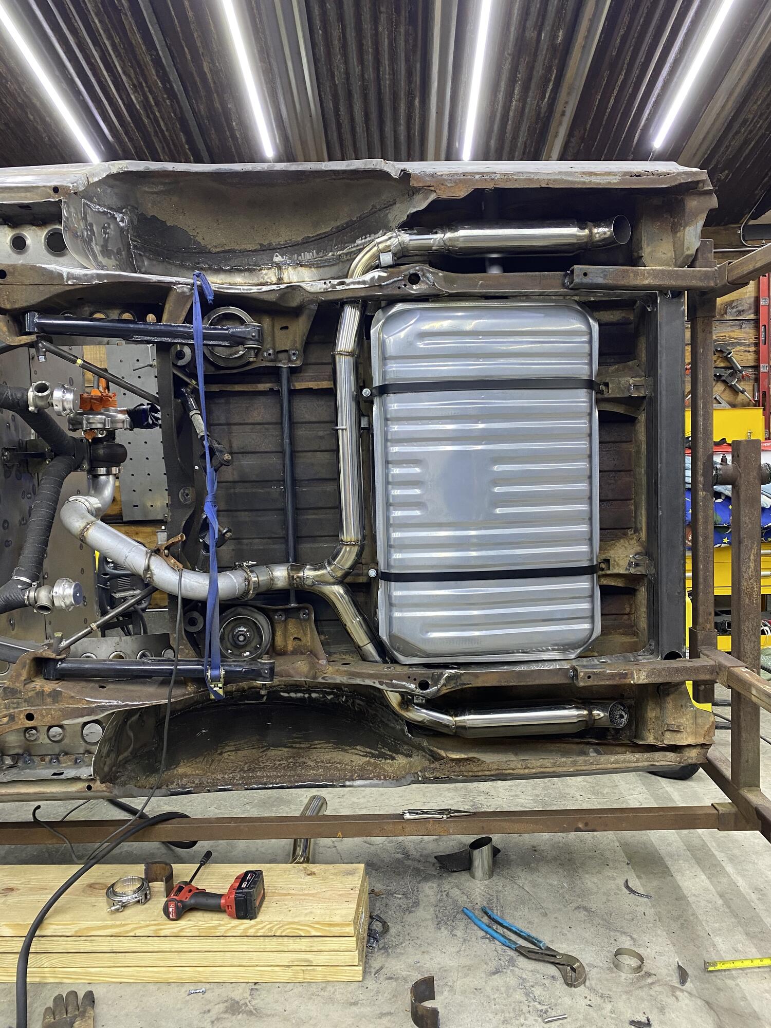

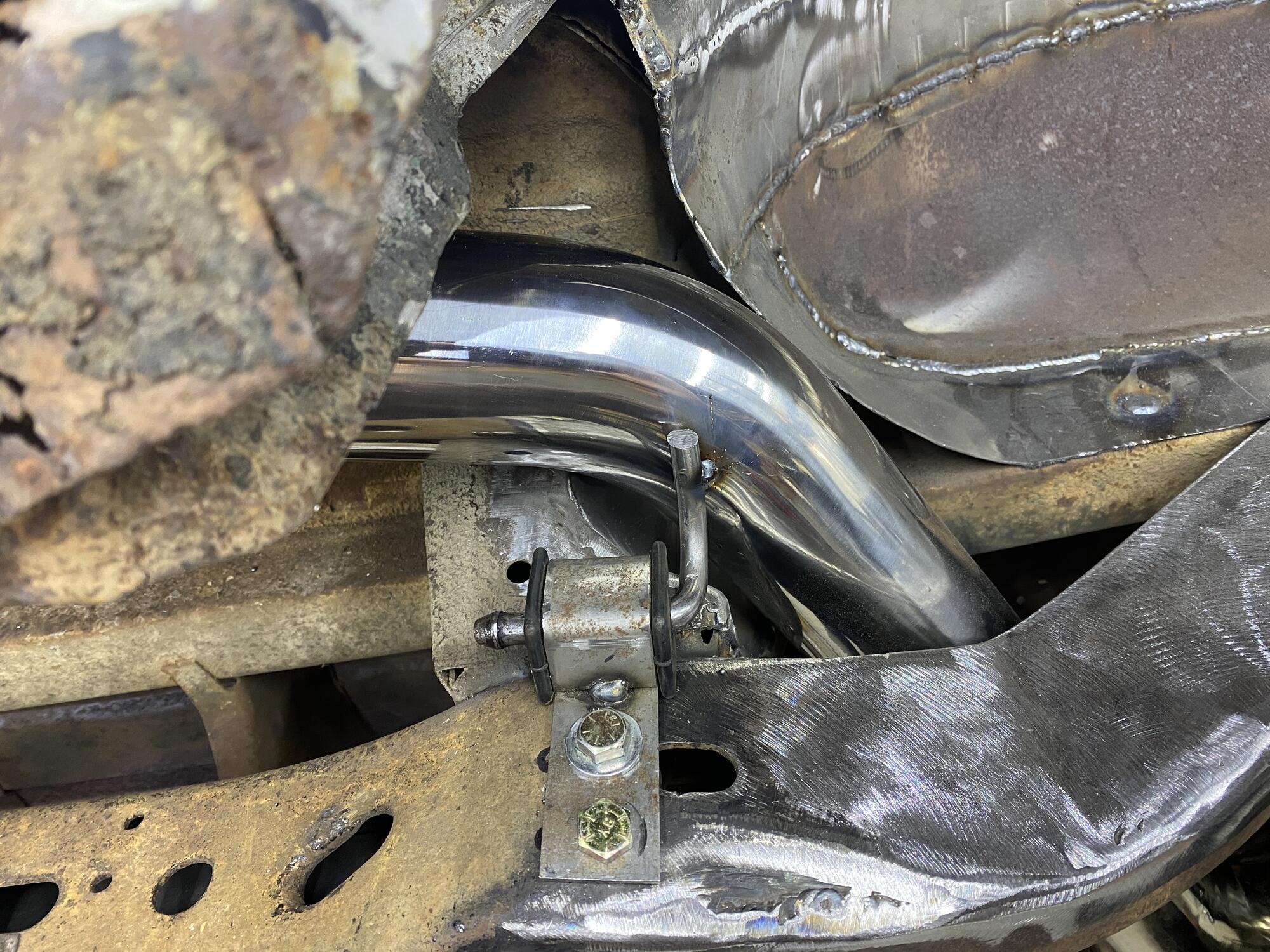

      Small update. I revisited the exhaust from the turbo to the rear yesterday, I got the passenger side tacked welded for fitment . The plan is for it to exit the bumper, I want to do cut outs in the bumper for the exhaust tips. I had to do a little notching on the body mount to get the 1/4” clearance I wanted. So far so good

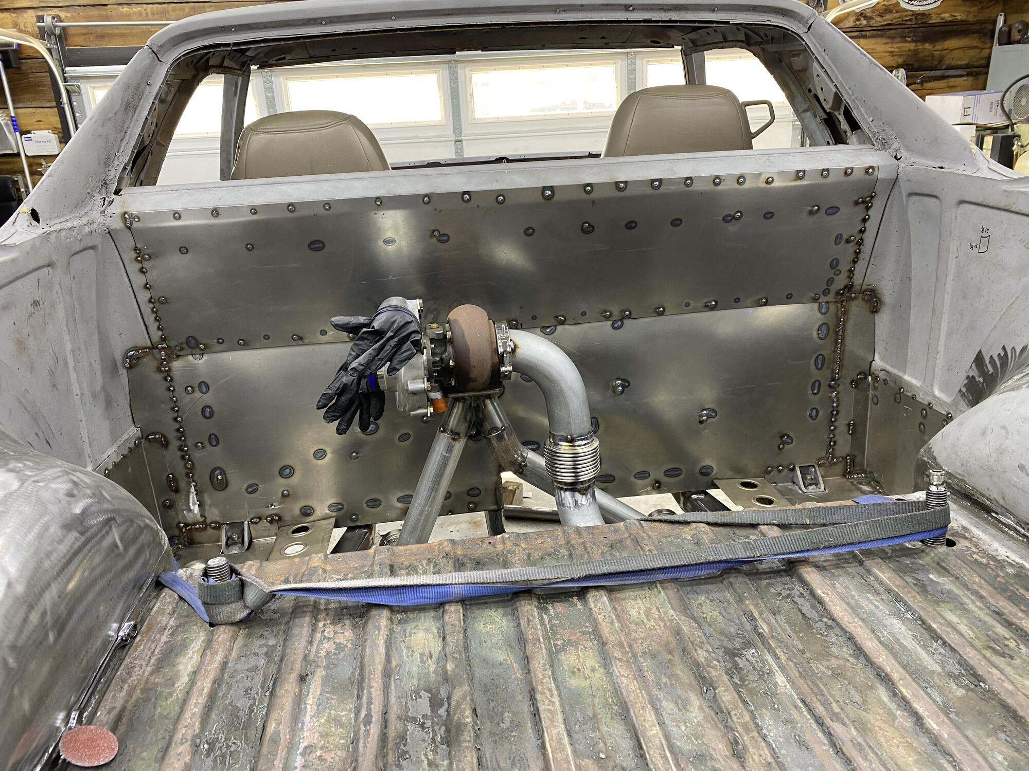

      Expansion joint fitted and tack welded in to the exhaust side of the turbo.Name:  E26AB374-D76E-4945-8F4D-EE883A3F1E30.jpg

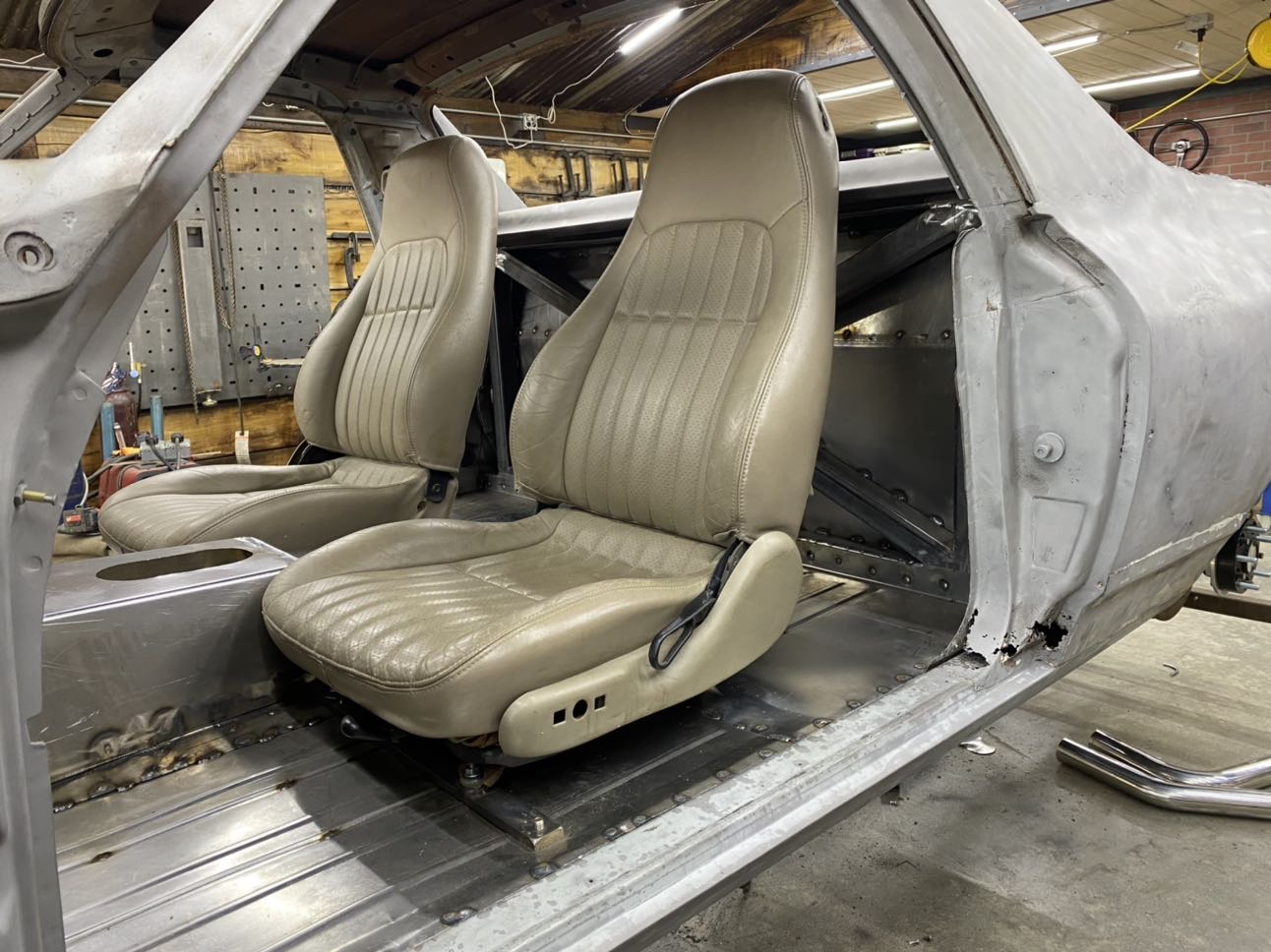

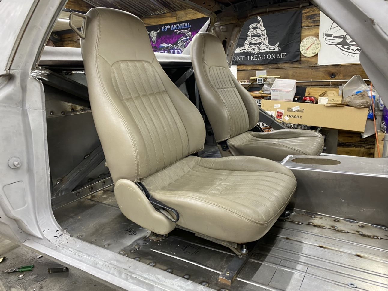

      Now that the floors are welded in I could finish the mounting of the seats. The rear of the 4 gen Camaro seats had about a 20% angle from my flat bottom floors. So to fix this problem I cut both sides off mounted the seats in loosely. Then I a-lined the cut off pcs. with the tracks then tack welded them together. Then I checked to make sure they still work properly.

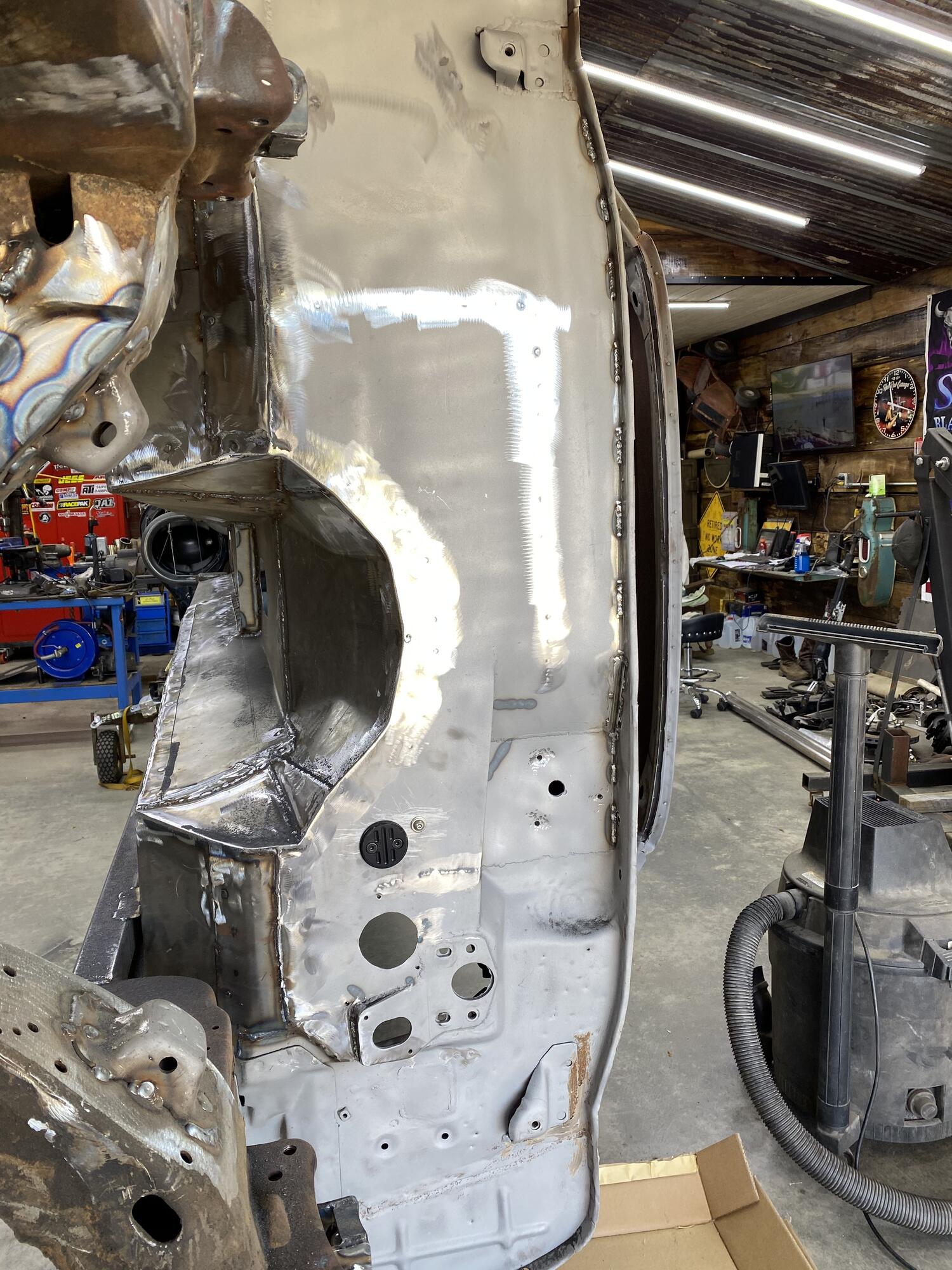

      I did start some cleanup on the firewall and floors Name:  6866006D-E689-4730-ABCF-255A7869D8E6.jpg

      Making solid progress. That turbo will make all kinds of noises by your head...LOL
      How are you handling the oil drain back? It looks like a pretty long, arduous path back to the oil pan.
    13. #133
      Maryland
      1,863
      Good thing it has turbo power, because it seems to be like everything I build........very fond of gravity.
      Ron Schwarz
    14. #134
      Aug 2002
      Waleska Ga.
      2,722
      I’m hoping with the turbo mounted as high as it is and a big return line that gravity will send it back . If that doesn’t work then plan b is a scavenger pump.

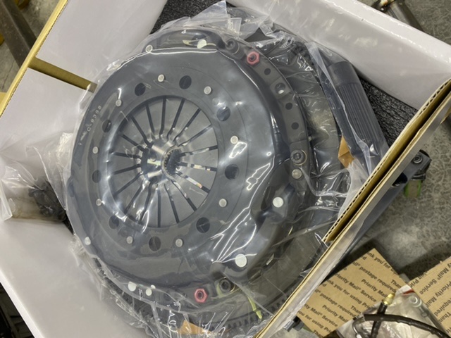

      Then this happened. I sold my upgraded t56 Camaro transmission an bought a upgraded t56 magnum with quick time bell housing. Also got a twin dics 1000 hp clutch billet fly wheel.
      Should be overkill for the 500 hp to the tire I’m shooting for. Name:  0237713F-3B63-4A9B-AE39-59AC6906DFA8.jpeg

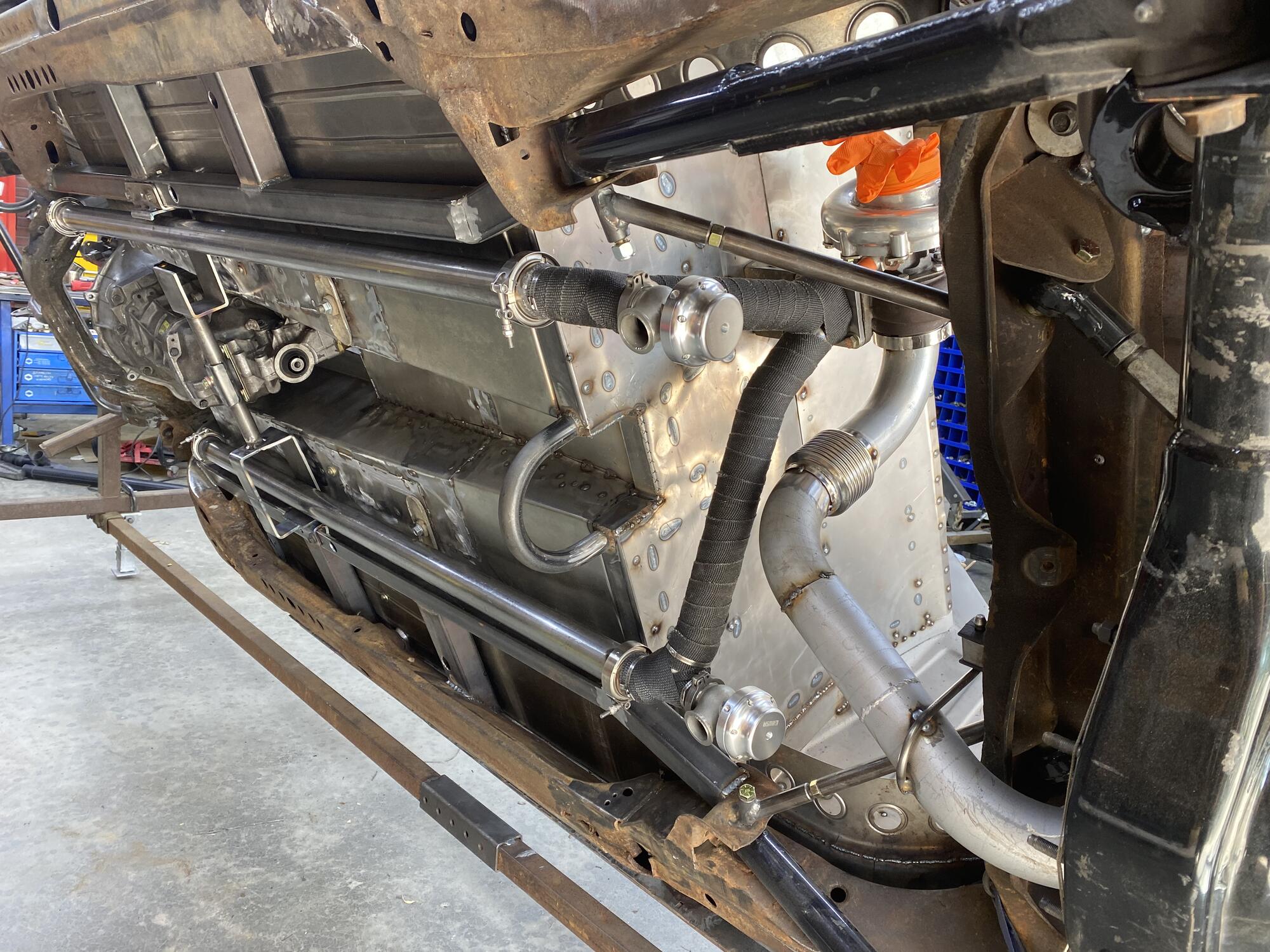

      Back to work on this one!
      Finishing up on the exhaust. Got the exhaust all mocked up everything looks good so now we start talking it apart for finish welding.

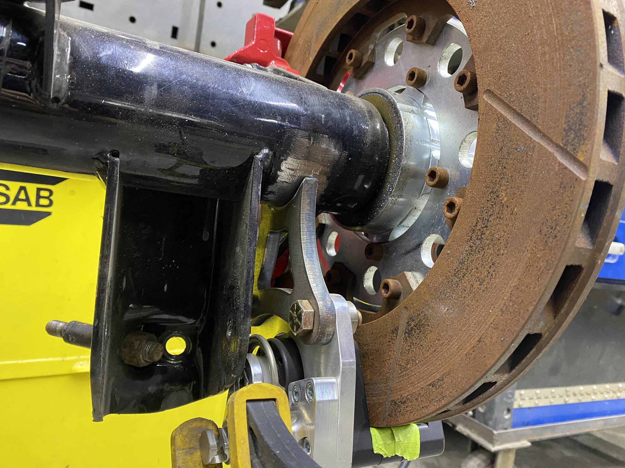

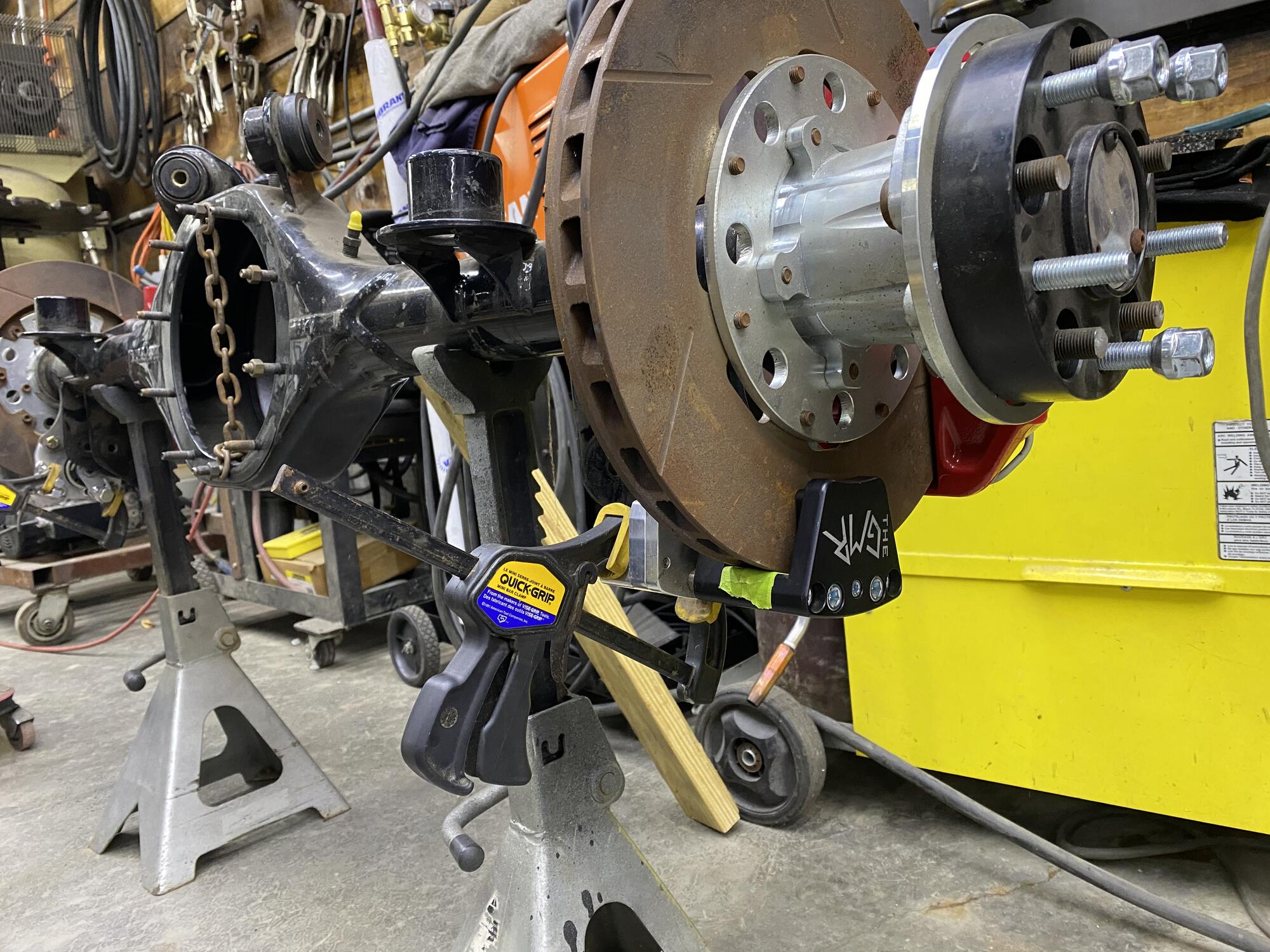

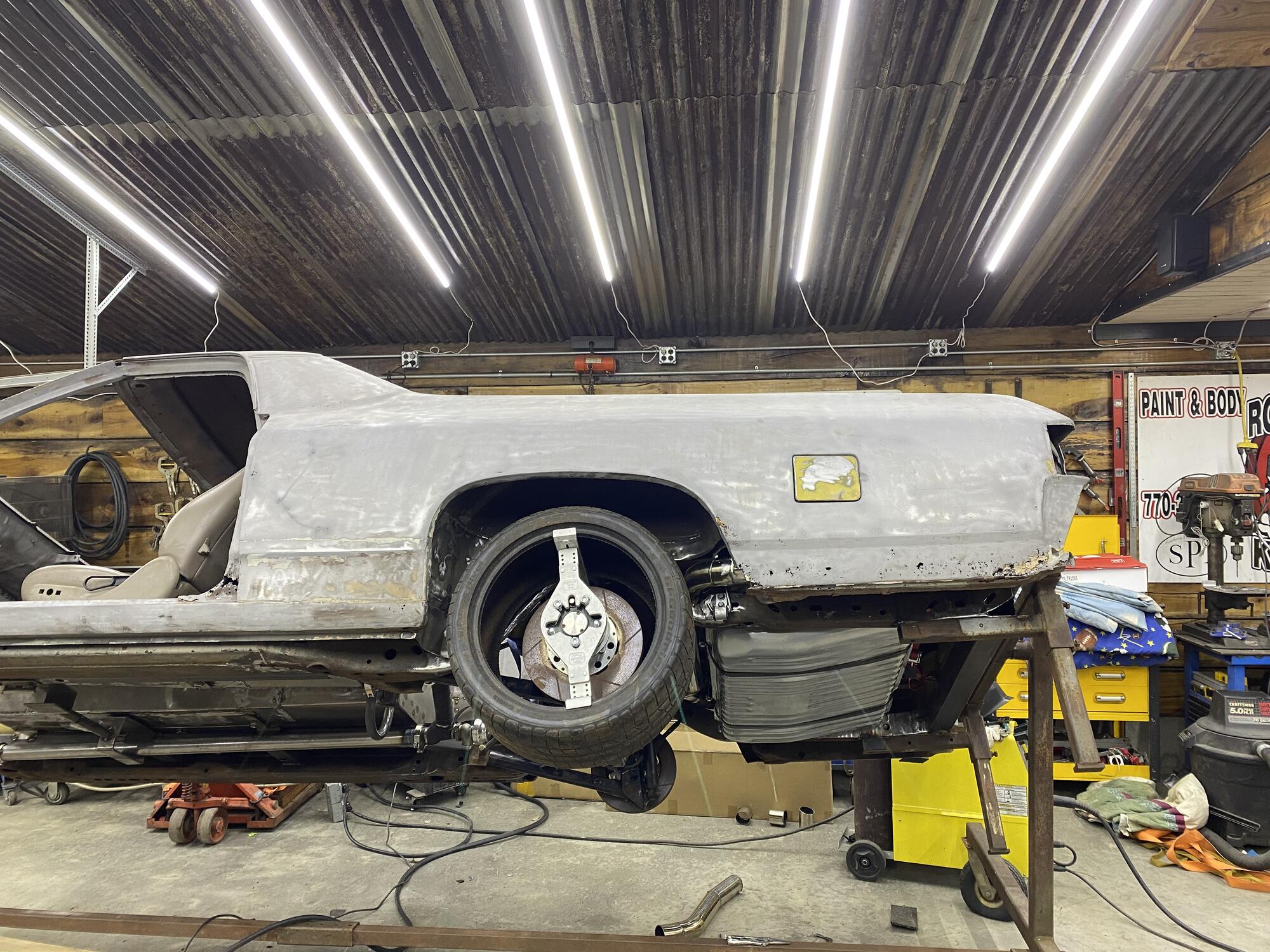

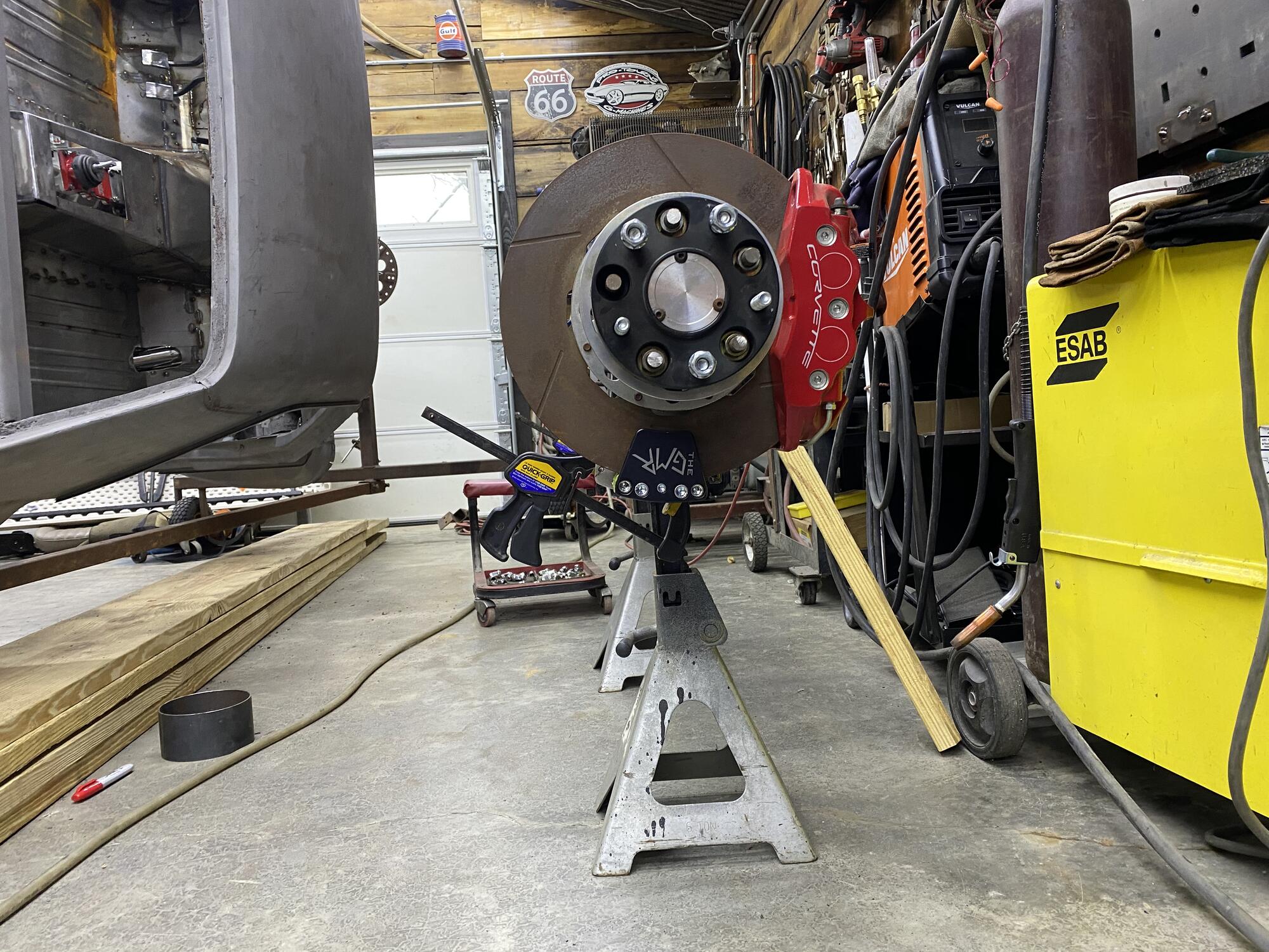

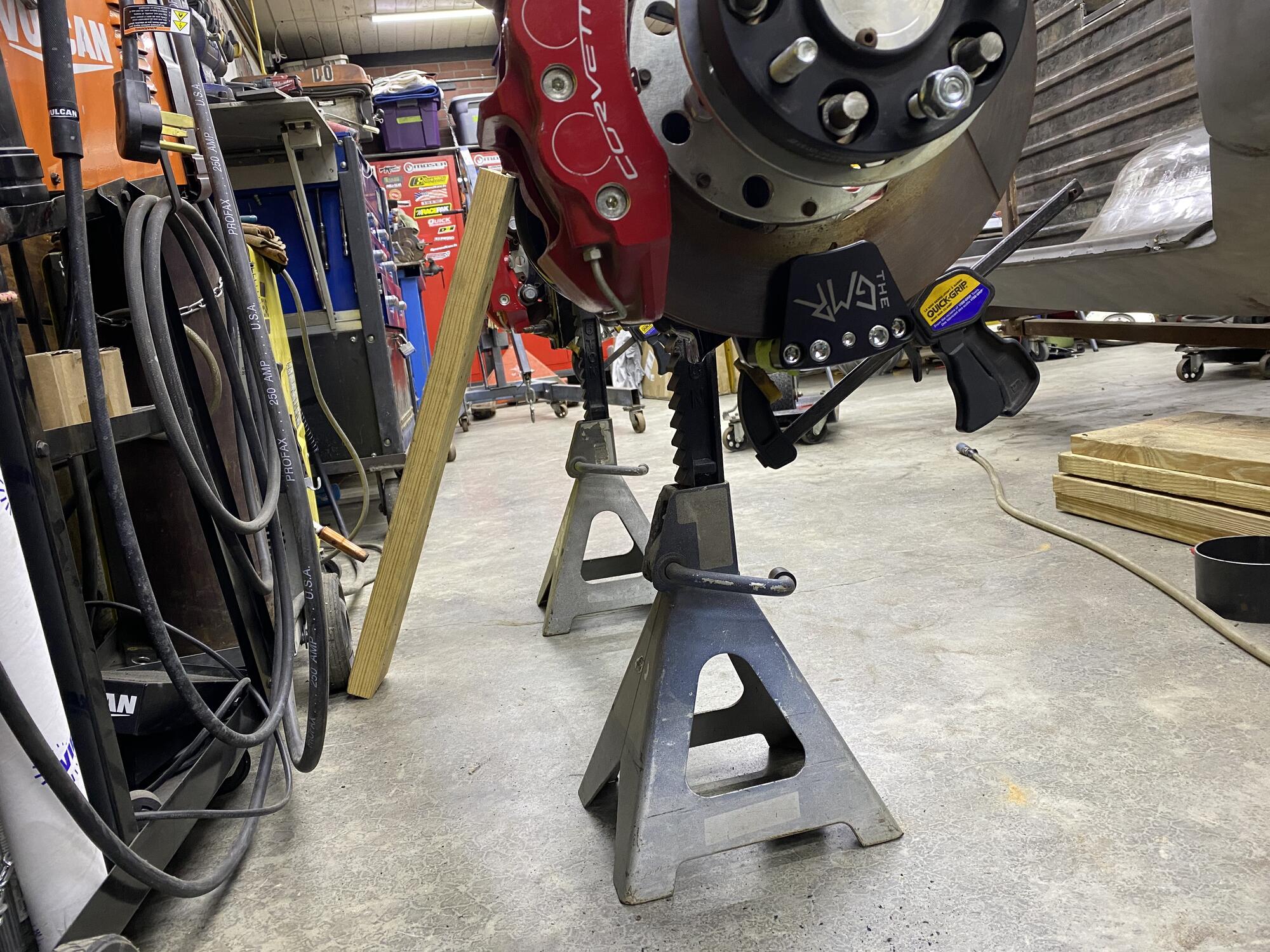

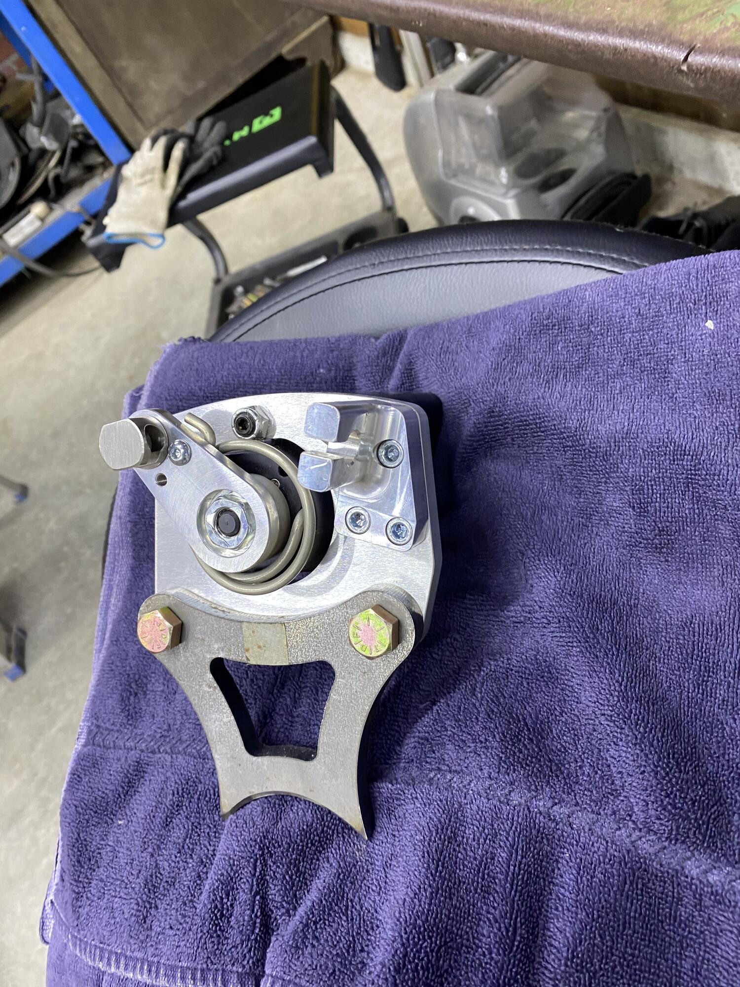

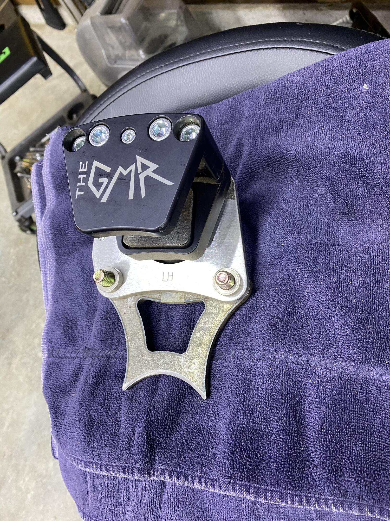

      Parking brakes, what I thought was going to be easy turned in to some head scratching. Lol!
      I had to weld a couple nuts on the bottom control arm brackets and reverse one of the bolts for the ebrakes in order to be able to service the ebrake later.
