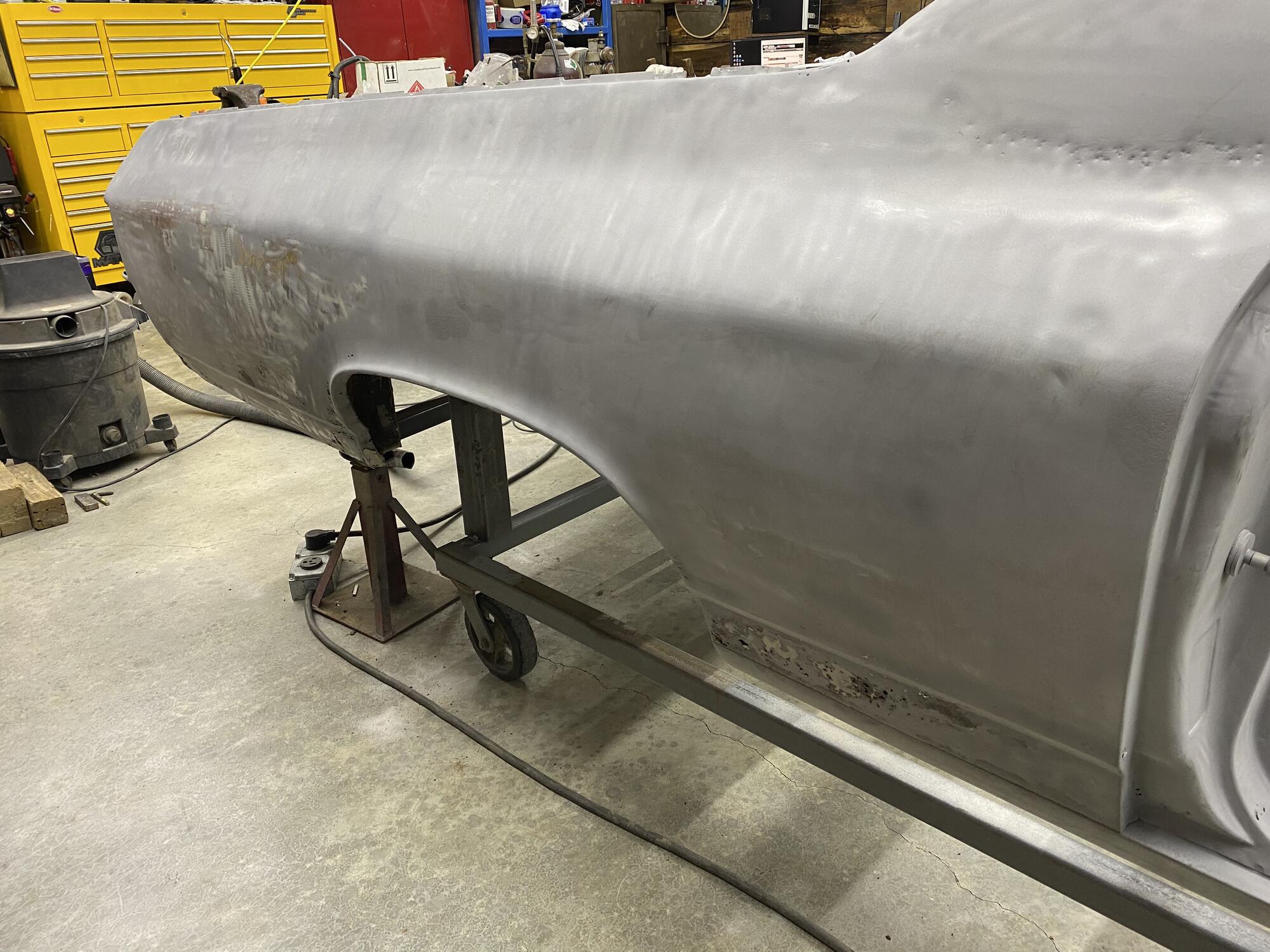

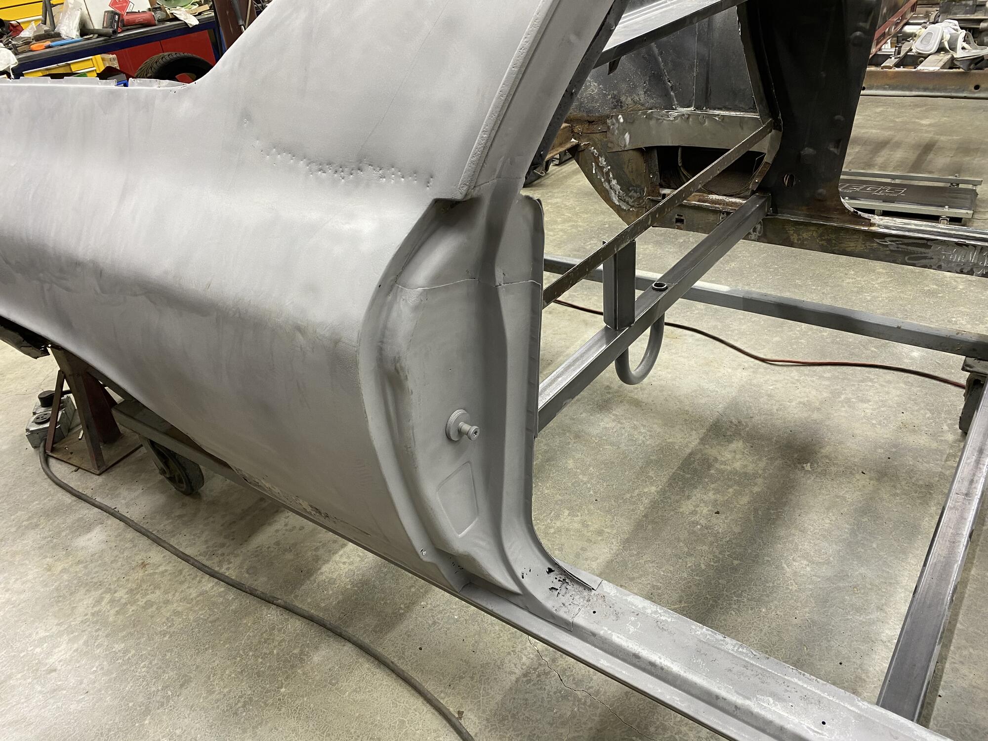

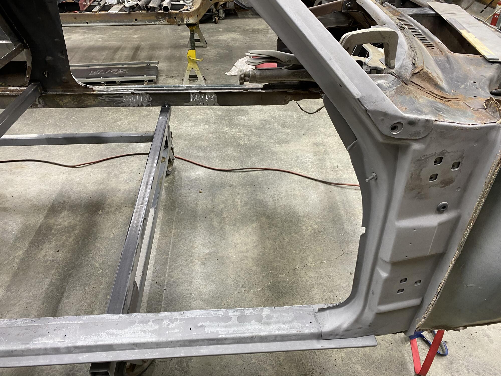

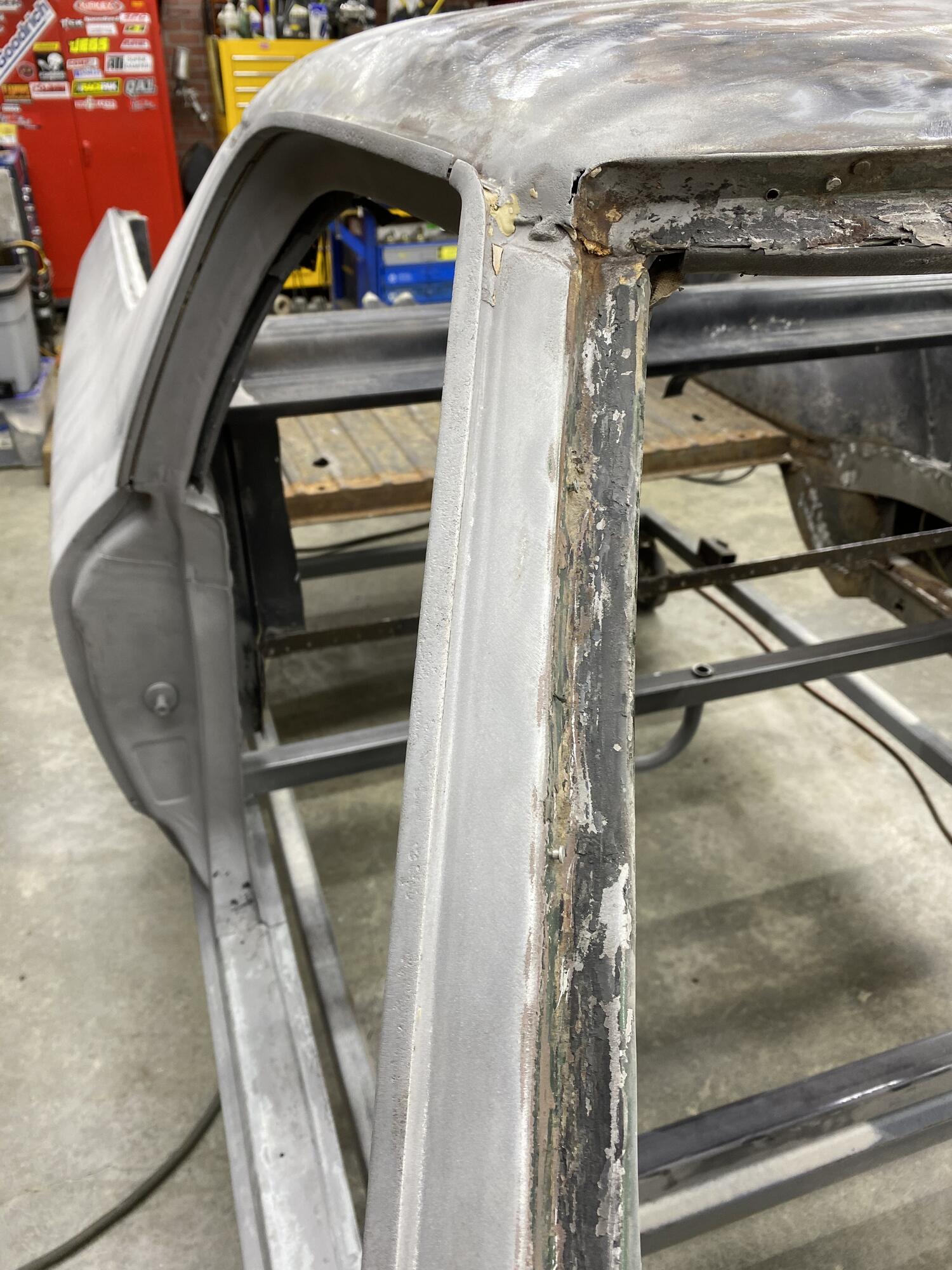

      Small update over the last few days, in between rain and cold windy days.
      Started blasting the passenger side door jam and quarter panel, this will take some time to finish but I have the time as opposed to paying $1000+ to have the car blasted.Name:  23321D5C-55BA-47A9-A72E-CE125A9CB1A4.jpg

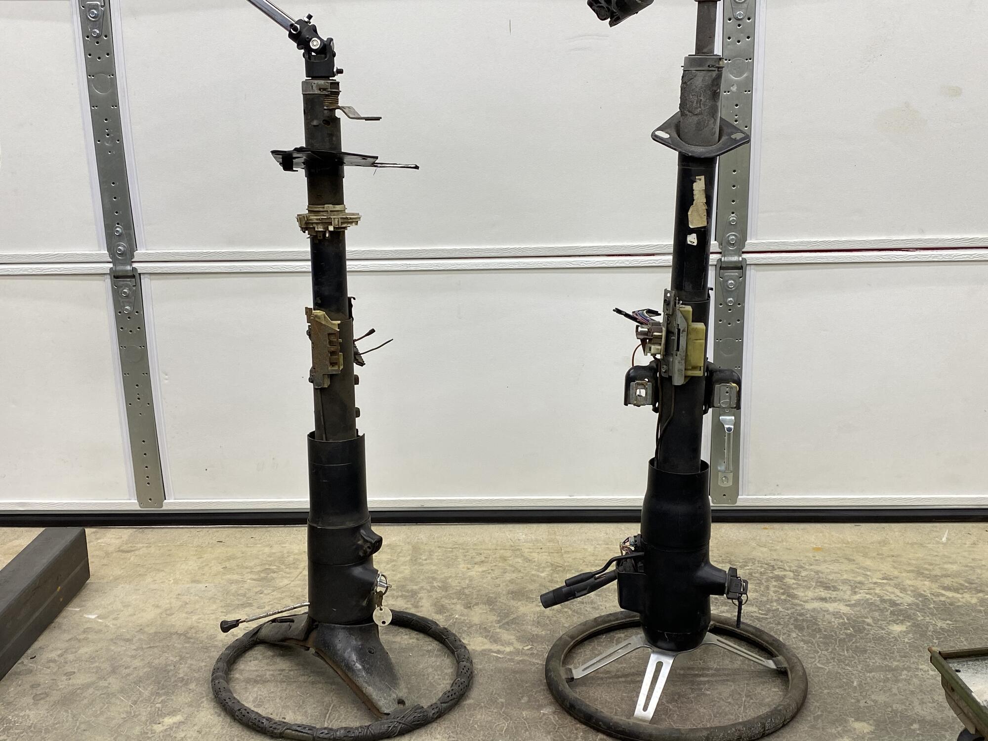

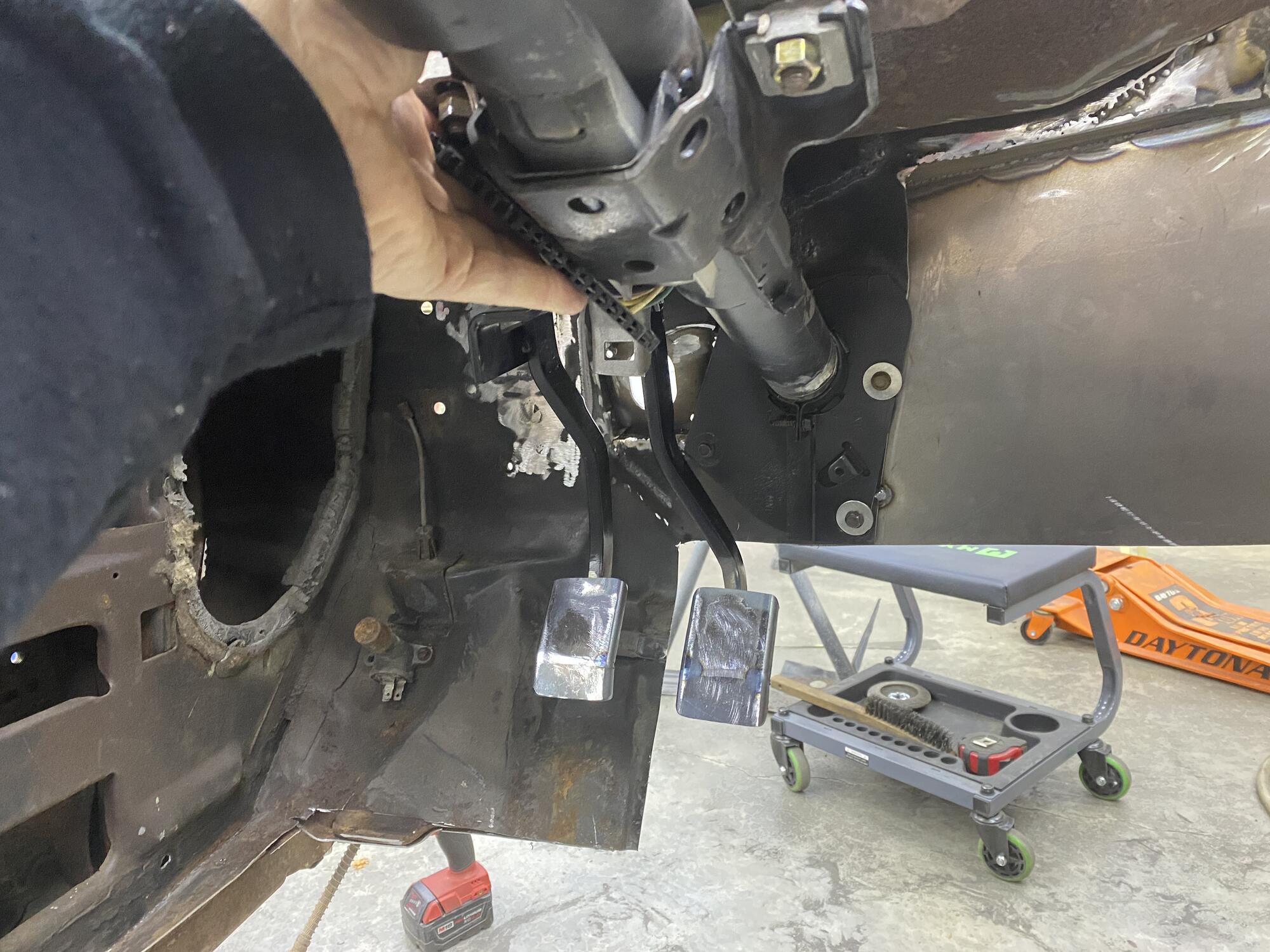

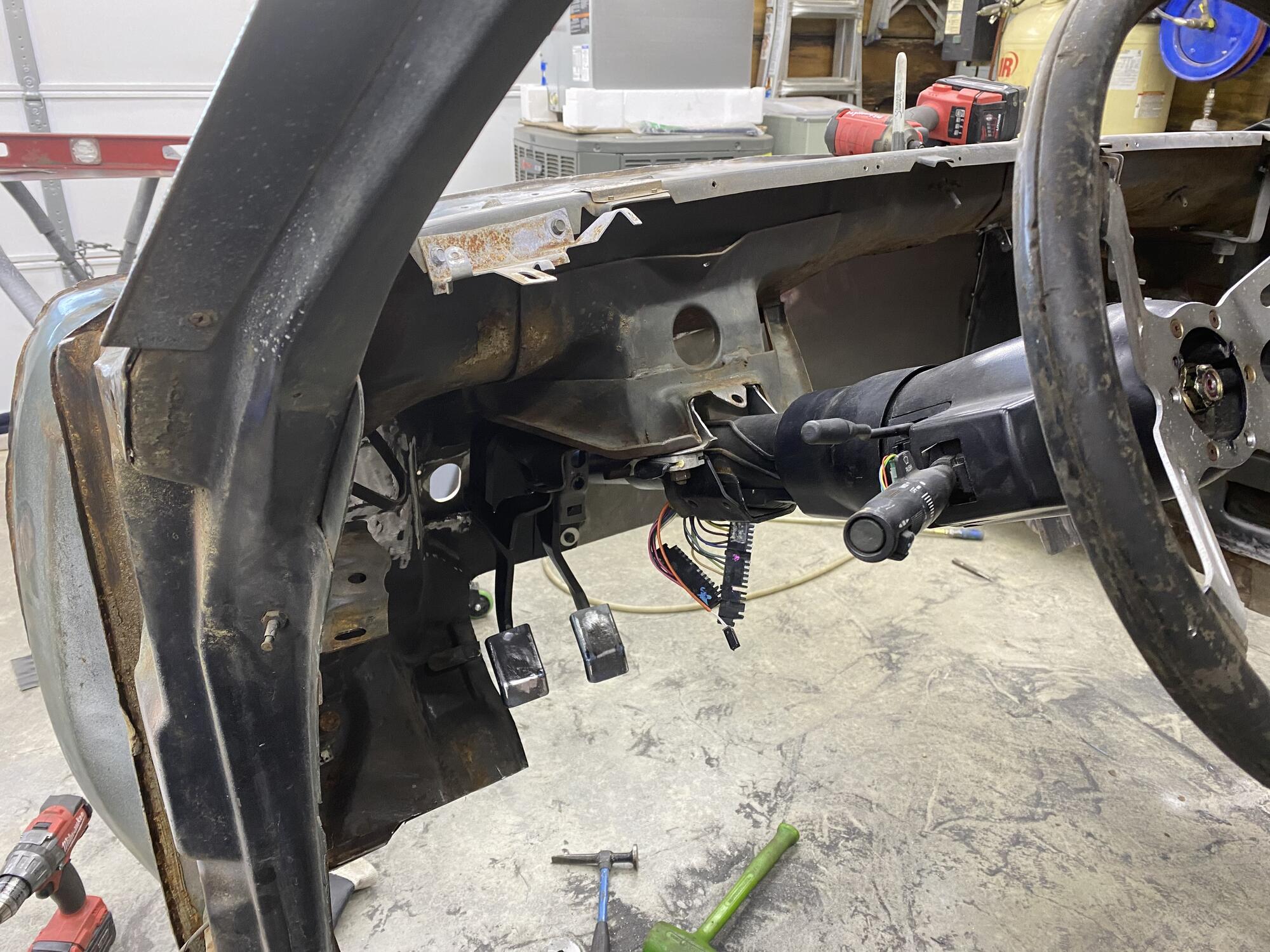

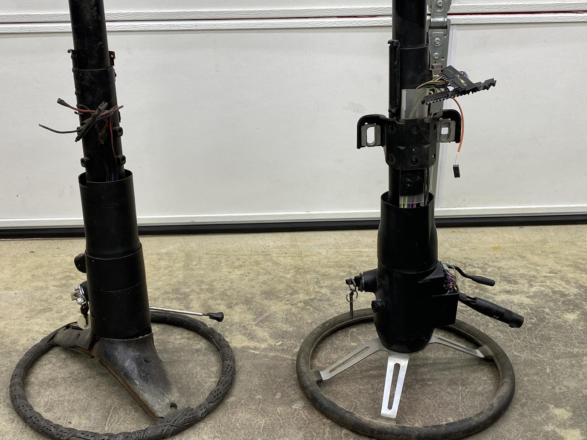

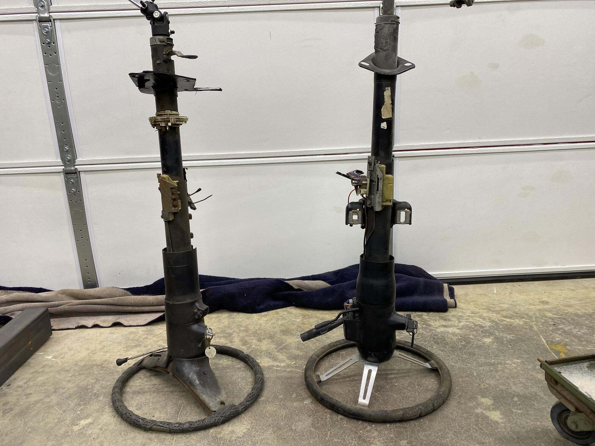

      Some pictures of the steering columns side by side Name:  0AD3932B-48D1-419A-BF38-5BCF43AE0A49.jpg
Size:  327.4 KBName:  B69C208B-C6D1-4099-9550-246B0C478FFB.jpg
Size:  398.6 KBName:  7A748E1C-D5A2-412C-B86B-5A1B156B10B8.jpg

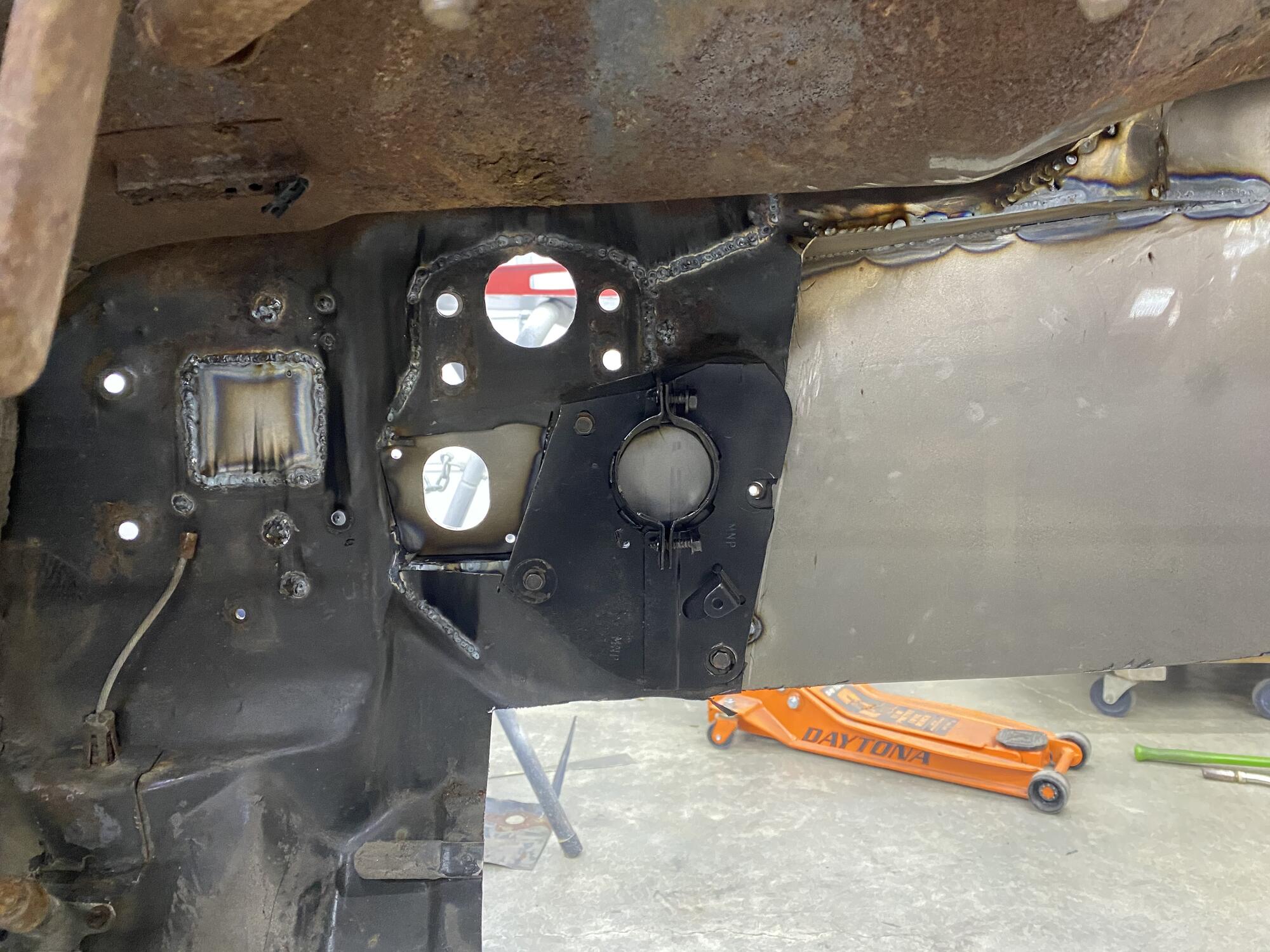

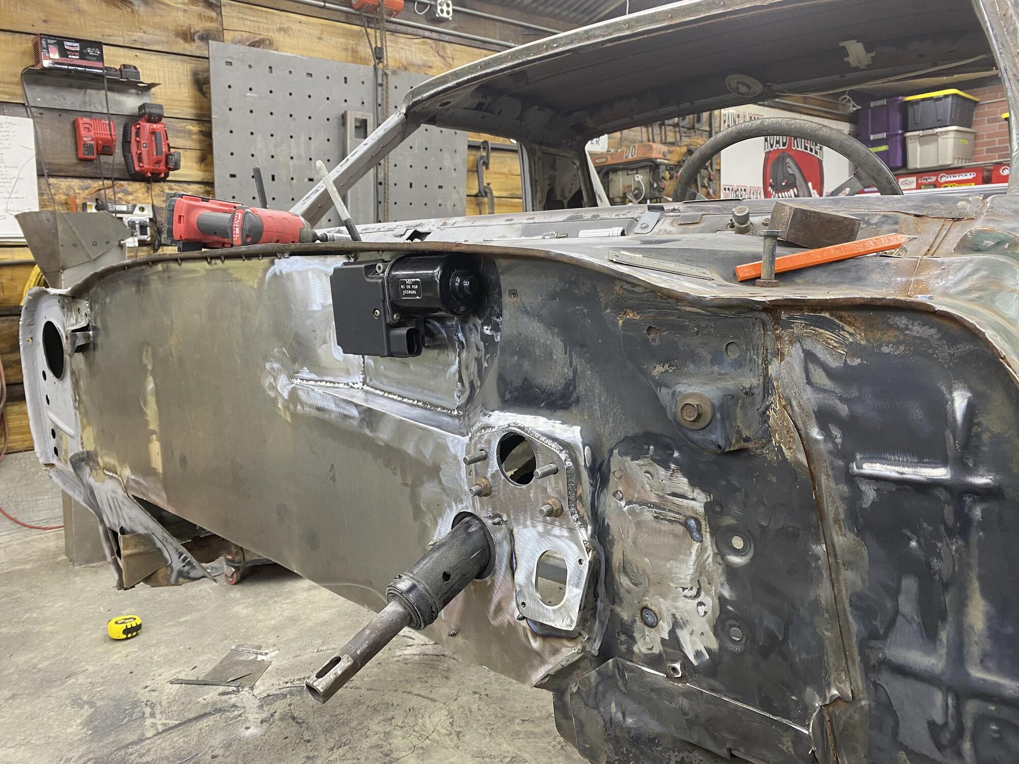

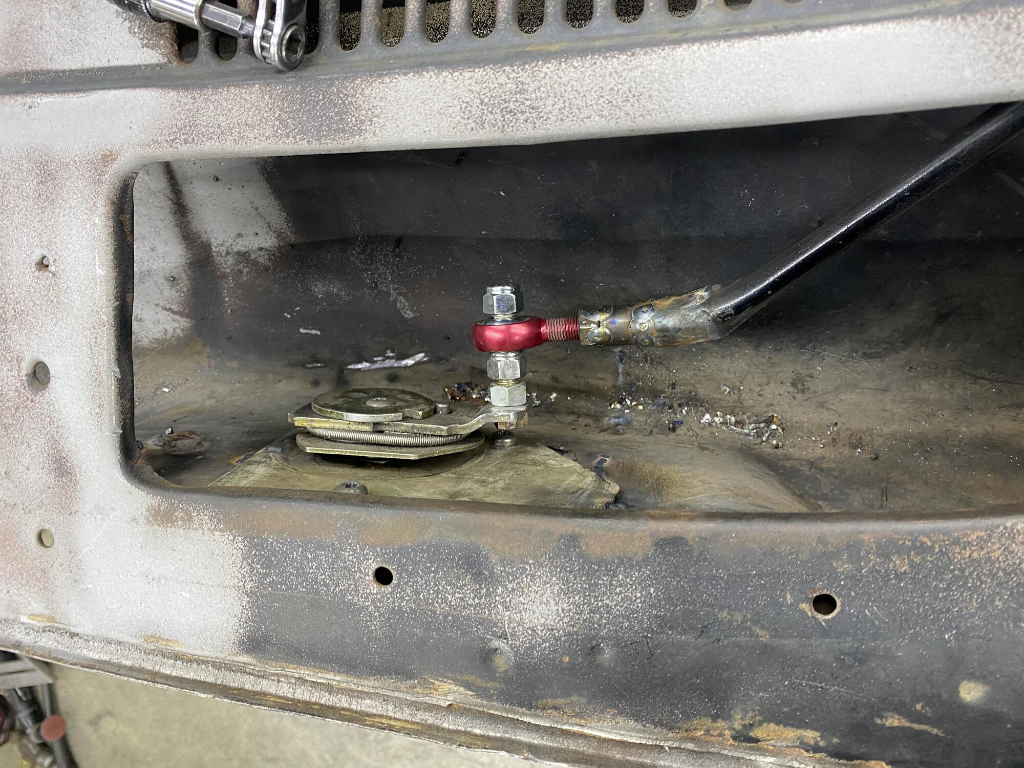

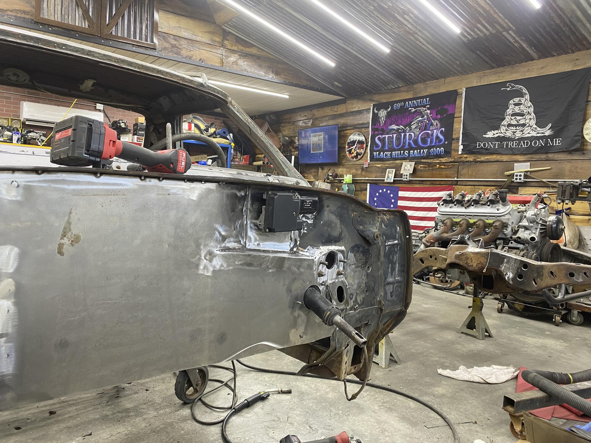

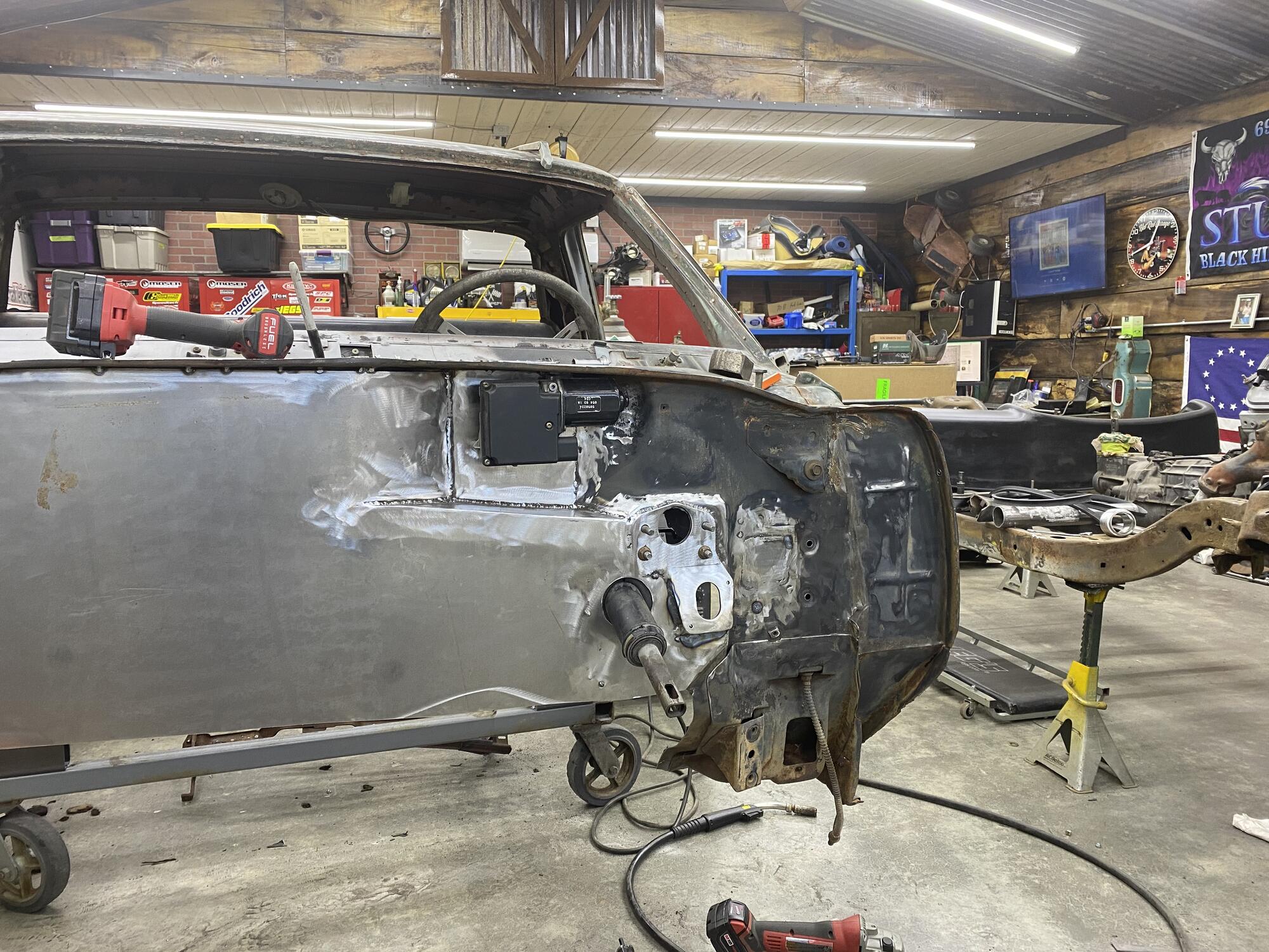

      Worked on the firewall today! Little more clean up then on to blasting some more of the body!
      Also made improvements to my windshield wiper install!Name:  8001B09D-F23E-4456-AB18-CBE9D03A4753.jpg
Size:  539.9 KBName:  F3BE0C70-708B-4DFD-8AB4-30D0F3C2366F.jpg
Size:  415.7 KBName:  752D7DB6-21AF-43F5-854A-7BA390A1F105.jpg
Size:  377.0 KBName:  FCD4A719-074B-411B-BD5B-DD1503EC00B7.jpg
Size:  464.5 KBName:  ED463AF4-7332-4824-84C7-3BD3EB020376.jpg
Size:  480.8 KBName:  95F9BD19-F2F1-467A-8C03-1A5CE84F611E.jpg

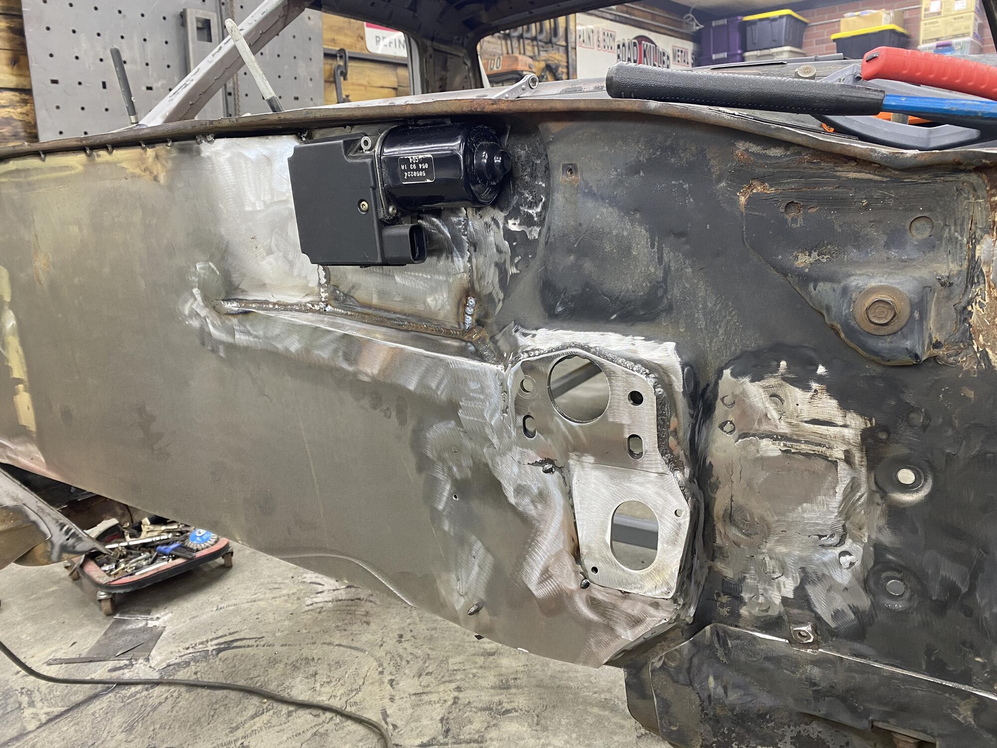

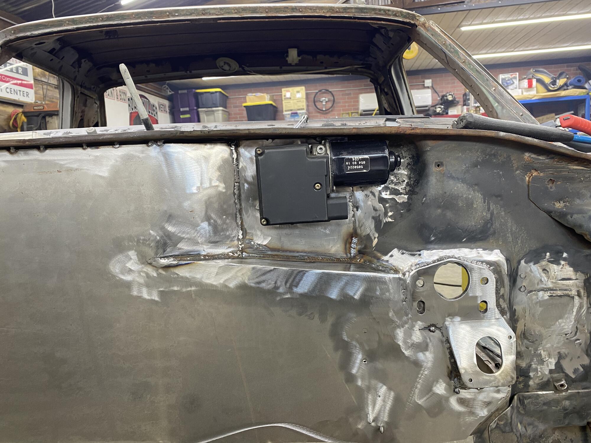

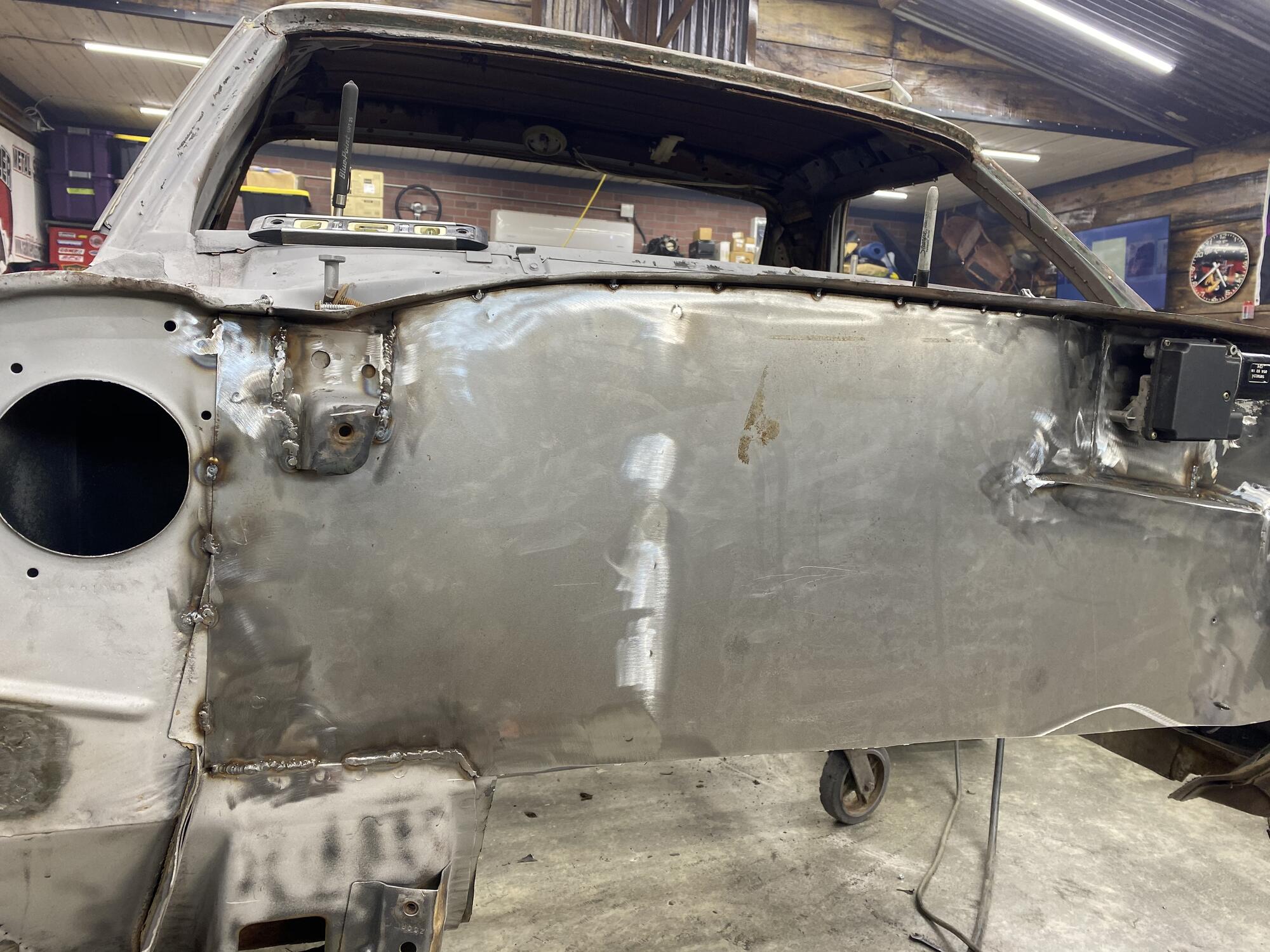

      Working on the firewall this morning , got a little more done and things mocked back up.
      Its really nice weather today so I'm about to take the mocked up parts off so I can get it outside to blast some more
Size:  348.5 KBName:  IMG_5177.jpg
Size:  410.8 KBName:  IMG_5178.jpg
Size:  506.6 KBName:  IMG_5179.jpg
Size:  507.0 KBName:  IMG_5180.jpg

      I like the new column mount , Im curious what is the wiper motor from and will you still have a park feature for the wipers
      Ryan Austin
      On Instagram ryanaustinss70
    11. #51
      Aug 2002
      Waleska Ga.
      2,722
      Quote Originally Posted by raustinss;[URL="tel:1351021"
      1351021[/URL]]I like the new column mount , Im curious what is the wiper motor from and will you still have a park feature for the wipers
      The wiper motor and the steering column is from a 4th gen Camaro. And yes the park mechanism is still on the wiper motor from the 4th gen.
      David Sloan
    12. #52
      May 2010
      kitchener,Ontario,Canada
      2,358
      Quote Originally Posted by David Sloan View Post
      Thanks, its a much nicer looking wiper motor vs the originals , also gives you intermittent. Anymore details to share on doing the swap ?
      Ryan Austin
    13. #53
      Aug 2002
      Waleska Ga.
      2,722
      Quote Originally Posted by raustinss;[URL="tel:1351043"
      1351043[/URL]]Thanks, its a much nicer looking wiper motor vs the originals , also gives you intermittent. Anymore details to share on doing the swap ?
      yes sir!
      the steering column was pretty simple, I took the steering wheel and air bag with the wiring off of the column. Then I test fitted the steering wheel I plan to run , all looked good so I moved to the mounting on the column. The two bolt on the Camaro column was much wider than the Elcamino so I took a couple measurements to verify that the mount off of the Elcamino column would fit if I cut part of the Camaro mount off.
      it looked like a good fit so I cut the mount down enough to tack weld the Elcamino mounting plate to the Camaro column. Once that was done I test fitted it to the body.
      So now I liked it so far and got to a point where I could get to working on the firewall again. Tried to keep it simple and cut a little more of the original firewall away. I started fitting a piece of 20ga sheet metal to cover most of the firewall.
      the wiper motor had already been mocked up a couple different ways until I found a way that I liked and it would function correctly (checking it without power by hand) to make sure it would turn without hitting anything and be timed correctly.
      the next test will come after I get the wiring connectors and power it up!
      That will be a while!
      Hope this helps!

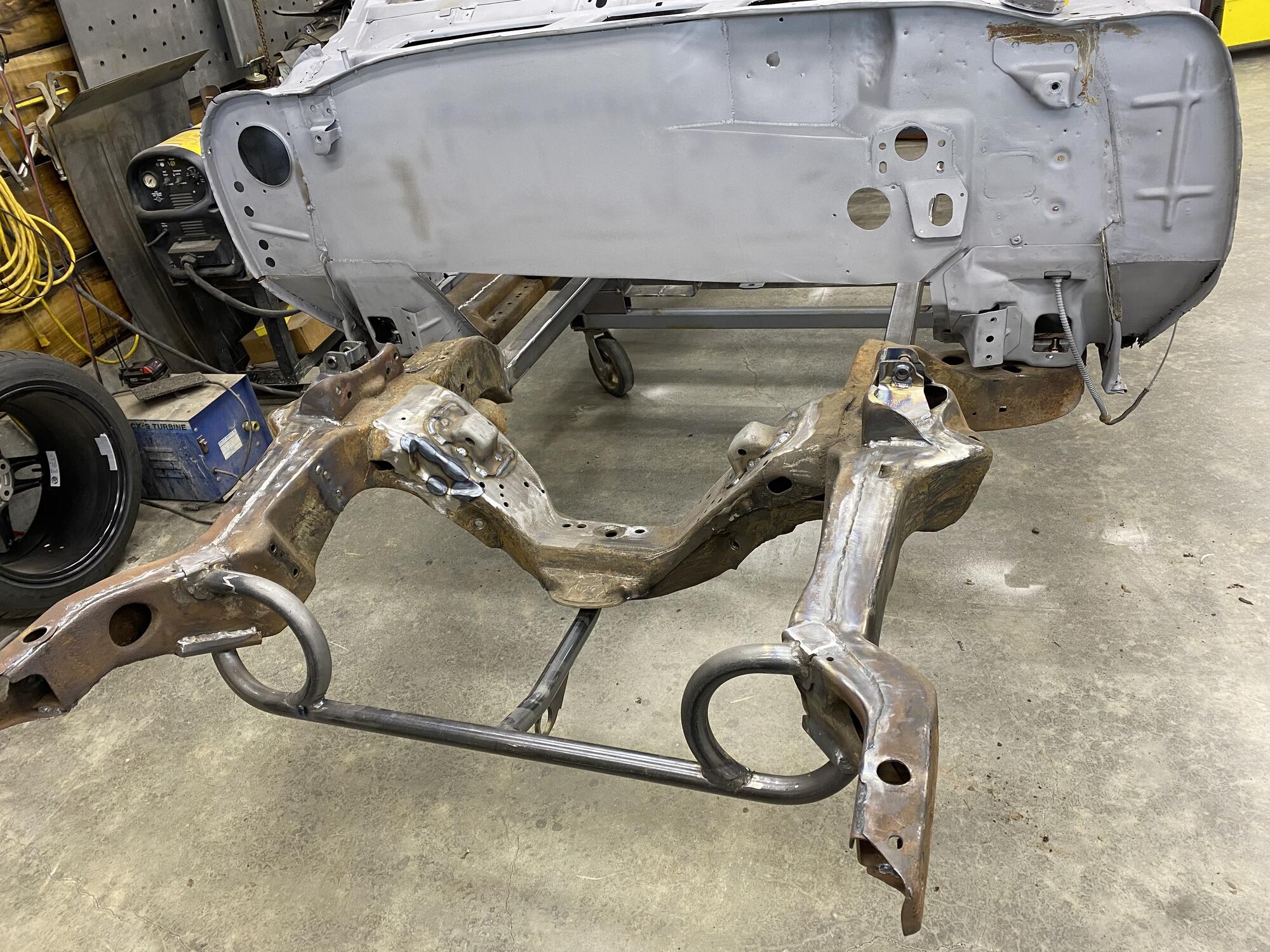

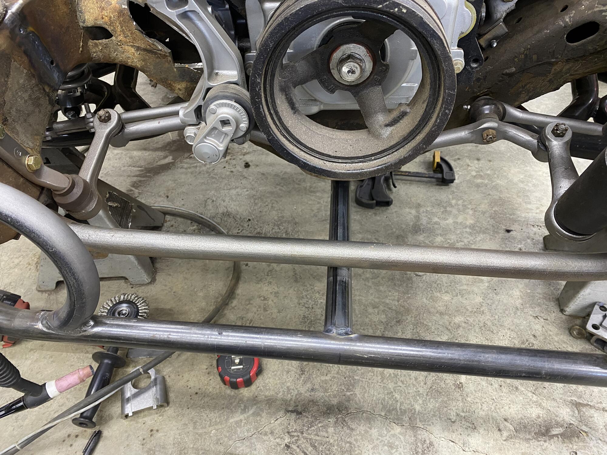

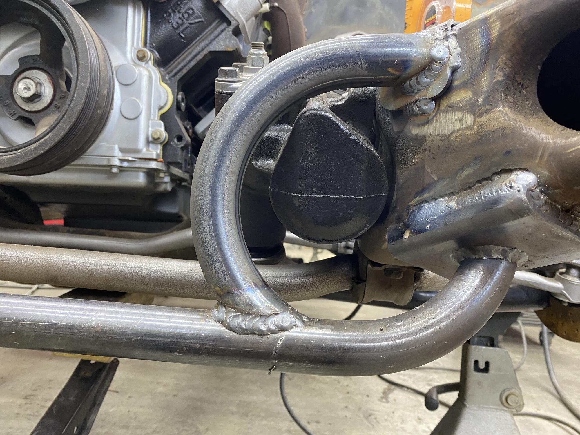

    17. #57
      16,126

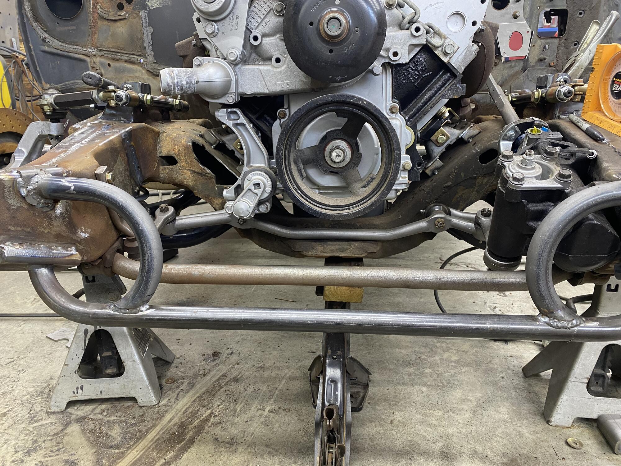

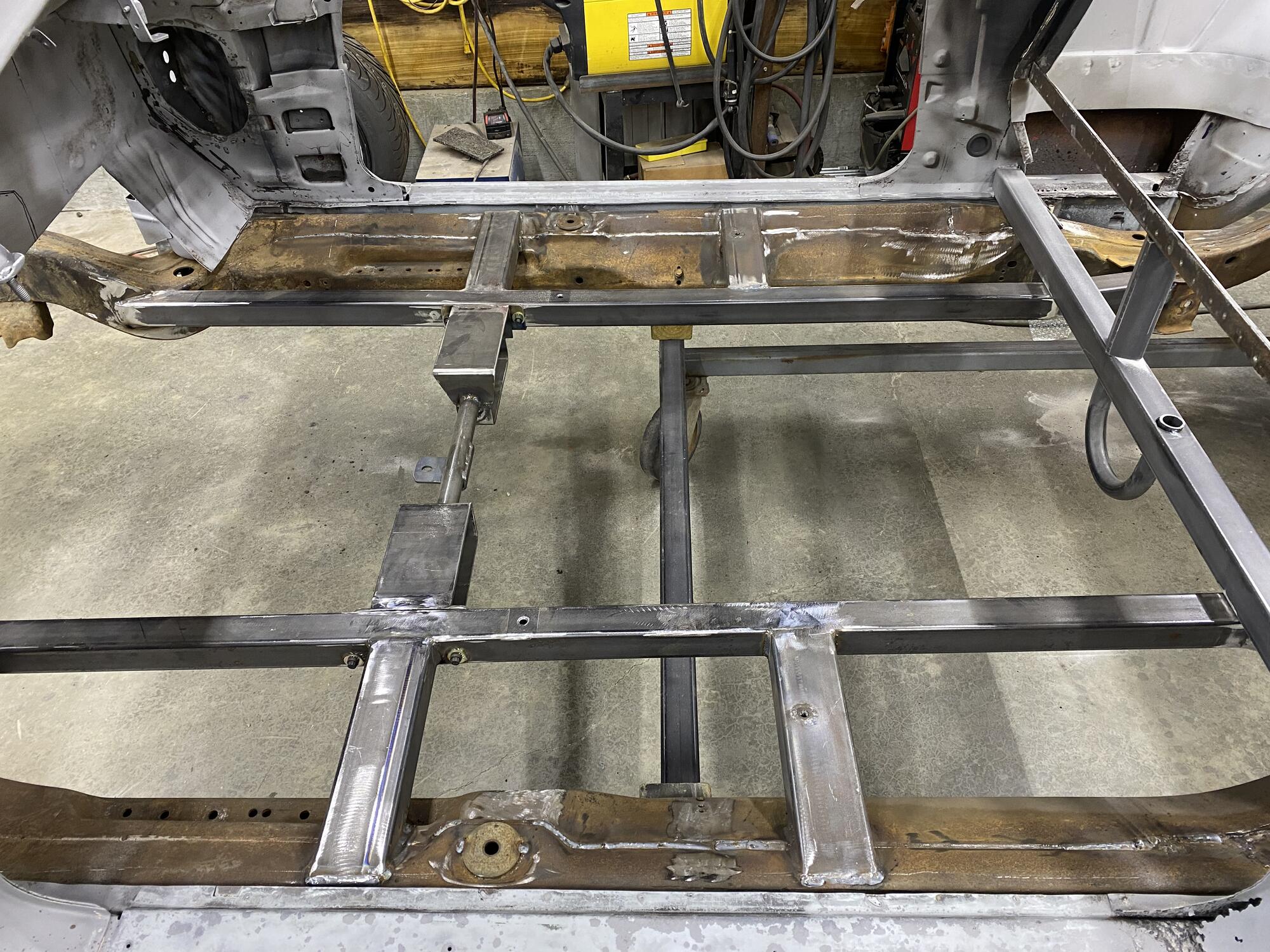

      David,
      You got a very interesting arrangement with the crossmember on the front frame horns. Presumably it doesn't interfere with anything?
    18. #58
      Aug 2002
      Waleska Ga.
      2,722
      David,
      Hi Andrew
      No sir it does not interfere with anything.
      I have had it all mocked of a couple times now, It is a little more trouble to get the 2nd gen trans am sway bar off but worth the effort I think. As I'm sure you know the front frames tend to sag on these a body's . This really seams to have help with that as i have done a visual test with a jack in the normal location with motor an trans. installed. (Before and after the added bar) I could not see any movement after the install that i had seen before it.
      This should also help with any frame rail flex at the steering box and idler arm location.
      Thanks for looking!

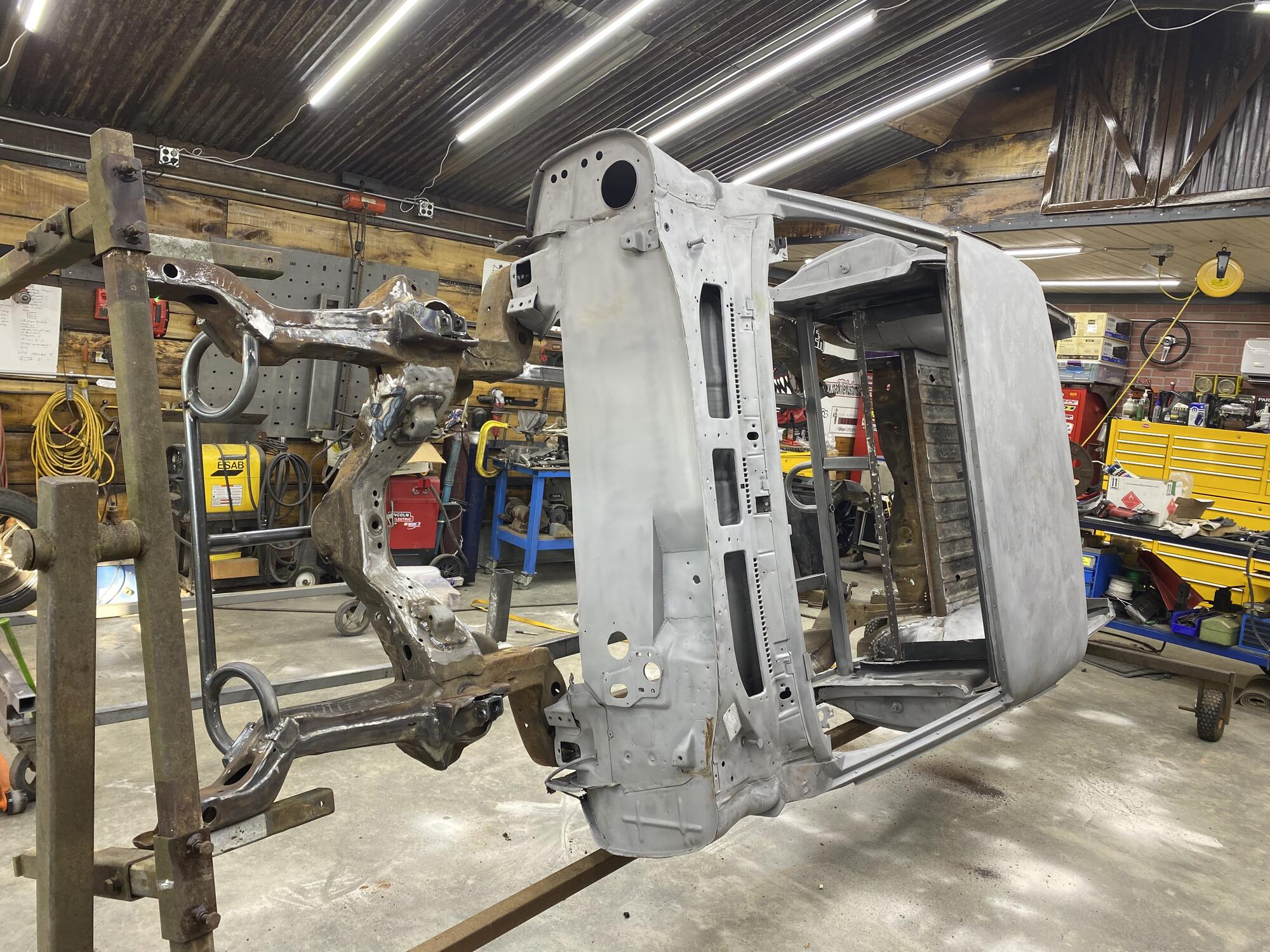

    20. #60
      Aug 2002
      Waleska Ga.

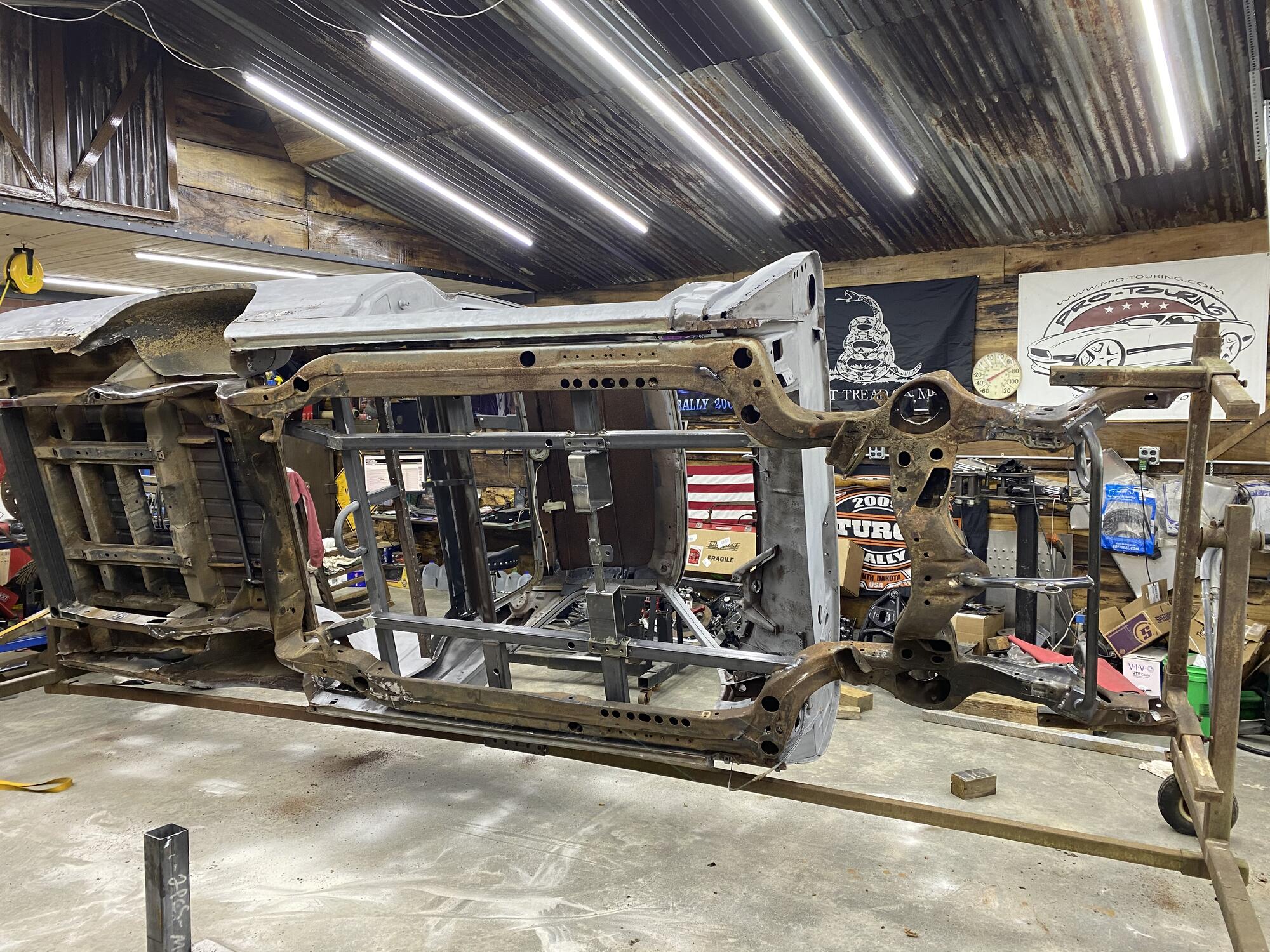

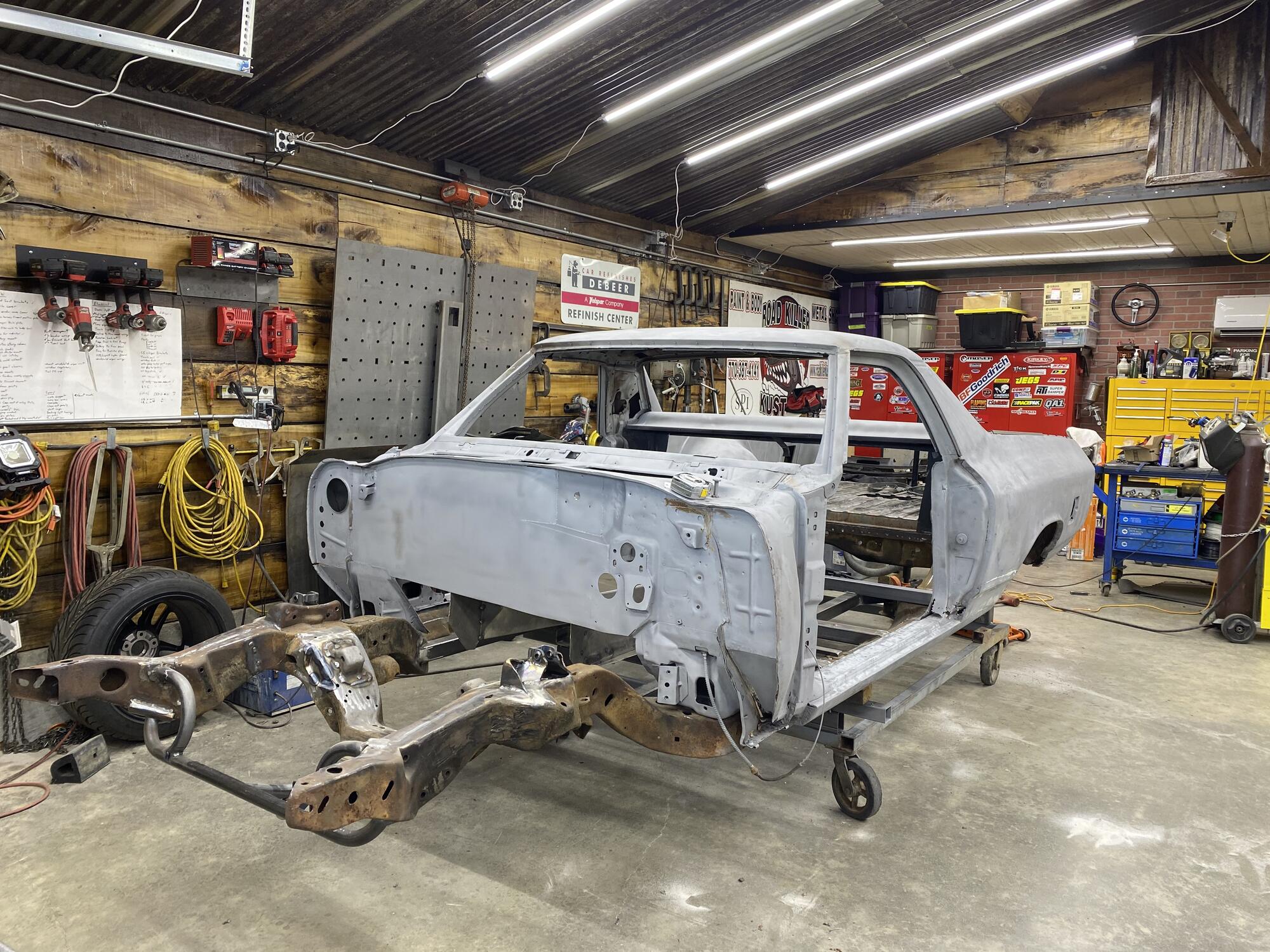

      2,722

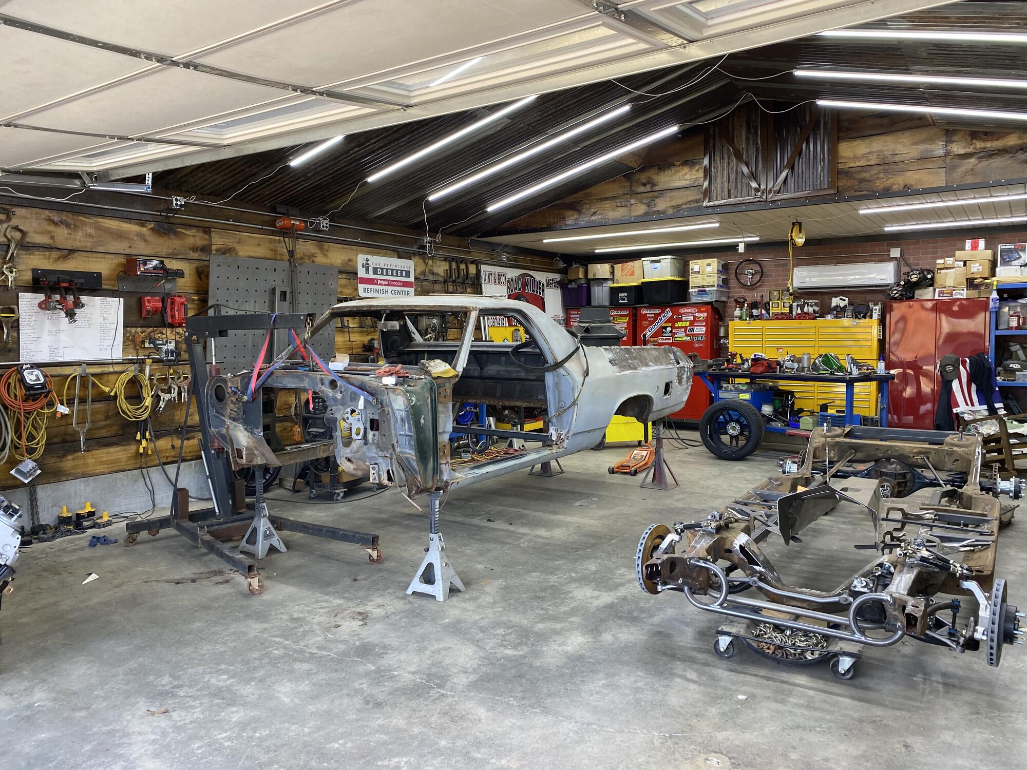

      Well the shop is a wreak but the Elcamino is on the rotisserie!Name:  423968DF-3A00-445F-93F7-C45336EF96F0.jpg
Size:  517.3 KBName:  962CE106-48C8-4154-9E3F-D7C2662E1706.jpg
